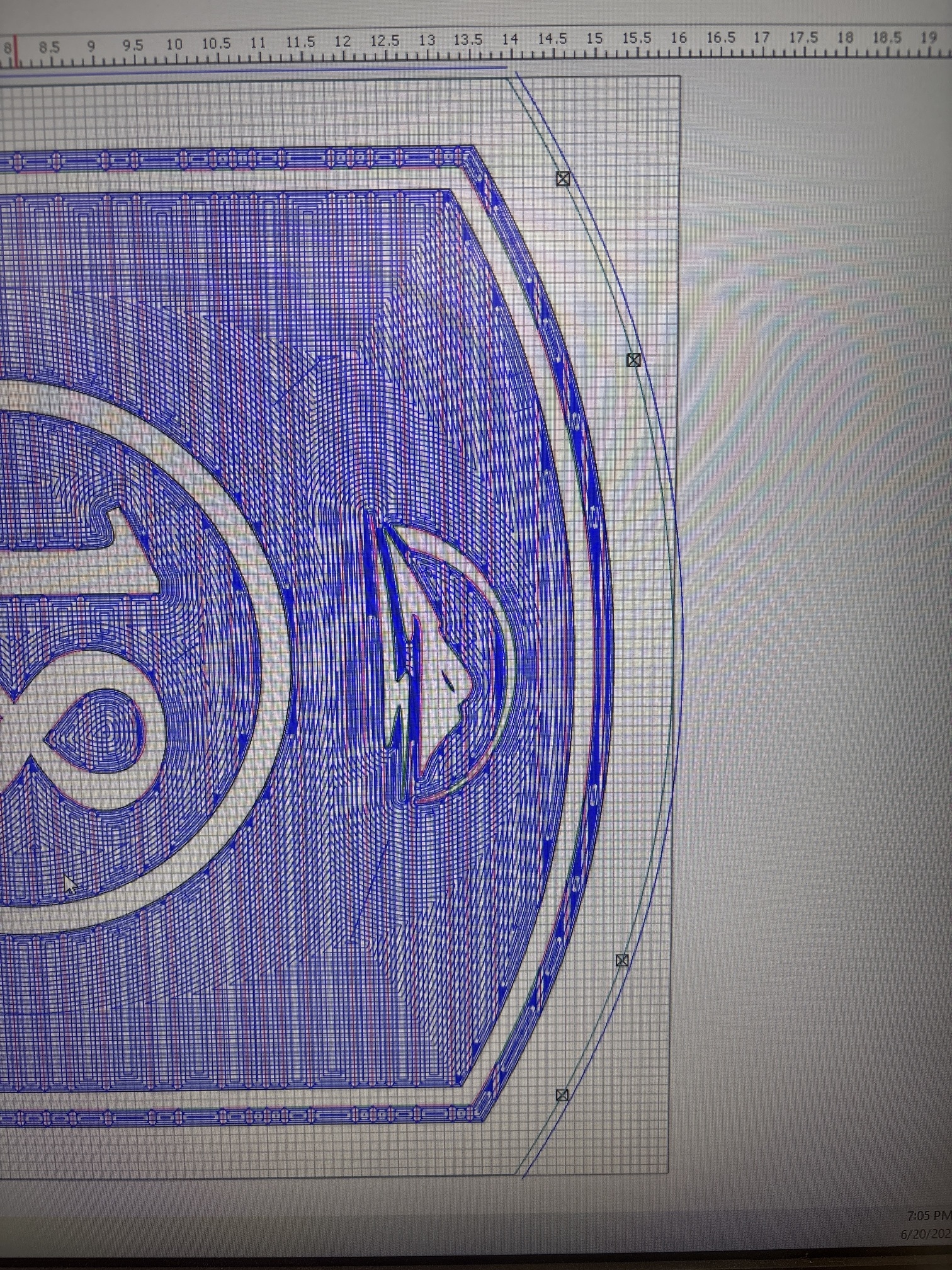

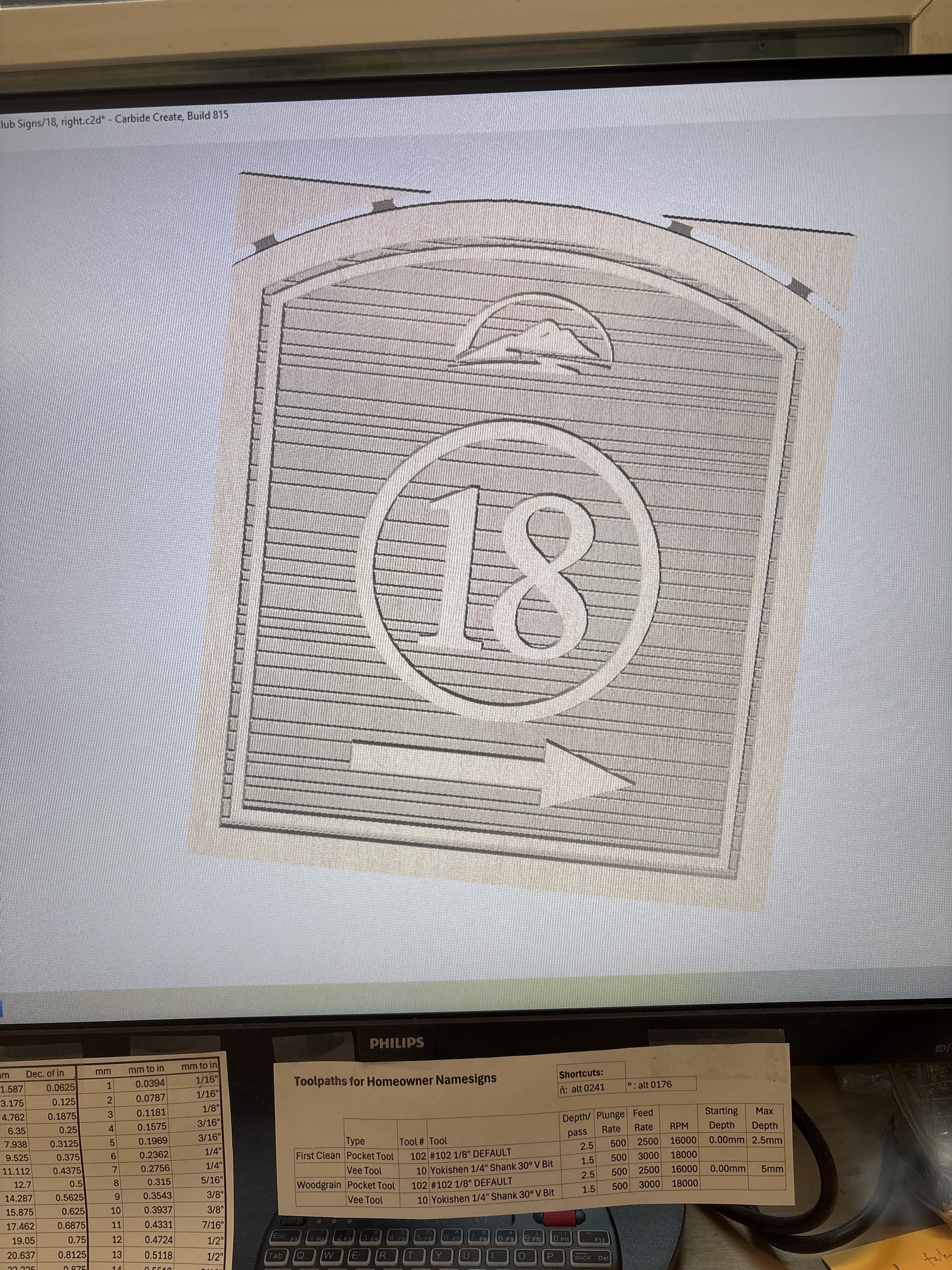

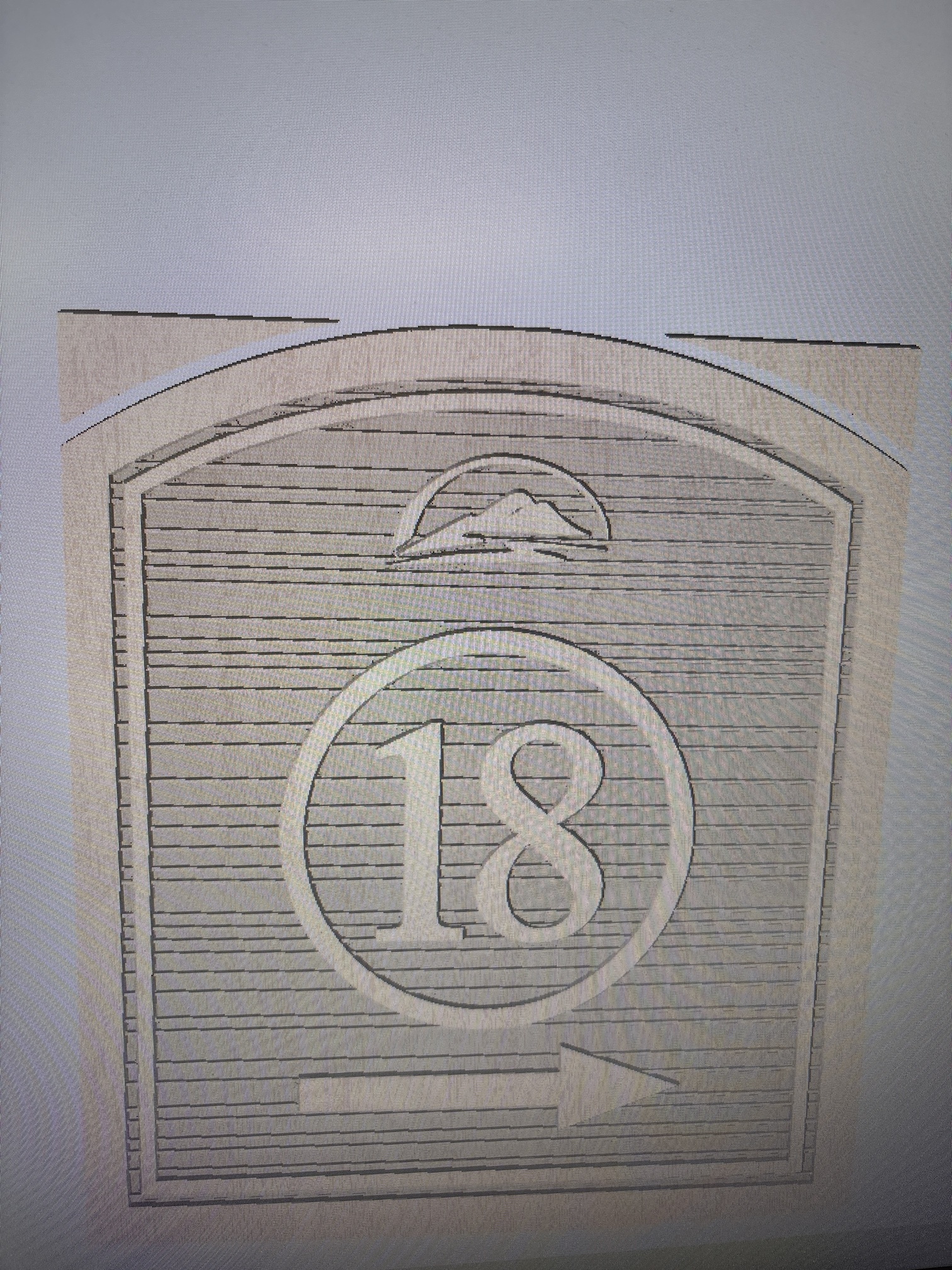

Question of the day:
Why the heck aren’t my tabs showing up in my simulation
I’ve checked the thickness, I’ve checked the tab size, I’ve checked max depth. Need a little help.
Looking for tabs in the arch.

Screen shots are of almost no use at all. Upload your project file .

Your tabs are on “Outer Border”, but your toolpath is on “Last Cut”.
SirGariff
(Gary Clark)
June 20, 2025, 11:37pm
5
And there they are! That was amazingly fast. Thank you so much! You are a genius . And I feel like an idiot now.

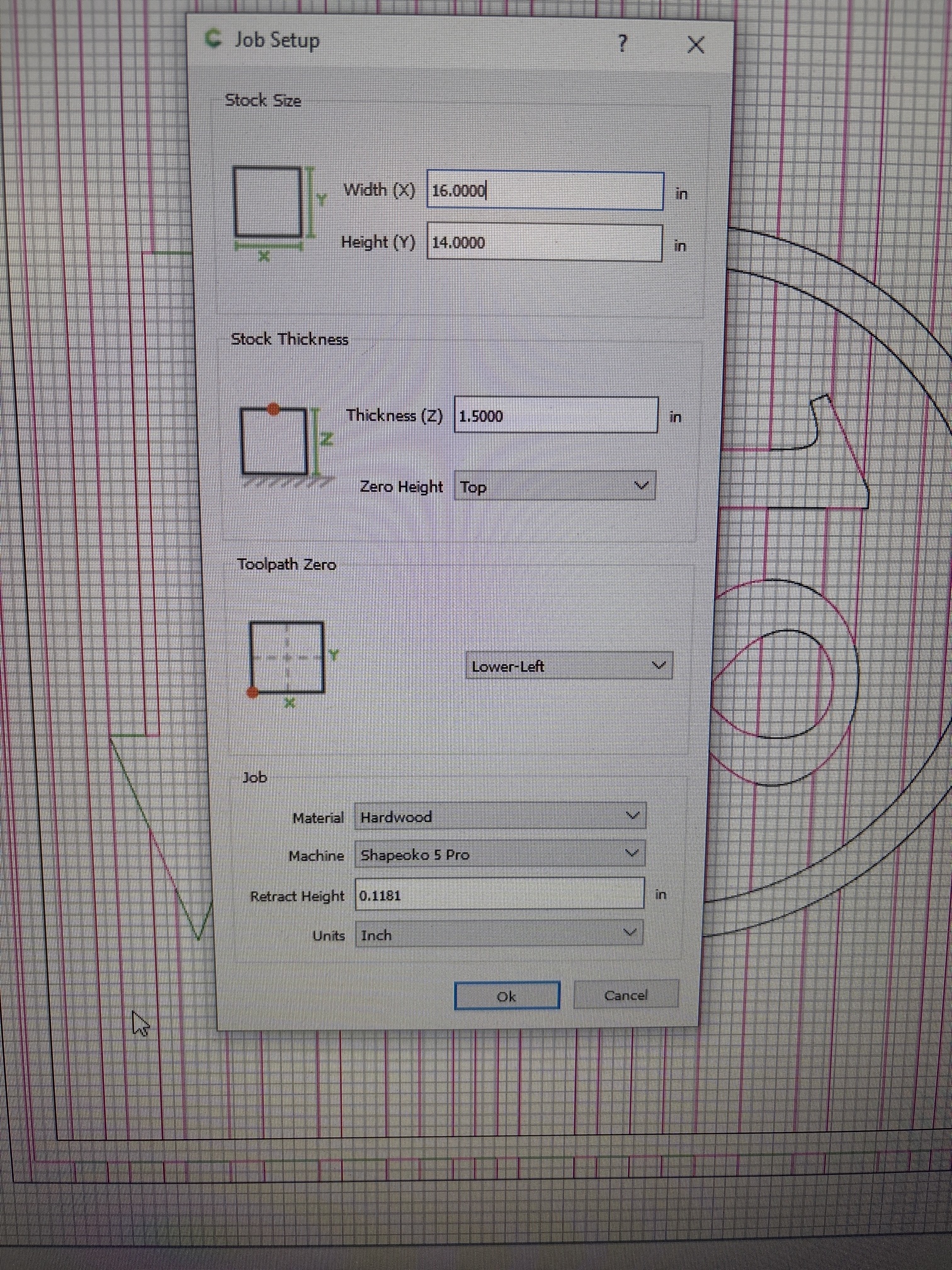

One concern, your file has a Stock Thickness of 1.5 inches:
and you are cutting out a slot which is 12 times deeper than the diameter of the tool, resulting in a very high tooling engagement (assuming your tool has at least 1.5" of cutting flute length, if not, it’s rubbing which arguably is worse) — where possible avoid slotting and add geometry and cut as a pocket
