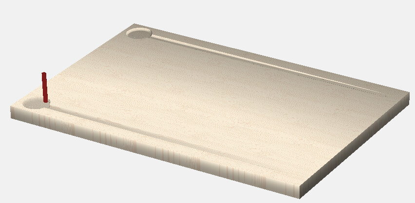

Hi,

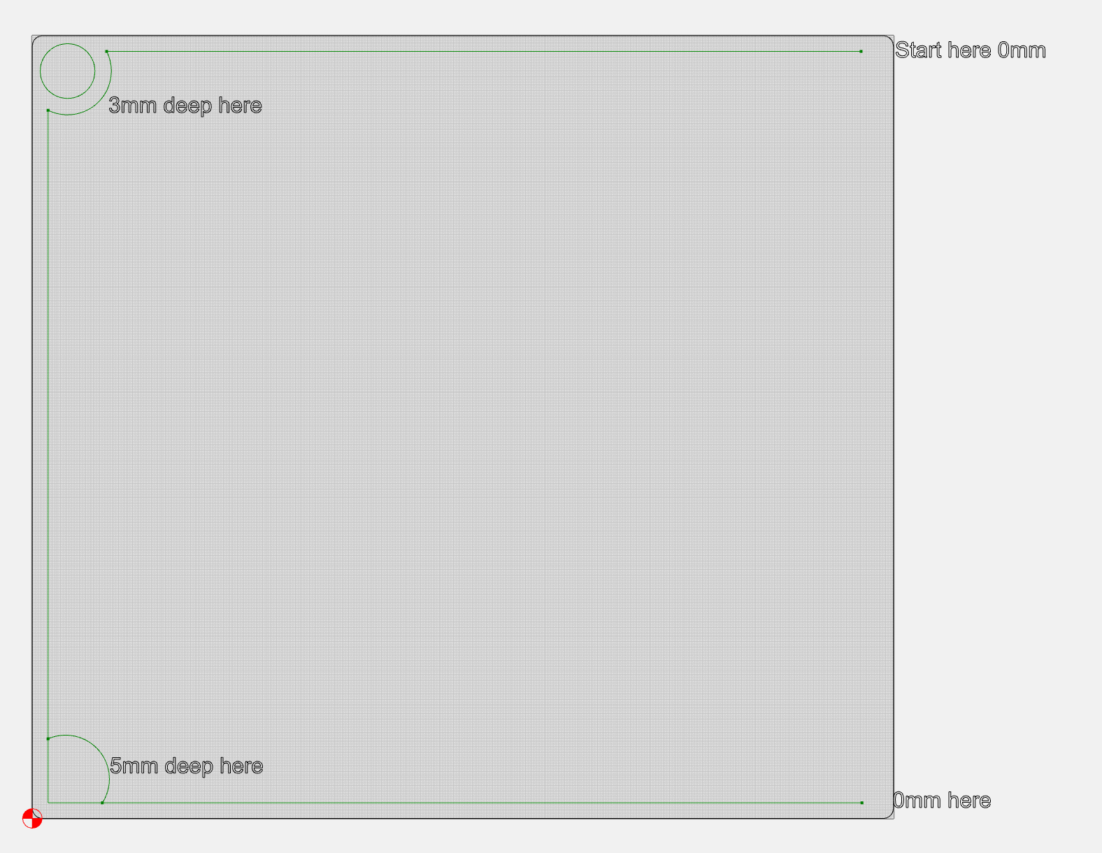

I’m pretty new to CNC and have had my Shapeoko 5 Pro for a few months (I do believe the first one in Sweden).
I’m making an inlay cutting board and have an idea for a tapered juice grove, with one side completely open so its easier to scrape things off the board. I want it to start in one corner at 0mm then end up in the far corner at 5mm depth, how the heck do I program the CNC to do that.
I would really appreciate any help on this. The picture is for clarification of what I want to do.

The easiest way would be to program it flat and edit the Gcode at the appropriate point.
You can model the tapers, but to cut in 3D you have to use a lace/zig-zag/raster cut, so you need to limit the cut with a boundary just a smidge bigger than the cutter.

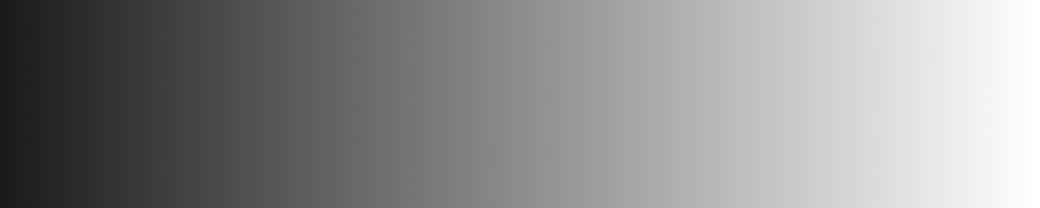

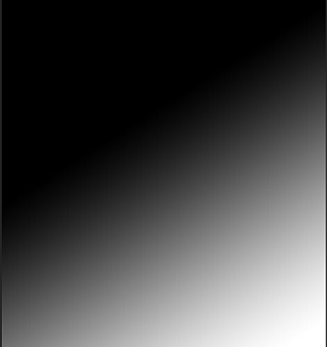

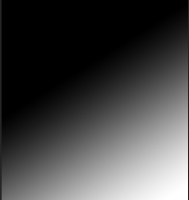

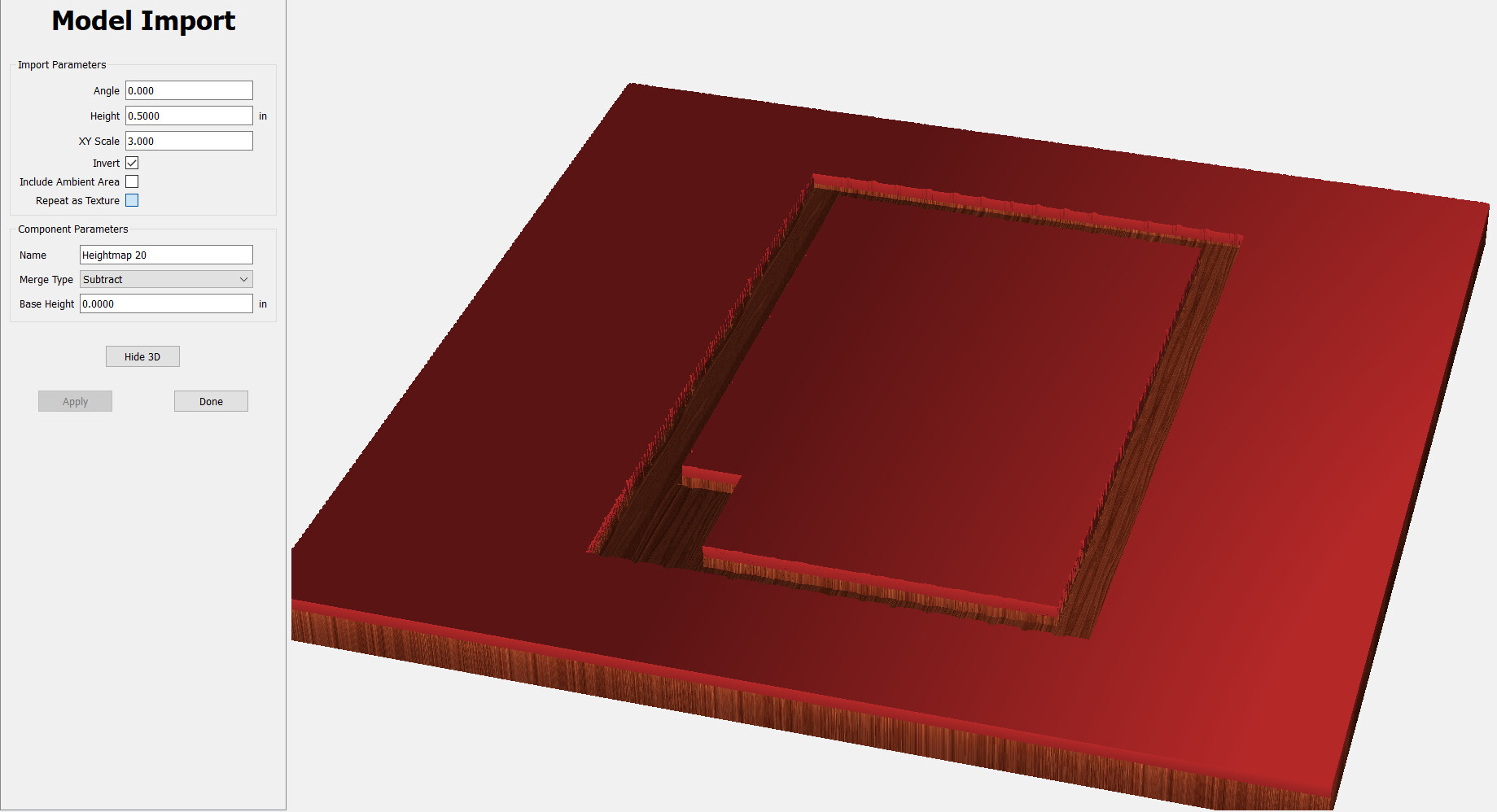

What I did, was I created a black-white gradient using Photoshop (I’m sure you can use any photo editing tool). then imported the gradient as a relief map. If you adjust your shades of grey correctly, you can get any depth settings / layout that you want.

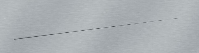

I was making a tapered trough, the simplified image is this (boxy):
Note: It’s a subtle grey to black (not a lot of depth)
and it resulted in this:
Which (if you look closely) is similar to the ramps you’re looking for.
For your project, the contour would likely look something like this:
Where everything black will be at top level, and white is bottom level — you will then need to modify your gradient colors to get the heights you want…but that’s an idea…the board would be flat at the top and then dive down to max depth on the bottom right.

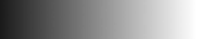

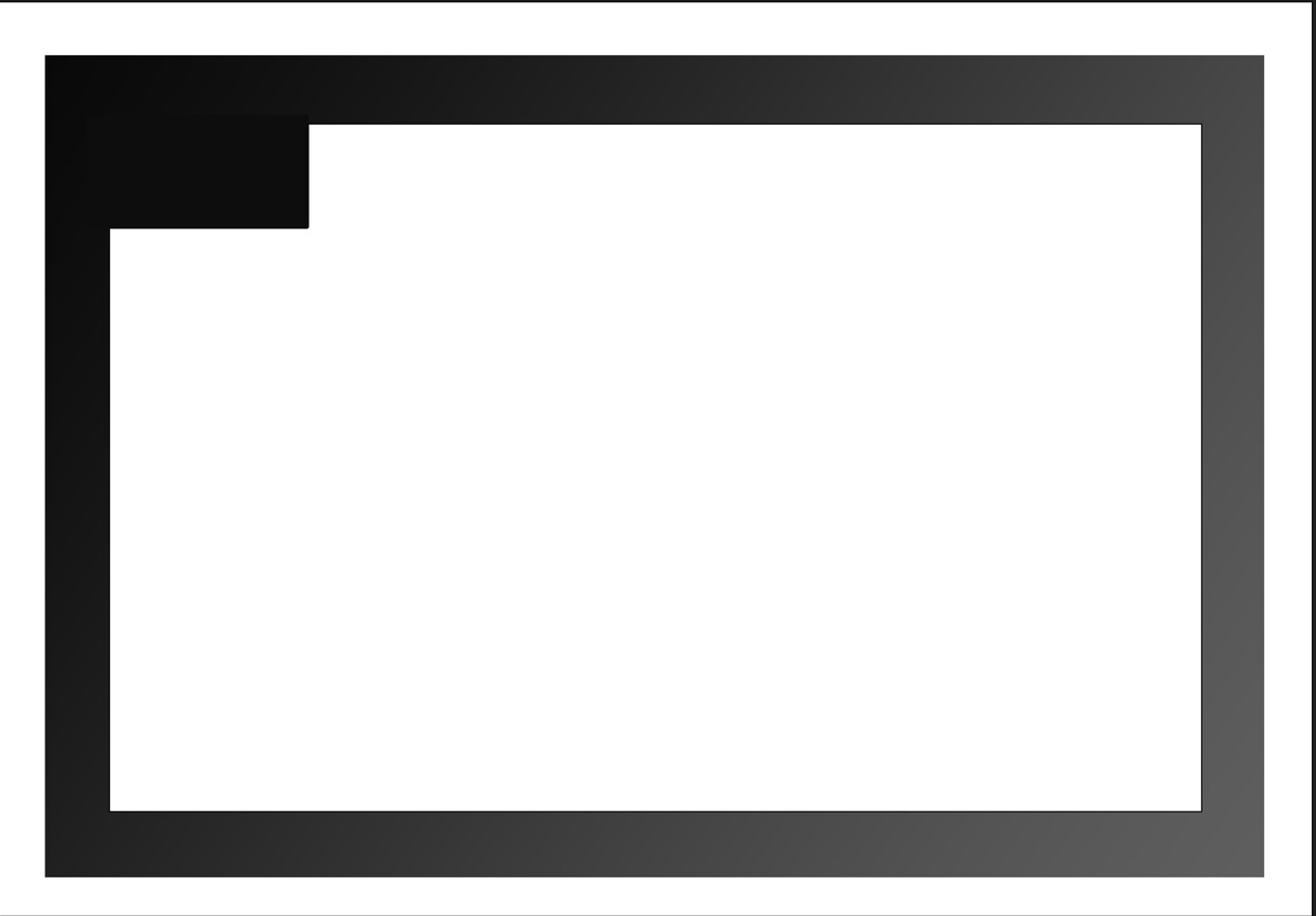

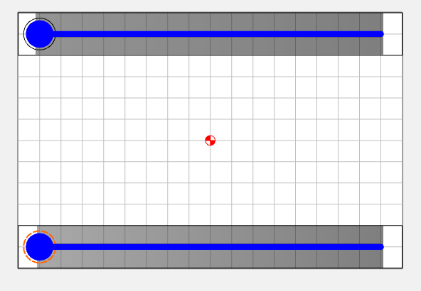

Here’s what I was referring to. Build the ramps locally, then use a boundary to only machine the groove. I machined the round pocket using a 2D pocket path.
I used this gradient for the ramps, one at 1/8" deep, the other at 1/4" deep

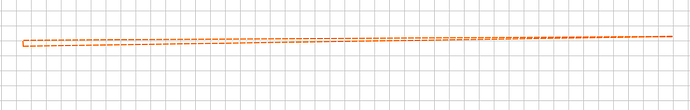

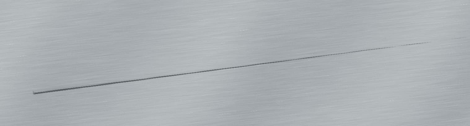

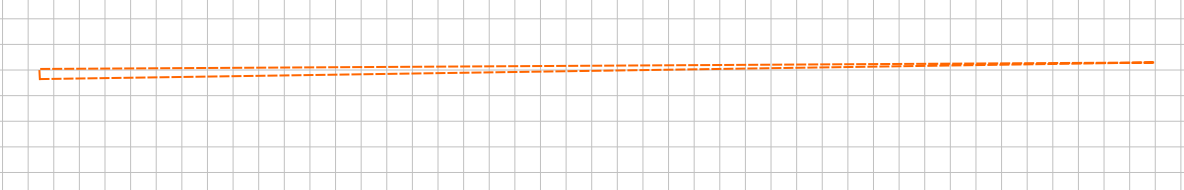

It seems to me that you could “trick” cc into doing that by using an Ad Varve, but instead of using a V-bit, install a Bowl Bit? The Vector would be a long, skinny Triangle.
Just spitballing here.
That would certainly do it. A little math involved, but with a 90° vee the width would be twice the depth. So in this case 5mm would be 10mm at the wider end.
There is occasionally a bug with very sharp shapes & you may have to make the other end something very small like 0.001" wide, rather than 0.000. i.e. add another point.
Thanks for confirming my thoughts.
I would run a .75" 90 Degree V-bit in CC, and then IRL use a .75" Bowl bit.

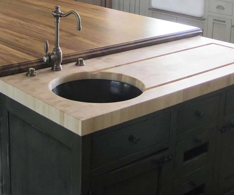

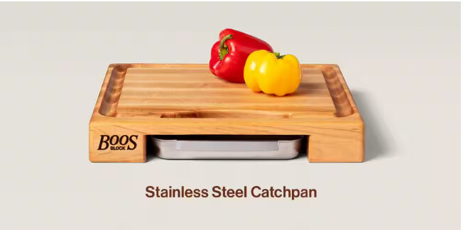

Here is one example.
Another use case is when you use a Juice pan under the cutting board.

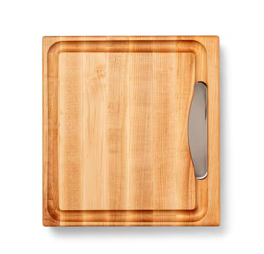

I think the question is about “tapered”…which means becoming less wide over distance. I think what you’re showing is rounded…and perhaps pitched towards a receptacle…but it’s not tapered.
Perhaps a better term would be a slanted or inclined groove - gets deeper the closer it is to the drain hole/spout/catchment.
Without regard to what “it” is called, even an amateur cook will tell you that the juice in a cutting-board-sized groove is not going to flow to any great extent. The juice will be full of debris and will require assistance to move around in the groove. One can get the same use out of a pocket.
