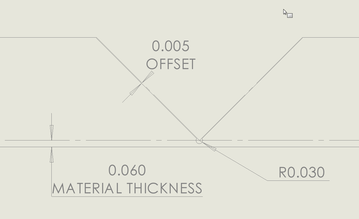

The way I’ll be modeling this will be to do ends which overlap in the 3D model:
(and instituting a check for a 90 degree angle so that that doesn’t happen at the ends).
Yes, the bending will presumably happen by hand — the big thing is, when I start from the front I want it to end up at the right position at the back.
Glad I could help some.
I would make your 90° cut .005 offset to allow for some interference when you make the bend. Here is a quick sketch assuming material is 0.060" THK.
