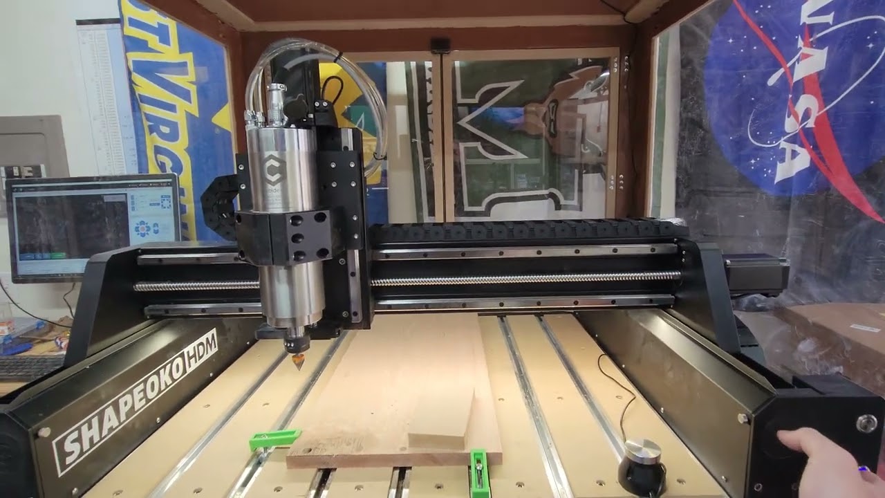

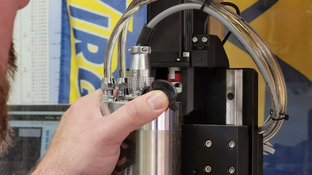

I have been seeing some intermittent missed steps in the x-axis culminating in a complete binding. I fortunately caught it on video (let me know if you want to see). The stepper wouldn’t turn the ball screw at all. I checked for detritus in the ballscrew and wipers and found nothing of consequence. I removed the stepper from the bearing mount, and the ball screw turned free by hand, and the stepper turned free by hand. Reassembled and tightened and saw the same behavior. Upon disassembly and inspection it seemed the bushing in the lovejoy coupling wasn’t fully seated and was binding axially when the stepper was tightened. I was able to flip the bushing and fully seat it, tighten everything back down and it seems to have fixed it. I also noticed one of the 4 stepper screws was cross threaded in the mount. I was able to clean the threads and reinstall.

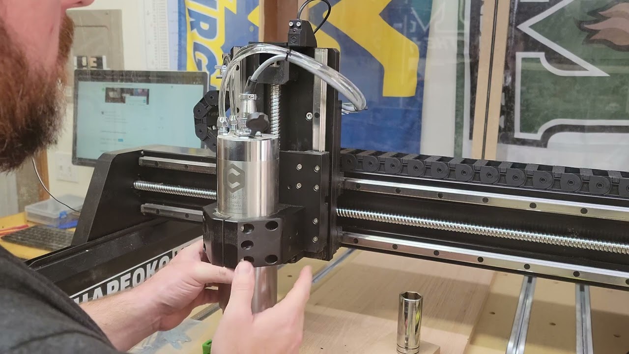

So in doing some vcarve testing today it appears i am losing steps on z and binding. I’ve posted the same file in vcarve pro and CC and ran it in Gsender and CM both with same results. Upon closer inspection I noticed this (see video). There appears to be significant slop in the z-axis ball screw. I assume this is due to loose bearing nuts?
Paging @Julien @wmoy @Luke
And here is immediately after the bit plunged ~10mm into the work, the stepper doesn’t seem to have enough torque to pull itself back up. I am jogging it up the whole time and it finally breaks free and rises.
And also the z-axis falls by itself when the machine is powered down.
Most definitely binding in the bottom 1/3 of travel. I removed both nuts on the ball screw, both were finger loose. Even with the ball screw completely free the axis won’t travel all the way down.
It looks like the DAC assembly is loose.
Please email a ticket into support and we will sort it out.
The dropping of the Z axis is totally normal when powered off.
Ticket submitted. I was able to tighten the nut on the ball screw and take up the slack. The nylock part of the nut was untouched and had never engaged the threads if that tells you anything. I used around 12 -15 lb/f on the ball screw nut and about 5 on the bearing retention nut.
Thanks Cody, glad this is resolved now. If you have any further issues please let us know.
