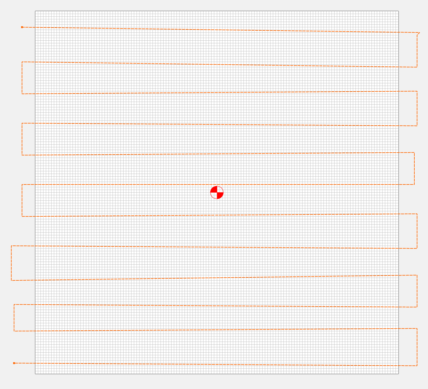

Is there a way to create a flattening tool path that starts outside the edge of the work piece? I am using a 1.5” flattening bit that has the blades on the outside of the bit. I do not believe a pocket tool path would work on this type of bit. Any help would be appreciated.

If there is room just make a rectangle bigger than the object being flattened. On my SO3 I purposely made my spoilboard smaller than the maximum cutting area so I could get my whole spoilboard flattened. On the SO5 and SO4 the hybrid spoilboard cannot be completely flattened in one operation. I believe @WillAdams has suggested on those machines to turn the mdf slats around 180 degrees so the back (now front) can be flattened. However if you just do a pocket the tool path starts at the center. So you can just draw a zig pattern that is closer together than the width of your tool and do a contour with no offset. I am sure the SO5 and SO4 folks will pipe in on how they flatten large objects like their spoilboard.
I crudely drew this in CC.
Basically you are creating a raster pattern for the bit to follow.
The raster pattern would need to fit inside your physical limitations of your machine and you material size would need to be bigger than your actual material.

For a free tool to generate such toolpaths see:

This one has some different options that can be useful.
This is really cool, I’ll give it a shot! I’m assuming “Cutting Direction: Both” does the traditional left/right/left/right raster path?
Thanks for making this and sharing!
Correct.
I highly recommend previewing the gcode in something like ncviewer before you run it.
