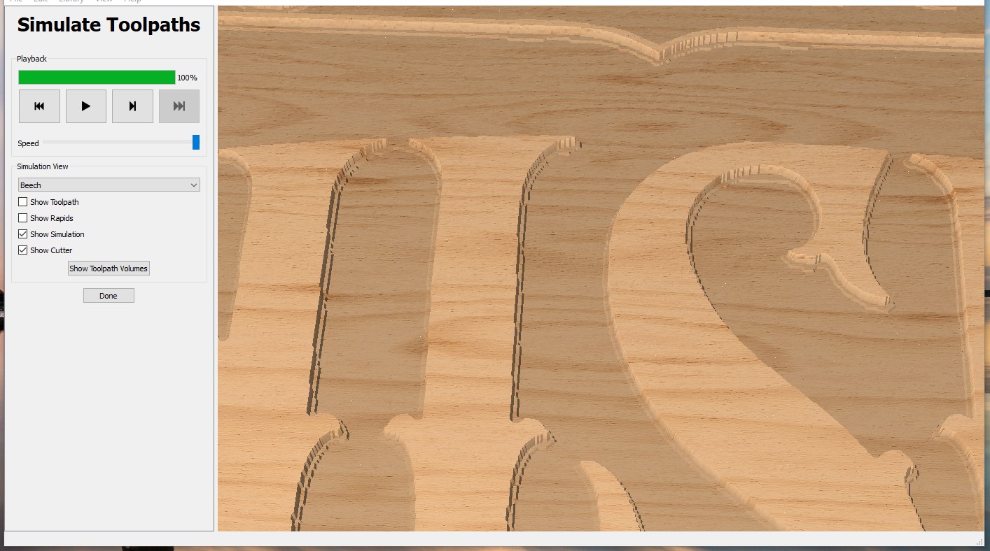

Toolpath marks showing
I made a sign and chose the pocket toolpath to remove the material around all of the letters and borders. It has some intricate parts so I started with a 1/4 inch downcut bit to remove as much material as possible, set the stepover to 2mm to try and minimize the marks then did a rest and cleaned up all of the details with a 1/16 downcut bit and it all worked other than the toolmarks left and the ability to get into all those nooks and crannies is impossible with any kind of sanding.
I have watched some videos on creating another toolpath where you set it to just go with the grain and it basically removes almost everything. I think it’s called a “raster” cut but I cannot find what that is in Carbide Create Pro.
Any help on this would be great. The toolpaths really show when I paint it, and I can’t give them to people looking like that.

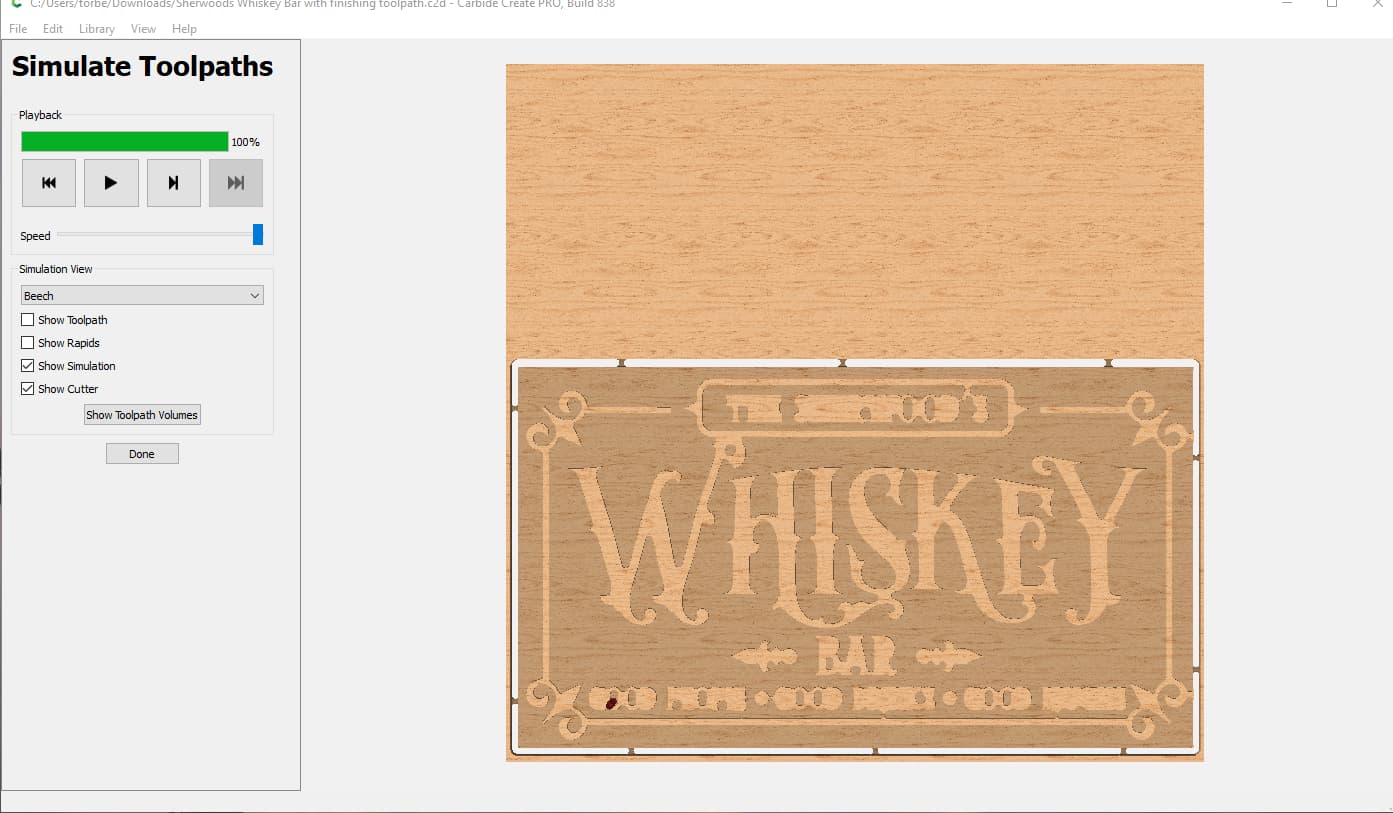

You’ll see I selected the exact same layer as you did for the toolpaths and used a pocket toolpath to create the final carve. I only went .01 mm deeper. In theory, this should run that same toolpath as before and just skim the surface clean. You might need to take it another fraction of a mm more if it only takes a little bit.

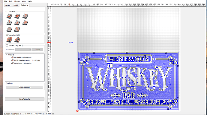

Sherwoods Whiskey Bar with finishing toolpath.c2d (1.8 MB)
Thank you for looking at this, so how do I get the detail back on this? Do I add back the REST toolpath to get the definition back in all the lettering?
It wasn’t in the fiie you sent. I would use an advanced v carve with a 30° Vee and a 1/8" end mill. That will give you some SHARP corners.

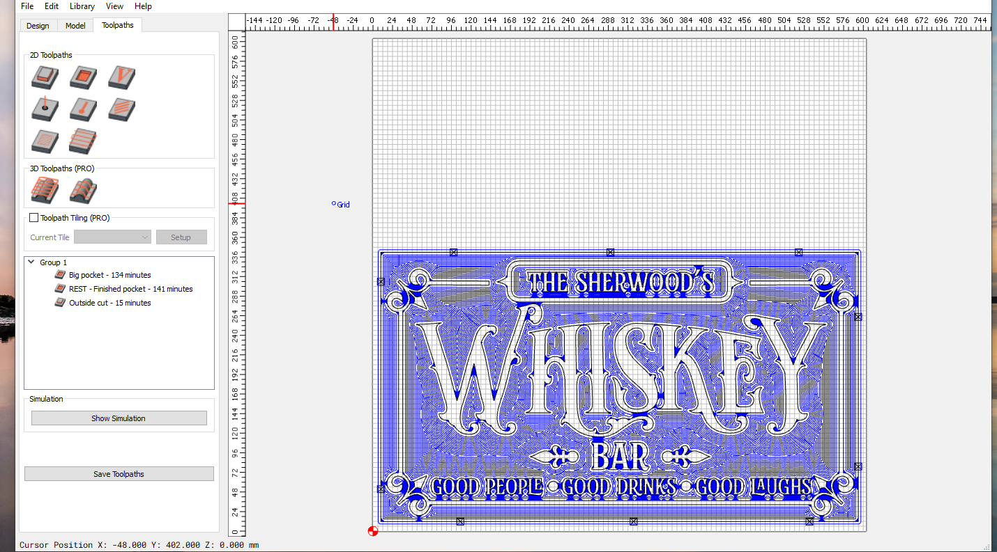

Is this not the file I sent? It has a REST toolpath for the details
Where would I then put that extra path in to just shave off a little and what bit would I use? I was guessing that I would have to use the 1/16 bit in order to do that.

Ah! No. I don’t use pro, only basic. There in lies the difference. Use an advanced v carve instead.
So an advanced vcarve would be for the finishing details after the larger toolpath with the 1/4 in bit?
Do it with the 1/4" bit instead of the pocket tool path. Yes.
