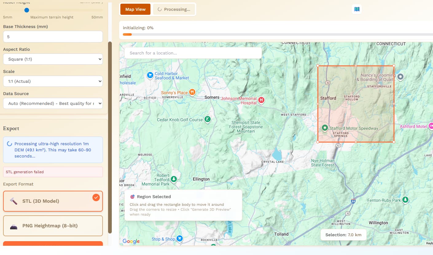

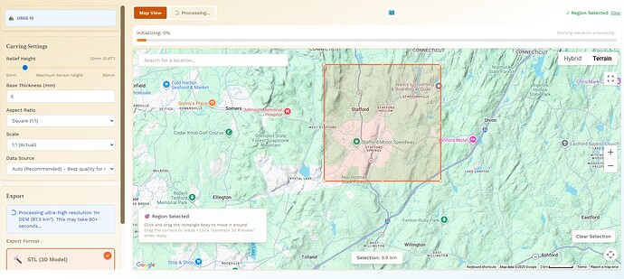

I have a 3 sets of test screen shots, two failures and one success.
I started at 9.9, then 7.0, and then 3.7 km boxes.
Failed
Failed
Success

Win 11, Dell G5 15, nVidia 2070
Graphics set to nVidia gpu

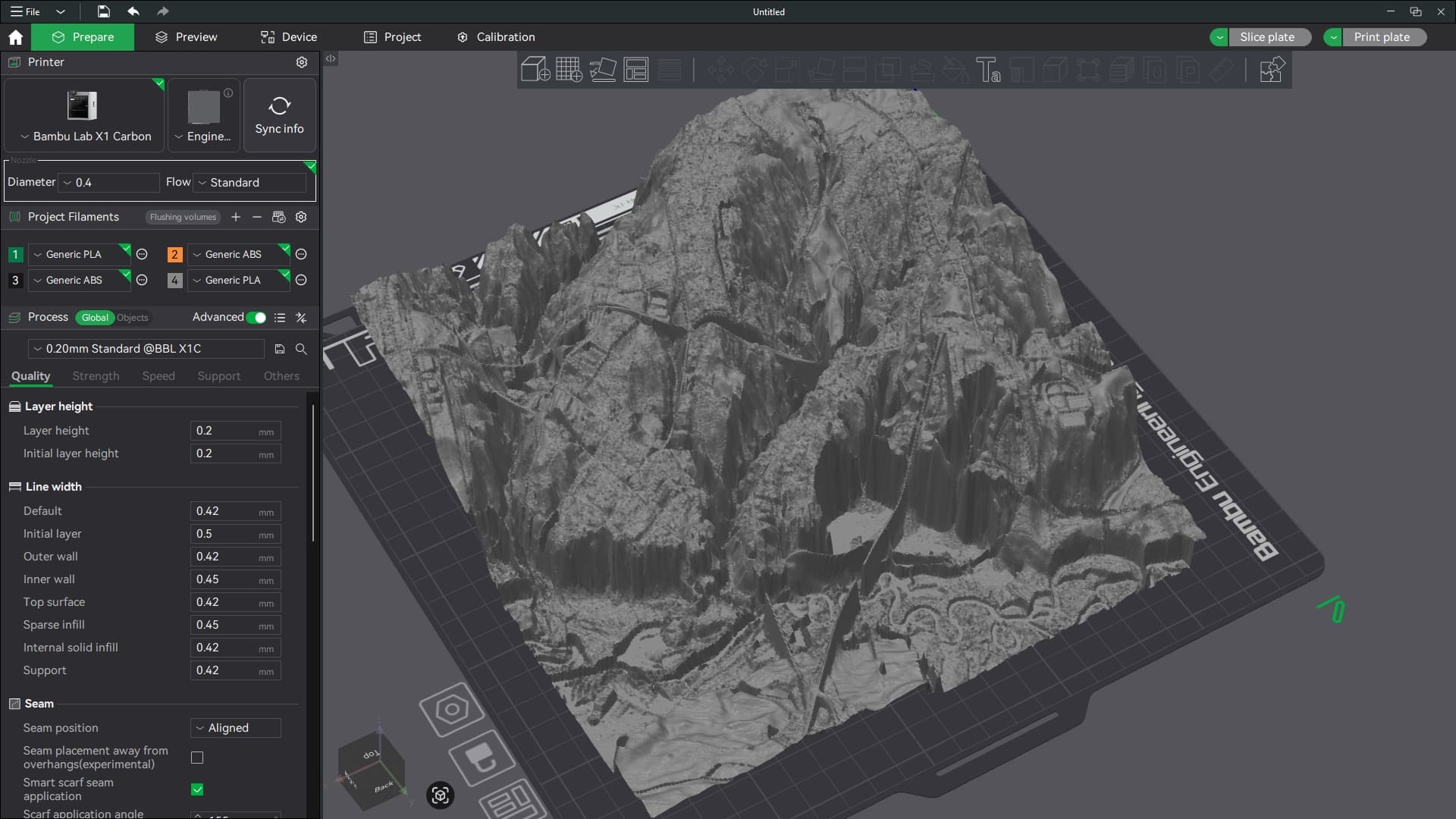

EDIT: Okay, I’ve confirmed that it’s also exporting greatly distorted models. The following are screenshots of an export I did of my hometown, which has maybe 15-20’ of elevation change from one side to the other. The model makes it look like I live in the mountains. lol
Also, there’s no closed base. I chose the 5mm base when I did the export. Did I do something wrong? The overhead view looks great, though! :smiley:

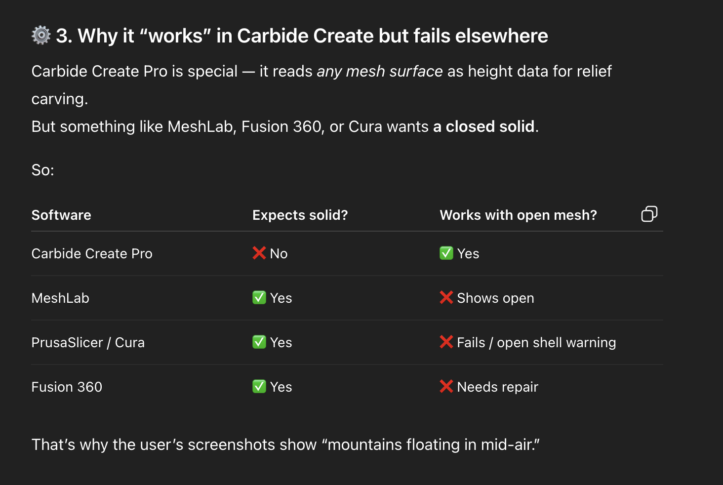

So, you just learned me something… The reason I went with “baselessness” or an “open mesh” for the 3D preview for the 1m data was to attempt to cut down the amount of rendering power needed for these extremely detailed region selections. I was unaware that this actually carried over to some CAD software! I also was not aware that the height settings could be carried over into some CAD software. I have only been testing with Carbide Create. So, in Carbide Create:
  1. Those height settings do literally nothing to my export each time. Or, maybe more accurately (with the golden knowledge you have given me), I thought that the height settings did nothing because Carbide Create probably ignores them and sets a default when you import an STL.
  2. The baselesness is automatically filled in. I had no idea that this wasn’t the case across the board!

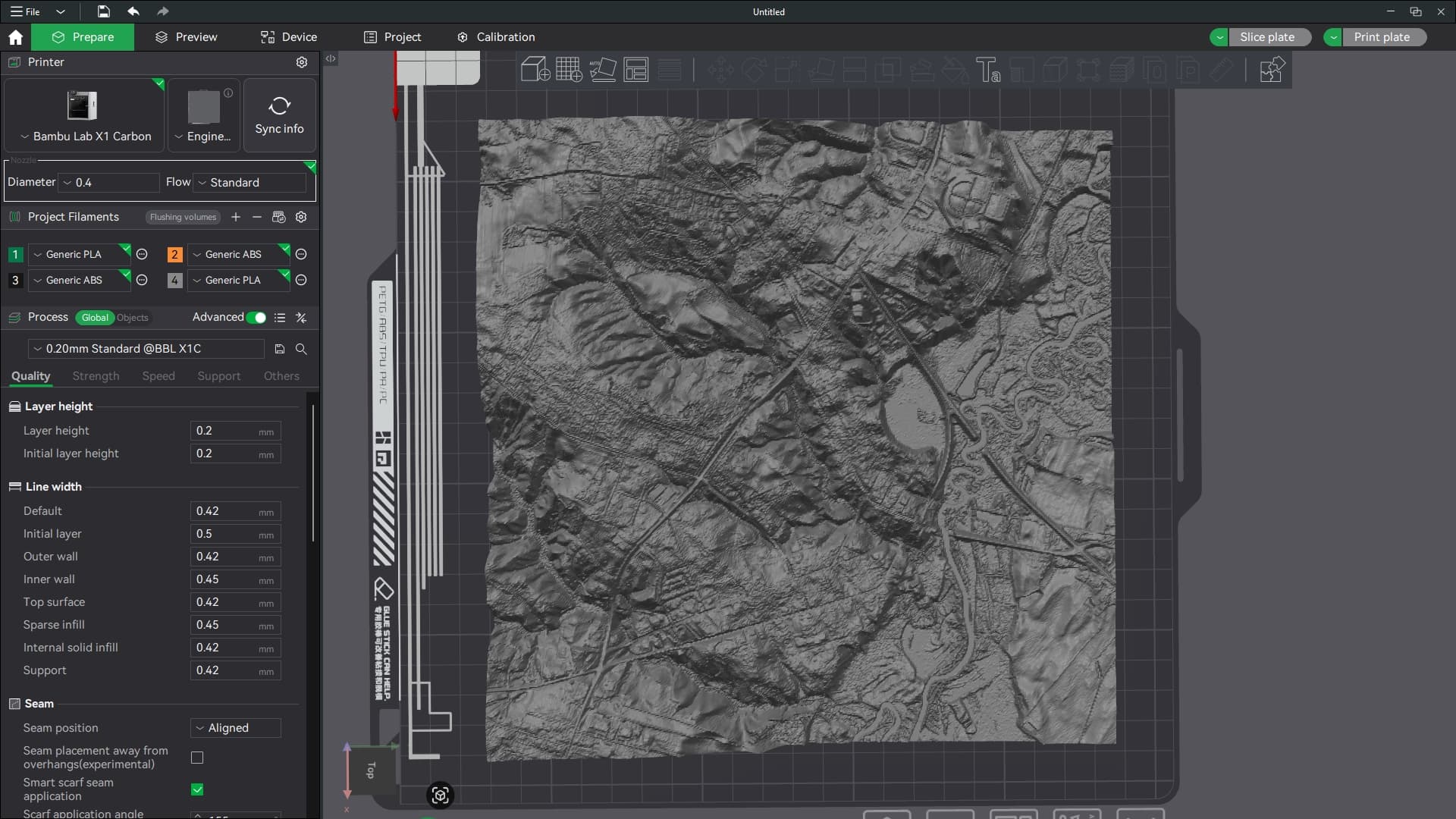

I discovered a couple more things while playing around in Bambu Slicer. BTW, I have no intention of 3D printing this, it just happens to be my default STL handler, and I don’t have CC Pro, so I dropped it in there to see what would happen.
Anyway, I discovered that I can just scale the Z-height to get things back to looking more realistic. It would still be great to have the option to export at “true” elevation (or some multiple thereof), since on occasion you may want to semi-accurately represent the topography of a place. I have a local area in mind that might like to have a custom carved model of their geographic feature, but they would immediately notice (and take issue) if it wasn’t at least reasonably to scale.
Also, thank you for explaining about the thin-sheet exporting and why I’m not seeing a solid model. That makes perfect sense, given the intended use case. I’m sure I’d be able to make it work without too much trouble when carving (I’m using Aspire). I think this was just an anomaly due to being imported into a slicer that was expecting a solid model.

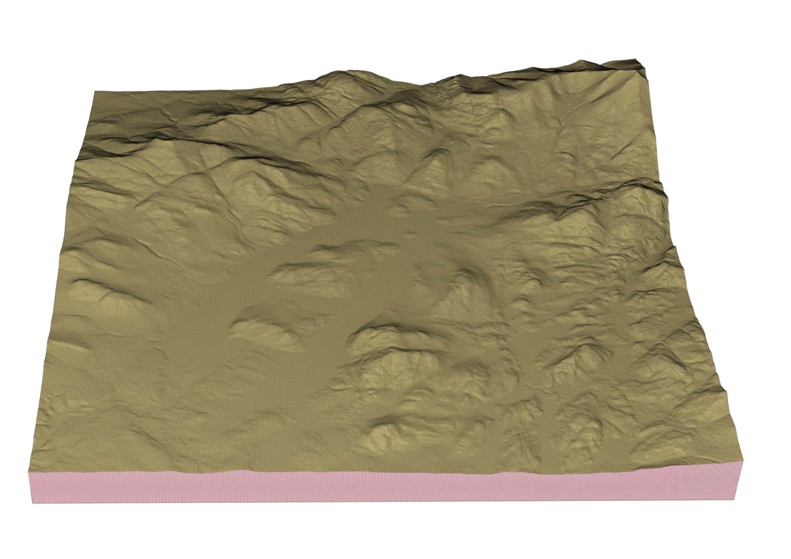

I am assuming that if I do not touch the relief height control, the Z height is the actual scale ?
The preview heights seem exaggerated versus the Fusion import heights.
Thanks, Jim

To confirm the Relief slider usage and values.
I am assuming that if I do not touch the slider after the preview, then the Z height output scaling is 1:1 . It seems that way, but I wanted to confirm
Edit: Just re looking at the two images I noticed the base height is also exaggerated.
To me that means your data is ok, just a scalar along the way.
Good Luck !

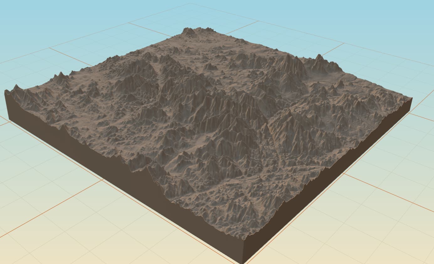

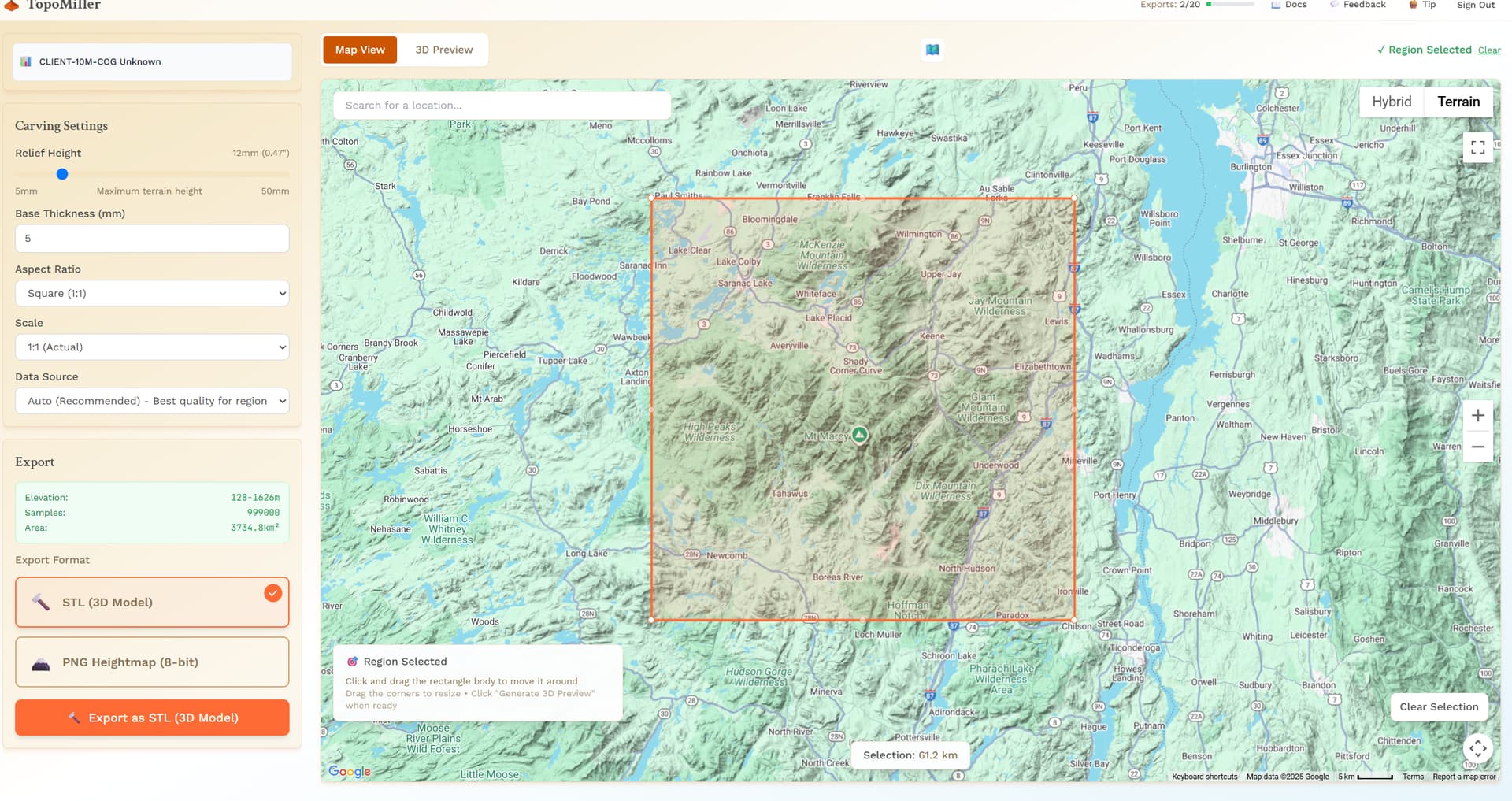

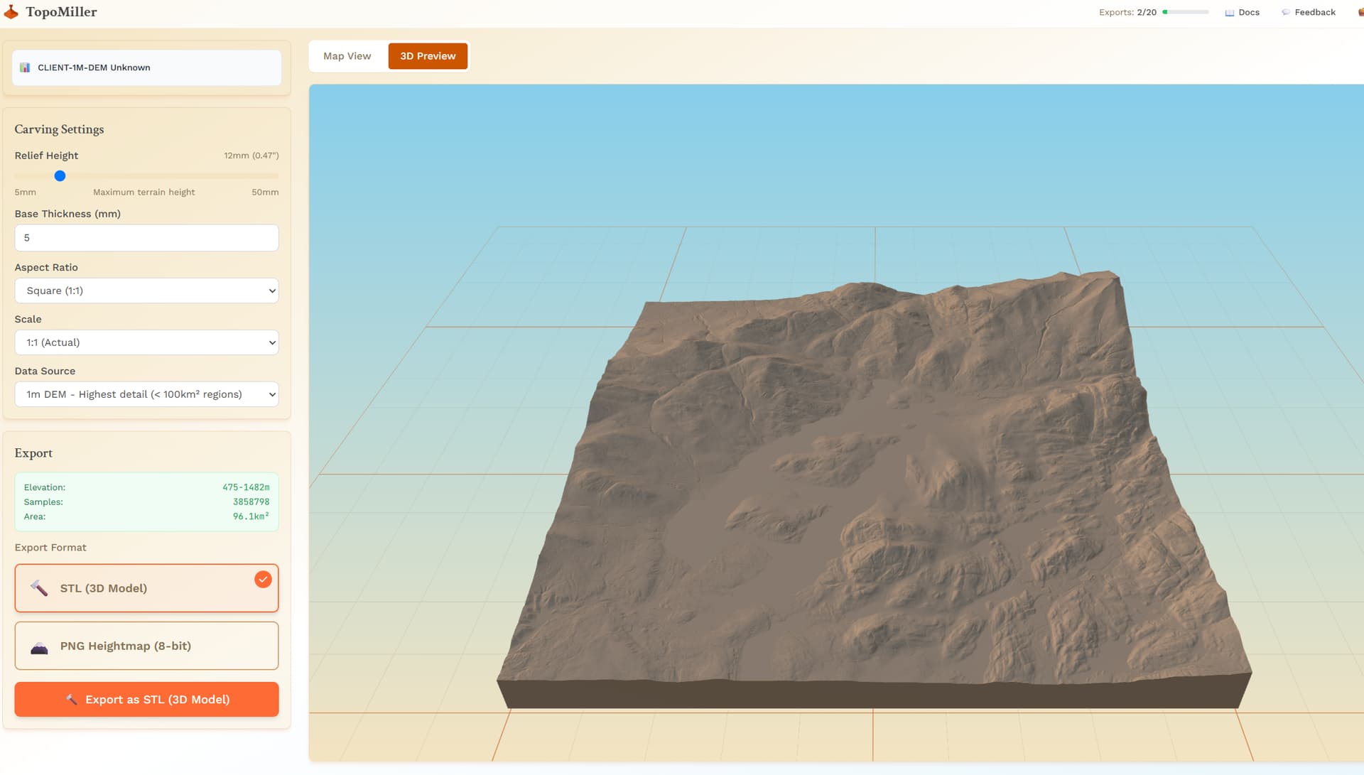

Here you go. The subject matter is Lake Placid NY ADK area.
The Preview and the Export are now very similar.
Your changes seemed to alter the Export model, not the Preview display.
The data seems to portray the mountains with very sharp peaks.
Thanks for the effort

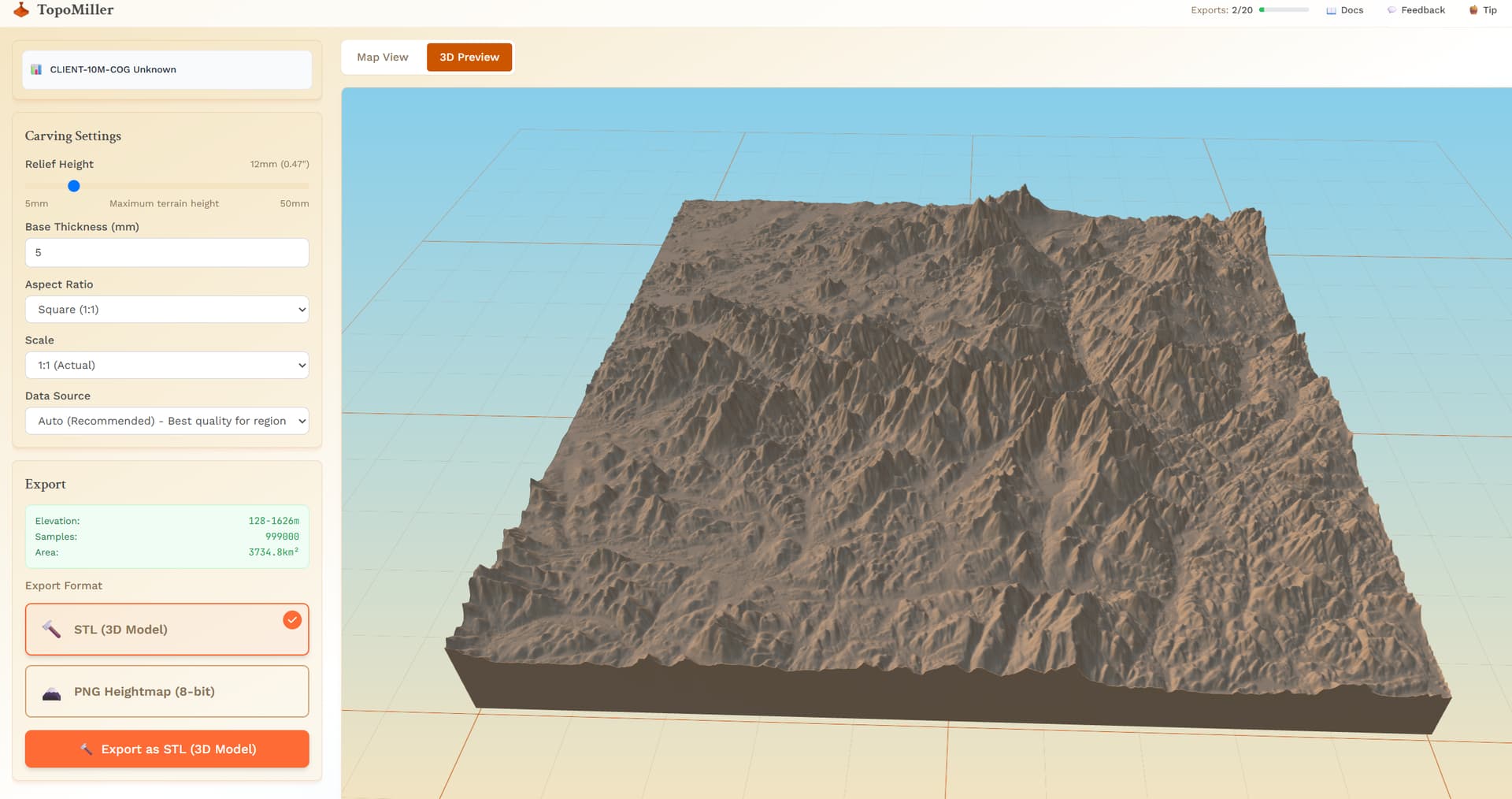

Here is a 1m test. This looks very good.
I would appreciate an explanation of the relief height settings.
I did not touch the default setting in either test.
I would like a “no touch” setting that does not scale the height,
I also noticed that the resulting 1m STL files in Fusion always are 100 inches square and 17 inches tall regardless of the map selection size.
Yes the starting empty Fusion model is using Units of inches.
You must be auto-scaling the results, I would have expects different extents of the STL files.
Just guessing …
I think you are filling a predetermined volume and the scale is changing based on the selection size. I would rather a fixed distance between each data point and let the extents float as needed.
