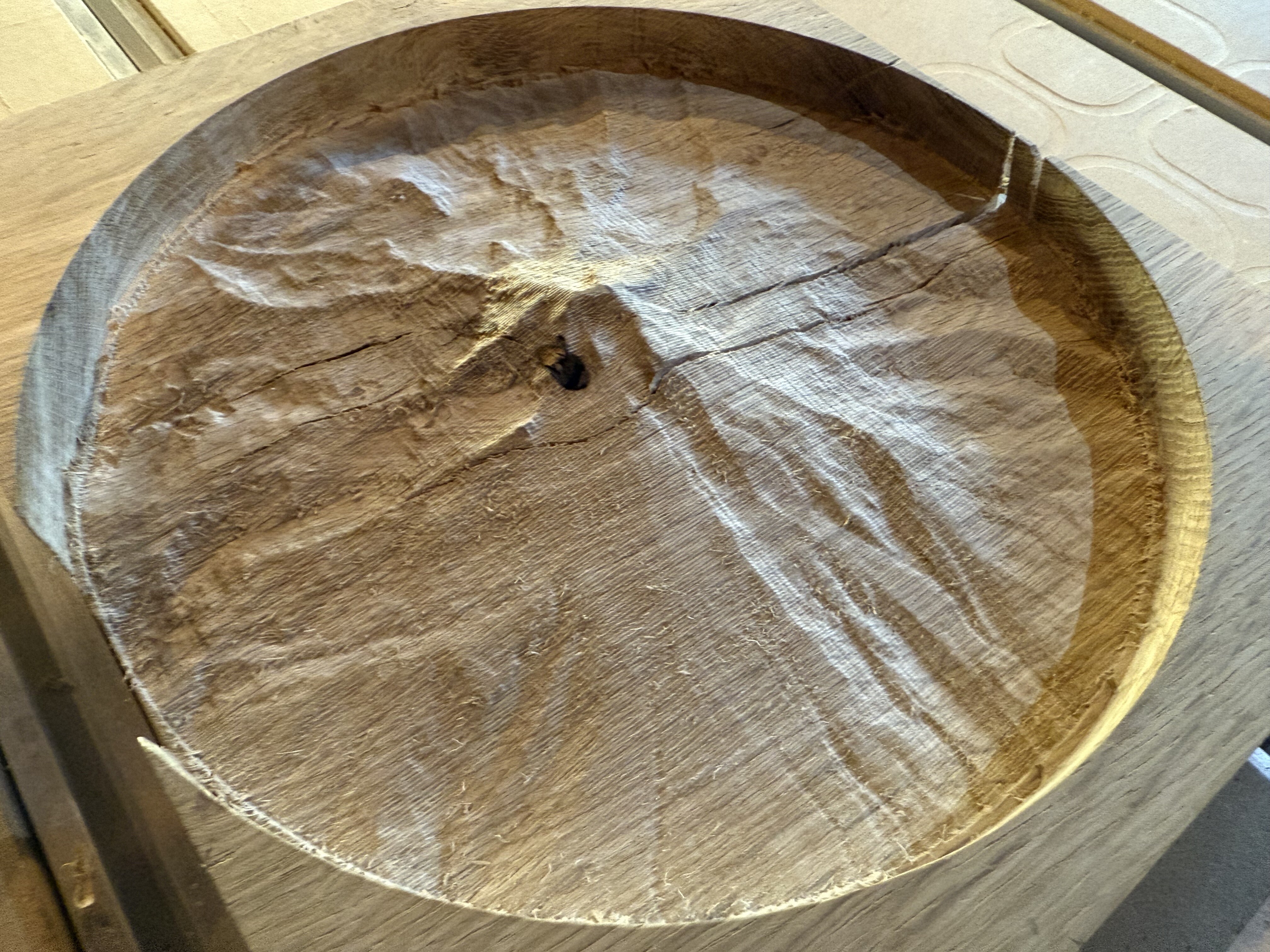

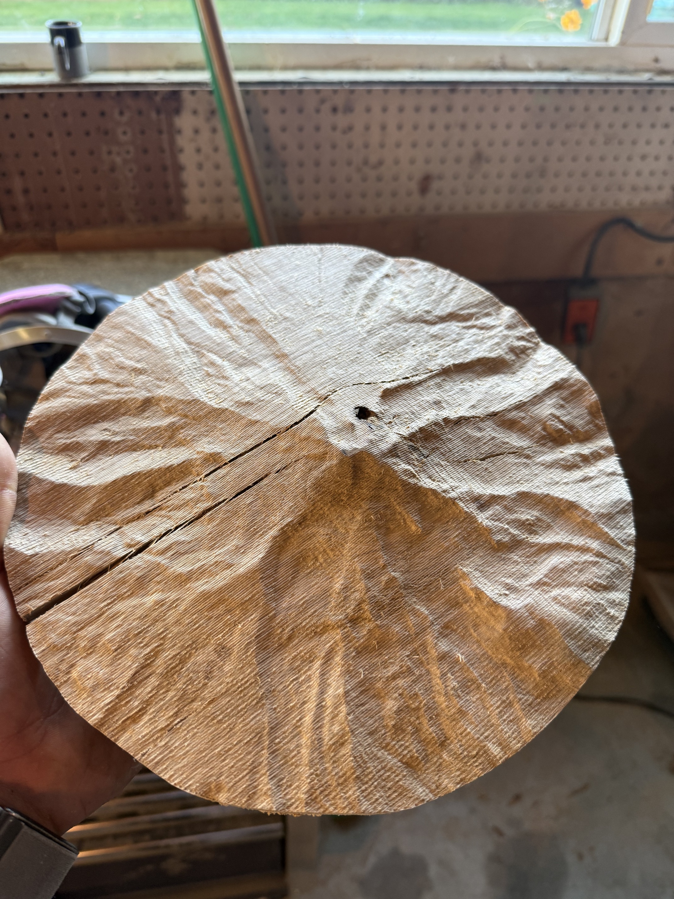

I gave Mt. Hood in Oregon a try today.
Turned out pretty good for a first run in white oak!
This program is rad Mitch!

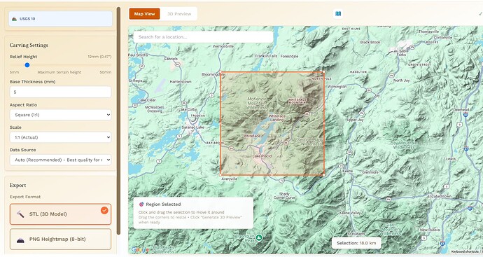

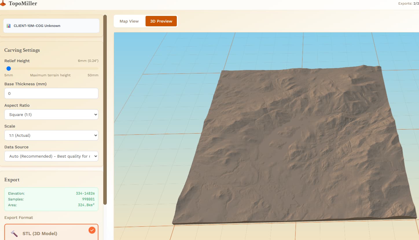

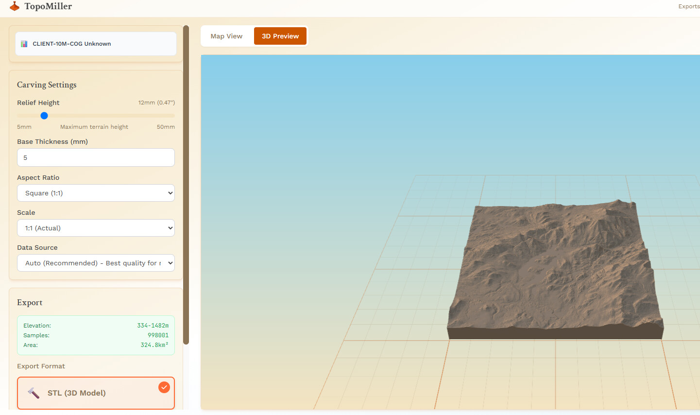

The program is freaking awesome with the simple interface and quality of results, except for the gyrations needs to produce accurate Z heights.
So I did some testing last night to find a solution for correct Z height values.

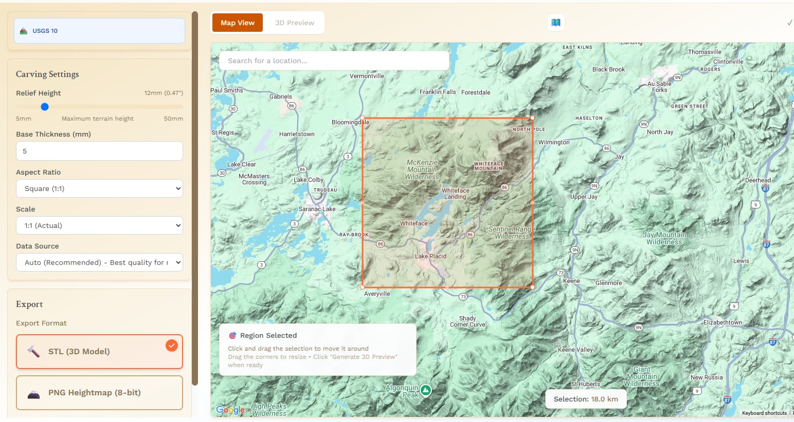

The export files are 100 units x 100 units regardless of the selection size.
As an example I assumed the export units to be mm.
If I selected a 18 km square then you have 18000000 mm of model space to 100 mm of export file space.
100 / 18000000 = 5.5555555555555555555555555555556e-6 ( scale factor ).
The elevation range is noted after preview generation.
My example was 1148 m of elevation change in the model.
That becomes 6.3777777777777777777777777777778 mm of height on a 100 mm x 100 mm export model. The slider in the Topomiller interface only allows integer values, so I can’t use the exact scale factor.
The minimum limit of 5 mm means selections with lesser elevation ranges ( boring ) can not be exported with accurate Z heights.

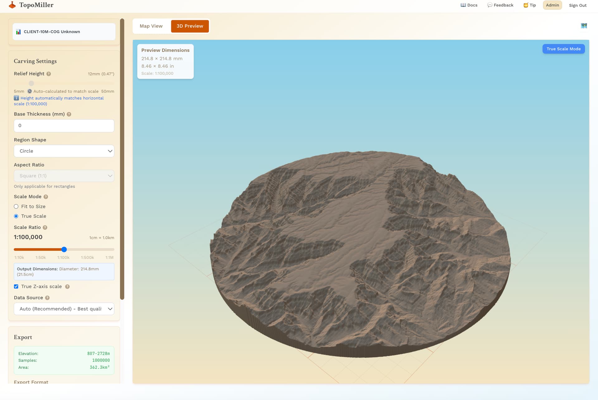

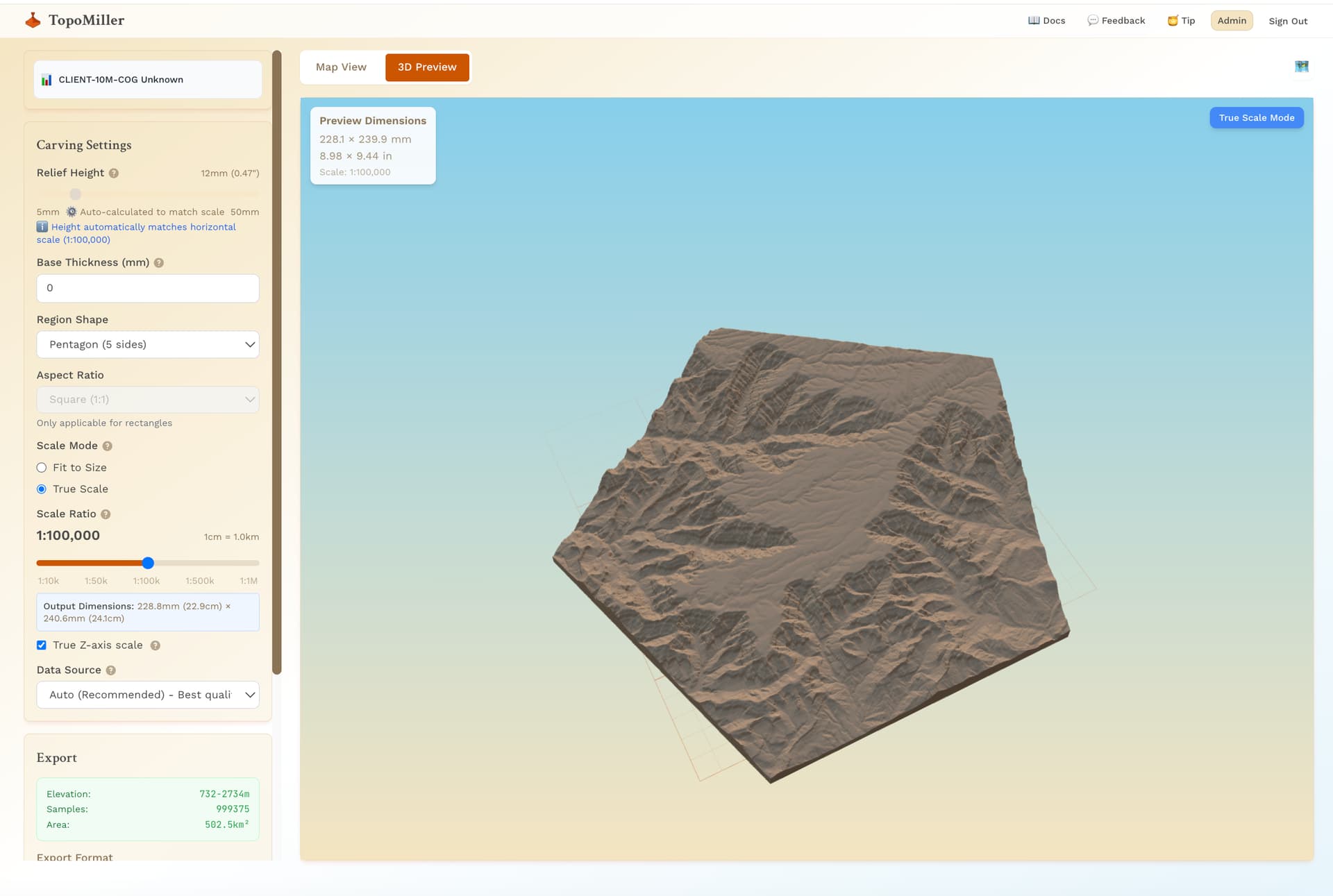

I’m excited to announce a couple of new features that are live:
  1. True Scale and Fit-to-Size - Before, you basically had one scale, and it wasn’t correct to the true elevation topography because everything was basically being squeezed or expanded into 100mm. Now, you have the choice of getting the true scale of the landscape, or fitting it to a specific size (like your cutting bed).

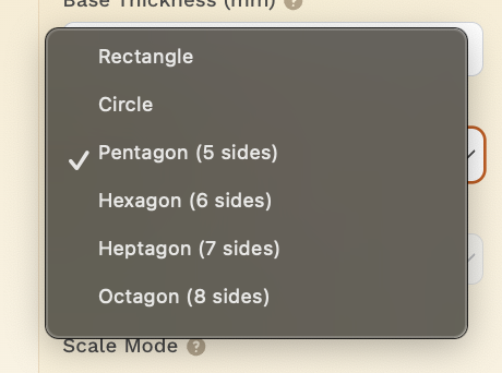

  2. New Region Shapes! - Before, you could only work with squares and rectangles. We have added circles and polygons. The points of the polygon can be manipulated to accommodate any weird shape you’re looking for, for the most part.
  3. Smart Processing: If you are on a computer that has 8GB or RAM or less, we are offloading computing to our servers, preventing the occasional browser crash that was happening
Hope this is helpful. Enjoy and let me know your feedback!

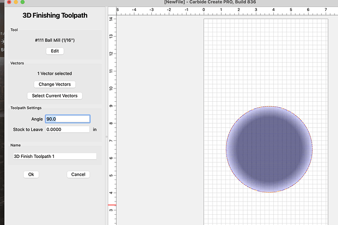

A way to reduce tooling marks in any relief carving is to do 2 finishing passes at about 10% step over and no clearance. The first pass should be across the wood grain and the second parallel to the grain.
Is this possible using Carbide Motion? If so, how do you program the second passes direction in create?
I’m not a Carbide Motion user I’m afraid. But I would have thought it is relatively easy to change the direction of a tool path
Add a second finishing tool path and change the angle in the Toolpath Settings Angle field.
