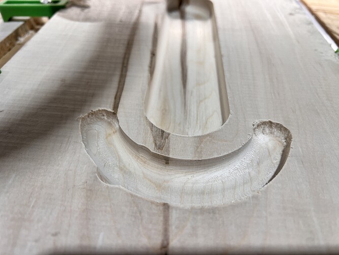

Can someone help look at this file and let me know where I went wrong.
Scenario:
  1. I was cutting maple and the 3/4" bowlbit stopped spinning in the corners. Inside went great. Could be smoother finish but was ok.
  2. The outer inner pass was fine.
  3. Outer finishing pass. FAILURE! ALARMS! HELP! DID I BREAK MY SPINDLE!? It plunged WAY too deep (I seem to have issues with this - I went for dinner and paused it on outer finish, came back and it dug in way too deep - like 0.4" or so. Did I go too tight? Freaking out thinking I broke the machine!
NOTE: Corner in Carbide Create is funky, I can see it is not just going nicely in one pass around which I’d prefer but “left right left right” iso just around and around… Cant fix this in the program.
Any help appreciated. Ended up just cutting the middle out with a 1/4" endmill and the “bumping/stopping” of bowlbit was so rough it actually moved the piece to the right a bit so one big failure. Just hope machine is oke!

If the cutter stopped spinning and the router/spindle kept turning that sounds like the collet wasn’t tight enough.
It’s always good to tighten the collet nut with two wrenches. One on the shaft and one on the collet nut.
The cutter might have been pulled out from the collet when it stopped spinning. Using a sharpie to mark the cutter at the collet nut will give a visual if the cutter is being pulled out.
This might be from to much depth of cut / to fast of feed rate/ wrong rpm for that particular cutter.
Using scrap wood to make practice cuts with the bowl bit will help you to find the sweet spot (DOC/ Feed/ RPM) for that particular cutter.
I always start on the conservative side then increase things depending on how it’s cutting.

Nope - no bueno. It’s that strange tool path at the outer ring causing me issues. See pics. The strange thing is that that ring goes deeper than the rest of the path.
Further, it does it twice. It gauges / bites down and then retracts and does the circular motion I am looking for around the inner “bowl” retracting the height.
This is how it starts just biting away the round edge. Little cuts is the ramping as now downloaded the Pro version to trial.
Here you see path goes around and the surface that bit out prior stays deeper
Here you see it retracted and is now doing the circular cut.

Hi Marleen, I’m taking a guess of the problem. It looks like the wood that your using is not flat to the table surface. I see the clamps you have placed holding it down but there is a big gap. You could try adding shims under you work piece. Every time the cutter goes across the turn it my be teetering down and shifting the path of the cutter.
It would be best to face the piece’s top and bottom. This significant gap highlighted in yellow is an issue.
