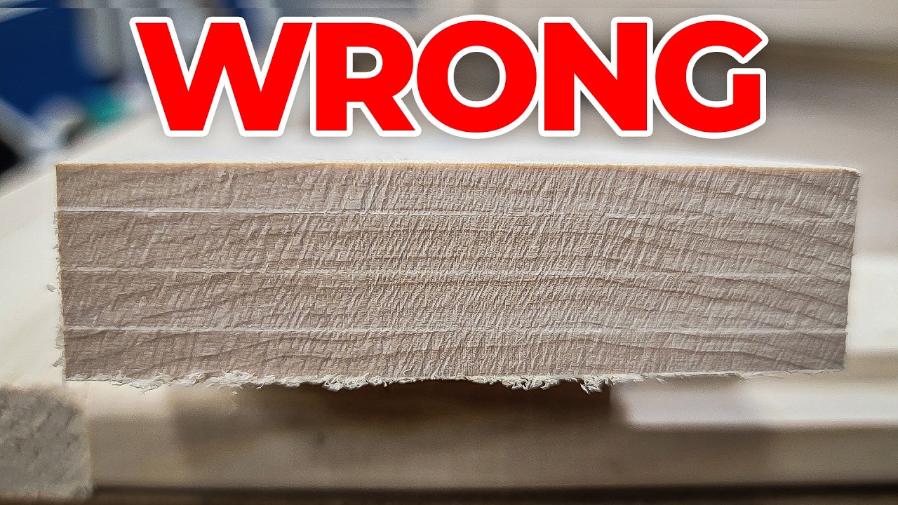

Did a quick rectangle contour cutout today on some poplar and had some tool marks on the top side only:
3 sides the cut was smooth and humming but when it would turn the corner on the back edge it would screech and you can see the tooling marks.
Not a big deal but I’d love some ideas on what may have caused that specific side to give the cut trouble.

Looks like it was bouncing off the material. Was it a full depth cut ?

I saw a youtube video just last night about this subject. The explanation was about the lines are actually a couple of things. Tool deflection, wood fiber tearing and tool run out.

It would help to know more details about your cut. Settings, endmill choice, and also what machine you have.

It was cut on Shapeoko 5 with 65mm VFD, workholding with tape + CA glue
1/4" downcut endmill, 2 flute, 1.25" cutting length
Cutting through 3/4" stock
Depth per pass: 0.130
Feed rate: 70.2
RPM: 19860
Good info so far guys will look into implementing. Let me know if something egregiously wrong with my parameters!

I like Will’s strategy of roughing a pocket leaving finish stock, then a full depth finish pass climb cutting to the nominal size.
However, the “depth first” pocket bug on narrow pockets prevents this from being as effective as it could be. You’re just wasting time on the 2nd pass for the pocket.
I would just offset the vectors by the 0.030" recommended in the video, and cut a slot with normal depth of cut, then cut the nominal vector with a full depth climb cutting pass.

Thanks for the feedback guys. A finishing pass at full depth of cut cleaned up all the noise along the sides.
