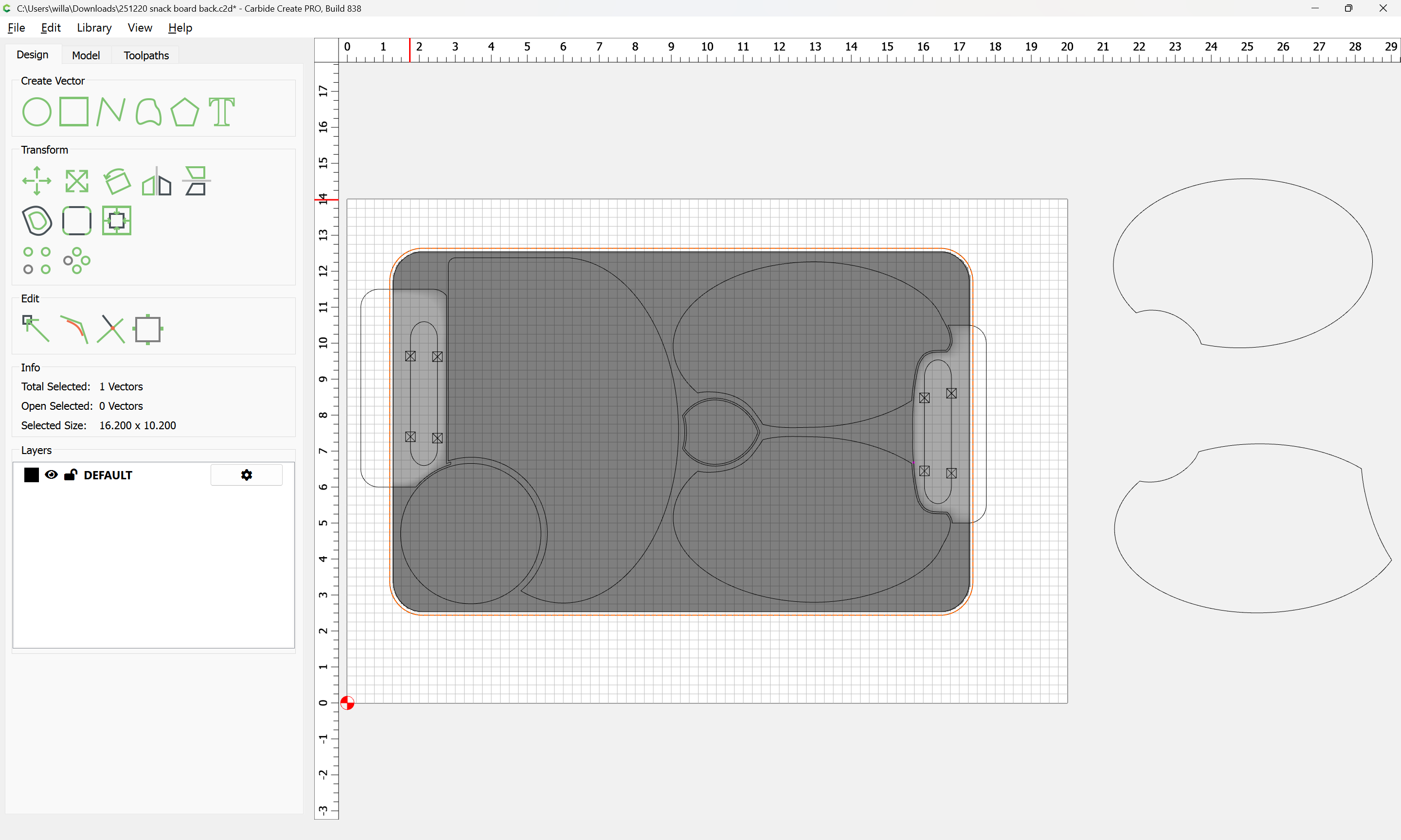

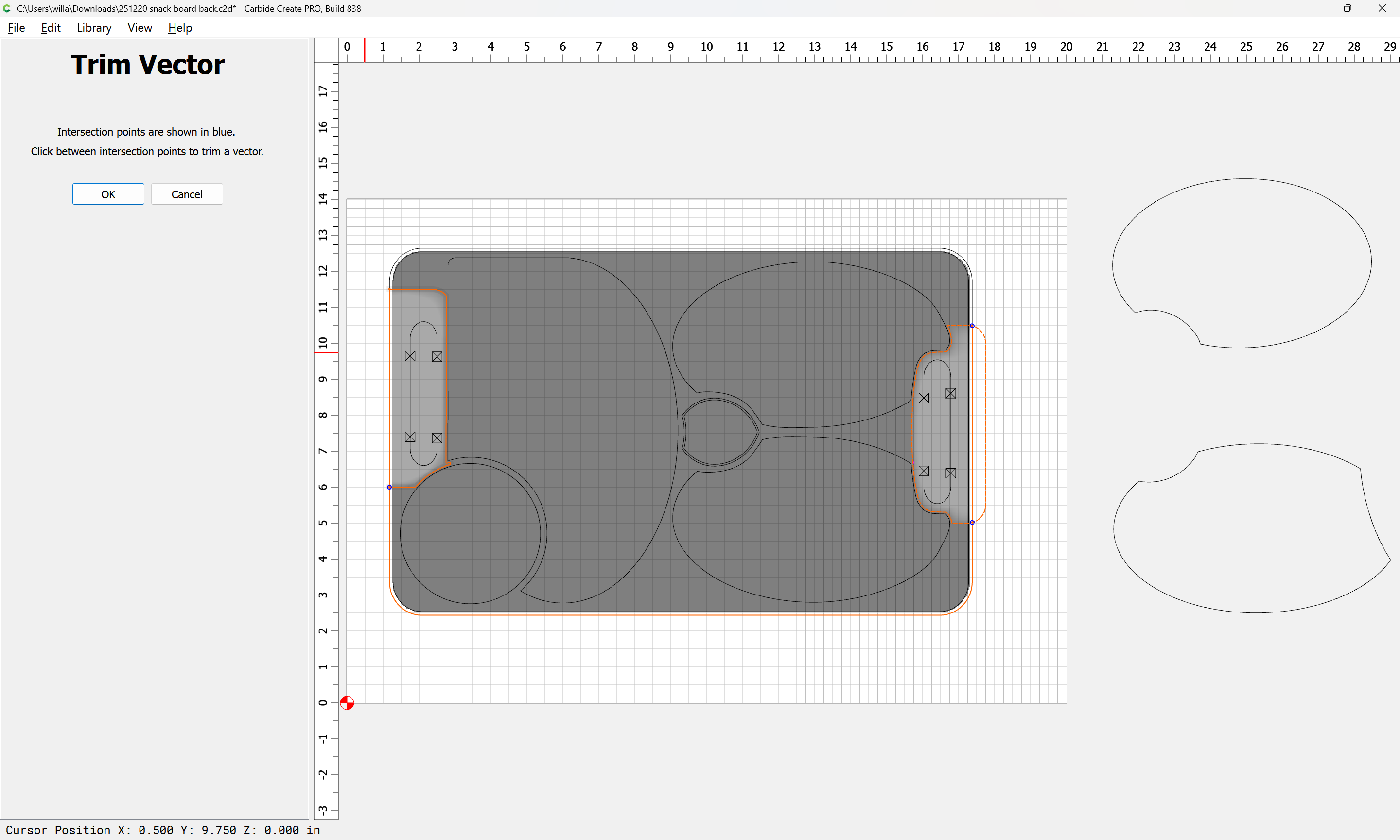

i may described not so clear. i had made a file to show what i really want. but not sure how to not cutting the part outside of the board? it will cutting air and wasting time.
thanks.

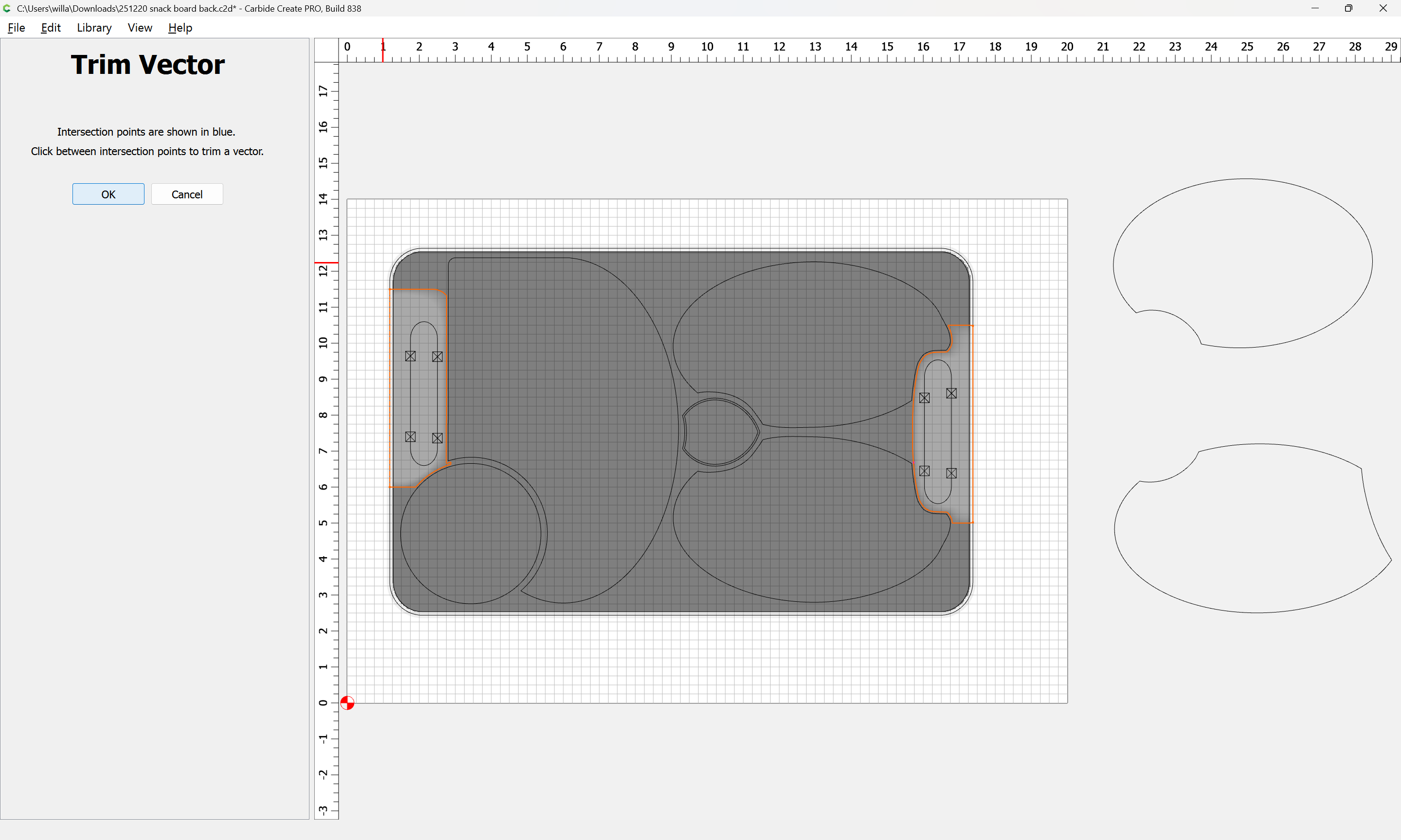

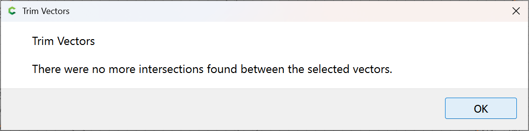

Select the perimeter:

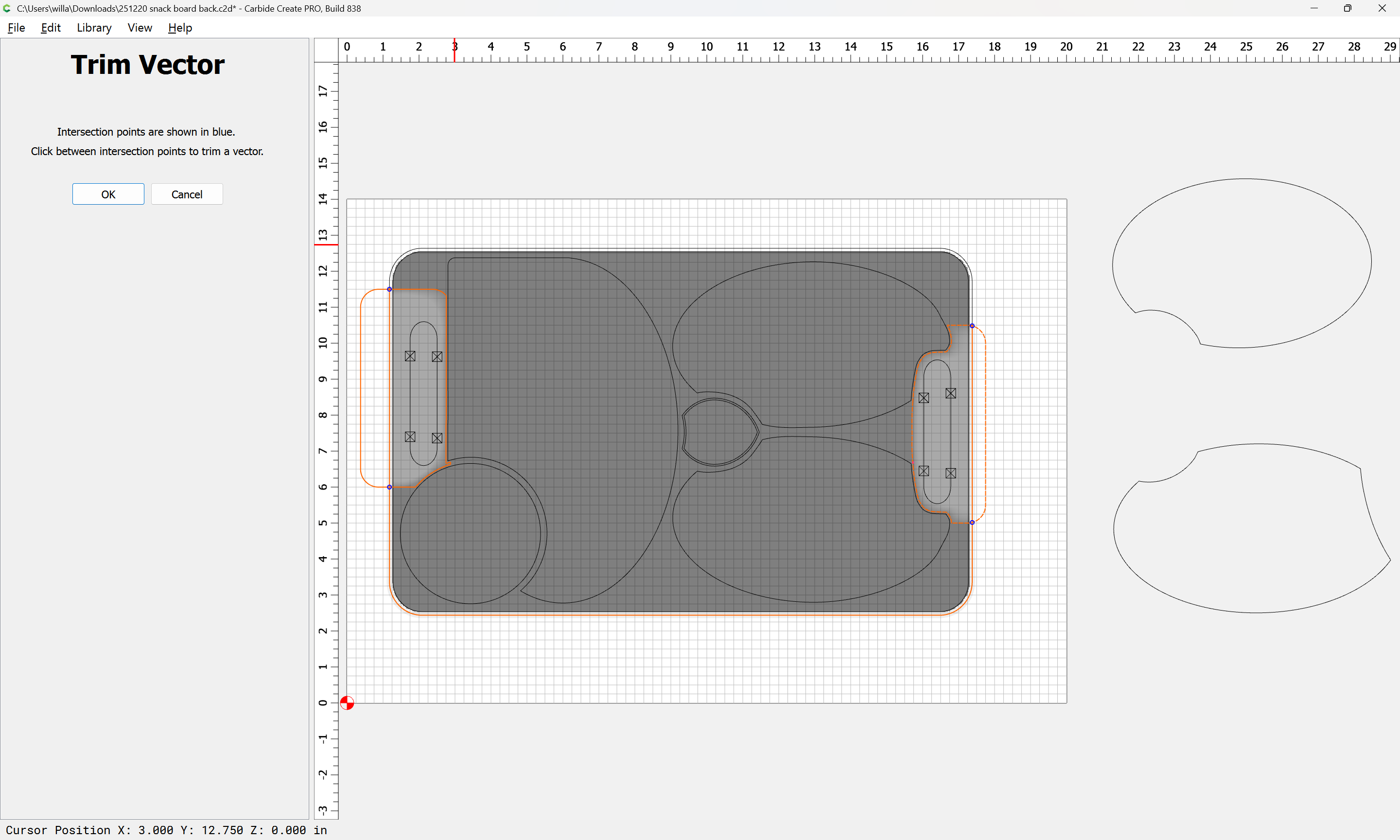

and duplicate it:

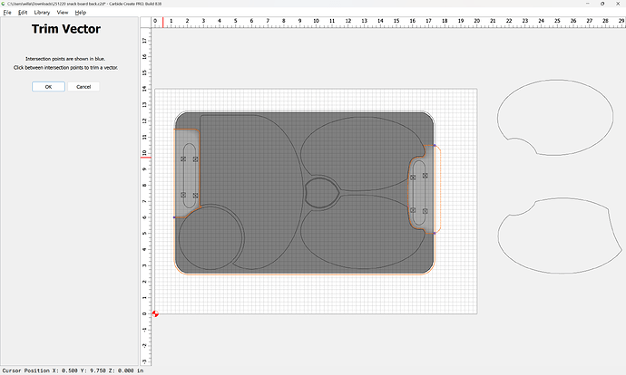

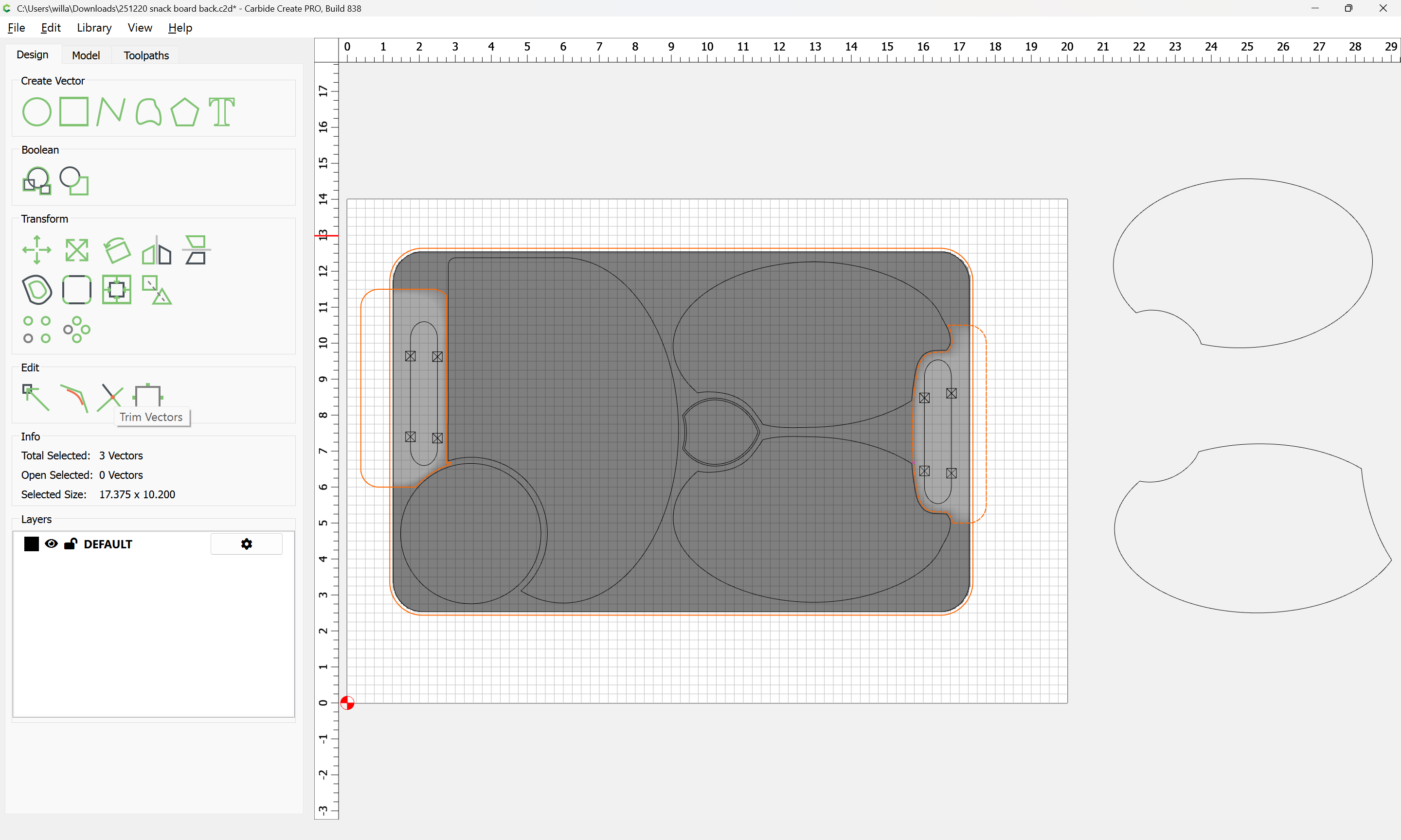

Then select the shapes which define where you wish to cut:
and use Trim Vectors to reduce to what you want:

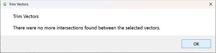

until one arrives at:
OK
OK

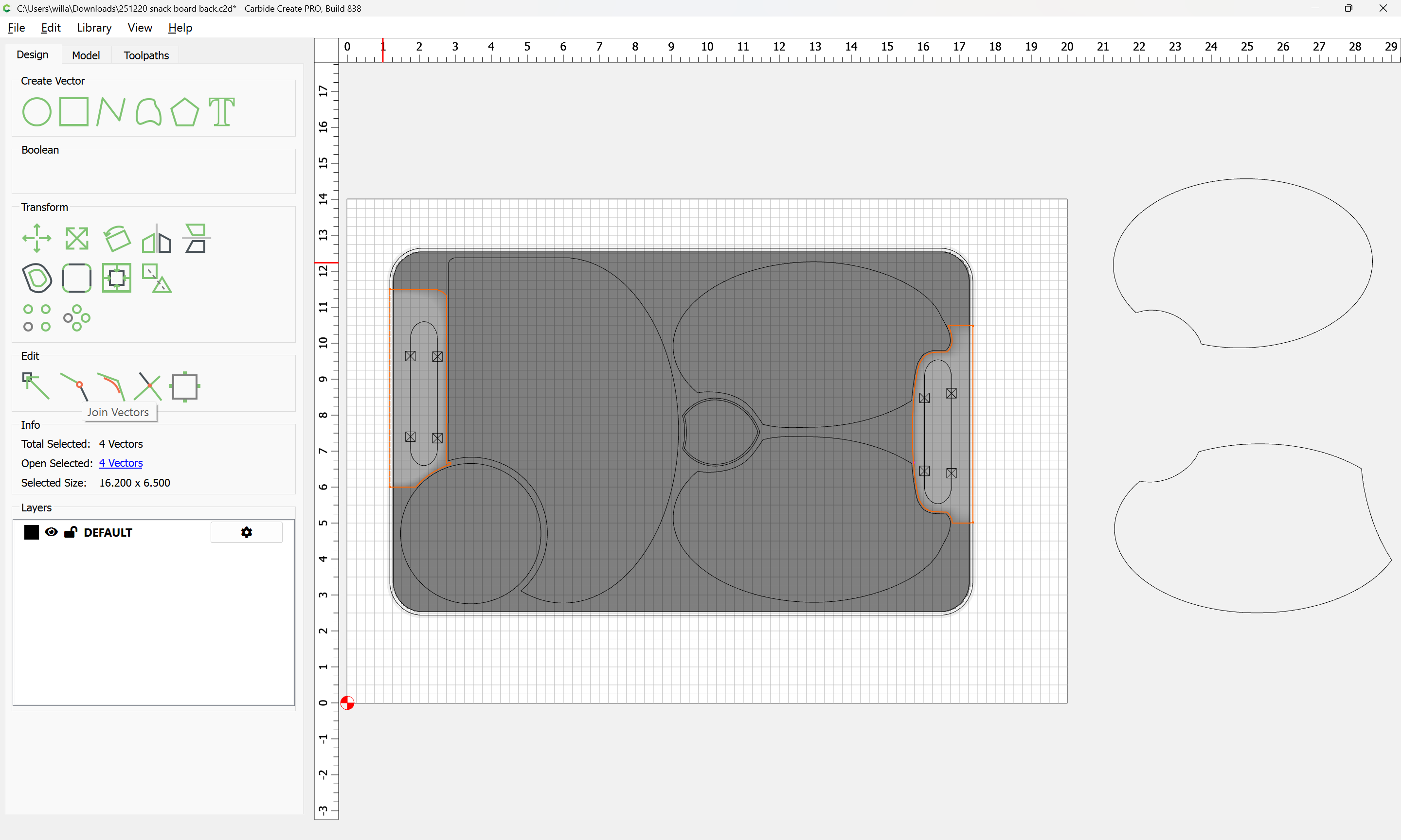

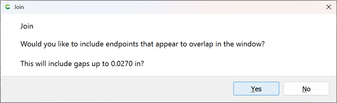

Use Join Vectors to close things:
Yes

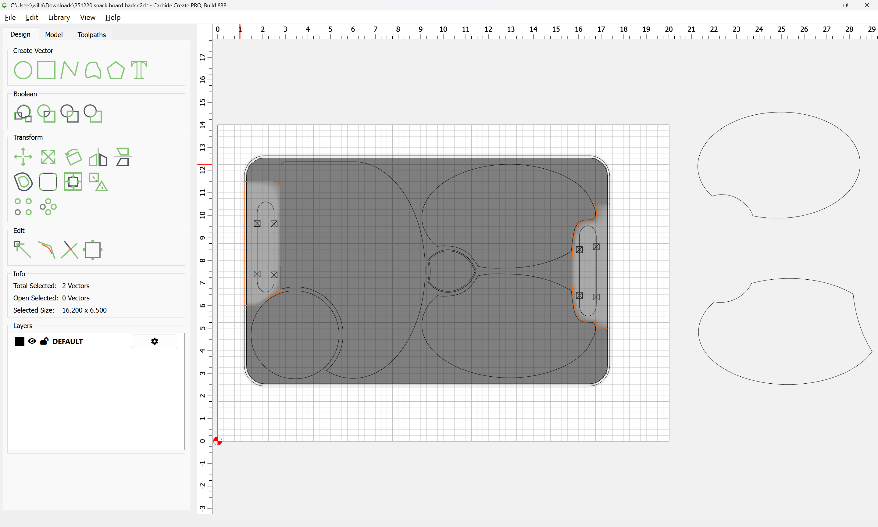

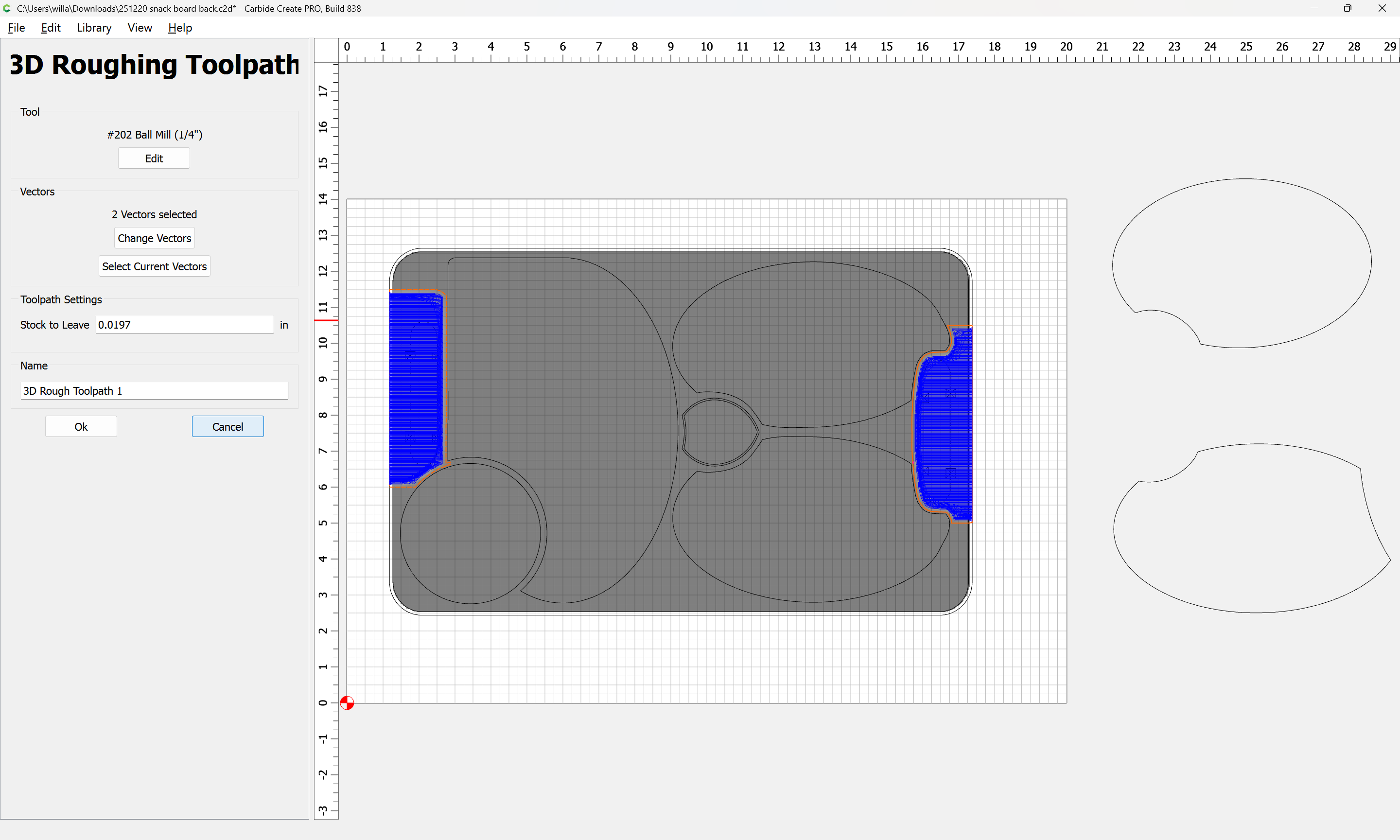

Then use this new geometry for a 3D toolpath:
