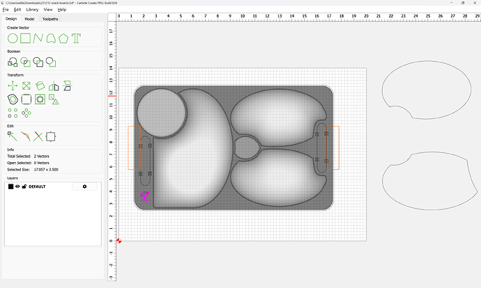

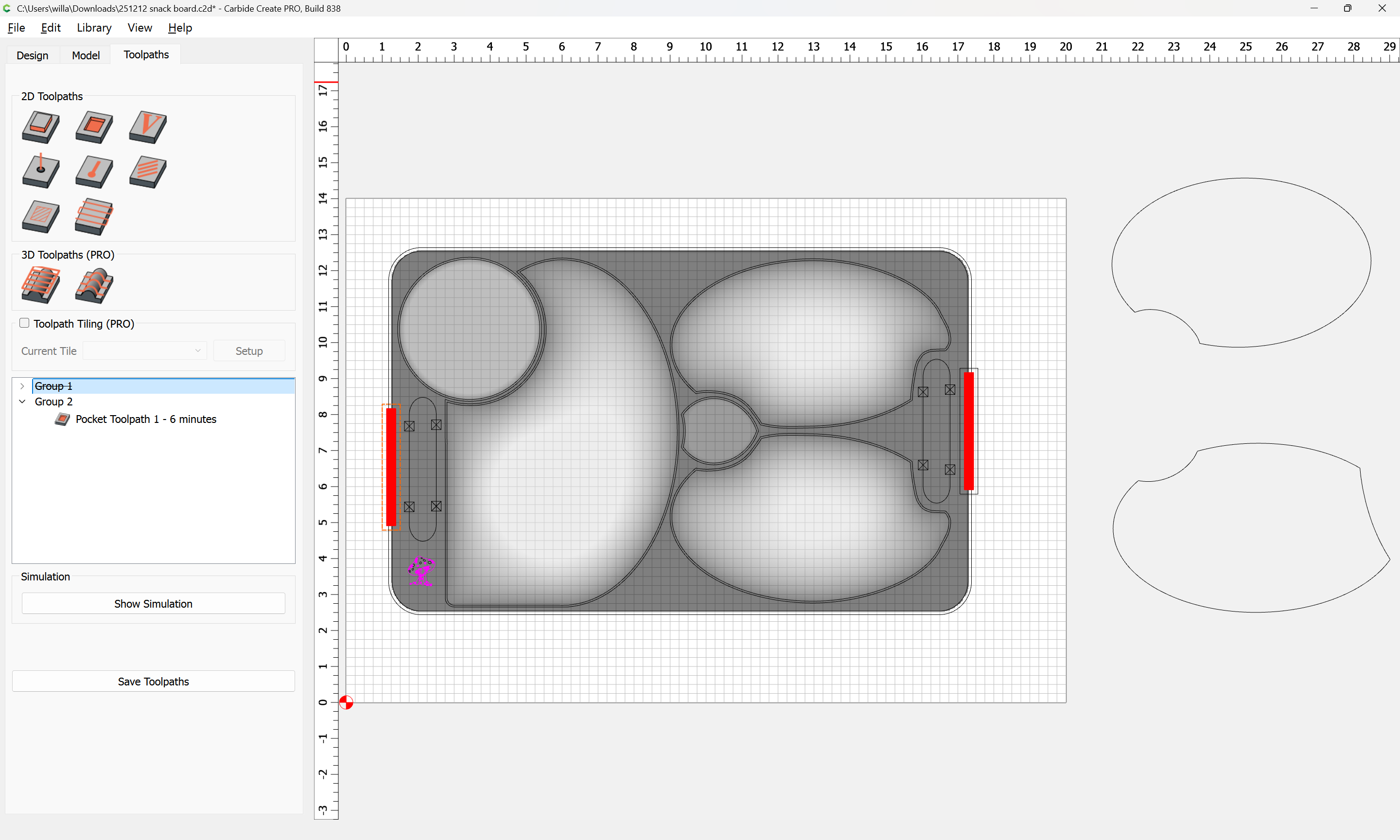

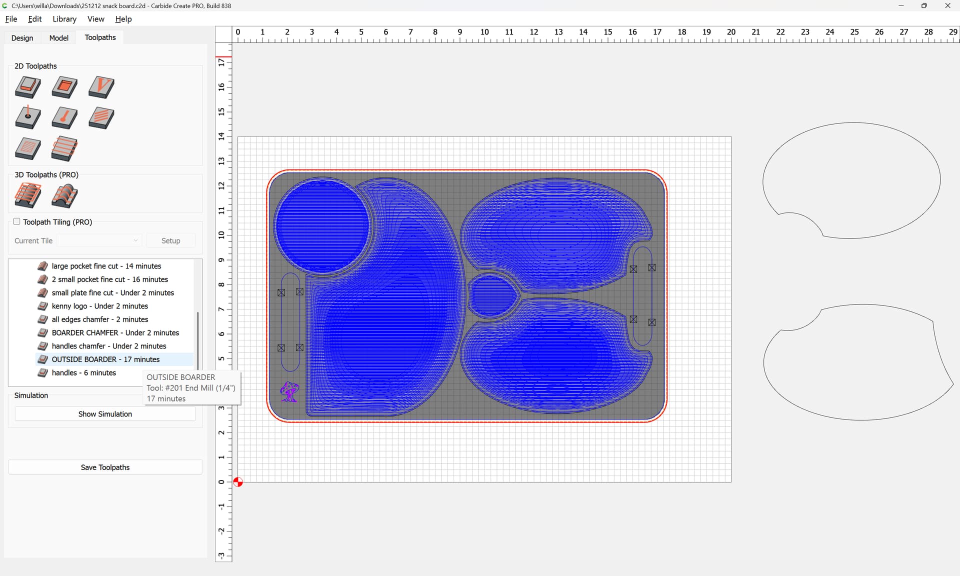

You should cut out the handles before the outside boarder:
A #201 endmill does not have 1.5" of cutting flute length:
you’ll need a "long reach endmill for that, and you really should consider Climb vs. Conventional Milling and tooling engagement — where possible avoid slotting and add geometry and cut as a pocket

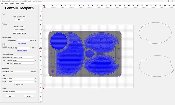

One which has a cutting flute length equal to or greater than the thickness of the stock — pretty much any tool should work.

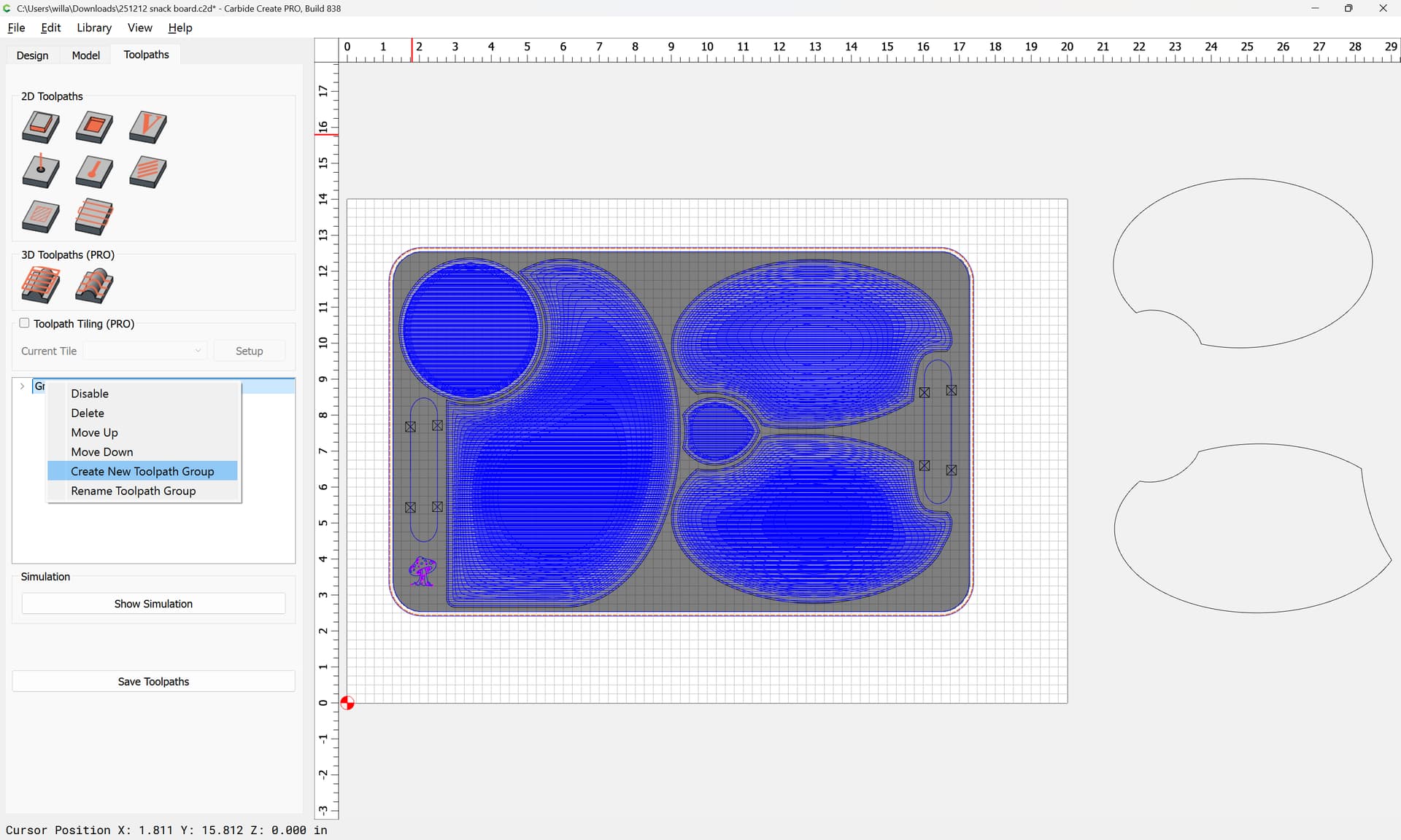

Big thing is the toolpaths — if cutting out, rather than just cutting a slot:
[image]
Offset to the outside by endmill diameter plus 10% or so:

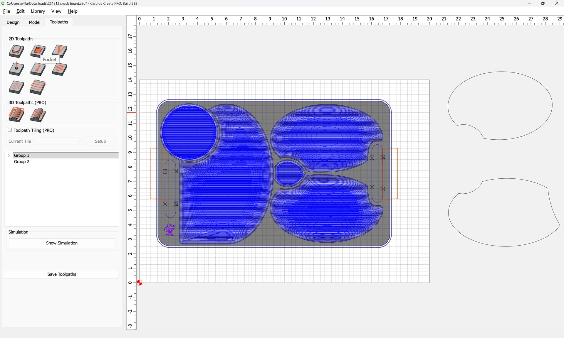

[image]
[image]
[image]

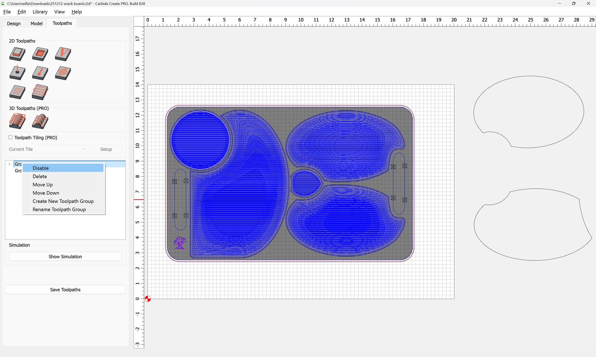

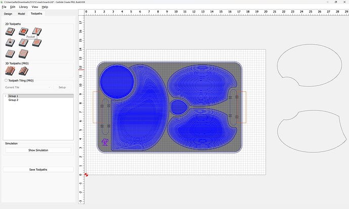

Then cut as a pocket:
[image]
down to tab height or the penultimate pass:
[image]

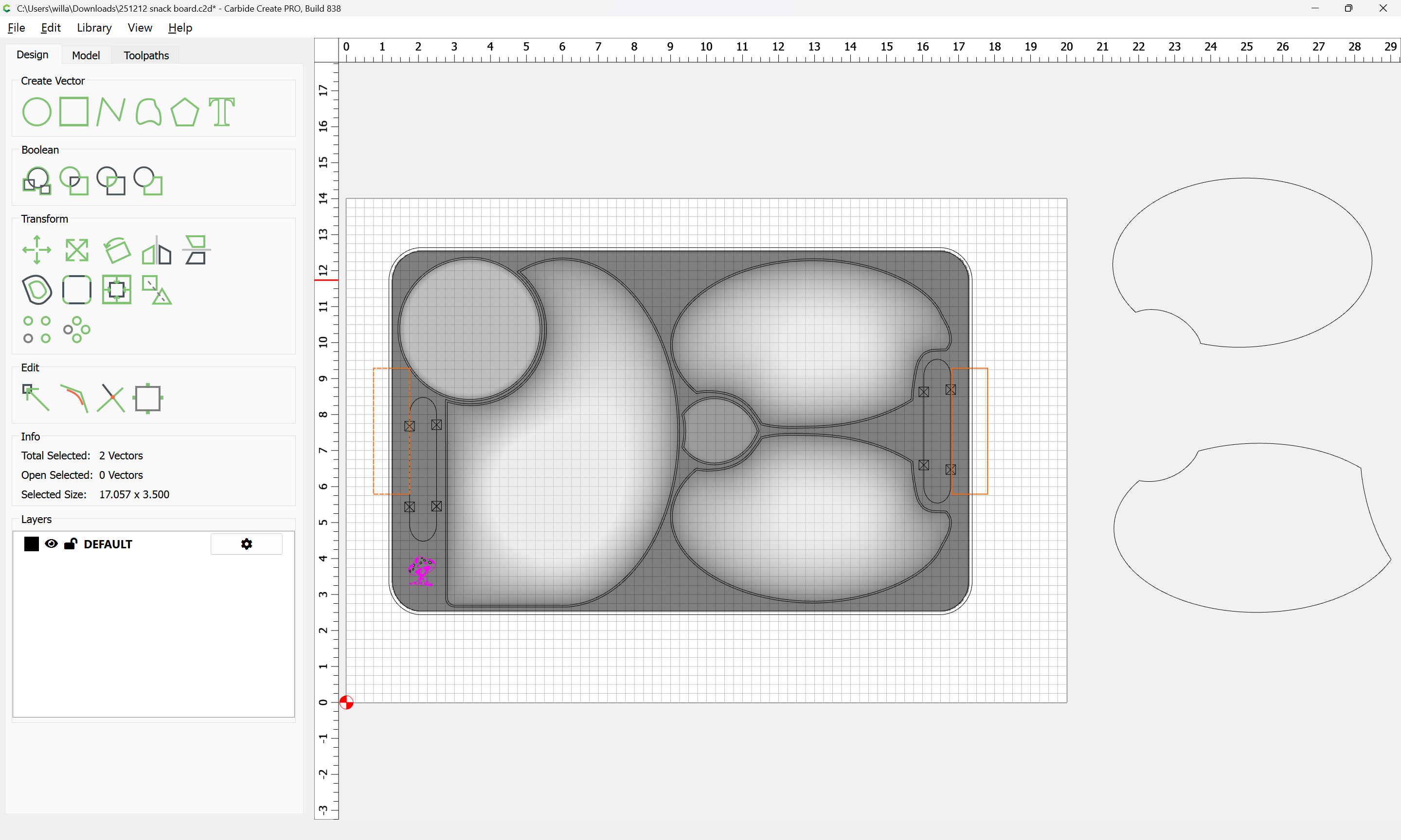

then move the contour down to below the pocket and start cutting at the bottom of the pocket:
[image]
and…
(same for the handles)

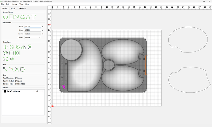

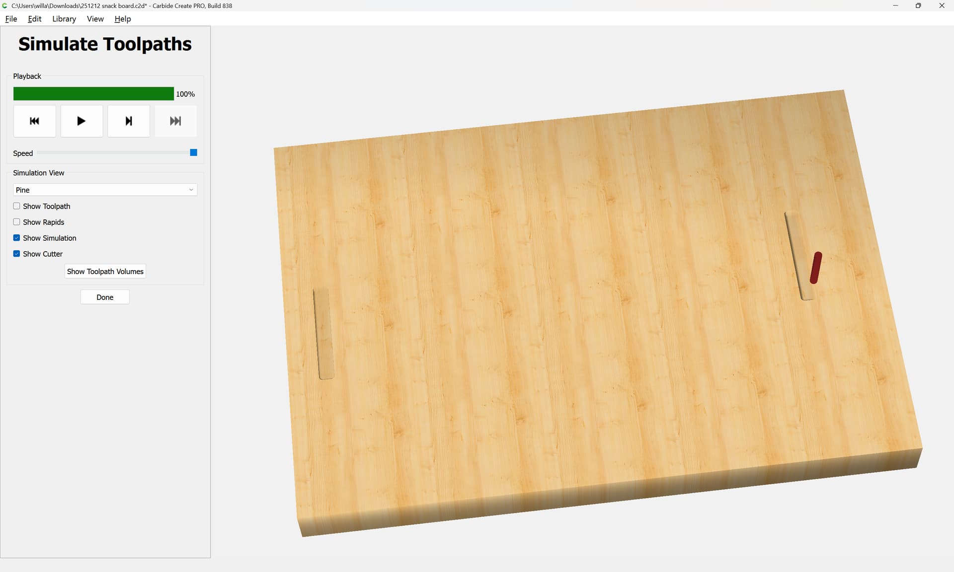

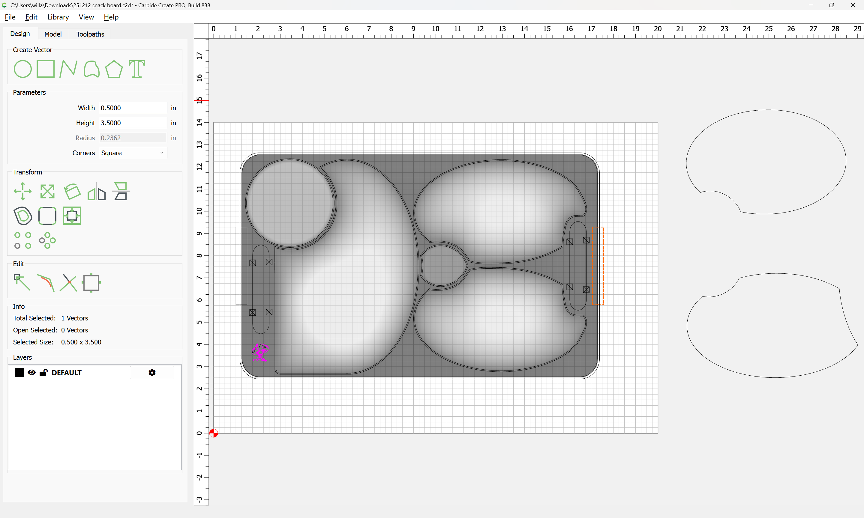

I’d simply add another group and add a shallow cut along the edge (note that you’ll need to maintain registration — probably the best approach would be to cut half-way through on each side)
Adjust the dimensions/placement a bit:
I believe those will need to be mirrored depending on the orientation of your flip, see:
