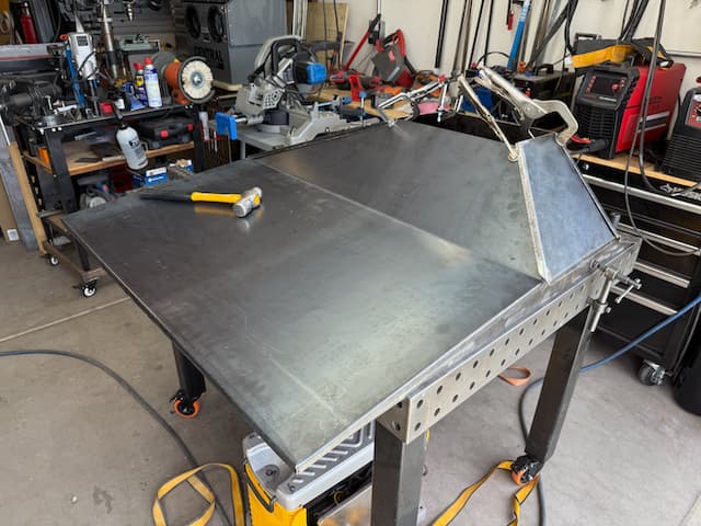

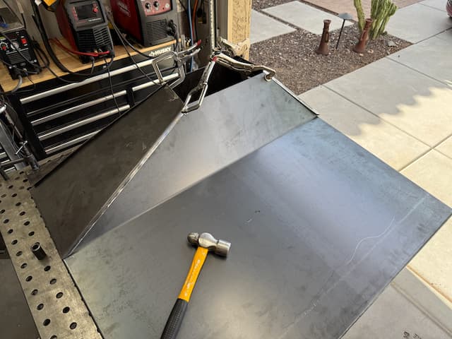

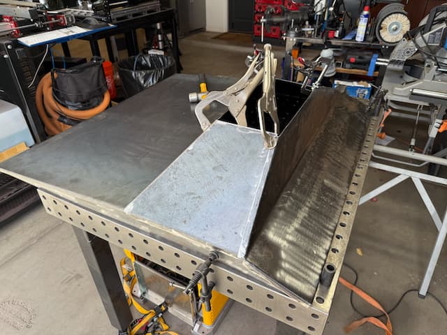

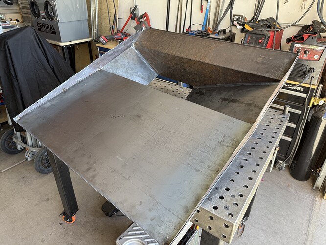

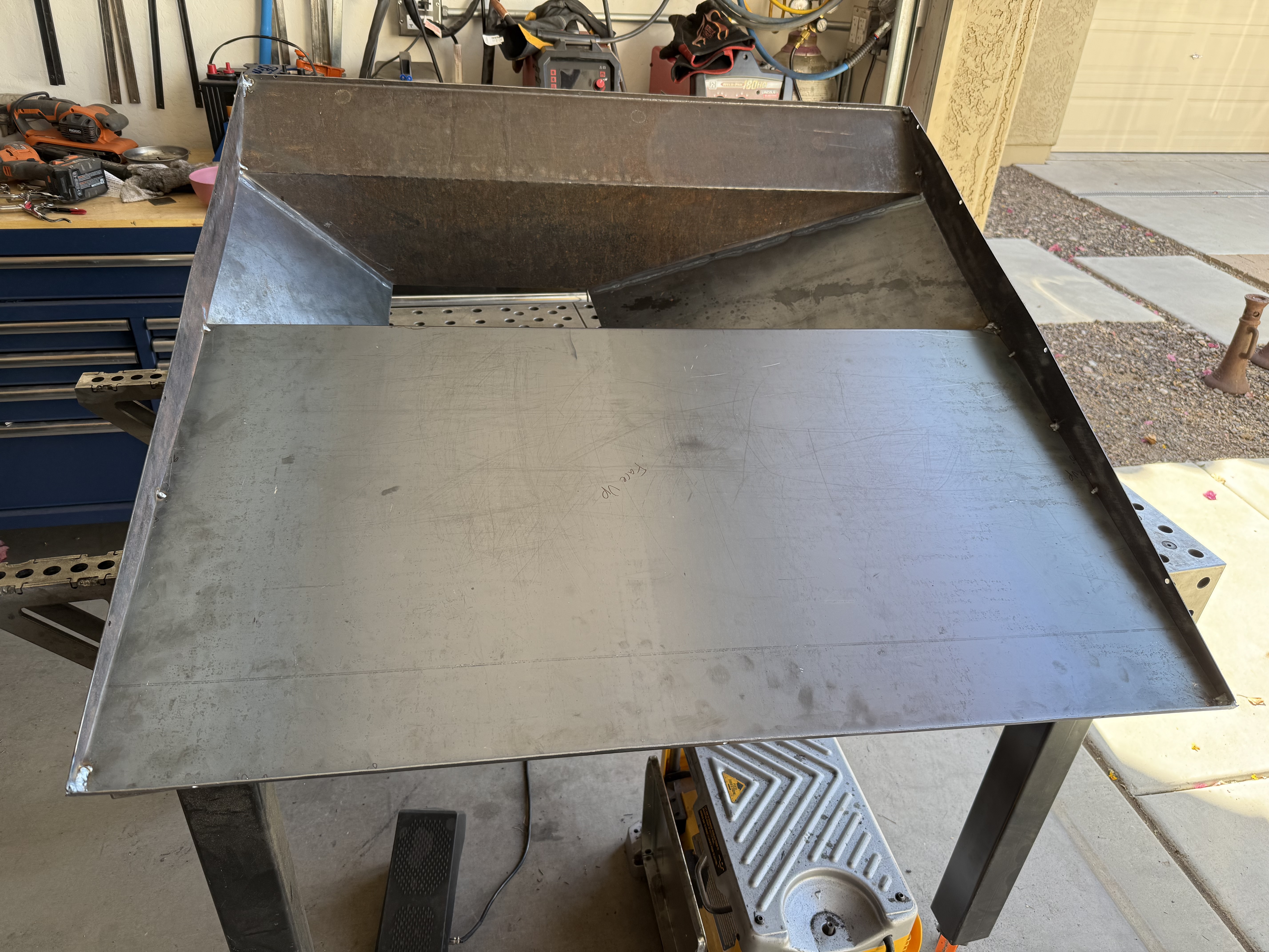

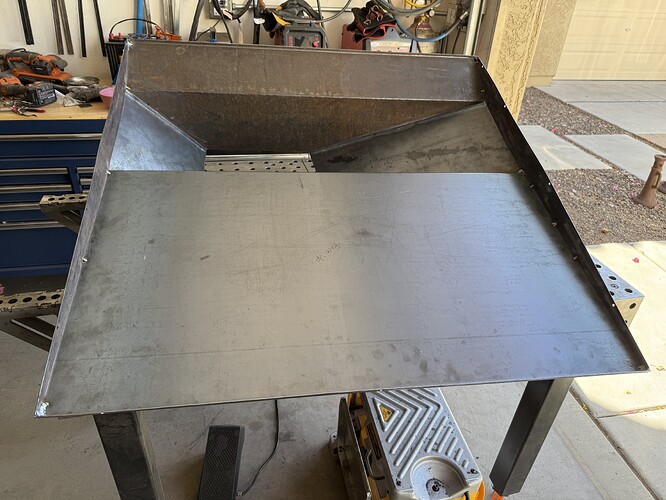

I have one part ot remake on the hopper. I got excited and rushed through bending and wound up bending the last part the wrong direction. So, I will have to undo that and rebend it the correct direction. Then I can rivet it all together, paint, and install.
From there I can do final placement on the enclosure and actually start using the HDM. I have already built the warthog elec enclosure box (see above). I have a few small things I want to build on the HDM, then I will move on to fabricating the doors, panels for the bottom. I need to order some parts for all the electronics, lighting, etc. Lots of research to do as well.
Love it when a plan comes together. As far as bending it the wrong way you are not the first nor the last to make a booboo. As long as you can fix it no harm no foul. :wink:
Well, I banged out TWO panels that I screwed up. The maths hurt. Actually, the geometry hurts when it is upside down. Now, tomorrow I will start gluing it together.

hopper is ready for prep and paint after gluing it.

I finished painting the v3 hopper that I fab’d. Going out to the shop to install it soon. I also installed the C3D air kit. I haven’t taken pics yet, but I will later.

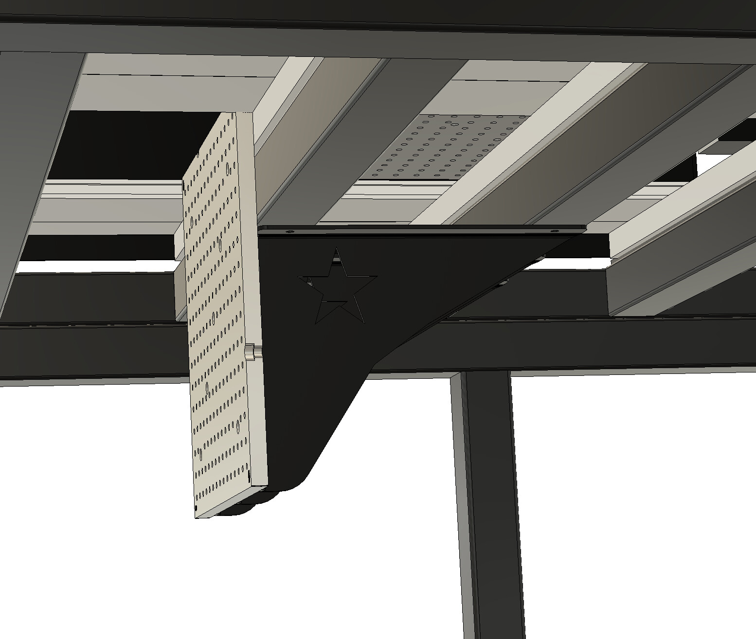

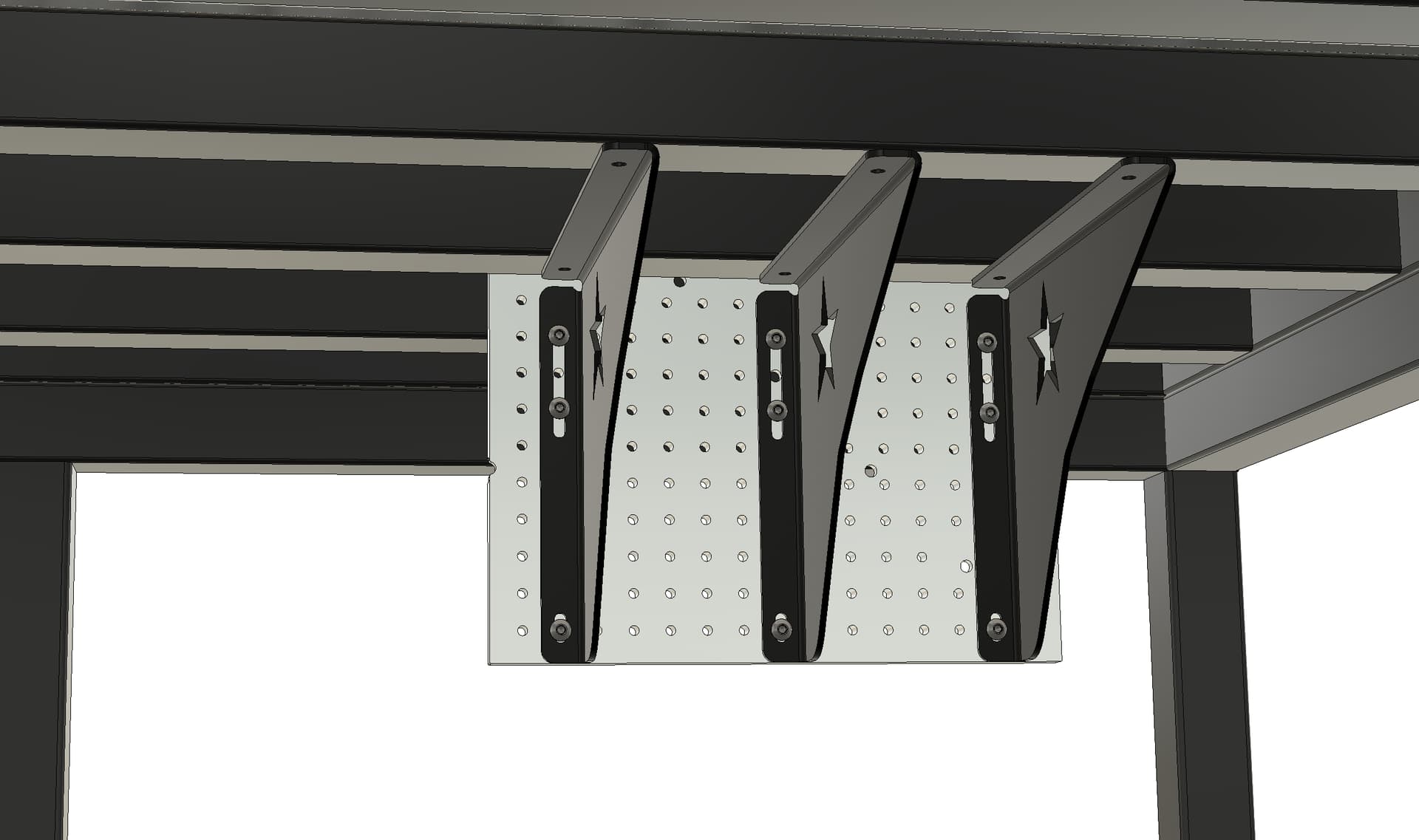

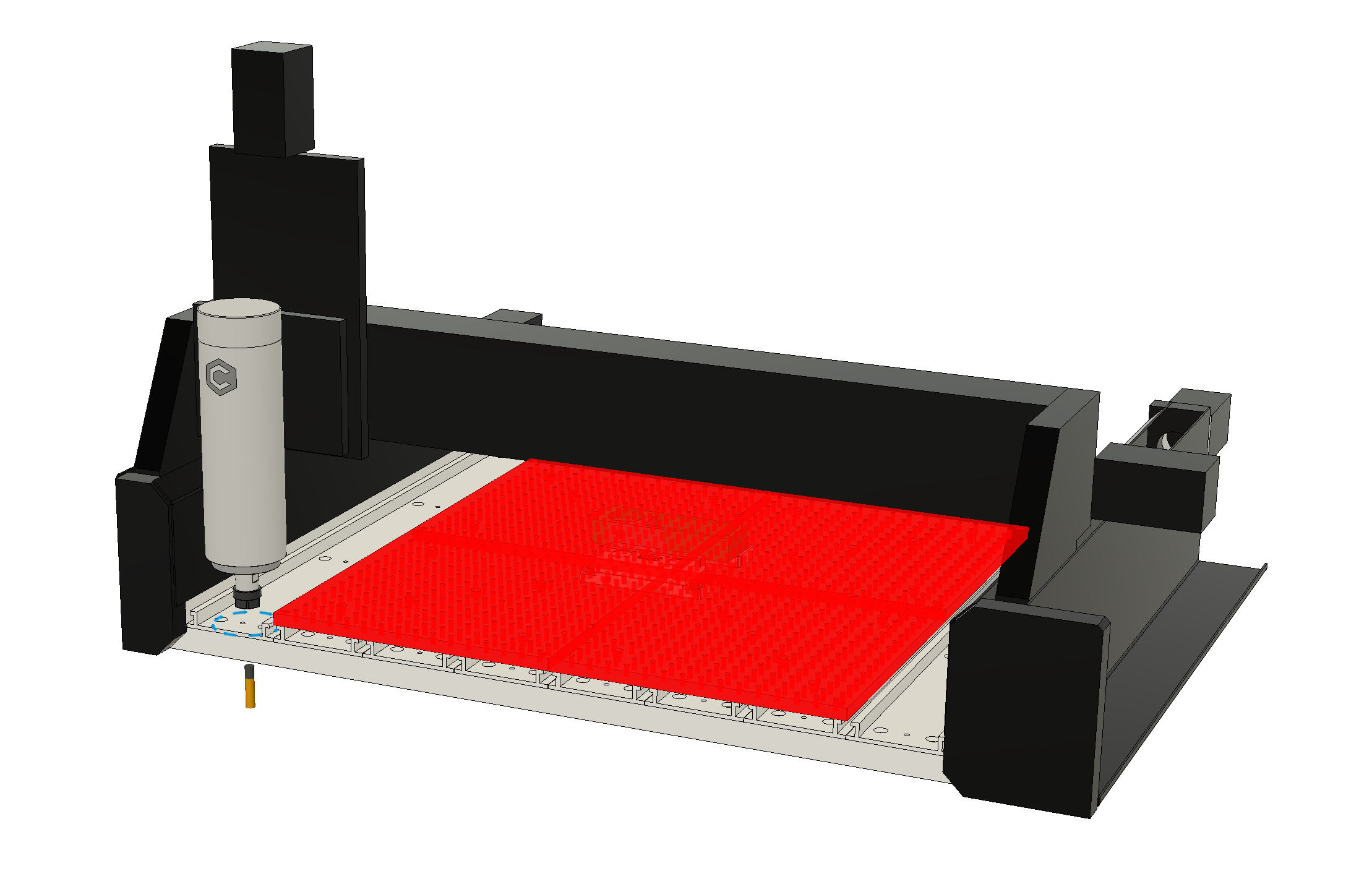

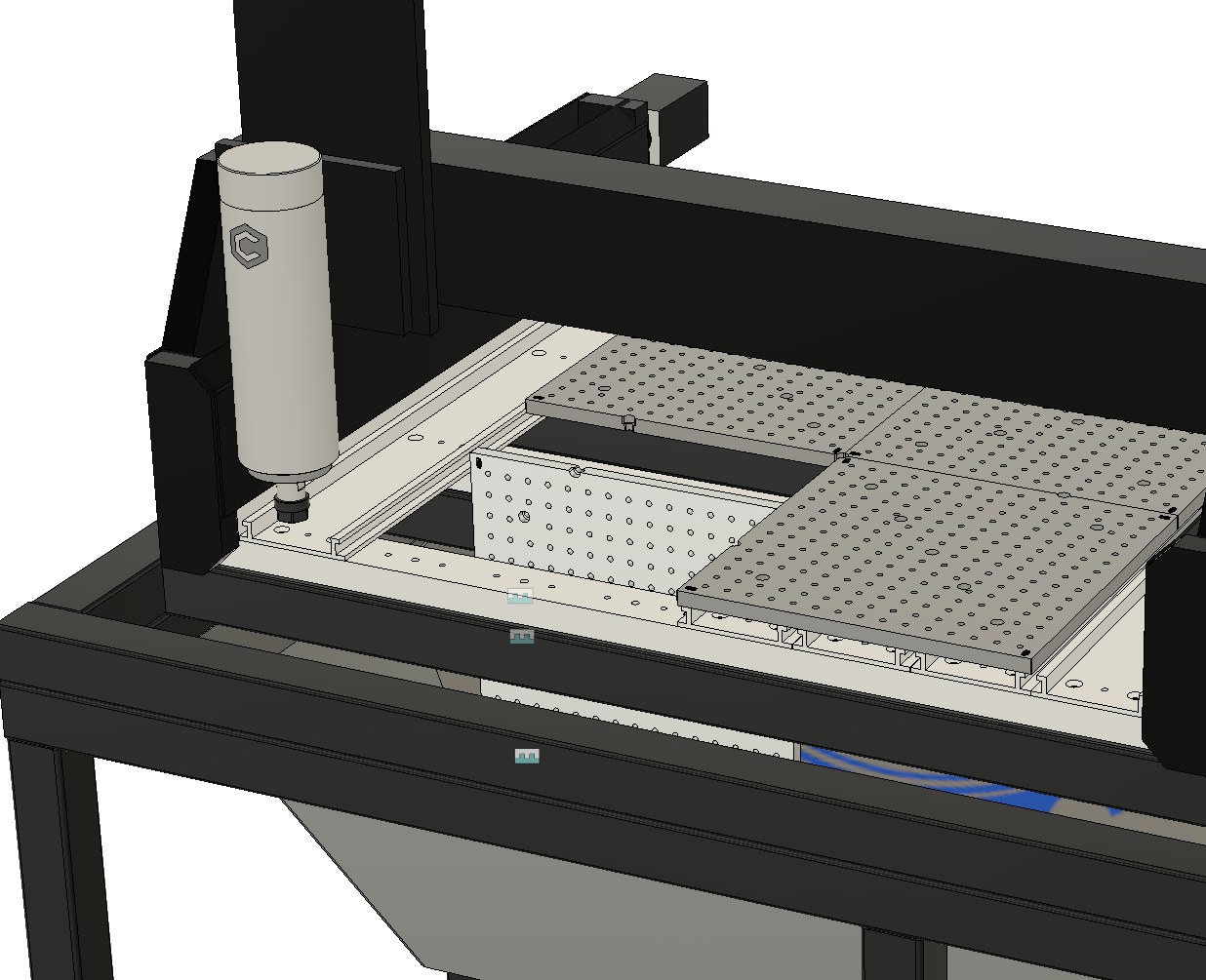

Also made some big revisions to the Vertical Work Holding Bracket and setup in preparation for cutting the brackets on the laser next week.

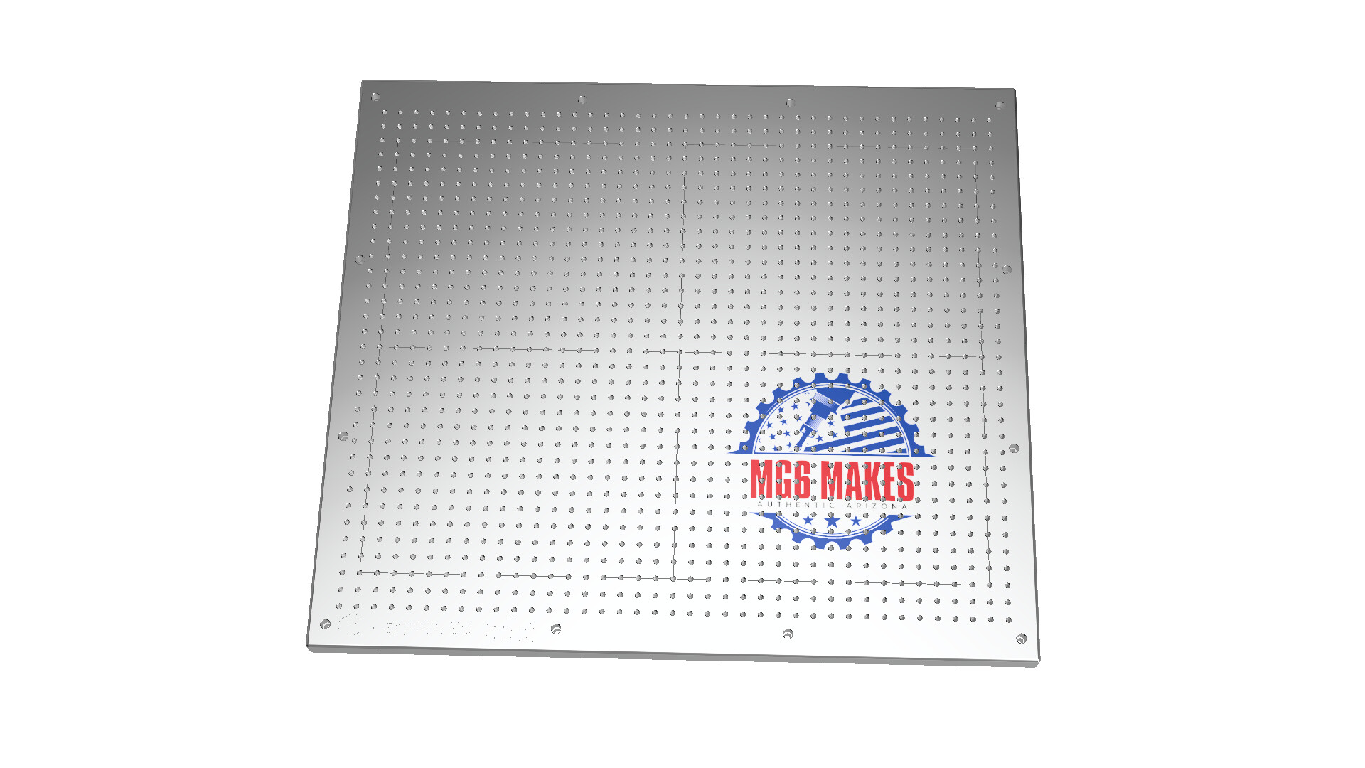

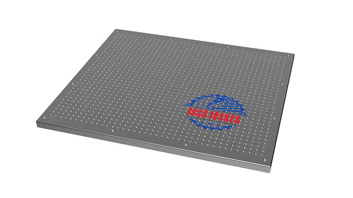

Well, it rained in the desert, so I stayed in and got distracted. Designed a 1" work plate for the HDM.
