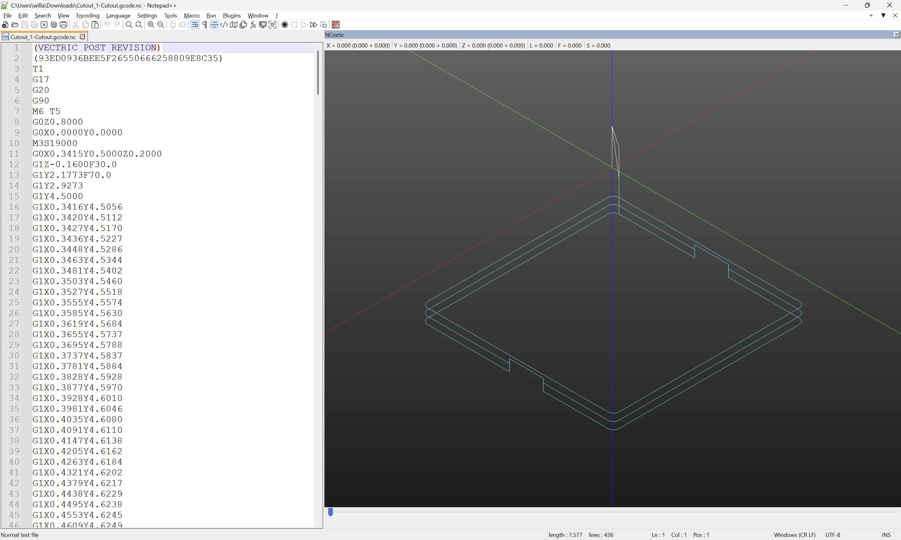

You are cutting a slot just as narrow as the tool:
at least as deep as the diameter of the tool.
where possible avoid slotting and add geometry and cut as a pocket
and/or
Ensure that feeds and speeds are appropriate to the tool and material.
