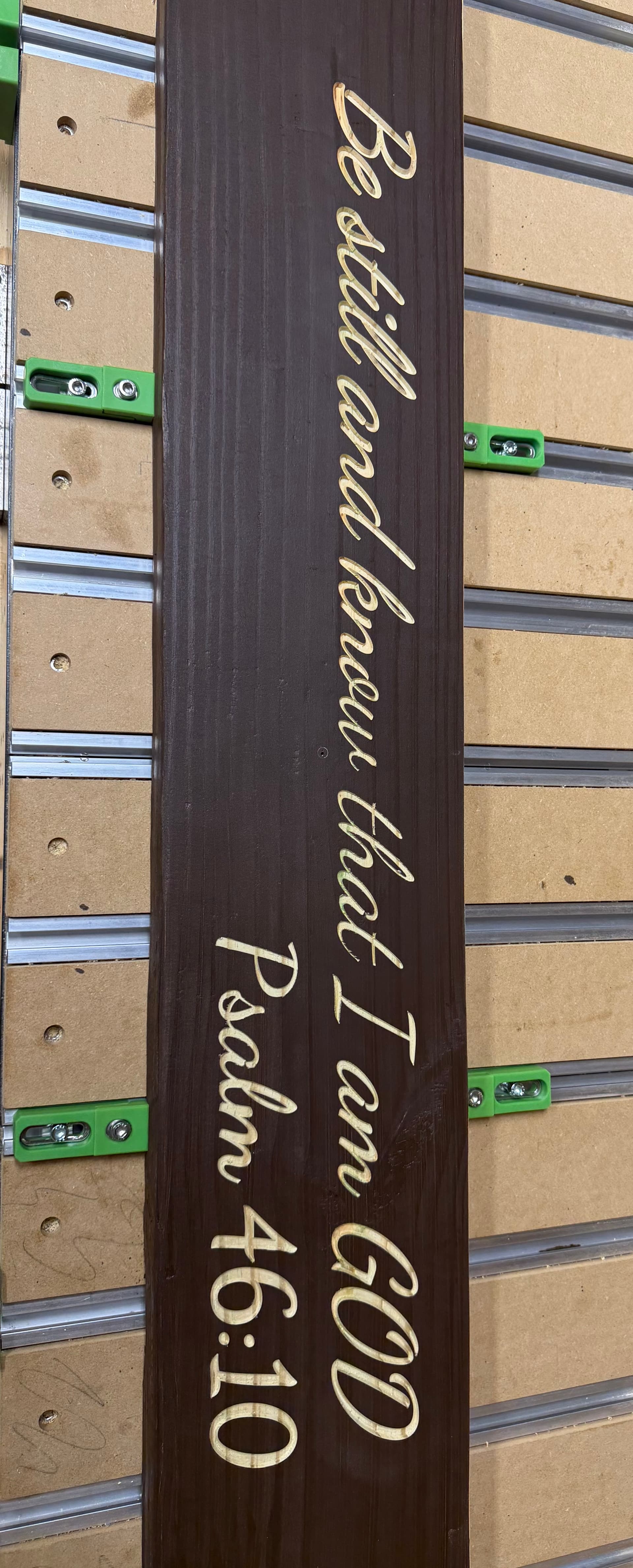

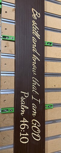

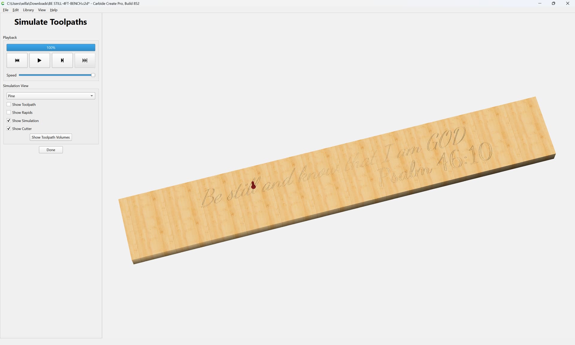

Yes, I knew the font “line thickness” would have to be wide enough to accommodate an 1/8" endmill and also have no pointed parts. I had already done a large block style text with a 1/4" bit but did it with v-carve also because I thought you had to. What got me asking this question is that I had done some cursive text on the back of a bench. The width of much of the text was like 3/16 wide and I used a 1/8" bit. When it went to cut, it just cut a few little dits and tittles here and there for like 2 minutes and then used v-carve to do the rest, leaving all kinds of cleanup in the middle of the font carve for the 60 degree bit which took forever.
Pocket clearing didn’t work well? Photo of the cut? Upload the file?
It came out really good I just don’t understand the 3 minutes 1/8 endmill then the 40 minutes
v-carve
Not sure I know how to share the file but I will try
BE STILL-4FT-BENCH.c2d (440 KB)
See if this works

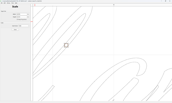

There are few areas where the 1/8" bit will fit at the bottom of a 0.050" deep cut. So the V-bit gets taxed with the rest of the clearing. Note that because of the angled walls, the floor is narrower at the max depth than at the top of material.

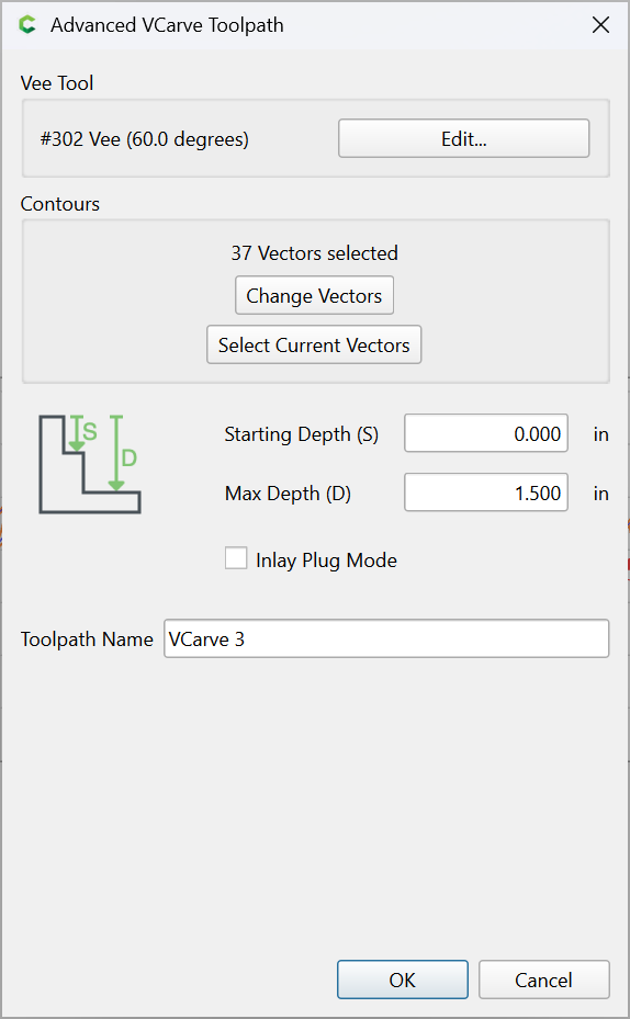

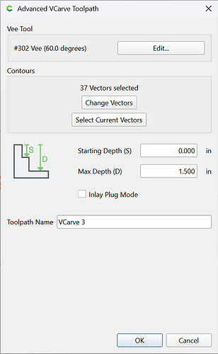

Change the max depth to 1.000" and it will only use the V-bit.
Reduce the max depth, or use a smaller clearing tool & it will use the clearing tool more & the V-bit for clearing less.

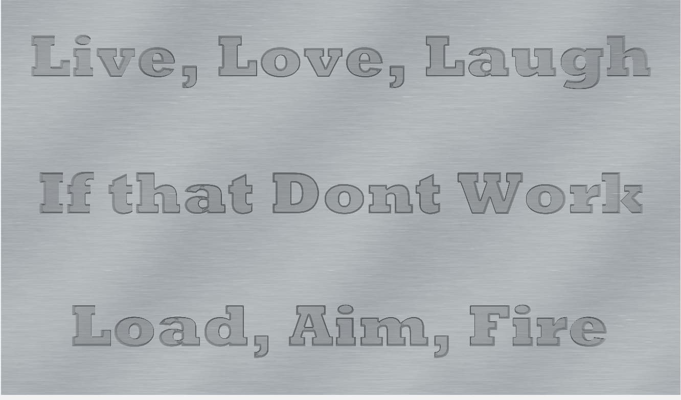

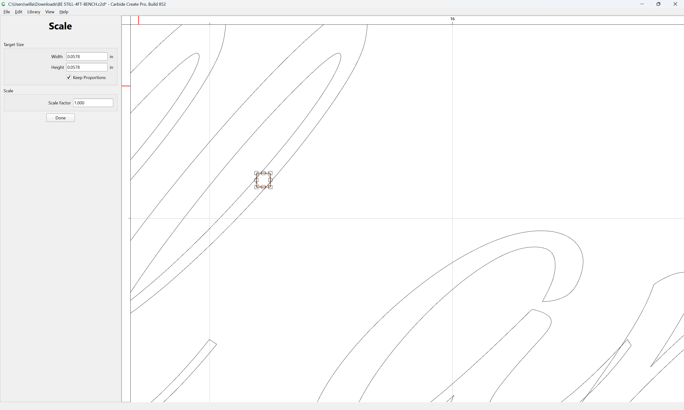

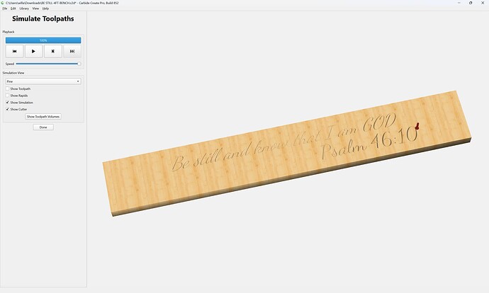

Today at lunch I saw a sticker on the back of a car window. I laughed for 5 minutes or more. In the simulation you can see that there are places where my straight bit did not fit. I started with a 1/8" but then reduced it to 1/16". Look at the “Load” and the a has narrow places that the vee bit will have to remove.
Although the text was 3/16" at the top, the angle of the VBit means that the width of the text at the bottom of the pocket can be considerably narrower.
Here each square is 1/16" of an inch, carved 3/32" deep. You can see a 1/8" bit wont fit.
Aligning to the grid, yuou can see the depth has to somewhat less that 1/16" for a 1/8" bit to fit:
Consider that to cut the narrower regions you would need a quite narrow tool:

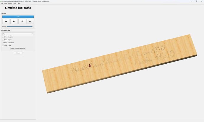

Probably, this would have been better w/ a full-depth V-carving — as it is, you are leaving a channel uncut in the center:

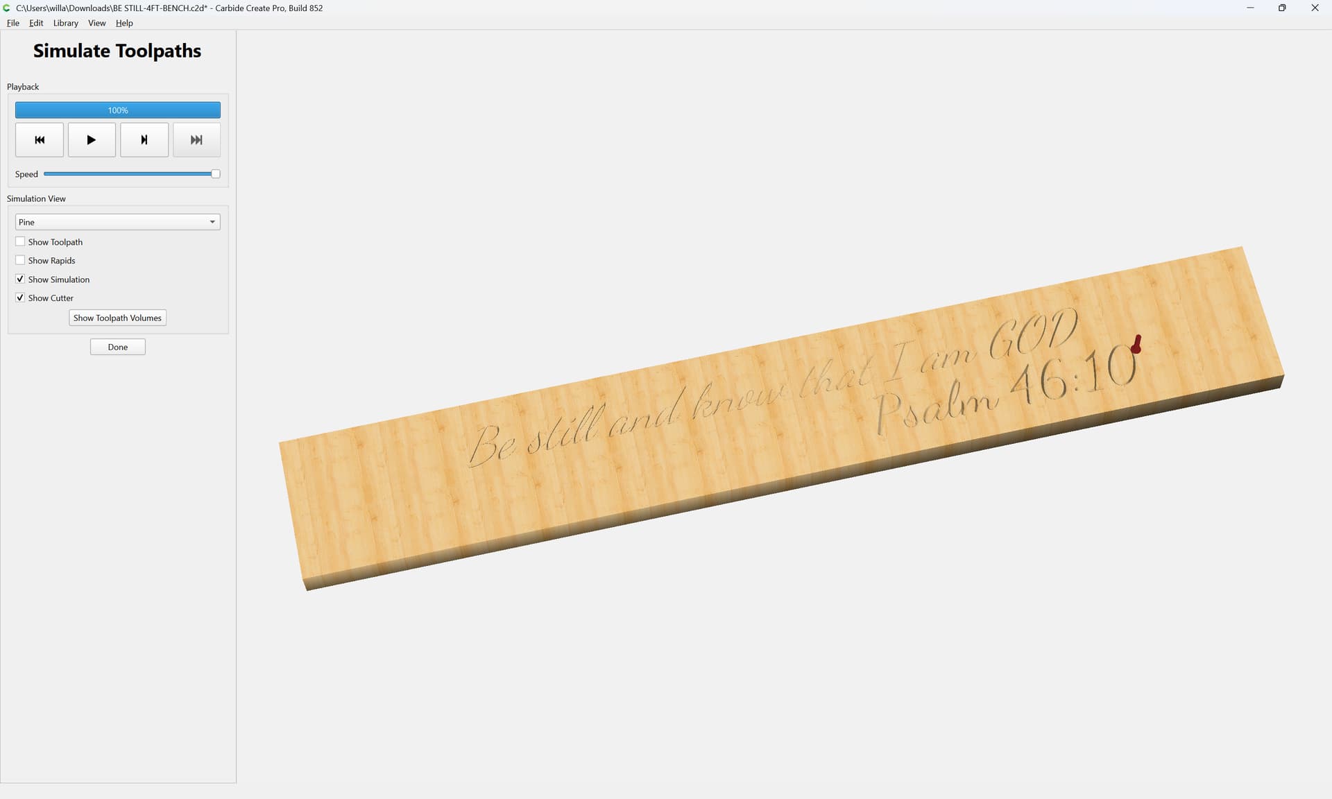

If instead you “allow the tool its head” (to mix metaphors) and set the depth to full:
So max depth on the tool has nothing to do with how deep you want your letters? Also are you saying the whole thing could have been JUST cut with the 60v at a deeper depth to achieve a good cursive text overall. No 1/8 pocket tool at all?
Max Depth sets the maximum depth to which a V carve will cut — but if it is composed of narrower regions than would be cut width-wise when cutting to that depth then the V tool will not reach that depth.
