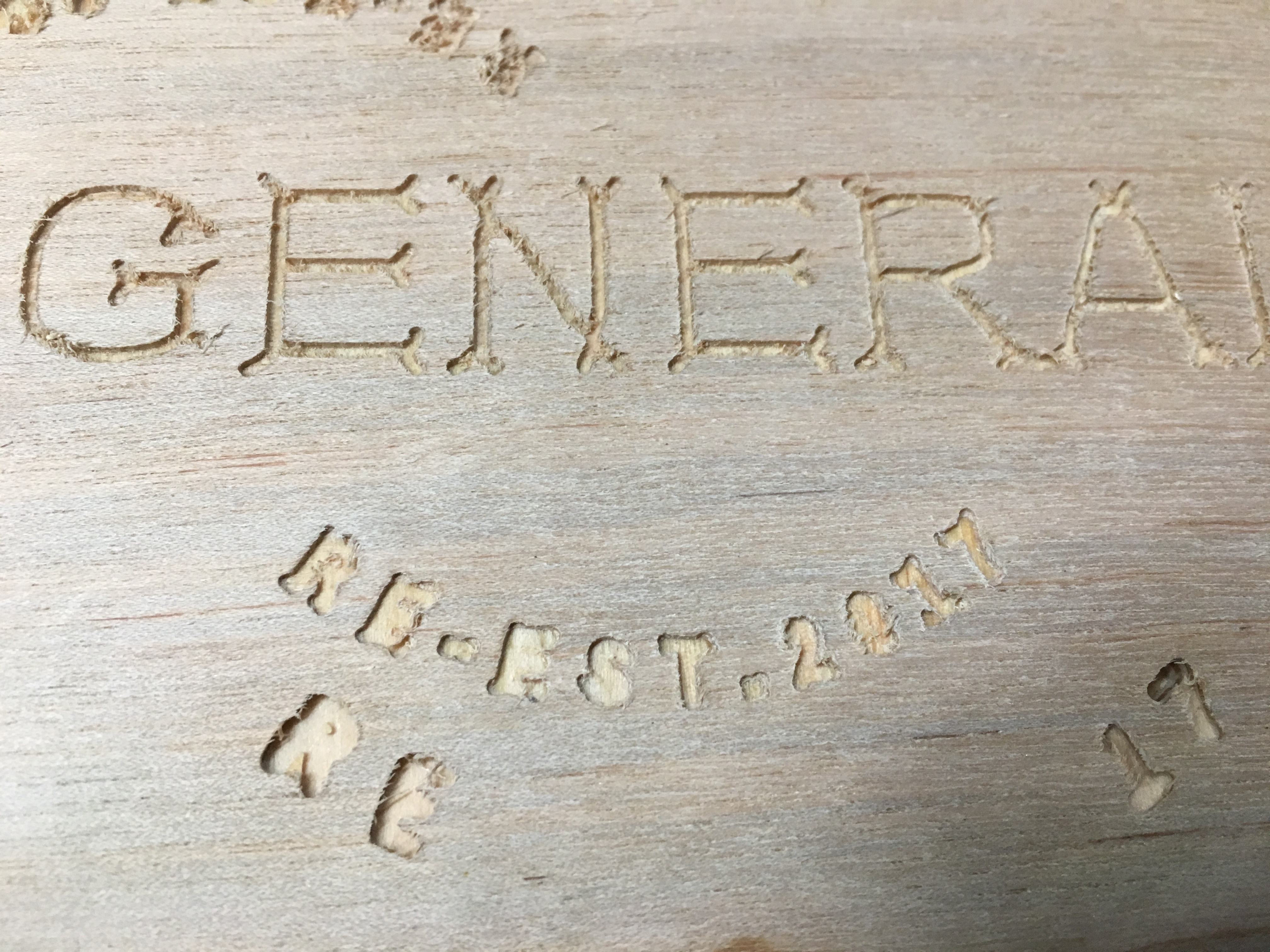

I tried rather unsuccessfully to V carve with my SO3 using Carbide Create. I know this topic has been explored before and sorry in advance for not being able to find what I needed in previous posts.
I was trying to do some rather small letters so I purchased the Amana 30 degree V mill with a .005 tip width and a .440 cutting length. When I try to carve anything, the bit just scratches the surface. In fact, it looks exactly like the line preview in the toolpath section of CC. It only carved the blue lines, nothing deeper. I can’t find (or don’t understand) the information being presented to me regarding the depth of cut of a V bit. I’ve read that CC knows how deep to cut based on the tip width of the tool and the width of the letters, but all I get is the blue outline on my piece (see attached).

Did you enter the 30 degree endmill with a 15 degree taper angle?
Hi Will, sure enough it was set to 30 degrees. I changed it to 15 and I just re tried it with the following settings
Depth Per Pass - 007
Stepover - 002
Feedrate - 5.00
Plunge -2.00
Spindle - 18000
It still looks pretty bad.
I also did it with the 60 degree bit (first picture) and it came out with more definition, Not sure why. Do I have unreasonable expectations for how sharp this should be?
Thanks,
Philip!

I believe the 60 degree endmill you have is too narrow for the larger letters — that matches the preview, no?

How wide is your 60* bit at its widest point? and are you sure it’s 60*, my #302 1/2", 1/4" & 1/8" 60* v bits all fit in the profile of the letters fine.
I see what your talking about on your O, mine is not like that, kinda looks weird in my photo but its cut through a knot in the wood and looks perfectly round.

My 60 degree V bit (specs attached) is .23 inches wide.
I just carved an N and an I. I watched the bit as it went. I can actually see it making those squirrely curved moves. Like there is something wrong with the code or the interpretation of the code.
The original letters in “GENERAL STORE” are about .125 inches wide, again significantly less than the bit width.
As far as the simulation goes Will, it doesn’t reflect at all what it carved. Attached is a JPG of that as well. Thanks in advance for all your help!

The preview matches the cut.

Sorry - here’s the definition from the tool creation menu and another carve of the same letters in a different font, which seem to me to exhibit exactly the same issues with the N as the other font.600%20definition
Looks like my cutter width is wrong. It should be 6, not 3.175.
I’ll change that and re-carve.
Here’s the new carve. It looks way better to me. I’m going to try the full logo now and see what it looks like.
Cockpit error. I never would have found it without all your help and suggestions.
