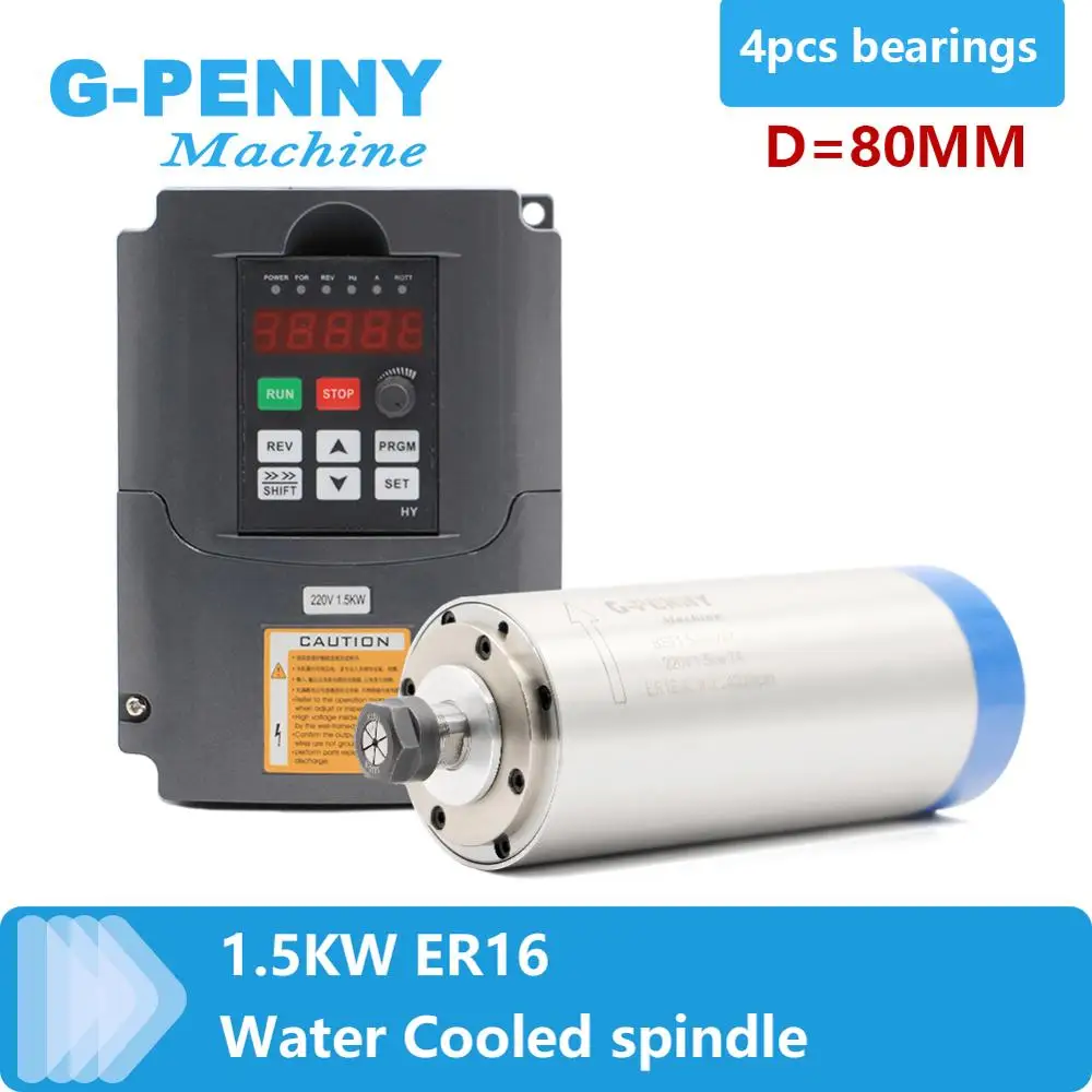

Not to hijack but didn’t think we need another spindle thread, im also spindle shopping and likely going to order a g-penny 1.5KW, my question is there a significant benefit to going with a 220v one over 110v?
If i had to i could do some wiring and get 220 to where my CNC is but is it worth it, is there a major downside to just staying with 110?
My other question does anyone know how much louder the air cooled is vs water cooled? i suspect the cutting is the loud part anyway so is it worth the effort and extra money of doing a water cooled setup?
This is the spindle im leaning towards:
I have yet to see anyone complain about using an 110v 1PH input to 220v 3PH output VFD. That said, be sure to use a circuit that can support the full amperage draw (see below) and not sharing with other appliances/tools, otherwise you could trip a breaker or worse. While you might never see it actually pull that full amperage rating, when it comes to electricity I rather play it safe than be sorry.
Also, typical industrial VFD installation recommends a circuit breaker and/or fuse inline, i.e. my 2.2kW VFD recommends a 25 amp (Type B) breaker, and as I am piggybacking off my dryer line for 220v 1PH (not running simultaneously of course), it has a 40amp breaker in the panel. So I rather it trip at the shortest possible distance (in my VFD electrical enclosure next to the CNC), rather than what would happen if it didn’t till over 40amps.
At full load (1500W output) that spindle should draw 220V * 7A * 1.732 = 2667VA from the VFD. Even if the VFD is 90% efficient, it would draw 2667VA / 0.9 = 2964VA from the service at full load. At 220V, that’s 2964VA / 220V = 13.5A (minimum 15A circuit). At 110V that’s 2964VA / 110V = 27A (minimum 30A circuit). A more reasonable 800W spindle would require about half as much.

Im sure a 800w would work fine but from what i have seen they come with ER11, i need something atleast ER16.
