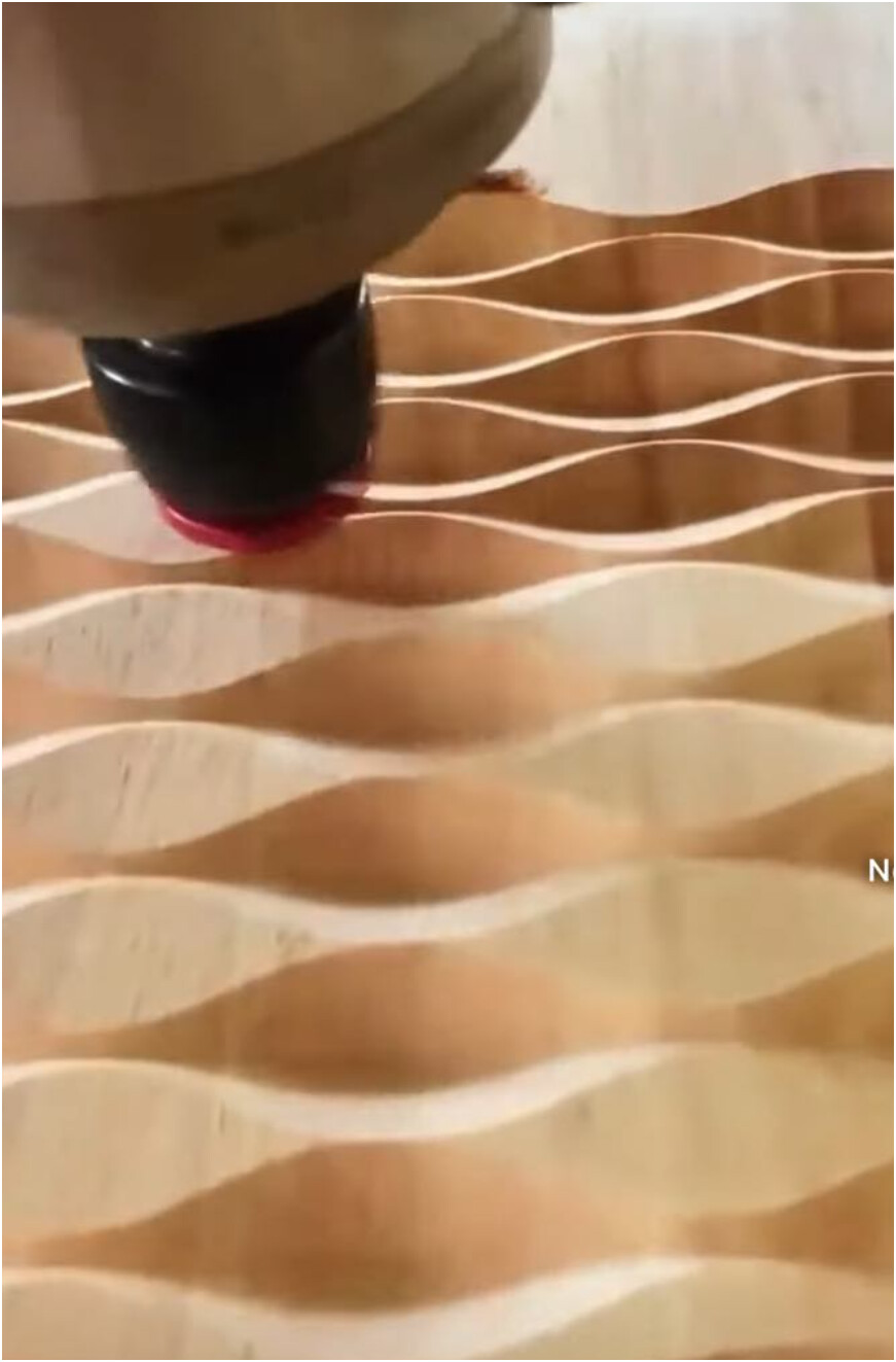

Hello all,
I am hurting my head with trying to figure out how to make toolpaths for patterns similar to what is shown in the picture.
The closest I come is with texture feature but it is not as I wanted.
I know such patterns can be done with 3D toolpaths, but are so time consumnig.
The Idea is just to run a tipped roundover bit in wavy motion across the stock. I think it could create interesting patterns with just adjusting wavelength, heigth, angle and space between the paths with different bits.
any ideas ?
Thank you in advance,
Miha
I am pretty sure that those are done with a V tool, not a roundover.

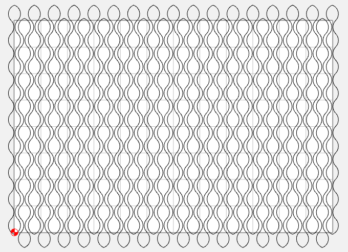

Note that the above link dates back to a quite old version of Carbide Create — this could now be done directly in CC using Node Editing — you’d still need to select alternate sets (or slightly space/offset so that there is a gap).
Draw up a pattern & V-carve it.

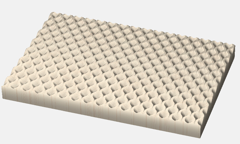

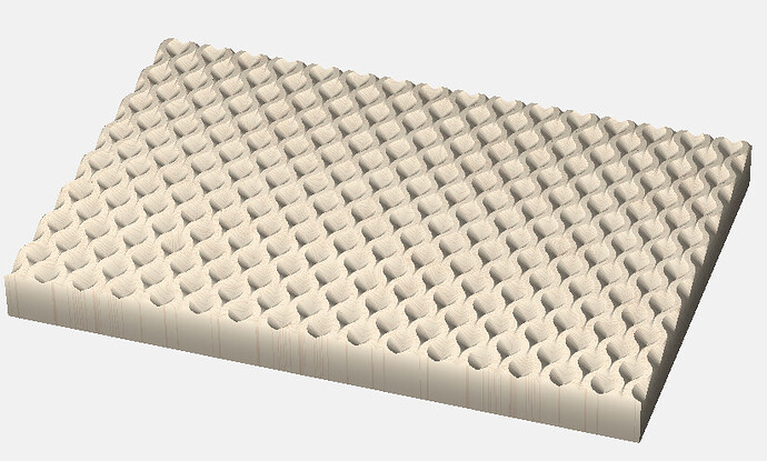

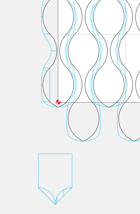

I played around a bit with using a roundover bit…
The blue curve is adjusted to create the same shape as above with a roundover. (programmed with 90° vee).
The simulation in CC doesn’t look right because it shows the 90° vee bit cutting instead of the roundover. I’ll see if I can simulate it in NX or Camotics with a roundover.

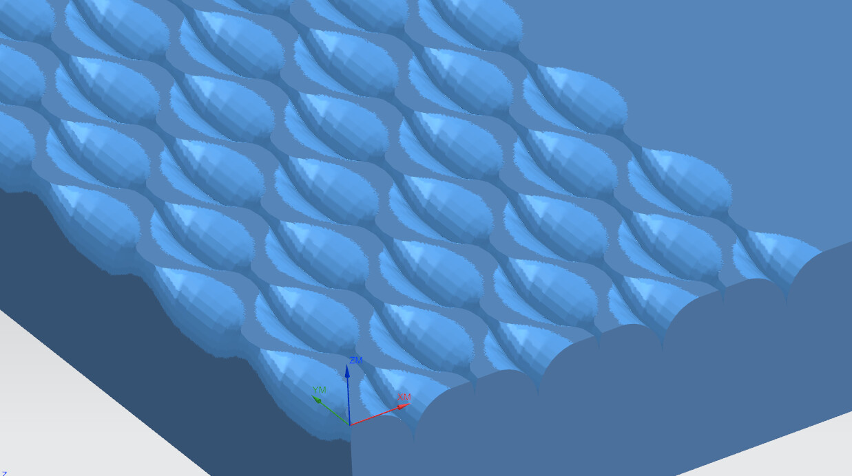

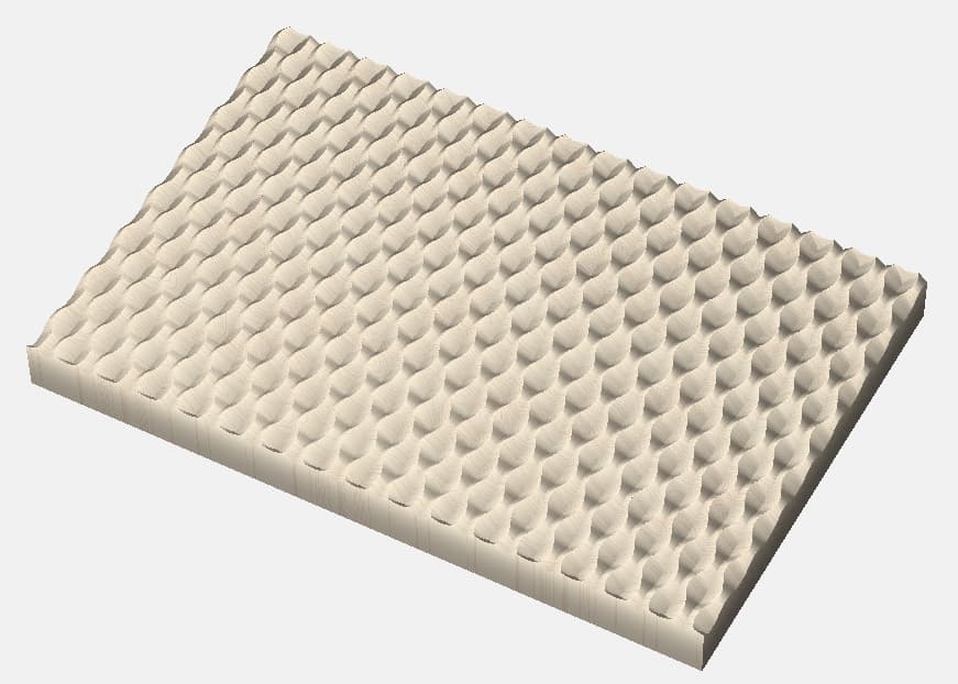

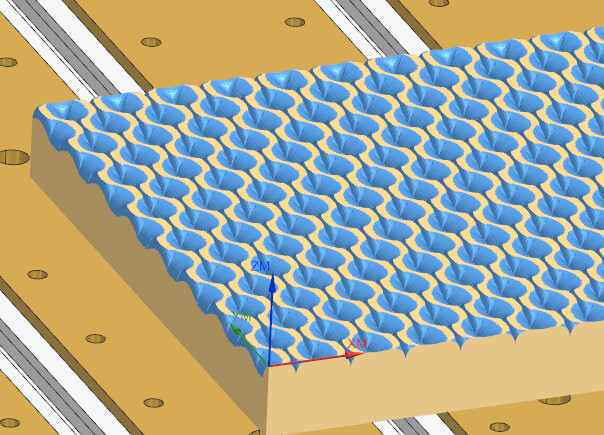

For giggles, here’s what it looks like simulated in NX on my HDM with a roundover bit.
I would need to tweak the curves so there are no vertical pick moves in the V-carve.
Here it is tweaked…
Gotta admit, I like it better with the Vee Bit. :person_shrugging:
