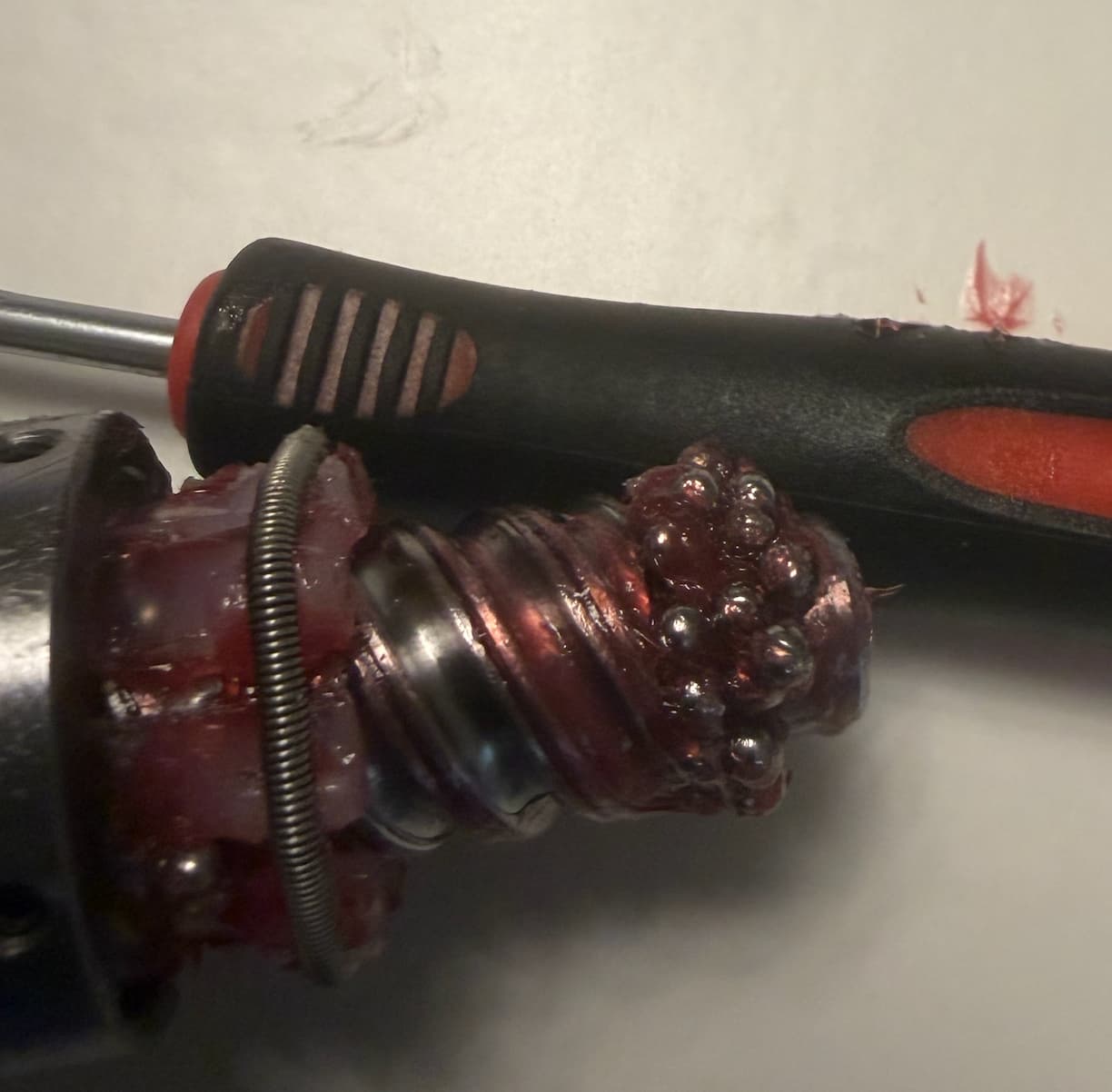

Left Y axis started rattling, then buzzing, then jamming, followed by HM009 errors and what appears to be a pretty catastrophic failure. After replacing the stepper motor and homing sensor with no improvement, I tore into it and found ball bearings coming out of the ball nut.
I don’t know yet if the ball nut caused the original problem or became collateral damage from something else. I’m currently attempting to repack it and find out. Apparently owning a Shapeoko 5 Pro means that by Week 2 you’re expected to be a CNC operator, machinist, electrician, diagnostician, and master of repacking tiny ball bearings into places human fingers were clearly never intended to reach.

Bearings don’t just fall out of the ballscrew or the linear motion hardware on their own. The system doesn’t generate enough force to make that happen. When we’ve looked into similar reports, what we usually find is that the ballnut was removed from the screw, and once that happens, there’s nothing retaining the balls so they will come out every time. That’s the nature of a ballscrew, not a defect.
I don’t know what that red grease is, but Mobil Vactra is the recommended oil. If you prefer grease, Mobil EP1 or EP2 works. For the ballscrew itself, I’d stick to oil.

I did figure out how to pack them myself. That was the solution. I had to take everything apart and clean everything. Then painstakinly push them into place…she purrs like a kitten now…Still…like a kitten made of paper on a rainy day.
Be sure to use dust collection and remove as much of that grease as possible. (Which looks like it’s begging to trap a bunch of sawdust and carry it into the ballnut.)

Thanks, Rob. Just to clarify, I’m not suggesting that the bearings spontaneously fell out of the ballnut. What happened was that sand, sawdust, grit, and general shop debris had gotten into the assembly and the bearings had begun binding and seizing internally. There was already substantial friction before I ever removed the screw. I pulled the screw because I was trying to diagnose and correct that problem, and because everything was already bound up, getting it apart was difficult. Once the screw finally came out, then, of course, the bearings came out with it.
The red grease in the photo was something I picked up at AutoZone after trying to find the closest appropriate lubricant I could get locally. I cleaned everything thoroughly, repacked the ballnut, and was ultimately able to get the entire assembly back together and operating again. The mechanical work itself really was not that difficult. The difficult part was that I could not find a guide, diagram, video, or other documentation showing how Carbide intended the ballnut to be repacked and reassembled. So I was basically figuring it out as I went.

Is your shop dusty? Have you been utilizing the appropriate dust collection?Keep in mind that 95% of all issues are operator error lol
Any machines with a ballscrew requires dust collection to keep the machine in good operating condition. If you don’t use dust collection, it’s only a matter of time before you have trouble. At this point, we’ve seen photos of every brand of machine packed so full of dust it won’t function.
The good news is that the included Sweepy dust boot is all that most people need since it will pick up the vast majority of the chips and dust created, and the wipers that we added do a good job of keeping the remaining dust from getting in there. (We can usually look at a photo of a machine and immediately know if the user has not been using Sweepy)
