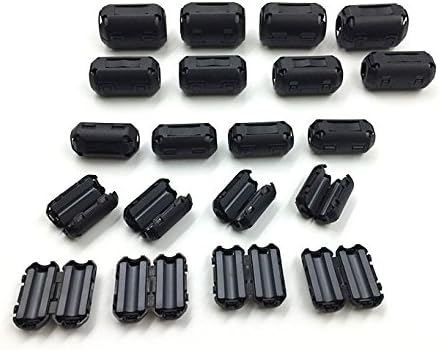

Bought a assortment of Ferrite Beads for $9 and went crazy applying them to the CNC today. Put one on each limit switch, IoT relay, Router and Zero Probe.

Why all the ferrite? Were you having EMI issues?
A few EMI hangs last fall but thought I’d overkill it while it was apart. It only cost $9 and I have extras.
