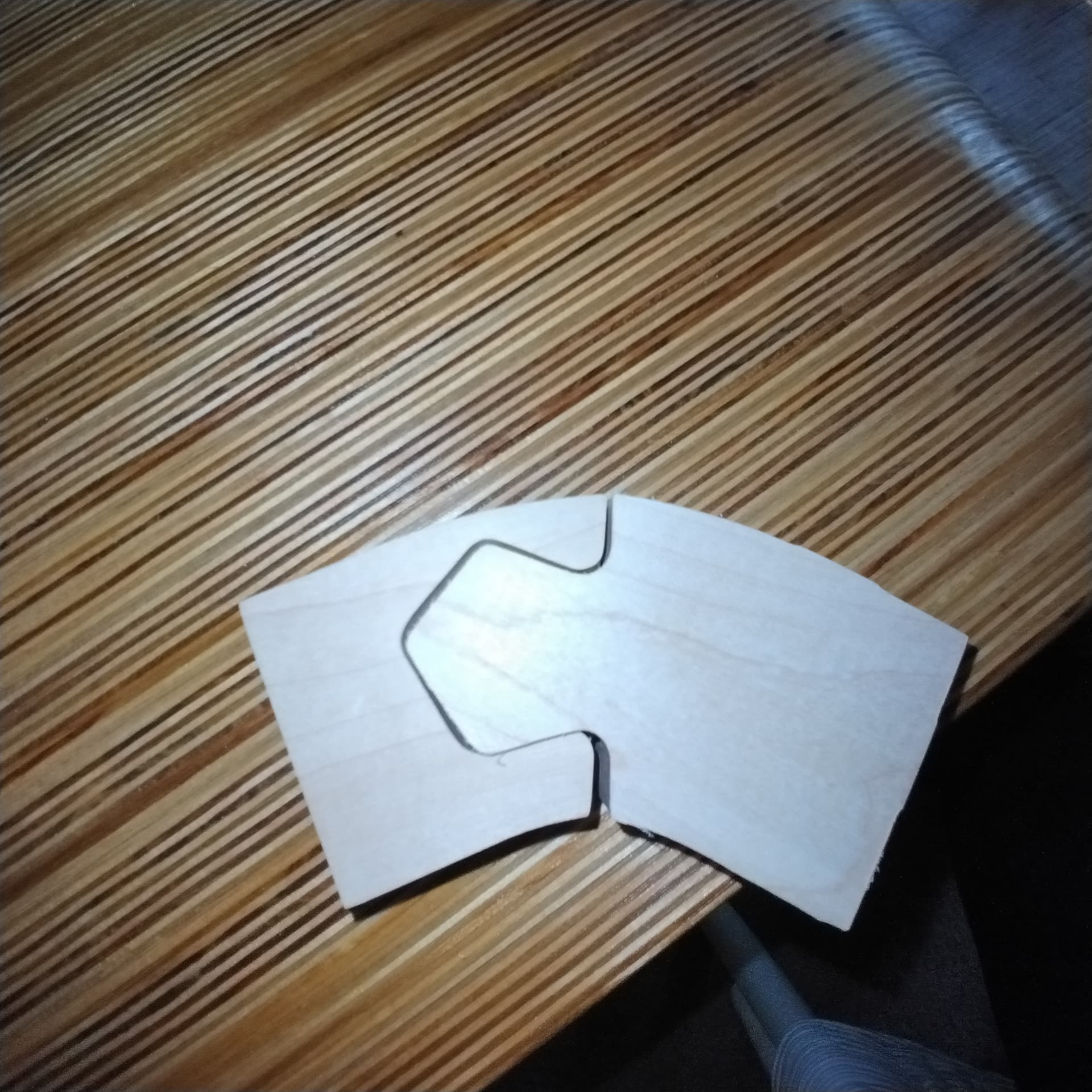

However: I designed this joint:
jointtest.c2d (84 KB)
all fine.
cut it, and this is how it looks:
huge gaps, not useable.
Ideas?

Shapeoko pro XXL, and calibrated some months ago. Will check tonight, and report back.
The file you provided doesn’t have both parts. It has two sockets only.

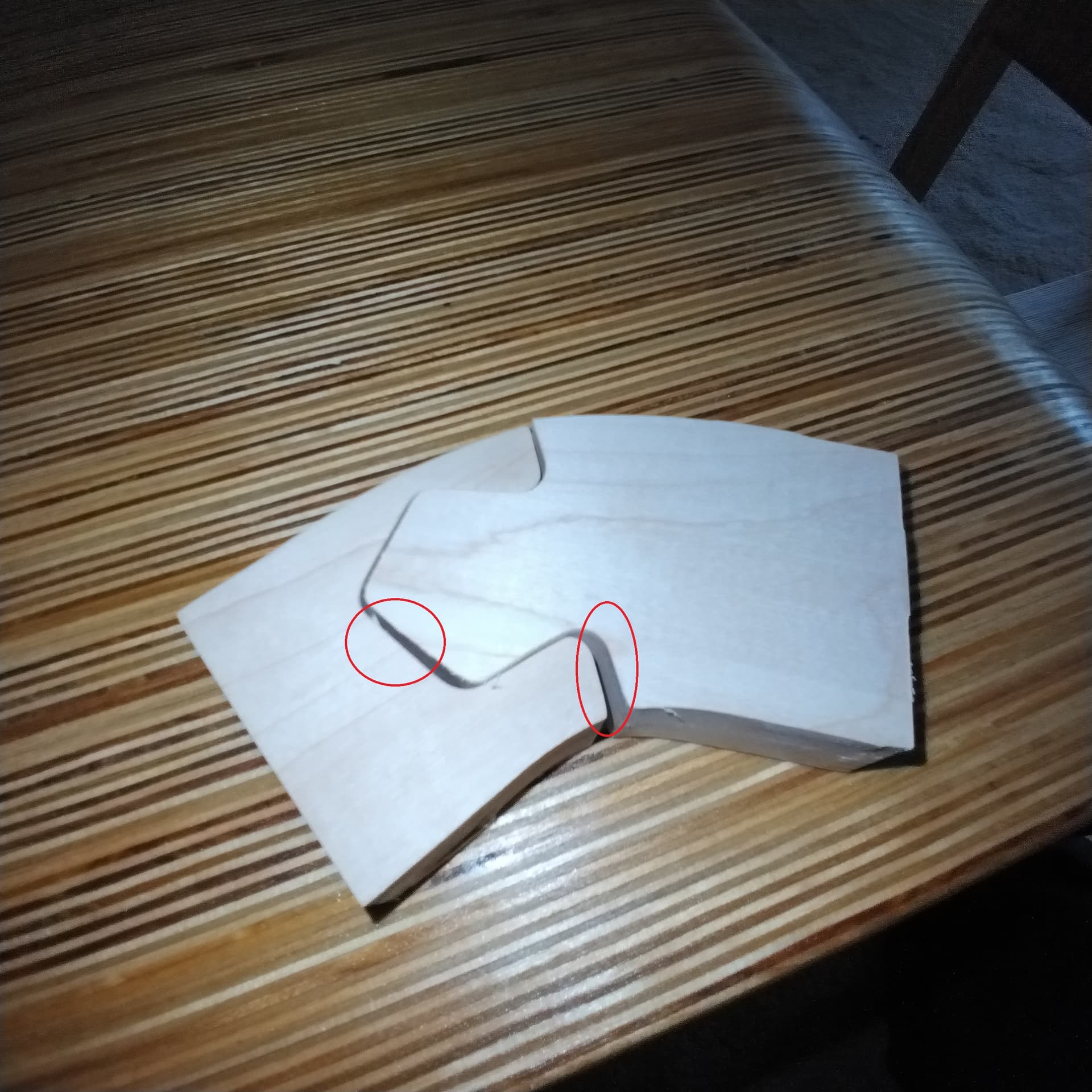

Endmill cutting oversize so your offsets end up wrong? cut a simple drill operation 3/16 deep in the material you’re cutting then measure (ideally pin guages but you don’t have them so calipers) whatever size you measure above the nominal size of the endmill used is your offset on the outside right, inside left.
Cutting deep slots is not a good approach to achieve accuracy, which is why the usual test has one removing pockets:
If the dimensions of that test don’t work out well with endmills which are verified as to dimension on a machine in good mechanical condition, then see:

You likely have a mechanical problem:
So, either something needs adjustment, or the cuts are too aggressive and are deflecting.

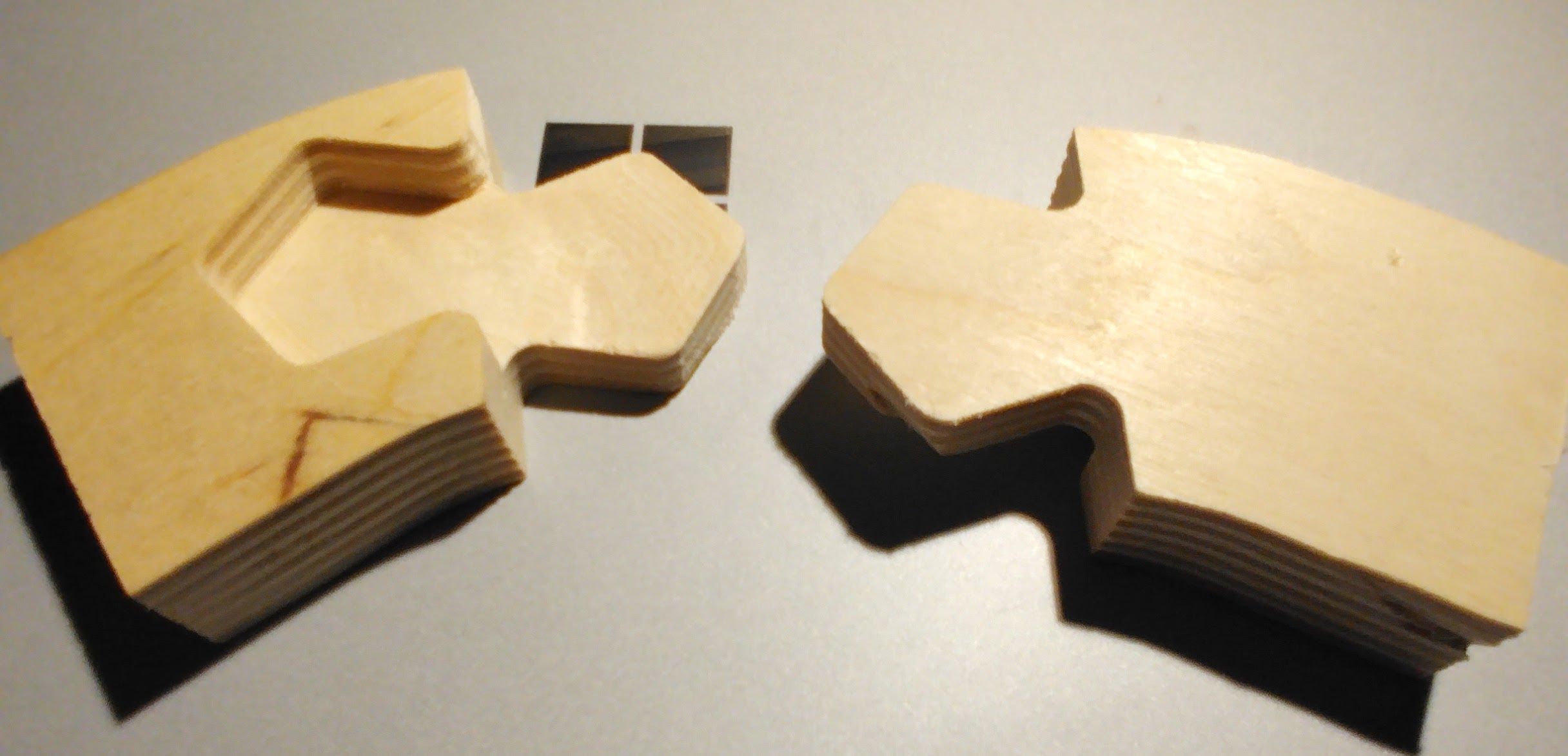

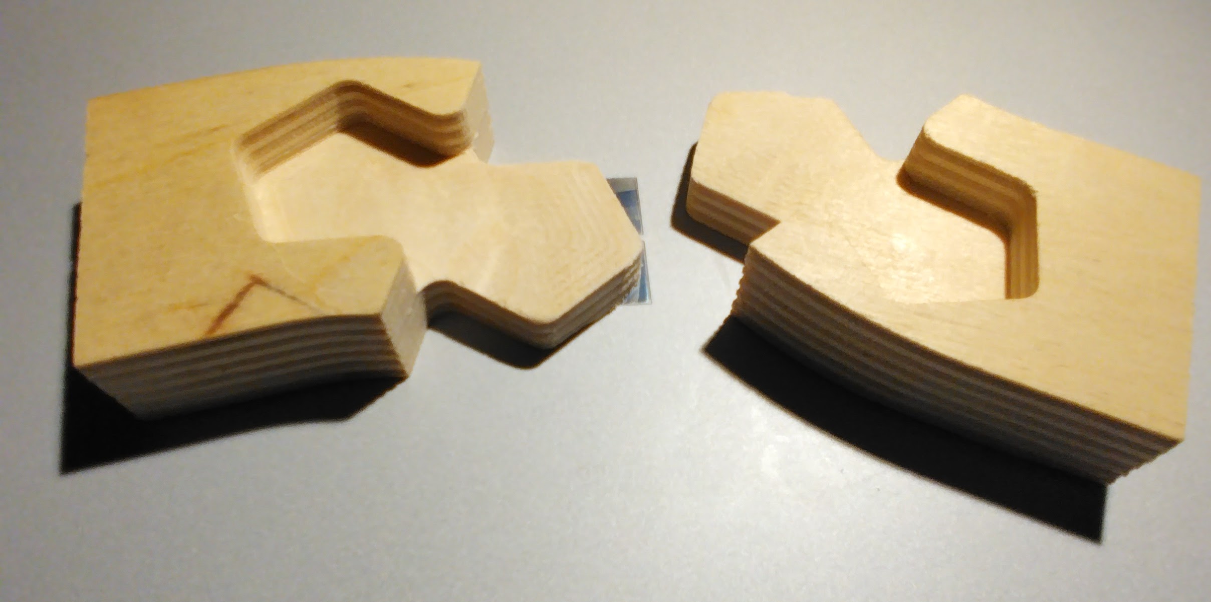

I took your file and made a few changes, but the outline of the objects is exactly as in the original (although 1 is flipped).
jointtest.c2d (96 KB)
I created new toolpaths to avoid slotting. There’s a pocket for most of the depth, then a contour to leave tabs.
My (admittedly small) experience with trying to create mating edges is that it will work a bit better if you offset inwards by a small amount, say 0.1mm.
Also, some square ended mills actually have a tiny radius at the outer edge, or have worn a bit at that corner - if you don’t cut deep enough, the bottom edge will stick out very slightly, and on a tight fit it can be enough to mess things up.

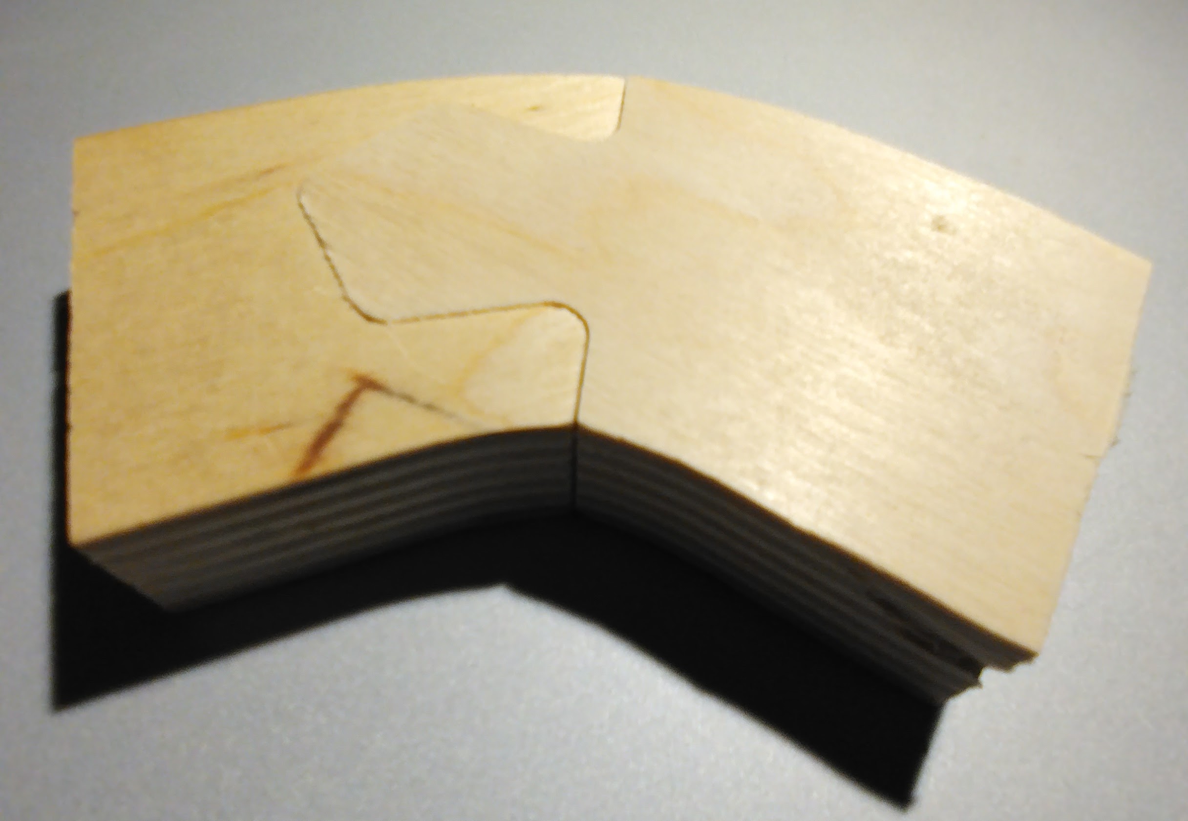

Michael: like day and night!
Google Photos
Thanks!
I never would have imagined that the pocket-contour “trick” would be that important!
Mission accomplished:
Wouldn’t have been possible without you, you all.
