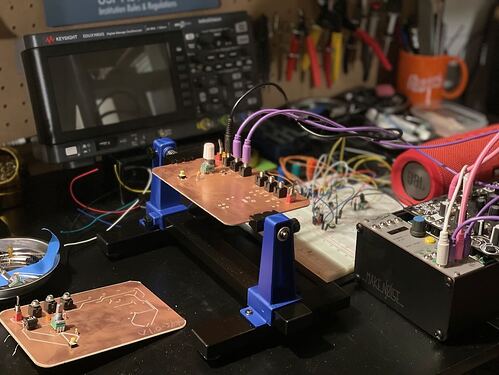

I’m getting closer to my goal of building my own musical synthesizer instruments (almost) completely with a Nomad! Enclosures and knobs are the easy part. But machining PCBs are something else entirely. I made some progress last week on machining my first PCBs. Definitely requires a bit of optimizing both the machining parameters (feeds and speeds, currently using 501/502 engravers for FR1 copper clad), but I’m finding more work is needed on the layout/design side (optimizing trace widths, spacing, isolation passes, and pad sizes to allow for easy component assembly and soldering). Once I found a good set of design/machining parameters - being able to modify a pcb design and machine a new board the same day is invaluable for quick prototyping of early circuit designs!
