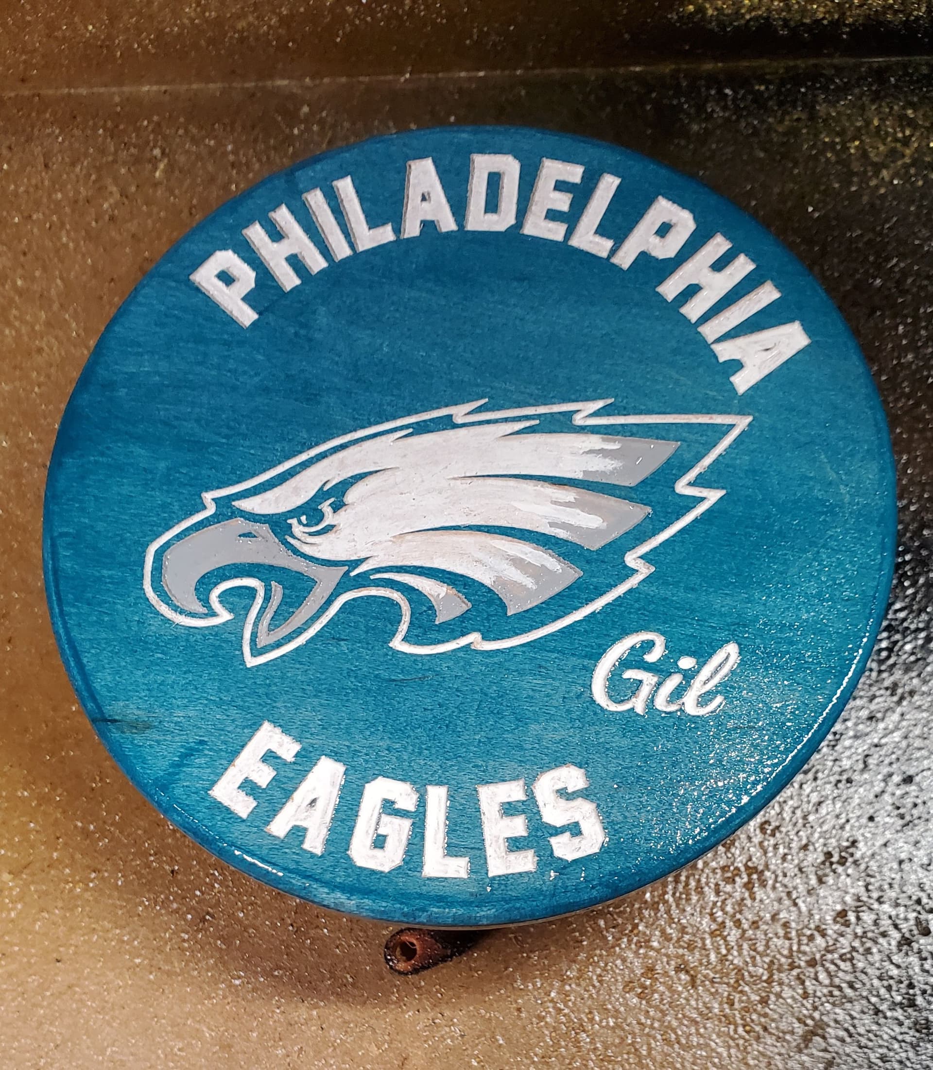

EAGLE NEW.c2d (68 KB)
Here is one I did not too long ago.
Eagles 2.c2d (224 KB)

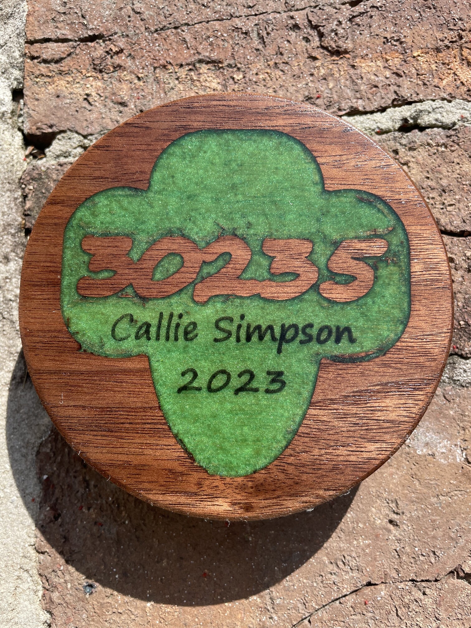

I made an attempt to continue to learn after messing these coasters up: What did you cut on your Shapeoko/ Nomad today? - #2133 by CullenS
Something went wrong with the Z on that and I never really figured it out but I forged ahead to finish the process and gain some experience.
I vcarved names into the green epoxy and then layed in a layer of black and then flattened again. Due to the issues with the Z earlier the tool numbers look blurry and in spots some wood is showing through because I didn’t clean it all up given that it should have been buried in the epoxy.
Anyway, a few coats of laquer and they turned out ok. I will remake and watch that Z more closely.
Certainly not what I aspired to for my first epoxy job but I will keep going.

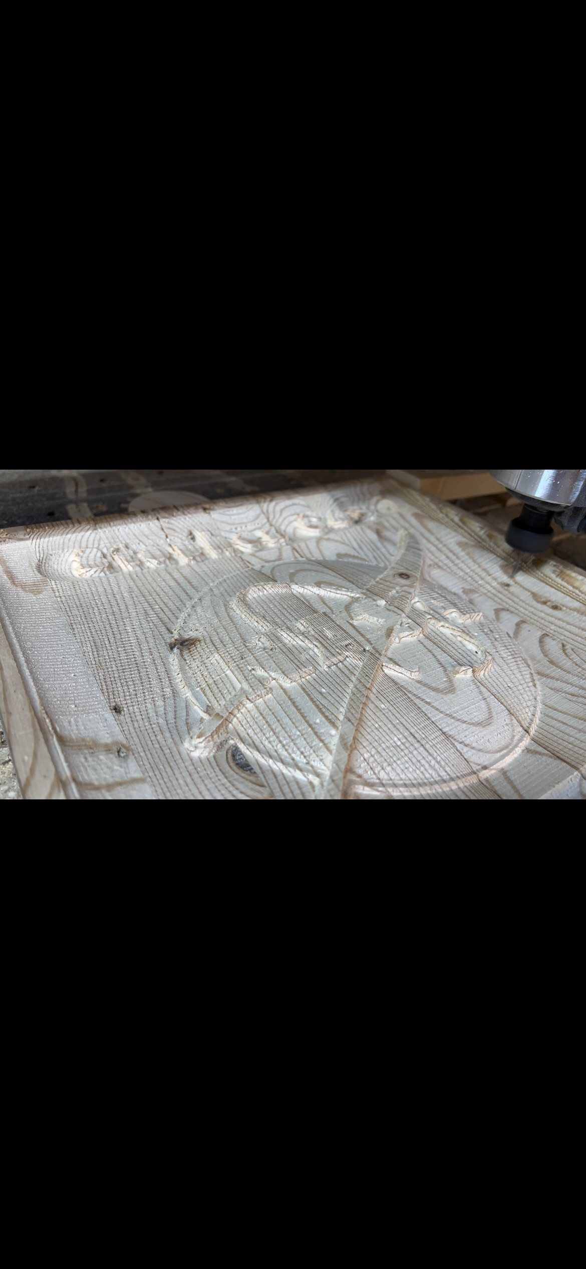

Finished this one yesterday. Just a fun one to put on top of the front door. My wife and I always wanted a sign like this. We always like to tell folks it means, Welcome to Our Home :joy:

Did you cut the outlining pocket and hand-paint the details?
Yes, this was just a pocket job for the majority and then a light contour trace on the leprechaun with the V-bit. I did a natural stain on the whole thing and then handpainted the details. The cut was very fast, but the sanding and painting took quite a while.

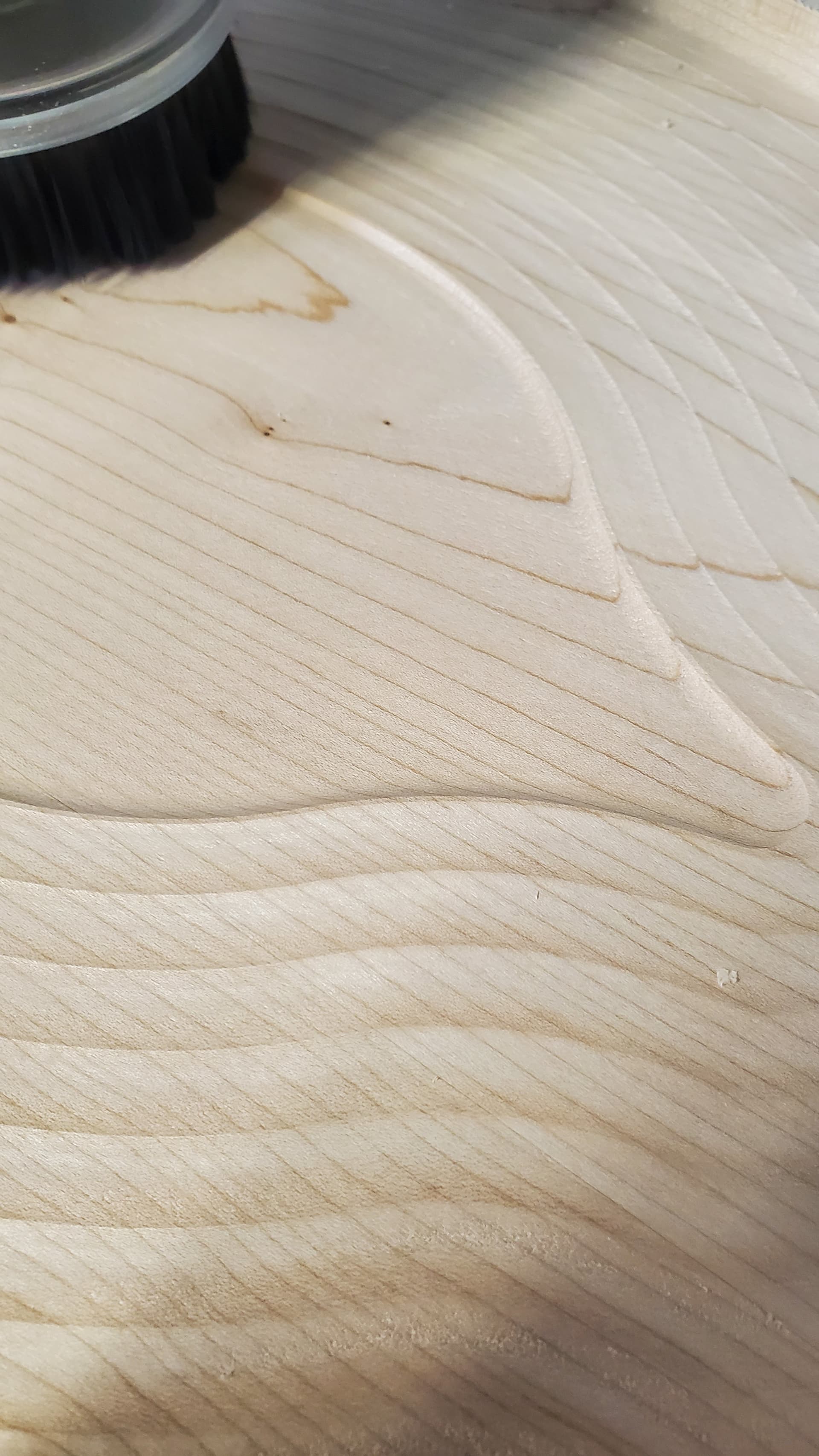

Then I made some random trays out of Maple and Walnut:
Cutting Walnut was like butter… super enjoyable. The Maple was much harder and required slower speeds.
I made the inner fillet .125” so I could use my .25” ball endmill. Id prefer a larger fillet but didn’t want to bother with it on these ones. Since then I made another tray out of pine with a larger fillet and used a scallop tool path to make it happen. It turned out well but I screwed up by thinking I knew the materials exact thickness so the outer roundover didn’t turn out as tangent as I’d like:

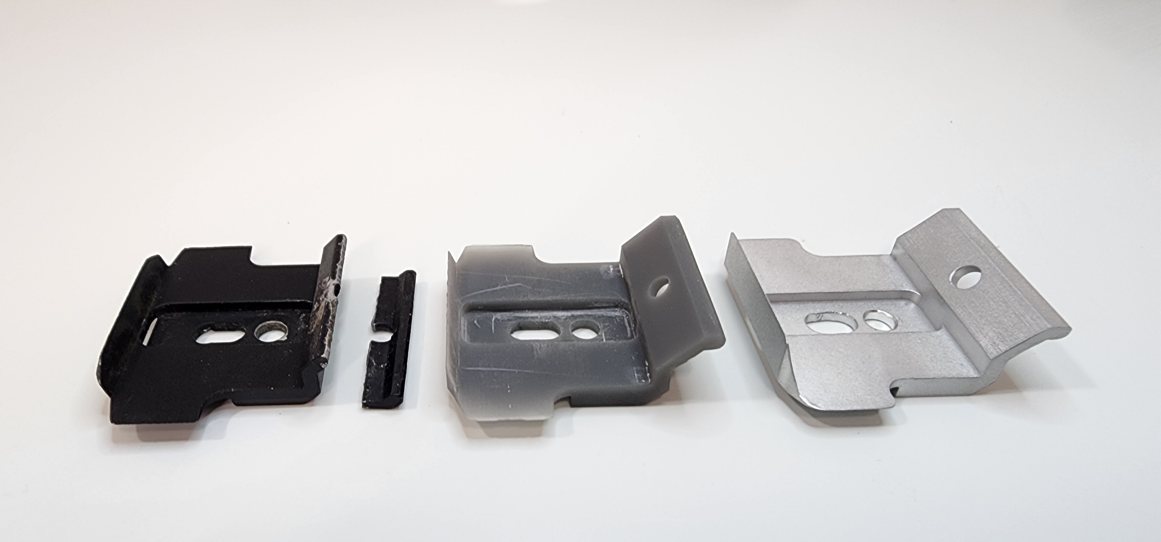

3d printed prototype next to the bottom side of its brother in aluminum.
“finished” parts.
I screwed up my stock thickness, and resulted in slightly screwing up this part, but overall came out well, certainly for a first prototype.
the original part is definitely some form of steel, and the replacement is 6061 aluminum (extruded 6061 off ebay, which definitely twisted a bit…which was annoying, but the way my bank account is set up, i got a checking and a savings…and all the money is in the savings…so no MIC6 or similar for me.)
both parts on the car, new & old
as you can see, the protective clear wrap has seen better days, so i figured while i replaced the wrap, would reverse engineer this protective bushing since as far as i know they are discontinued (problems with owning a sky…)

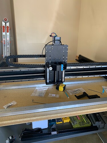

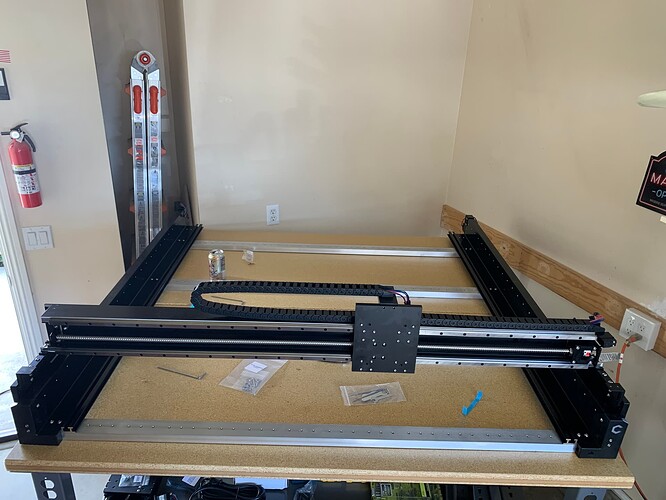

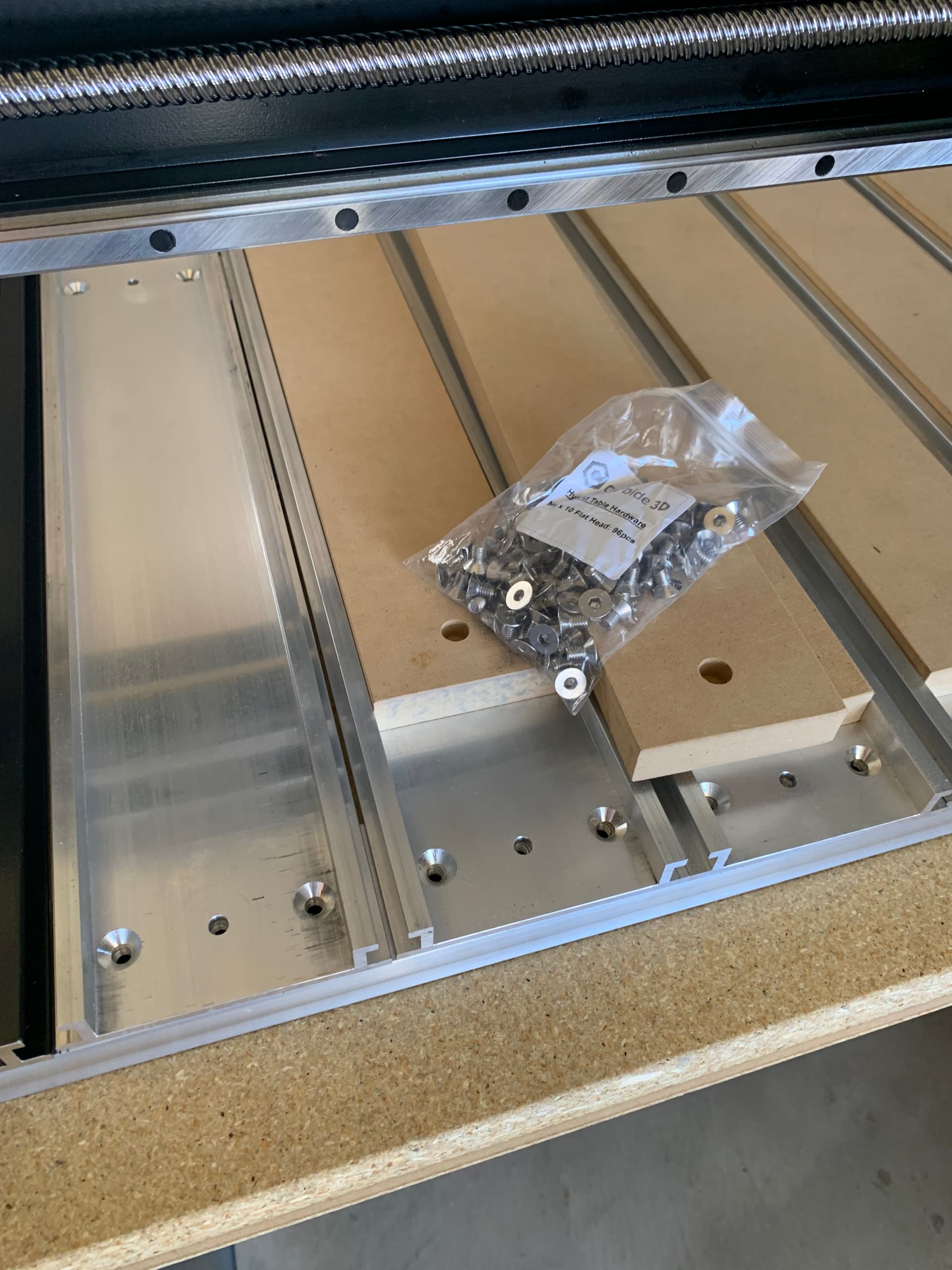

Finished. Made a separate thread.

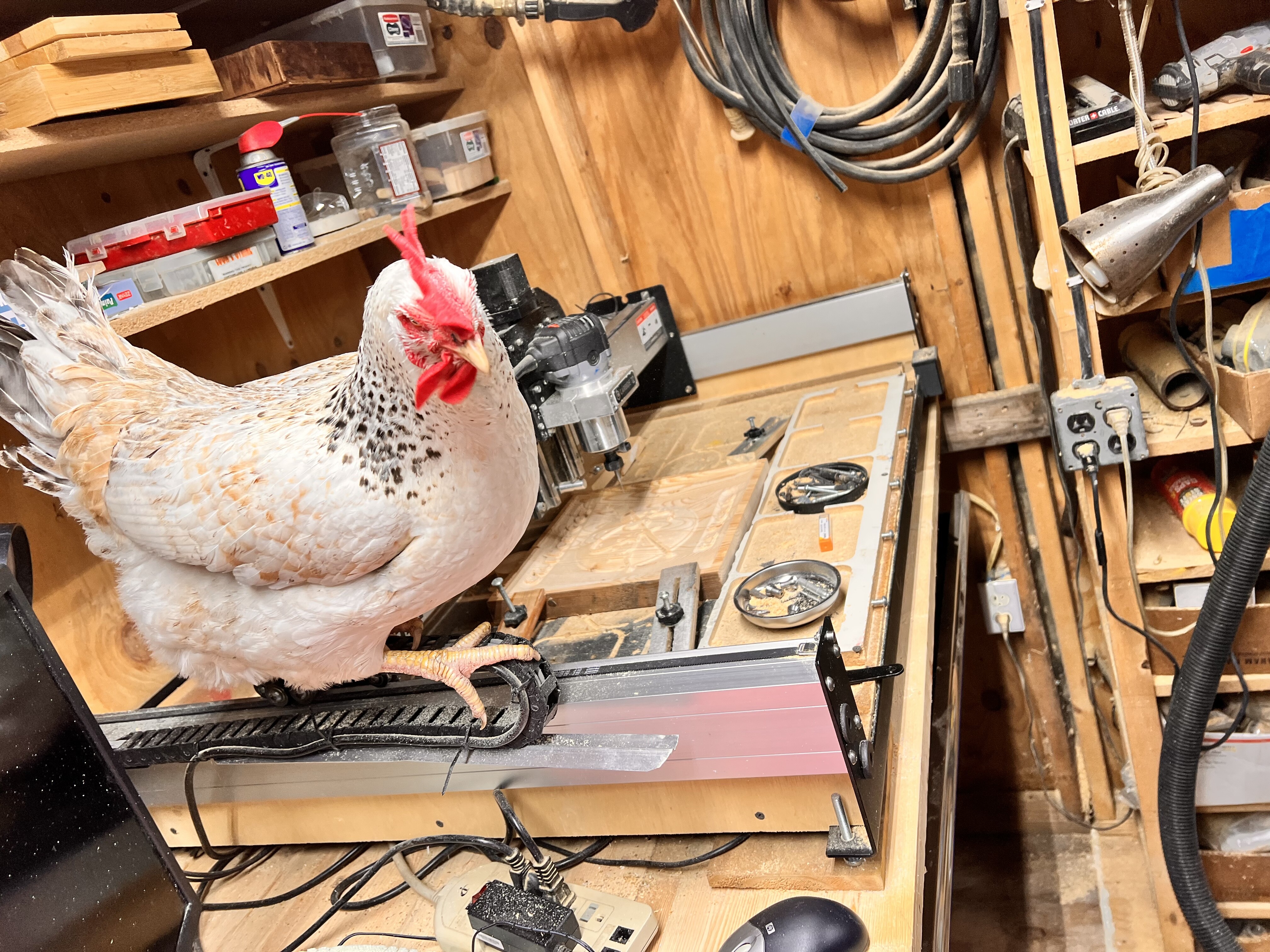

When the grandkids are over, papa makes eggs
Then the drag knife gets stuck & I have to keep putting it back in the holder :laughing:
Machine decorated for Easter. Cutting red HDU makes pink chips

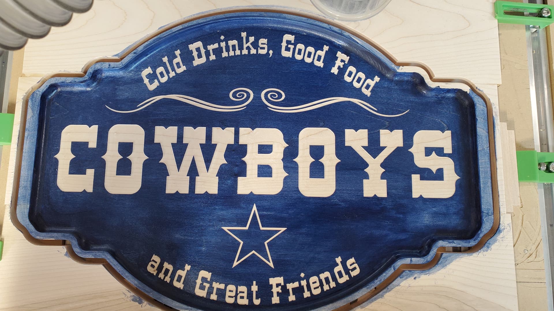

Then I made a sign for the bar owner down the street

No idea what you paid but you might want to check out Midwest Steel. Here’s a link quoting pricing for their version of Mic6, ATP5, 4 each 6x6 pieces of 1/2” ATP5. $10.85 per piece.
Sorry, misstated, you fill in the blanks on the linked page.
