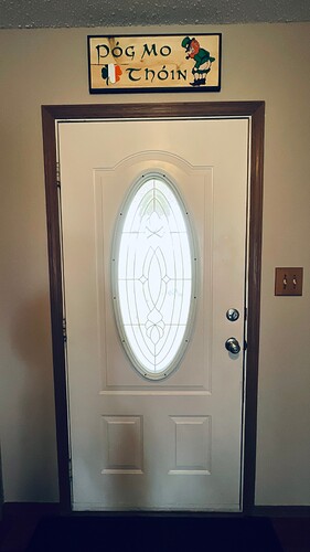

Finished this one yesterday. Just a fun one to put on top of the front door. My wife and I always wanted a sign like this. We always like to tell folks it means, Welcome to Our Home :joy:

Did you cut the outlining pocket and hand-paint the details?
Yes, this was just a pocket job for the majority and then a light contour trace on the leprechaun with the V-bit. I did a natural stain on the whole thing and then handpainted the details. The cut was very fast, but the sanding and painting took quite a while.
