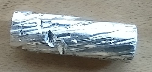

So this is my first double sided job! Kind of excited on how it turned out. Also learned lots… Like make sure you account for your alignment pins ;). Yeah that scared the shit out of me…
So the pin… I am standing there and I hear an ungodly sound from hell and see something shiney fly! I hit the pause and shit off my router and go over to fine the pin missing. I look and look and look and can’t find it. Then I found it tucked up under the price down in a t track. Can’t get it loose or moved I figured I could fire back up since it’s clear.
Nope… Turns out my vacuum sucks… It picked up the pin out of it’s wedged hiding spot gets stuck between the spinning bit and shifts the piece. Yeah that for the estop button… Ran down to the hardware store, no screw to fit the aluminum spacer, and pick up a screw. Came back, checked the bit, aligned the board, pulled the alignment pins. :wink: And the rest was mostly uneventful.

I find the 1/4" grooved wood dowels bite really good. I cut to the length needed and if I hit one, that’s OK. Something about a metal dowel near my tool path never felt good to me.

It was a learning experience for sure! In my mind… The metal pin was week clear. I actually machined the first side and got no where near but… The tabs I added were smaller than I thought. I now will post attention where everything is a little closer but… The wood dowels are a good idea and if your so goof you should be good…
