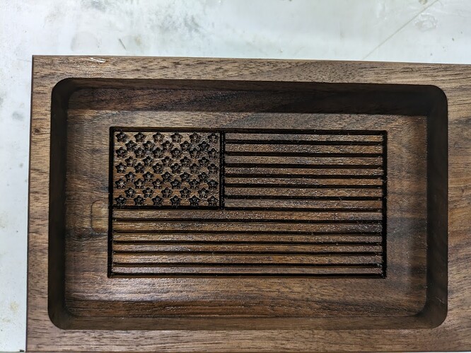

The catchall trays are 4" x 6" and various depths of .75" to 1". Attached are the files for the catchall trays I have machined. Basically you secure your work and cut a .5" deep pocket. Then use a vee cutter to make your design. I use Inkscape to convert google images to an SVG. Then I start the vcarve cut at .5" and use the bottom of material as max depth. I mostly used a 15 degree vee bit.
catchall_trays.zip (1.4 MB)
Some of the files in the zip have not been machined yet and may be too busy for a good result. So look at each image and determine if you think you can use them.
These have been made and came out good. I used Watco natural oil for the finish.
Check the files very carefully. I think I used top but sometimes use bottom of material. All should be using center for origin. Obviously you can make any changes in size you want to make bigger ones. The images are far enough away from the sides so the router collet does not hit the sides during machining.
Enjoy.
Edit: Got more cut out today. One is cutting and 2 more in the pipeline. Trying to get these done, sanded and Watch Natural Oil so they are finished.
