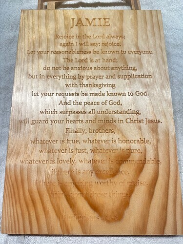

I made this wall hanging as an encouragement gift for a friend.
I’m very happy with how it turned out!

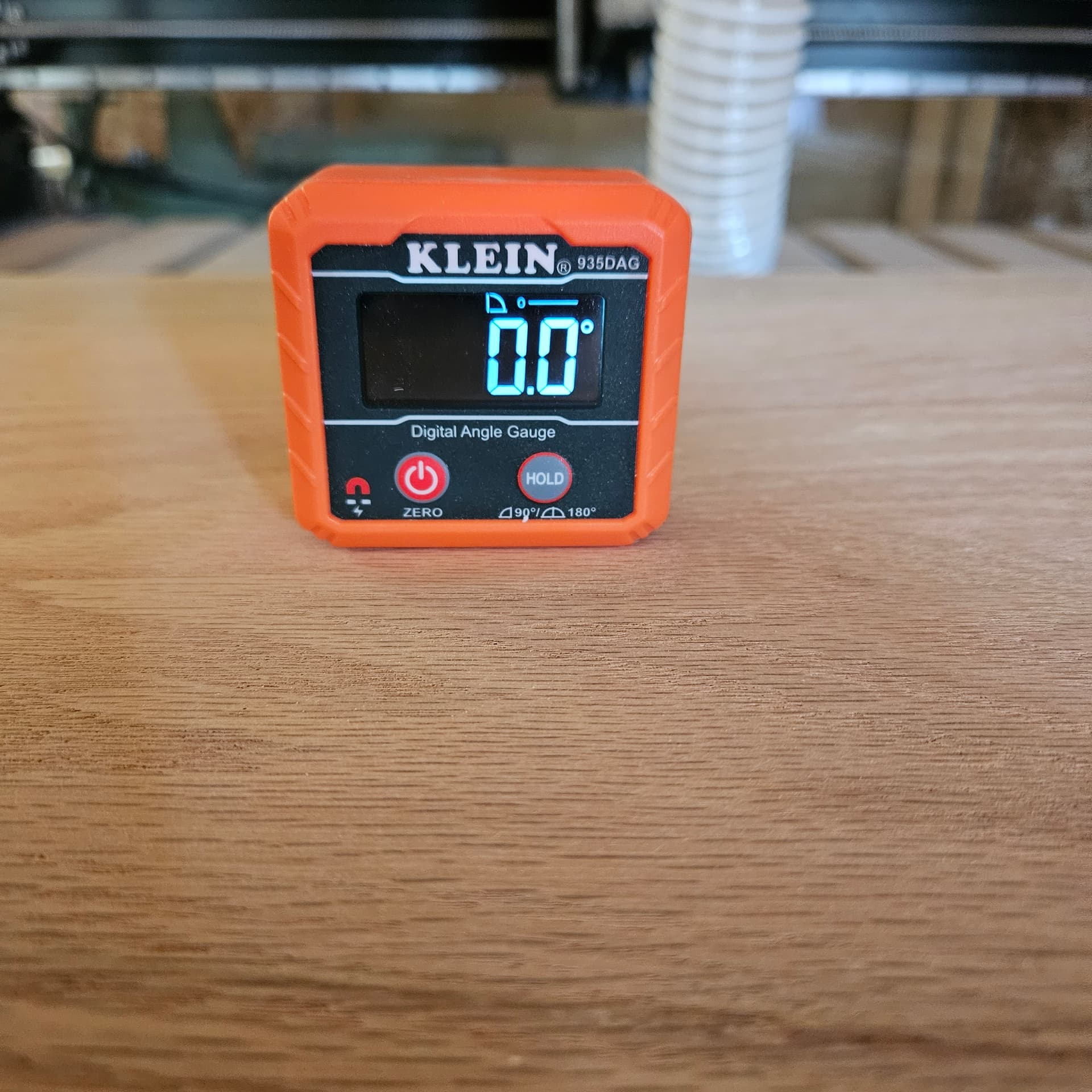

I had taken great care in plaining and sanding this fairly large 2.5" board 24x16. Flat is so important. My table is square and flat but the concrete floor it can wheel across does change slightly. This means i check table first for level. This current position im out 0.3d. Therefore my board must be at 0.3d to be flat in respect to the environment.
All went well minus the last verse on the bottom left. It scribbed in the air mostly. A small dip in the board. At the end of the project I reset zero to the specific troubled issue. Then disabled everything except that verse. Fingeres crossed while holding the E-Stop it worked!
Minwax 210B Golden Oak for finish
(The picture shows level at 0.0 but i shimmed it up for the picture. I didnt feel like explaining it to those who dont care haha). One of my favorite tools :slight_smile:

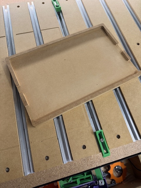

This is my first CNC project after getting my Shapeoko 5 set up (minus a couple screws I’m waiting on).
IMG_7088
I got a cheap 15.6" portable monitor to connect to the Raspberry Pi running Carbide Motion but it didn’t have any mounting options. I modeled a base in Fusion with slots for the fans (or maybe they are speakers, I couldn’t tell) and IO ports and cut it out of a piece of MDF. Then I created a drawing for the acrylic screen cover and cut that out.
The Shapeoko worked flawlessly and the MDF part was simple. I haven’t worked with acrylic much and things fell off a bit there. I think the acrylic flexed a bit while cutting, and I still need to tram, but it left a half MM of material on an edge which was a pain to get off cleanly. Then I decided I wanted a couple more bolt holes than I originally cut out and foolishly used an automatic center punch near one edge of the acrylic and sent a chunk of acrylic into some unknown corner of the garage.
It was a fun, simple first project to start learning the workflow and I’m still happy with the results

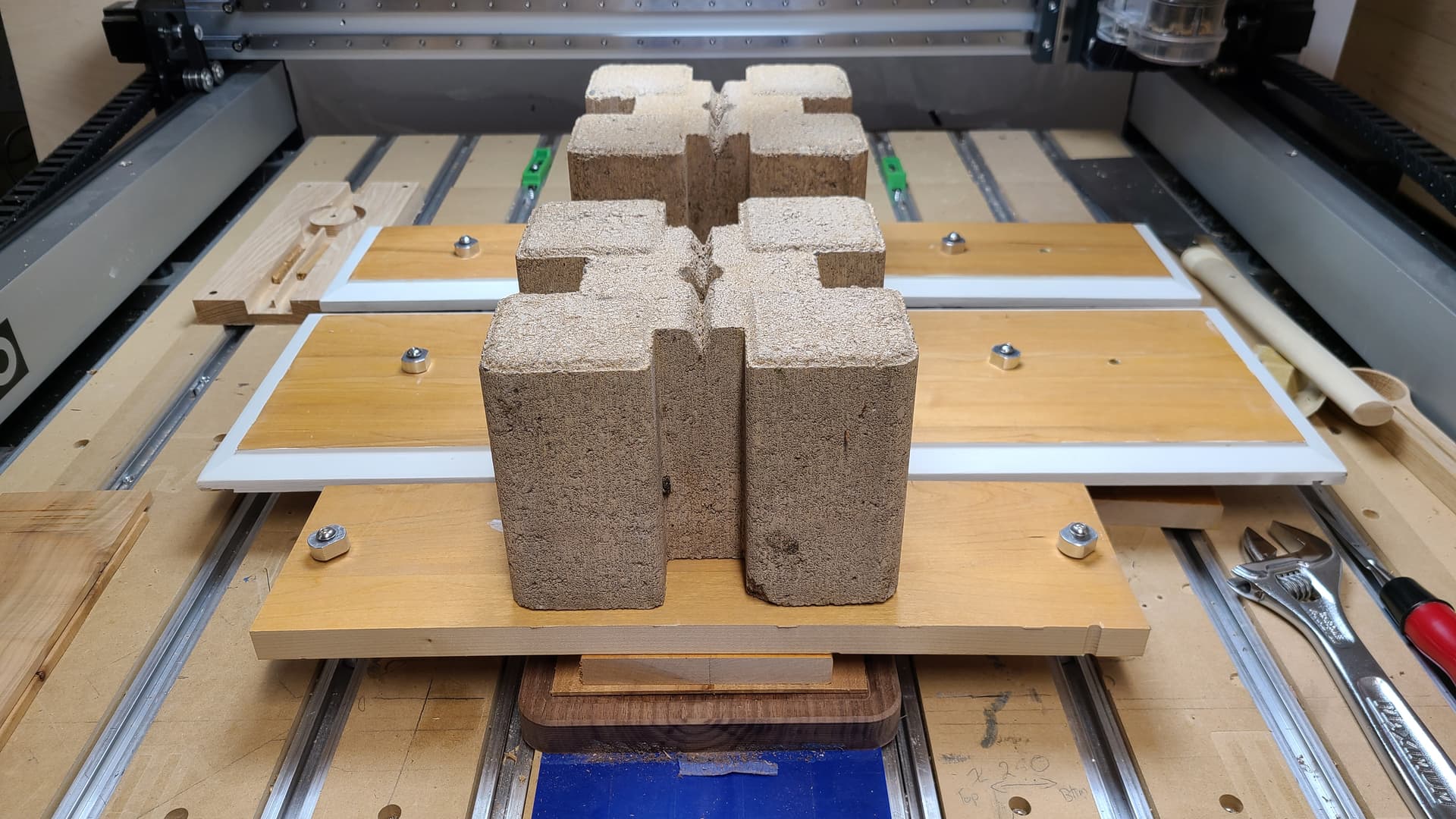

Work in progress but cut out a text inlay plug tonight, not sure why but these text inlay’s are the most stressful to watch… Took me 2 hours to cut this out but the fine detail look pretty good, slowed it down to avoid chipout. I’ll say cherry cut way better then the roasted maple I used last time which was just brittle and prone to chipout. Dry fit locked into place with 1.5mm spacing between the flats of the sign and inlay backing material. Anyhow spread the glue, set the text inlay plug into place and clamped it down on the hybrid table. Tomorrow I’ll get to see if it’ll be a success or if I’m milling out 3mm of the sign and redoing the engraving with masking and paint… Fingers crossed!!!
EDIT: So I snuck out to the workshop this morning because I really wanted to see the result. Still have some sanding to knock down the text flush with the surface and I did notice a few characters that will need some repair work but I’ll scrape out some of the voids and fill with glue and sawdust from cutting the inlay plug. Also noticed that the characters that chipped out are closer to the center, I’m thinking the clamping using the hybrid table was my issue because I’m pretty sure the wood clamps bowed under pressure and had more clamping force on the edges then in the center of the sign. If I use this method again I’ll need to consider using a board with a flat side and on the other a curve to try and correct this. Ideally I’d be using a hydraulic press like my uncle had in his workshop but I don’t have the space for one of those. Anyone use the vacuum bags for this, I’ve seen people use them for veneers but thinking it may work for this and much easier to store away.
