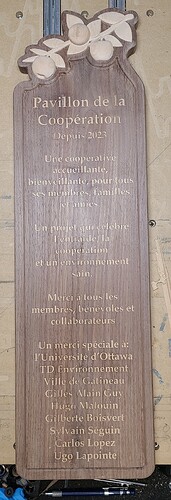

As for how I cut out my inlays I use the Engrave toolpath in Fusion 360 which Iām assuming works like VCarve in Carbide Create and use a 60deg vbit (Amana RC-1148 is what Iām currently using) for general use but when I do an inlay with very fine detail Iāll likely experiment with even pointier vbits to avoid having inlay pocket that are too shallow. When there is fine detail in the carve often end up doing multiple stepdowns because Iāve had more problems with chipout (pieces tearing out) when going full depth at once (for text this applies more to the plug (male) then it actual carve (female). Now I know some methods leave a glue gap but for this inlay I didnāt, and simply followed the exact same contours as the initial carve. I also let the vbit go to a bottom depth of 2mm to 3mm deeper then the inlay contours. Once the toolpath with the vbit is done I then use flat endmills of varying sizes to clear our excess material remaining between the inlay contours to a bottom depth about .5mm to 1 mm higher then the bottom depth of the vbit. This way if any material wants to tearout it likely will not affect the male part of the inlay plug and stays contained to the grove left behind by the vbit in the first toolpath.
Now I am noticing the glue seam leaving a shadow effect around the letters in this latest inlay attempt but Iāll attribute that to my poor clamping method that I used this time around. Usually I remove the project from the CNC bed and sandwich the inlay/project between scrap boards and clamp down hard using many, many clamps (ideally Iād love to have a hydraulic press but space is at a premium).
I grabbed Titebond III Exterior glue one time on a test piece. That glue dried a brown color and did look like a shadow. Titebond Original Interior glue was essentially clear.
The better the fit of the inlay means that there is less of an exposed glue line to see. Your project is very ambitious in that it has all those letters. +1 for making it look so good.
Another thing I should have maybe done was not keep the inlay as a single piece and cut it between each grouping of text/paragraph and glue them one at a time using more clamps.
Canāt wait to get a finish on this and bring the grain and wood color to life.
I saw a similar box somewhere in the vast jungle of the internet and wanted to try and make my own. It was fun taking the stock right off the machine and being able to do the glue up without any serious work. Super happy with it, despite some chatter in the pockets, but I donāt know if itās entirely avoidable with a 1/16" bit in this material without doing a light perimeter pass at depth.

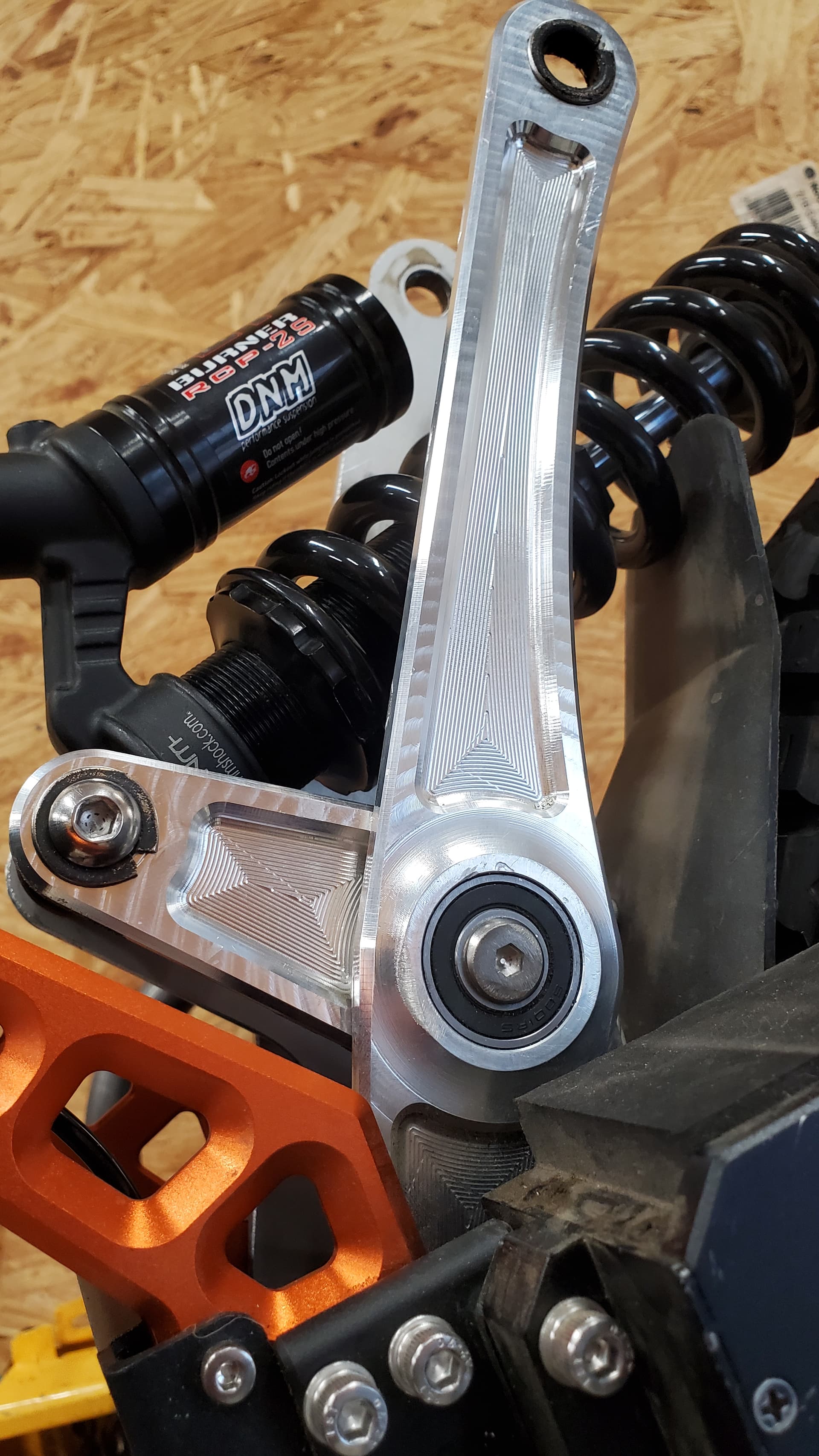

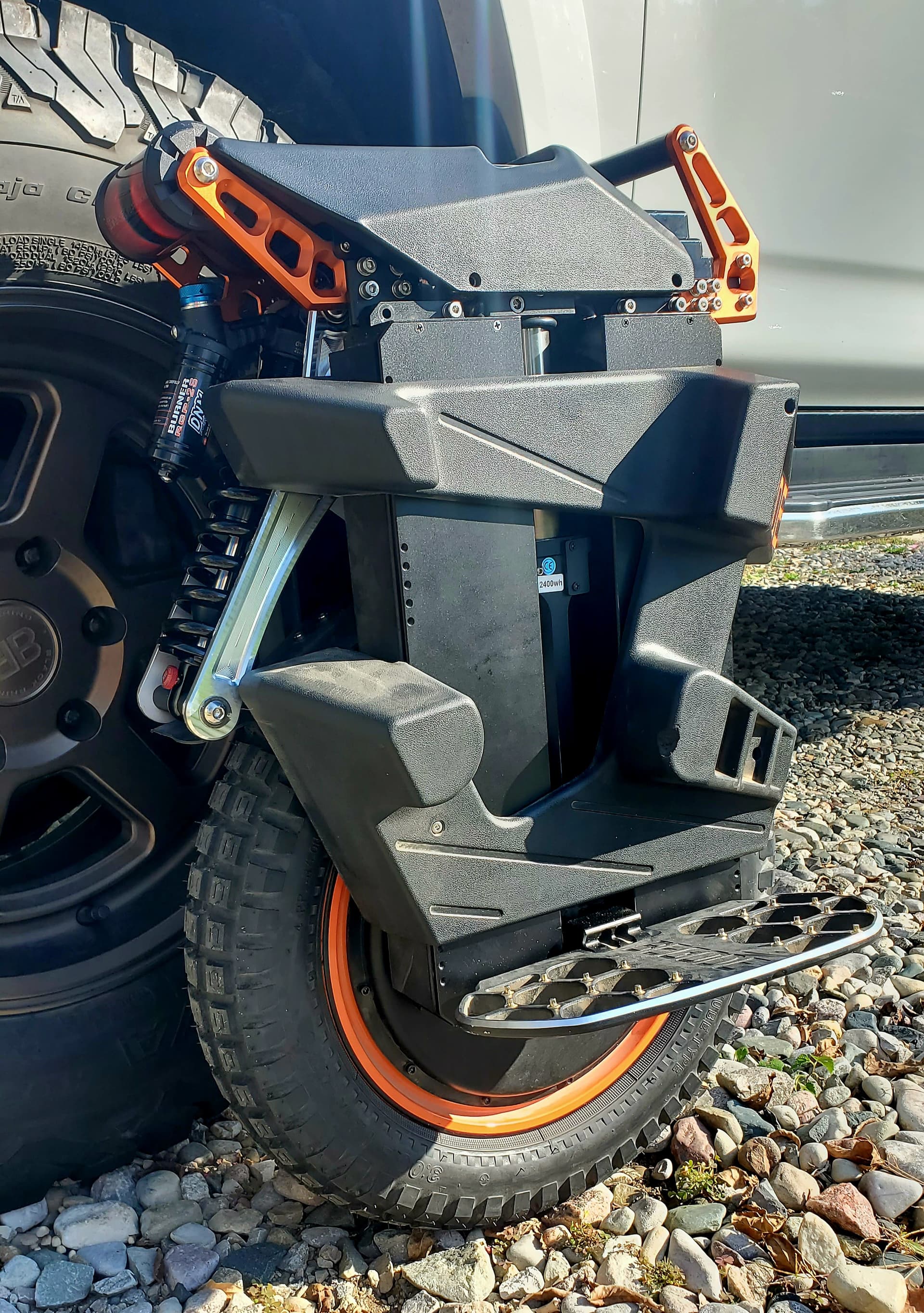

@LiamN this is my current baby. Begode Extreme, 134 volts with 115mm suspension travel. I redesigned the linkage to make it rising rate with a much better rate curve than factory. Yes, Iāve taken it off some sweet jumps

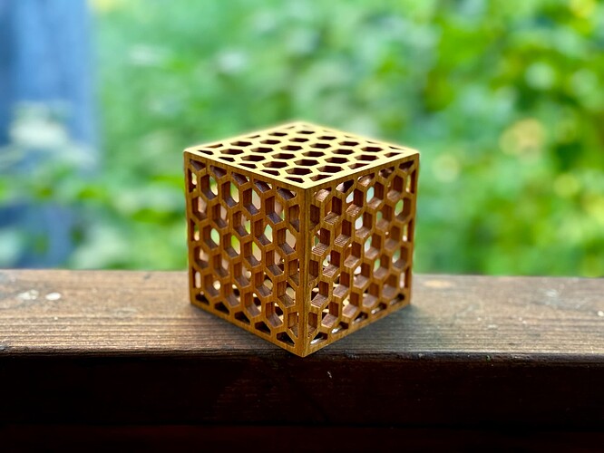

The hex grid edges are .065 according to the calipers. The wood is Sapele, which is pretty stable. I remember it looked really thin and delicate when I was cutting it, but it worked out fine.
I like the thinner frame edges you got on yours better. It looks cleaner and more in line with the actual thickness. I think the wood I use is about .12 inches thick.

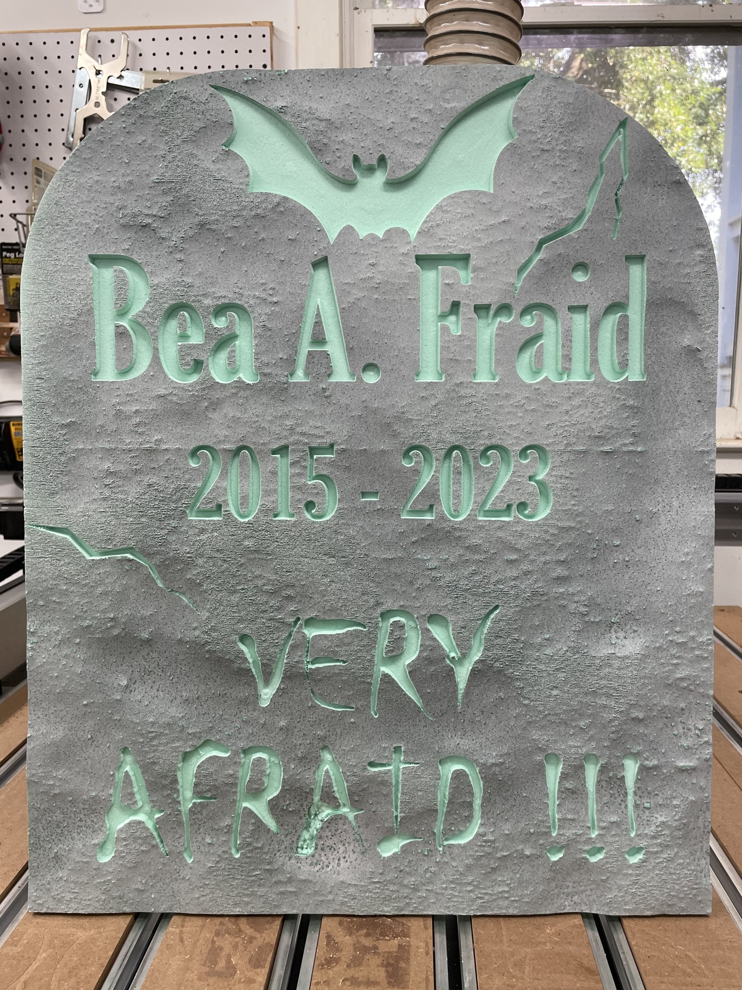

I wanted to make some Halloween tombstones for the yard. I bought some cheap $7 pieces of 2x2 foam at Loweās and some $8 cans of textured granite color spray paint.
The plan was to paint the foam and then put shelf liner on it , cut and then paint the cut portions in black.
I had no idea how this paint would do on the foam. Well, something in the propellant I guess did not play well with the structure of the foam. It caused the surface to deform in pockets such that there was no way the shelf liner would work so I just put it on the machine and cut away with my daughterās design.
In the end, the damage from the paint looks pretty cool. It looks more worn. Now we have to paint the cut portions by hand though. Several more of these to make.
BTW, it took 1 entire can of paint for 1 side of each piece of foam. I tried shellac on a spare piece and that didnāt mess up the surface, but like I said we like the texturing as is.
