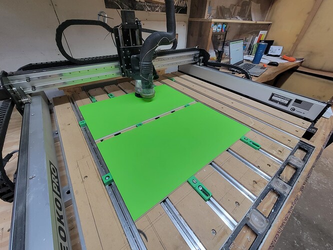

Very excited today. Used my Shapeoko Pro to cut out and decorate of front panel of a drawer I am constructing for a coffee server tray. The finger pull notch was cut out on the machine and well as the decorative touches on each end of the panel.
This is one reason I wanted to invest in a CNC machine, because you can easily and repeatably cut out elaborate pieces for multiple instances of a particular project. So cool; loving it!
Nice!
What sort of joinery are you using?
How are you cutting it?
Hey, Will.
So as not to mar the from drawer panel, I am relying on glue as the main joinery technique. However, the rear corners of the drawer will be re-enforced with small finishing nails driven into pre-drilled sockets.
The front panel will be further held in place with a glue bead along the front edge of the drawer bottom.
I used three tools paths in total. The first one cut out the finger notch with a number #102 1/4-inch bit. The two formal decorations were done with a 60° bit. I am recording the entire process and will be posting a video on YouTube. I’ll share the link when it is done.
I am not an accomplished woodworker, so I go to this site for inspiration on how I want to do it. 7 Wood Joinery Methods That Use No Metal Fasteners
With the face attached to the side rails as you have, you could do a Mortise-and-Tenon. It would give you a bit more strength.
Looks great Sir
Thanks for the link, Mr. Zman. A few days ago I constructed a jig to cut finger joints. I’m still working on perfecting its use and the results. I really love the sliding dove tail joint, but I think I would need more thickness to pull that off.
For the rear corners, I do think I will use 1/8" dowels for reenforcement.
Thanks again for the input. This forum is awesome for learning and sharing information. Much appreciated.
