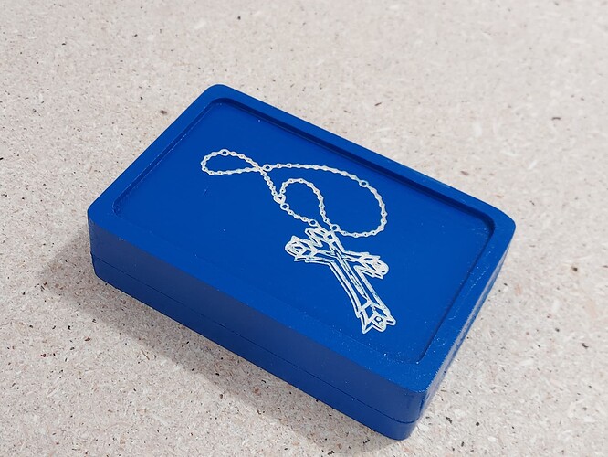

A neighbor asked if I could make a box for a rosery.
So here it is in the color requested.

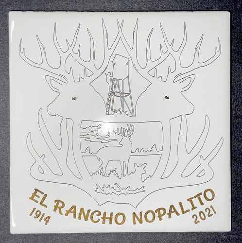

I’ve been wanting to do a tile or two with my recently acquired JTech laser. I’ve spent some time getting a proper mounting and offsets set (thanks to Gary @wb9tpg for the help). I found some old 12” floor tiles from our old house and did the ubiquitous “Aztec” calendar Darth Vader version. Wow. Just like Gilligan, I went on a “three hour tour!”
So, then to make a test on a more practical six inch tile, I spent about twenty minutes putting a design up, added a couple of light coats of plain old Rustoleum white flat and waited 20 minutes for it to cure (by the time I got my machine turned on etc. it dried about 45 minutes.)
The burn took about 20 minutes (a more viable candidate for duplication) and looked good, so I went to the next step. Using a light rubbing of acetone (I’m thinking mineral spirits would have worked just fine) I wiped all the paint off. The key is to stop smearing the liquid paint around at some point and use a dry paper towel to bring the tile’s shine back.
Then I wiped on some VERY thin amount of “Rub’nBuff” wax metallic finish on the lettering. (I couldn’t get it to stick in the tiny vector cuts.) As soon as the surface dried, I started erasing (yes, with a pencil eraser) around the letters. That’s why you want a very thin coating on the tile surface. I cleaned that up with a teeny-tiny amount of mineral spirits so it wouldn’t pull the color out of the letters.
I think this is a good representation of line art and certainly could be enhanced to be more “artsy.” The mechanics of it are as simple as I described, so its time for you to try it.
