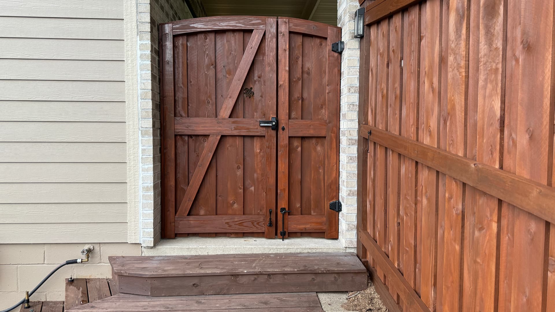

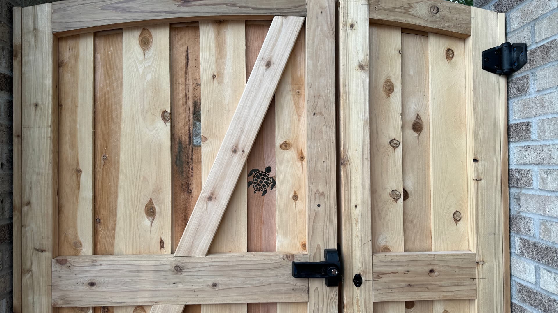

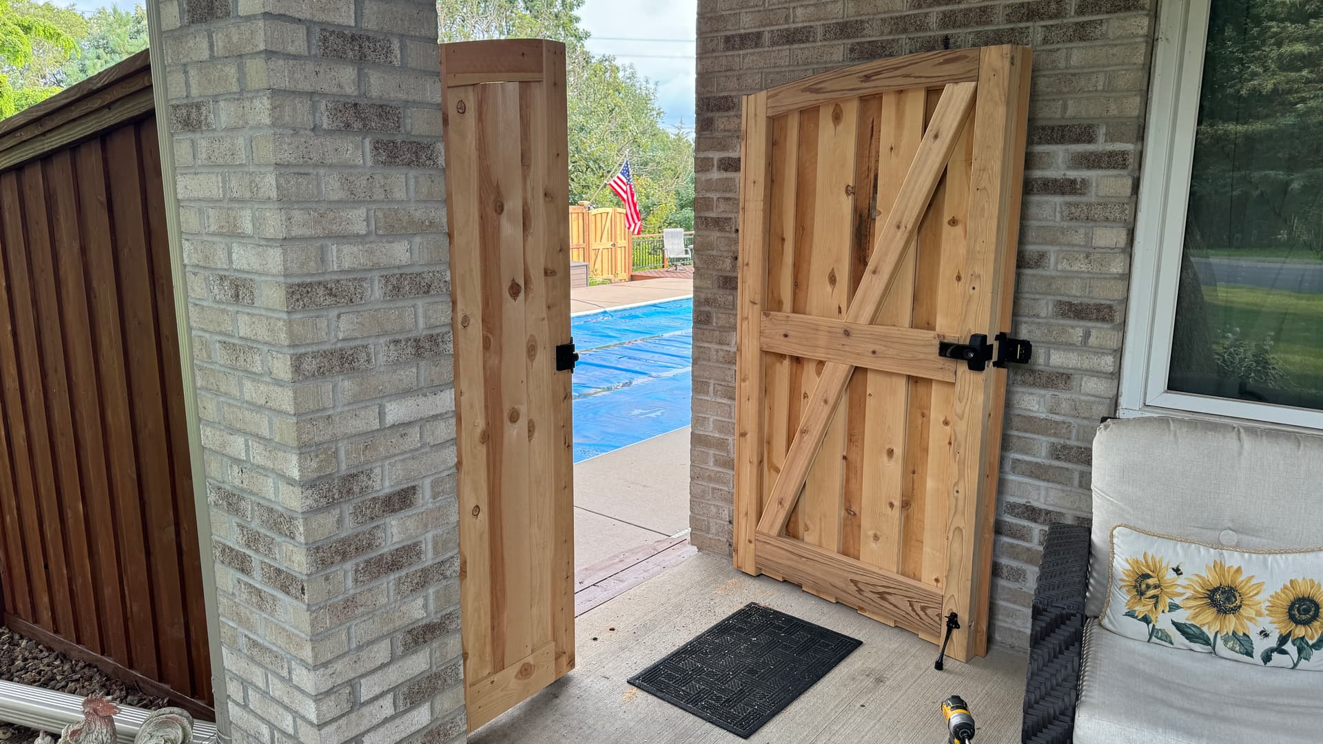

Besides the turtle i also did a pineapple and palm trees. Here is 2nd back gate with pineapple.
