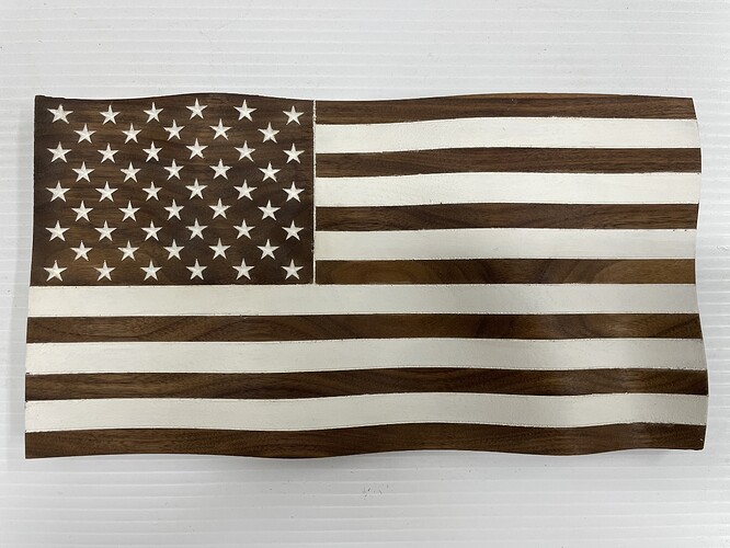

Project 2 for the weekend was a wavy flag using the files from @Merick01 I had not tried one before so I wasn’t brave enough to do a glueup and then the puzzle so this was just a plain piece of walnut 6.5”x12”. I wanted to validate the process. It turned out well enough that I decided to finish it with danish oil although I still need to add a clear coat. I simply painted the Stars and Stripes. It inspired me to do a glueup with the mixture of wood that he does though, so hopefully that will be soon.
I imported his STL and DXF into Vectric Vcarve. Mapping the vectors for the stars onto the 3D surface worked great. I am very happy at how sharp they turned out. I also mapped the stripe edges onto the 3D as after cutting the wave I masked and then cut the lines so I could remove every other one to paint the white stripes.
The files from @Merick01 are great.
