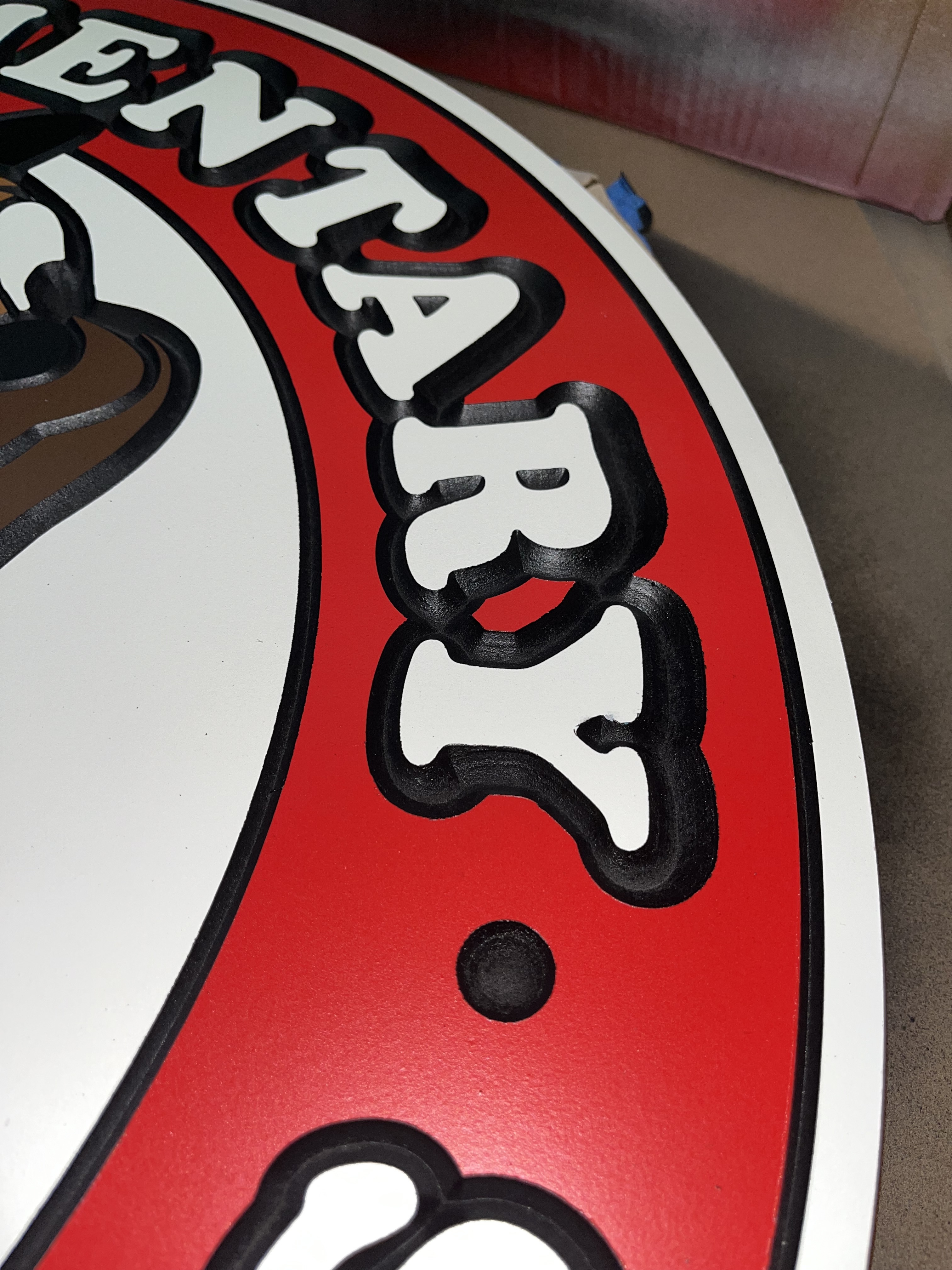

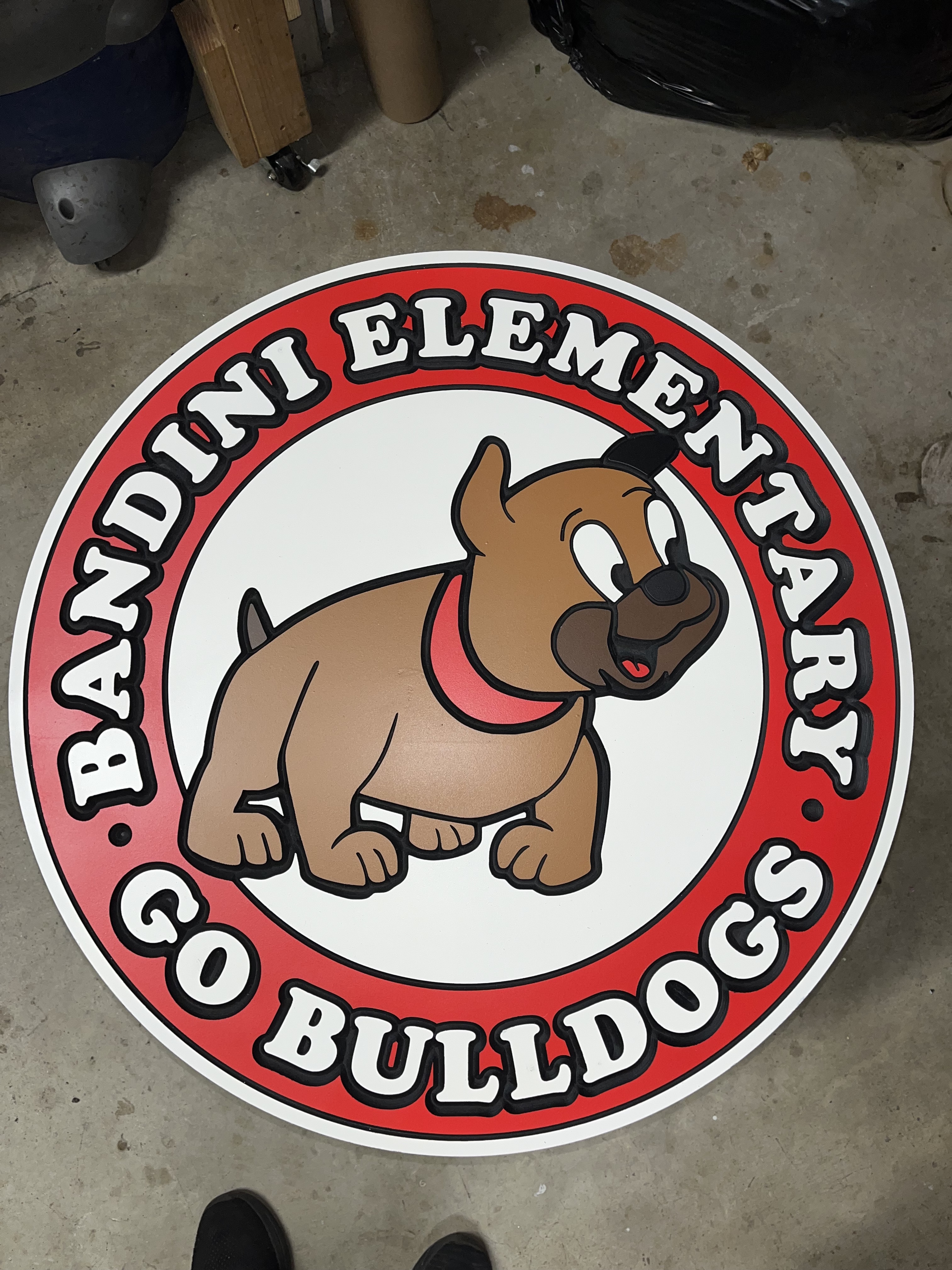

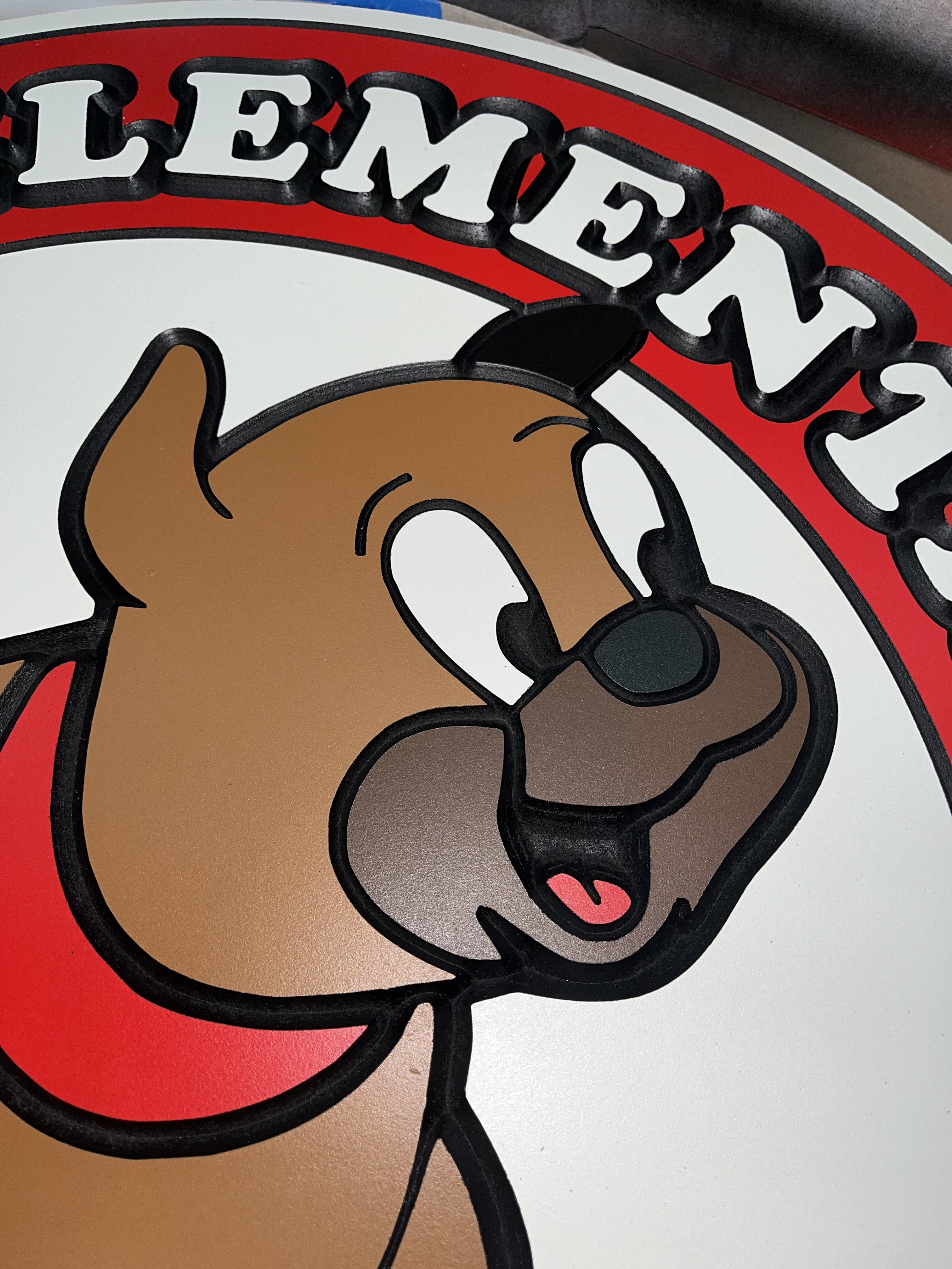

I made my first 3D project with CC Pro. It’s a tray of sorts with a local school’s logo. The school asked for donations for an auction, so i figured it would be a good way to do some market research.
I used 8/4 cherry and finished it with wood honey.

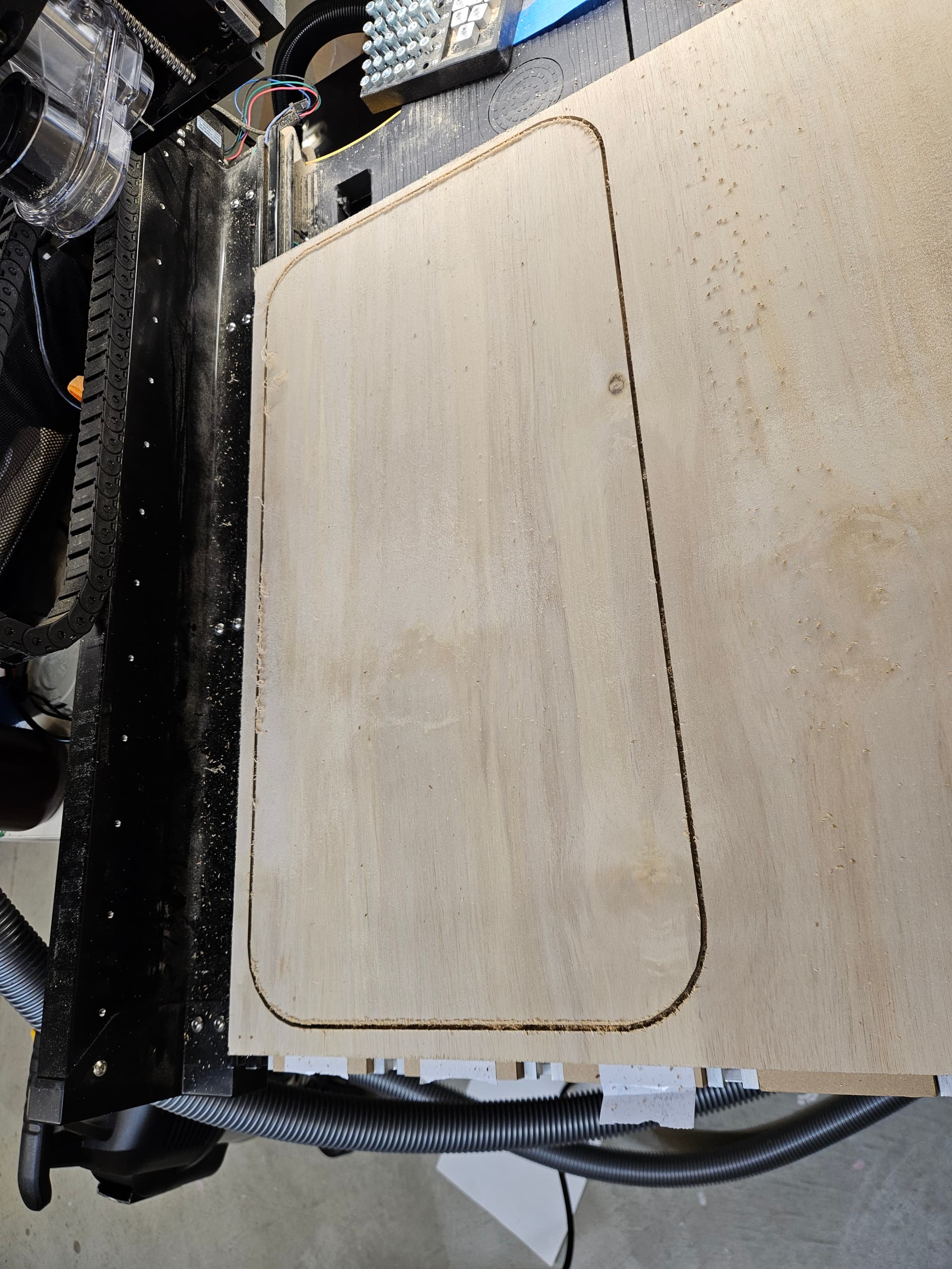

Started doing Hyrox, wanted to get a wall ball target to train at home.
The prices of metal ones online were too high so designed and cut one from ply.

May i ask which bits you used for the bowl and roughly which speeds? Just curious.
Sure, happy to share.
I used the 90 degree V for an outside chamfer. It makes it easier to round over the edges later. I used 500/2000/24000 for plunge/feed/RPM.
The 3D roughing was done with a 1.5" McFly-type B216 bit. This one was a little tricky on speeds. I slowed down the plunge rate to 30mm/min to make sure it didn’t stop my 65mm spindle. Once down, feed was at 2000mm/min and 20,000 RPM. When I put in 18,000, which is technically max for the bit, my controller showed only 16k RPM.
The 3D finish was done with the 1/8 ball end mill. It took a minute and I did many hours of sanding to get the ridges flat, except around the logo. I used stick speeds this time as i was worried I’d snap that little mill any second.
The cutout was done with the trusty 201 1/4 mill at 500/2000/24000.
If anyone has ideas on how to ‘quickly’ sand the ridges from a 3D concave area, with a protruding logo and very conplex inner outlines, I’d be grateful.
