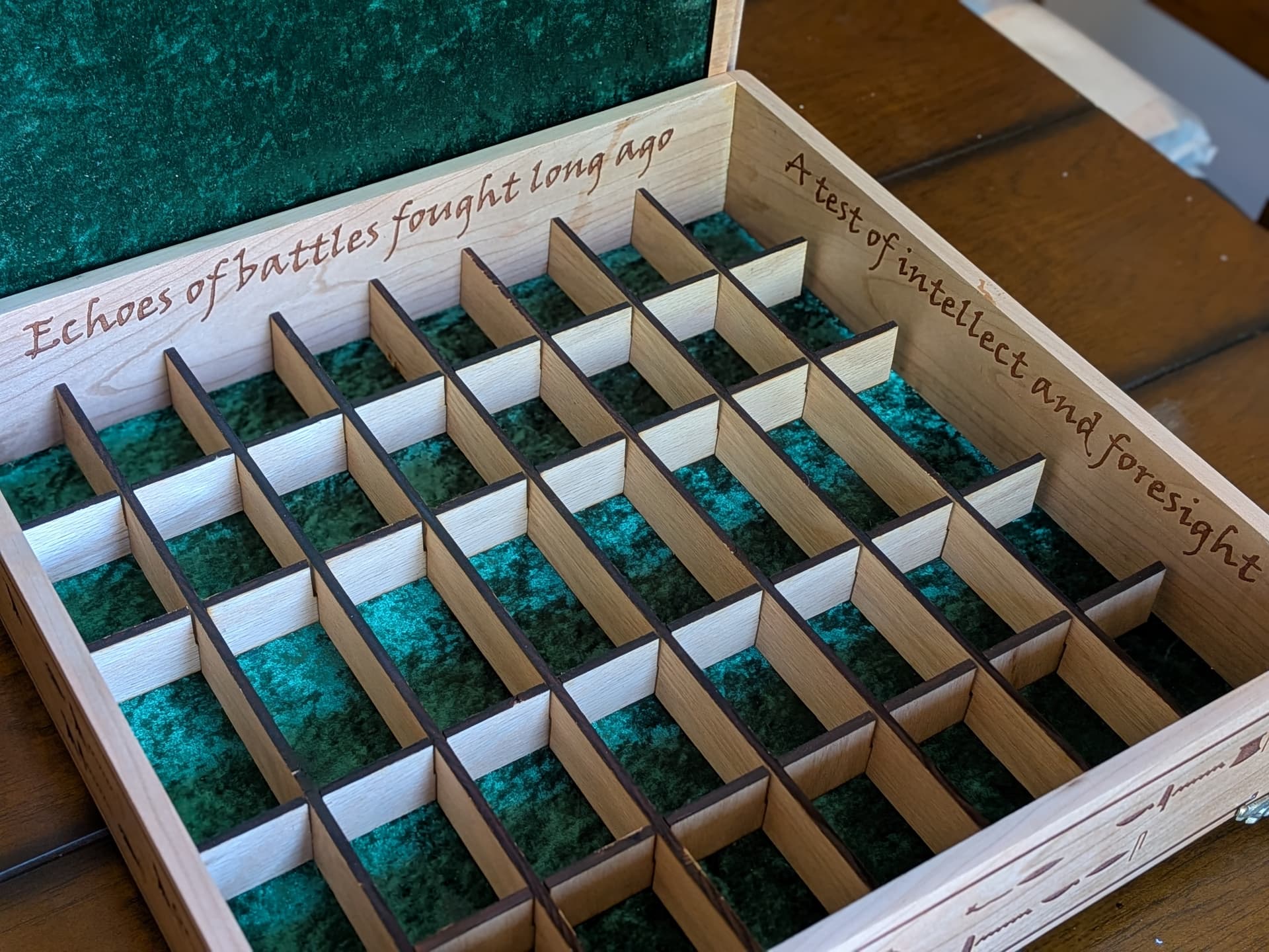

I’ve been working on this 3D train design for a while now and finally got it to where I’m happy with how it turned out. One minor adjustment and it will be exactly what I want. I cut it from hard maple so it’s pretty light collored. Just some light sanding to do and then figure out what kind of finish to use.

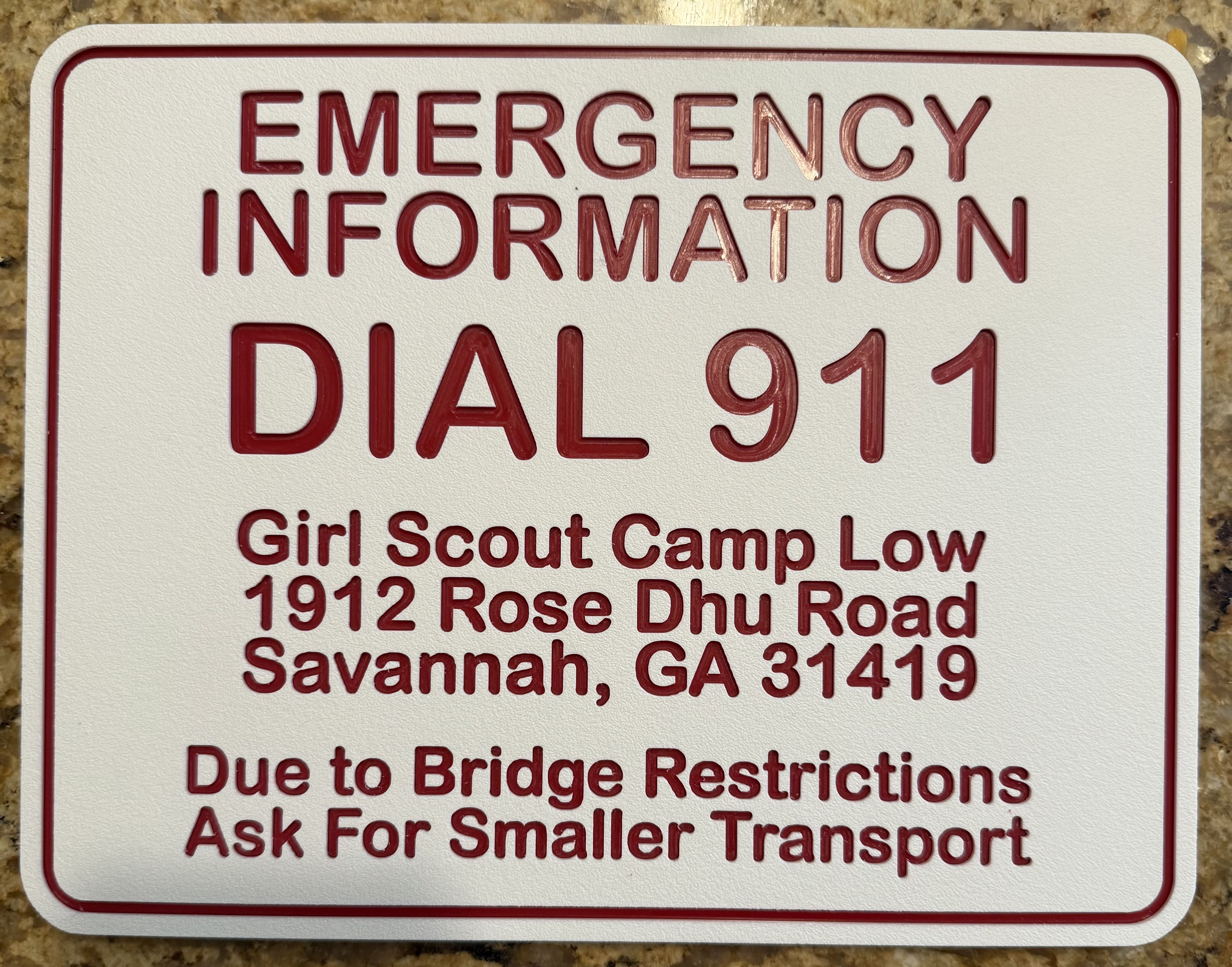

Been having fun with aluminum composite. 5yr old son is crazy about star wars - so used some panel I had left from another job to cut his new sign. Used #201 1/4 inch (think settings were 1mmDOC 300/1300/18000) but think I could’ve gone all the way through in almost 1 pass… what’s the verdict on the chips? Small hand file used to take off most of the rough bits but may chamfer edges slightly next time.
Also Hockley sign (mdf sample) - I seriously need to work on my finishing skills. Any MDF finishing YouTube tutorials appreciated!
The double sided flower logo sign - cut sample on CNC but couldn’t get details right (company lettering 1/32in pocket just didn’t do it), so outsourced the cut. Proceeded to power coat orange, cut the aluminum composite to scale to use as inside core and sandwiched it all together with old fashion nuts and bolts plus (not in pic) some hanging brackets. Still needs some finishing touches but hoping to hang next week. Fun times.

How do my chips look? Speed and feed looks about right?
Maybe a bit small (depending on the size of the tool and number of flutes)?
Hard to tell from a photo w/o a sense of scale/distance — so long as there’s no melting, it should be fine though.
