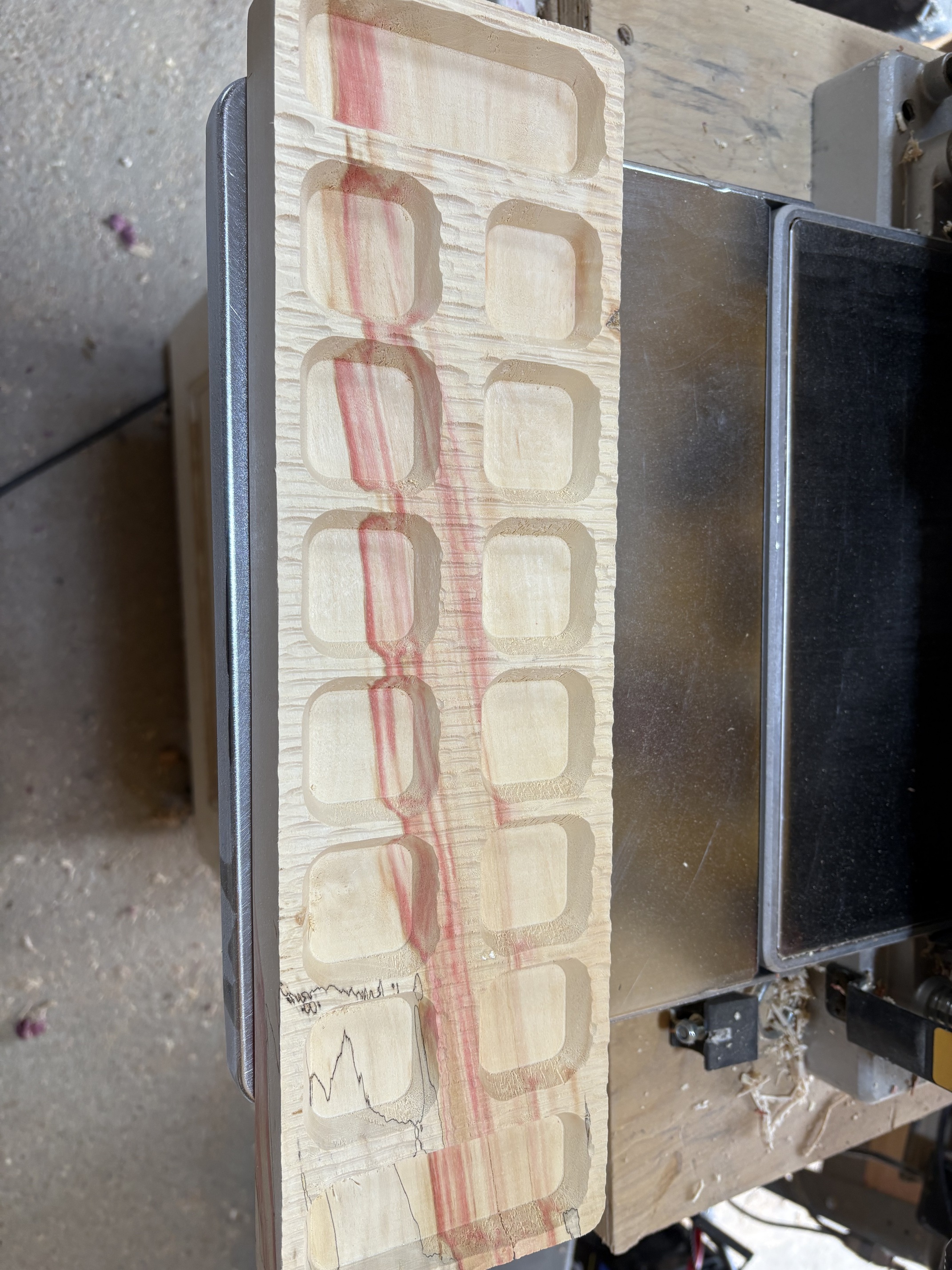

Third time is the charm once again. All edges survived, Sweet !
Thanks to @Tod1d for the wood saturation tip.
30% denatured alcohol and 70% shellac (eyeball). Dries well enough in an hour, I could have waited more, NOT !
Fusion took a long time to generate the Flow paths. The results were compact short running.
I processes 6 sets of vanes to help.
Added shellac after full first side cuts.
Flip the part.
Shellac after rough cuts. I stopped the rough cut so it left 0.030 off the bottom surface where the real thin section resides.
Finish cut 6 sets of vanes using different height ranges.
Cut Top 70% using a one way ( more shellac ) and bottom 30% using both ways only because that produced a path the looked good.
Dimensionally within .002"
I will have to school QA it.
Call this one DONE !
