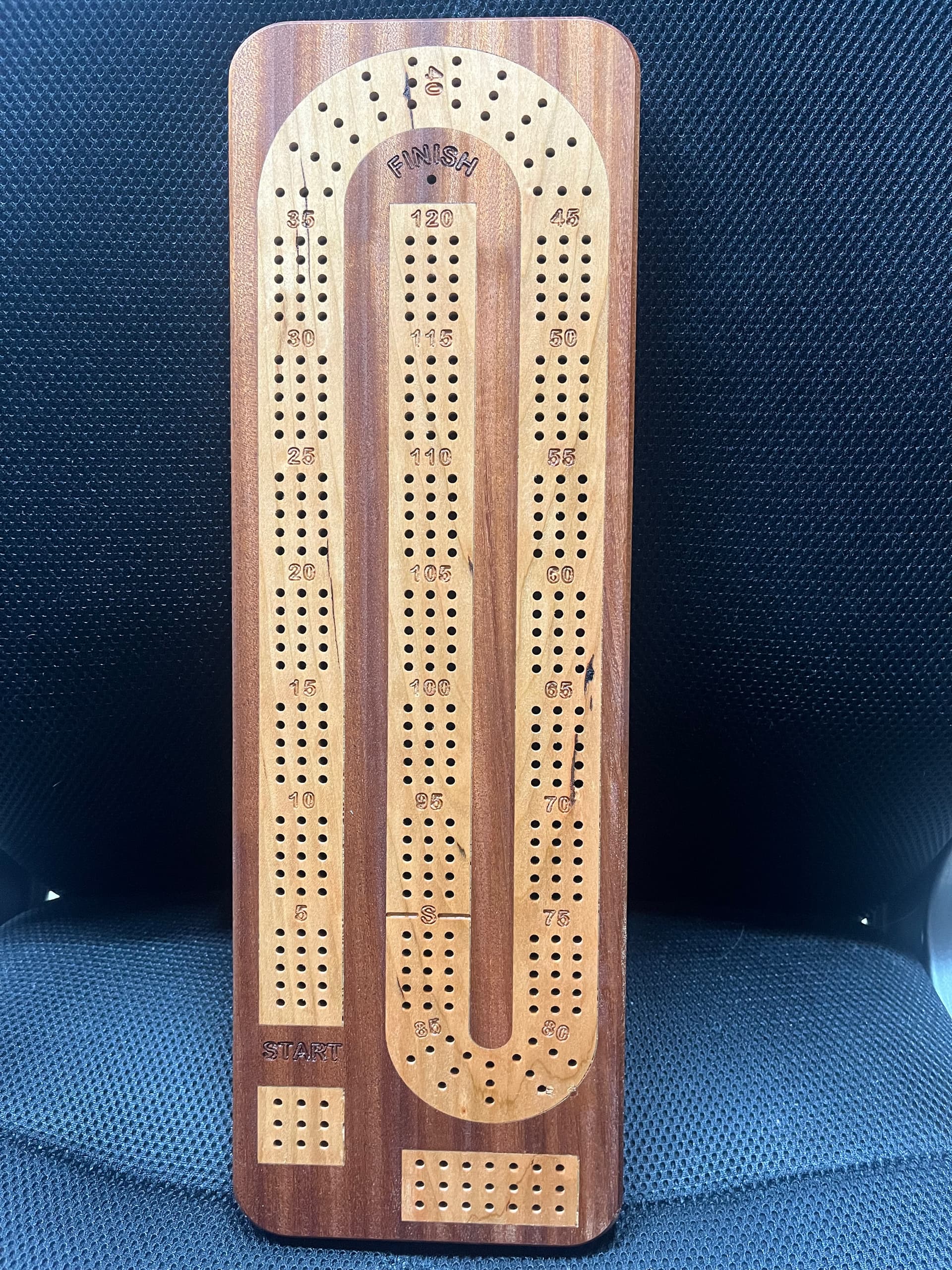

I did this one for my daughter in law’s father. He is a master at cribbage and has taught all the grandkids how to play.
As for me…still don’t know how :roll_eyes:
