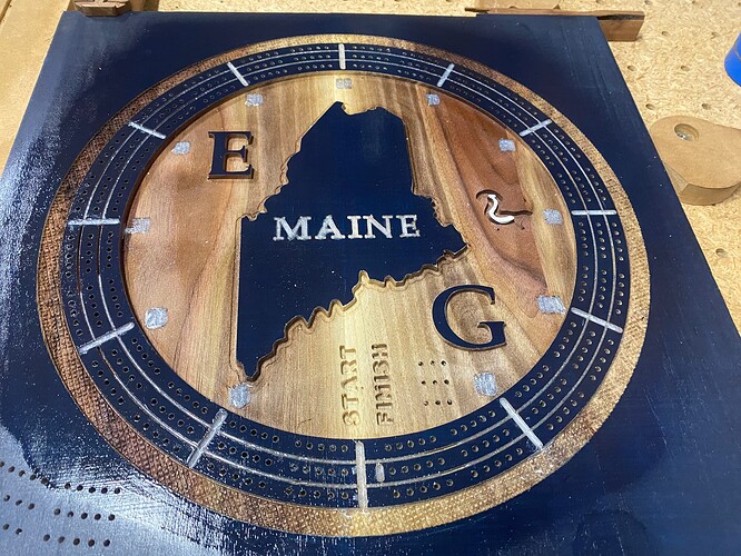

Second inlay project, bamboo cutting board with walnut inlay.
I’m learning that I should probably try more wood inlay. So much good work showing up recently.
Nice job :slightly_smiling_face:
Thank you, it is so rewarding to watch that last mm of stock removal to see the inlay magically appear.
Wow after seeing all the inlay work being done, I was inspired to attempt…
CC v833 (Free), CM 640 using an S3XXL with Z-Plus
Both parts are pine, base was stained in advance to better highlight inlay.
Font is Cinzel Decorative…as you can see tale of the S had an issue with plug…hardwood may have resulted in a better/complete plug.
I followed Winston Moy’s youtube for setup using .125" and 60 degree Vbit.
No special offsets or anything, just followed Winston’s recommendations and
bit parameters.
Thanks for all the inspiration, confidence is growing!

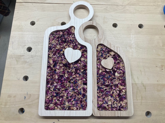

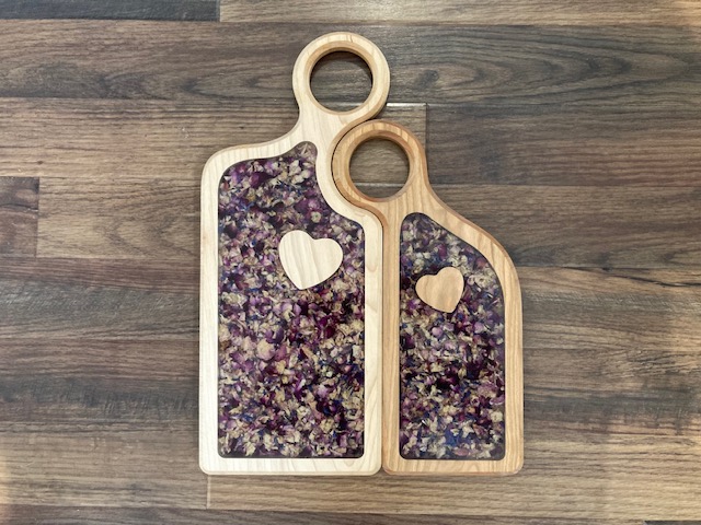

My friends got married recently and they had loads of confetti flowers left over so I made them this “Romeo & Juliet” style charcuterie board set with the flowers preserved inside. Really pleased how they came out and have delivered this gift to the happy couple. I also made some coasters with the wedding flowers but let’s not talk about that as they turned out awfully :sweat_smile:
I’m trying to record my projects now so I’ve got a video of the build - hopefully a good watch but you can be the judge of that! Link: https://www.youtube.com/watch?v=BpiENWoa54Y
Here’s the complete gift after the machining, epoxy, a pass on the router to add a chamfer, and then a few coats of oil to finish.
Here it is part way through where I’ve cut the wood on the CNC and put the flowers in ready for the epoxy pour.
Great mix of art and design
That’s kind, I’m glad you think so :slight_smile: It’s a fairly easy and meaningful project to do as a gift. Much better than throwing the flowers in the bin after the wedding!
