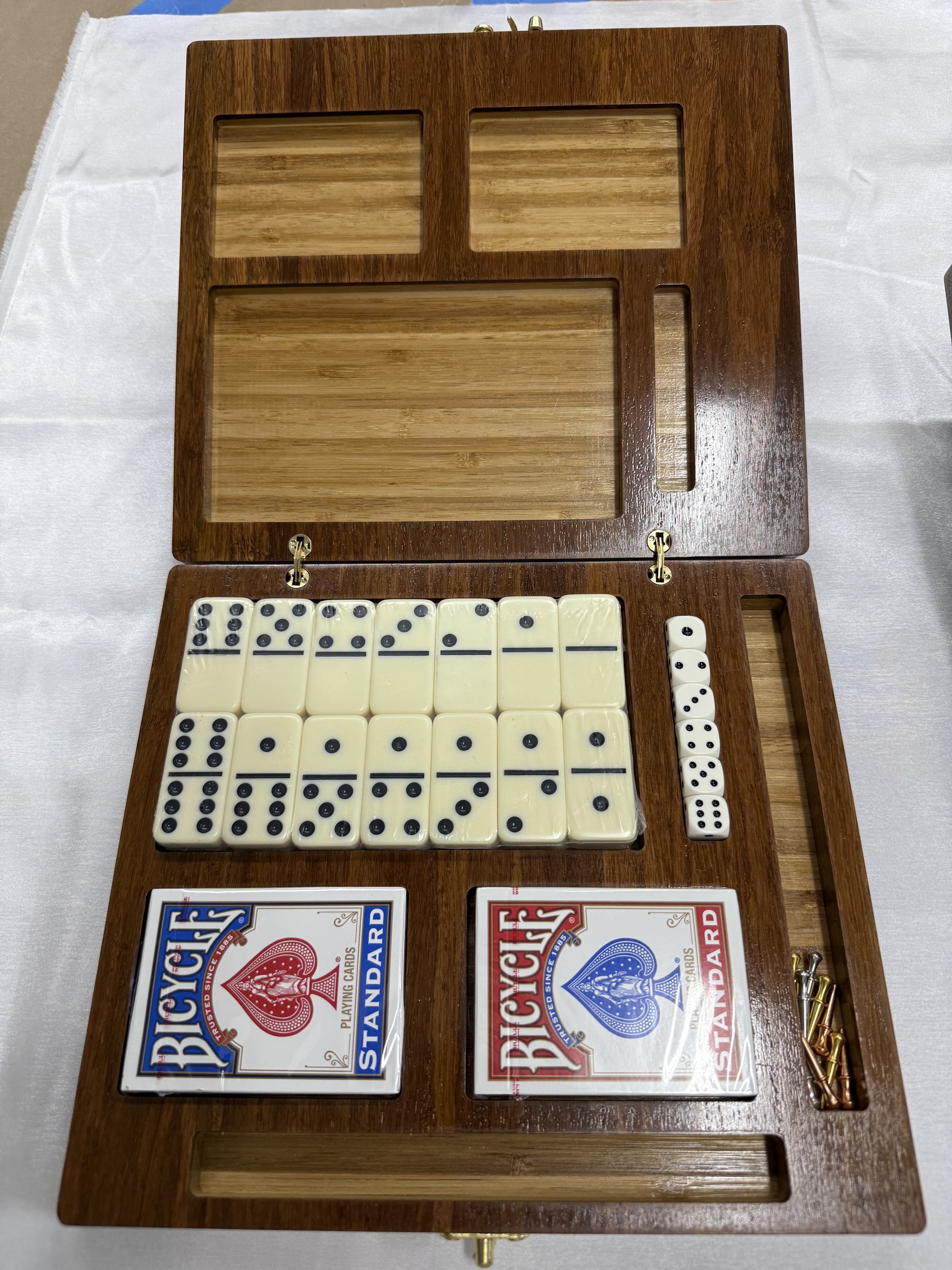

I bought the CIC Workshop Game kit and created a couple sets. I already had the BamCore left from a previous project.
I increased the size from the original plans a bit and put a cribbage game on the lid.
At some point while changing the plans I offset the hinge holes slightly so when I was done with the first one the holes didn’t quite line up. So I offset in the opposite way for the second and ended up with matching pairs. The offset was slight so not really noticeable that they aren’t centered.

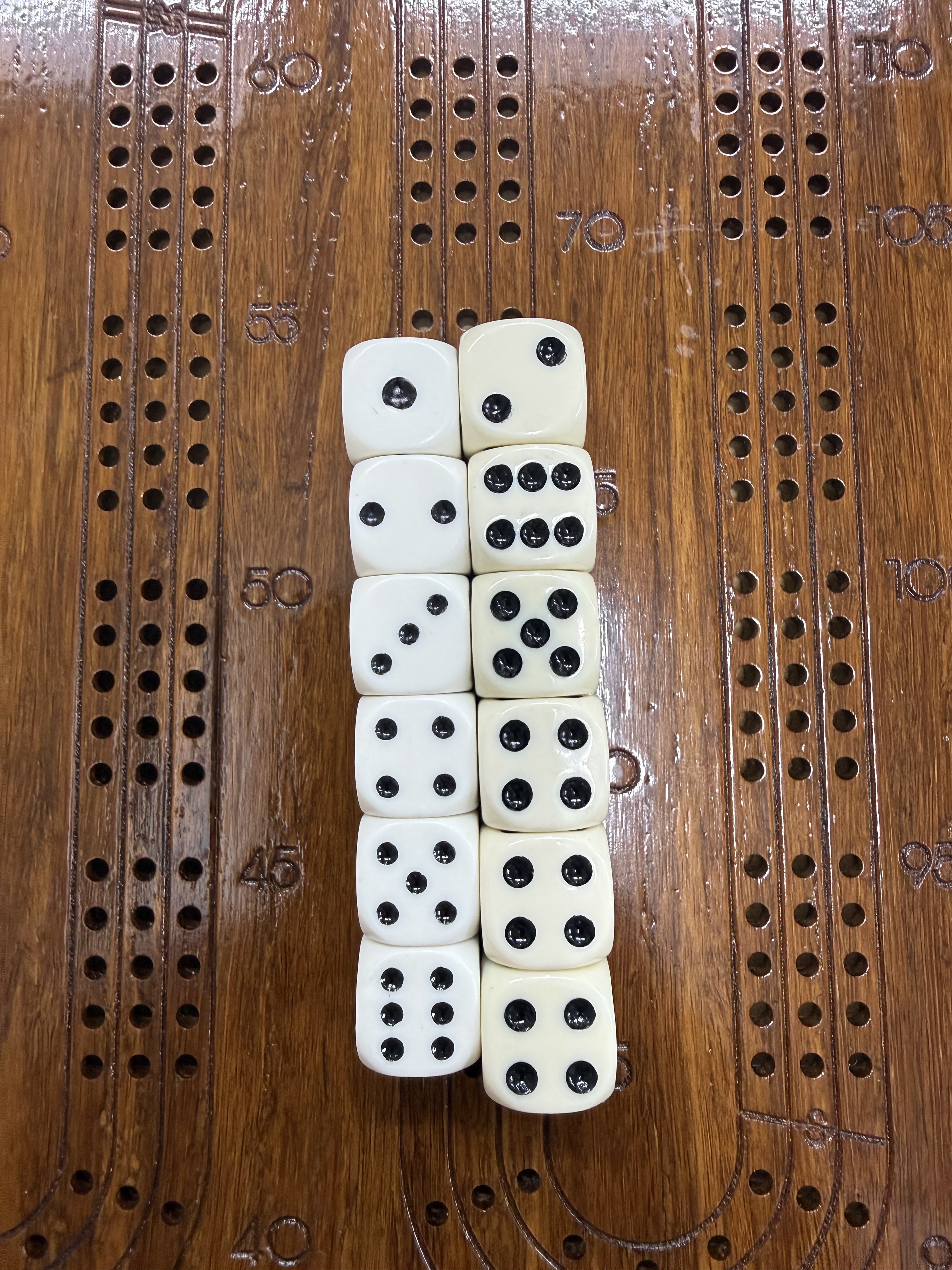

Another lesson learned: I tightened up the tolerances on most of the pockets but the second kit I ordered came with slightly larger dice so they won’t fit. I will have to try and find smaller ones.
