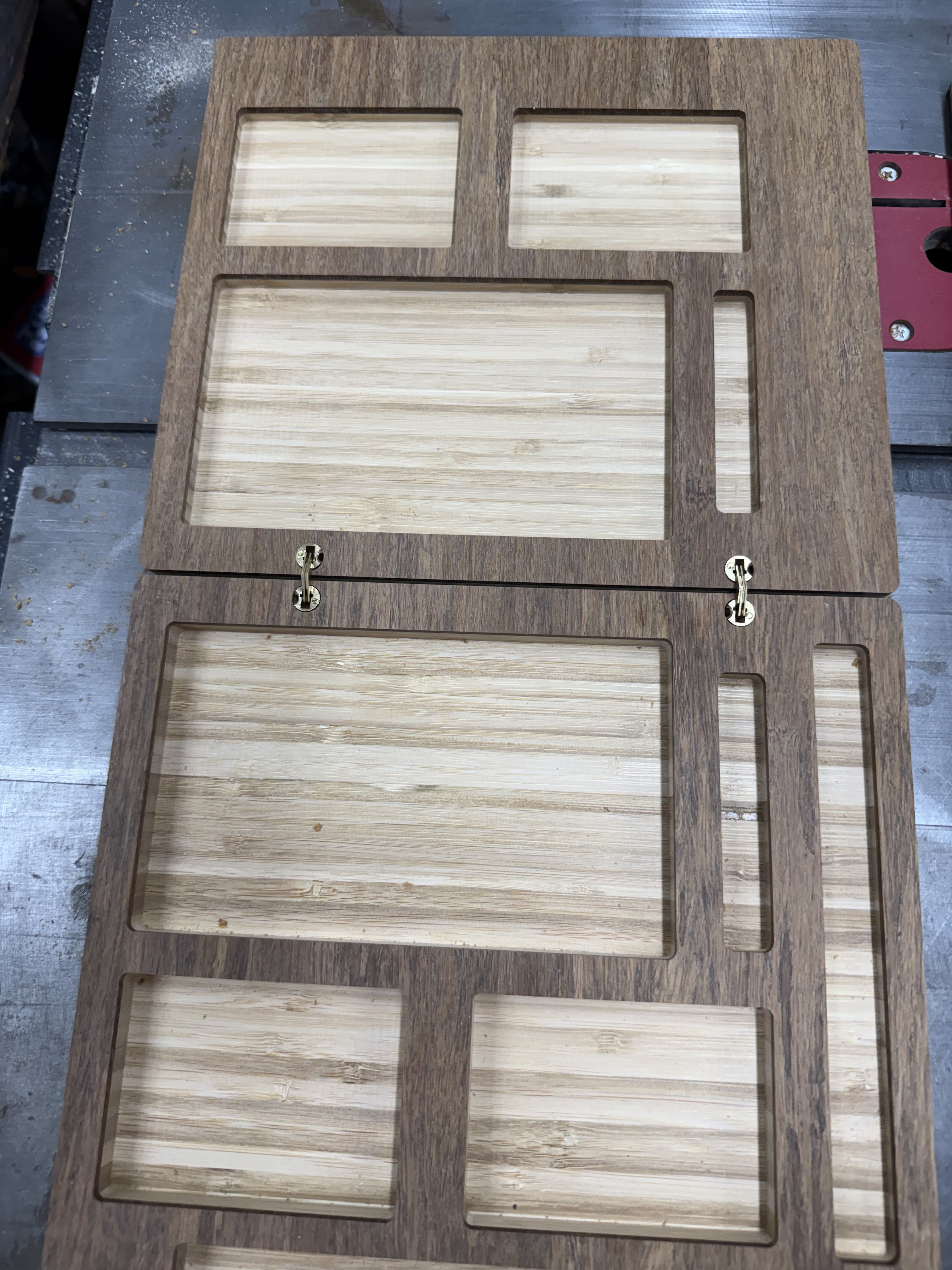

The hinges were a little fiddly. Initially I thought the hole called for in the plans was a bit too tight as ai could barely fit the hinge in. I oversized ever so slightly and it seemed good in tests.
Once I put it all together though I had difficulty tightening the hinge enough. I ended up putting a wrap of teflon tape around the barrels on the lid side. I am a little nervous for its long term holding power but seems ok now. I will definitely make adjustments before the next one.
It does fold flat with the outsides down. I don’t think it would be flat with the insides down but I can see how much it would rock.
i rounded the outside edges but not the inside edges since I wanted a clean edge when closed. I probably should have softened that back edge but it does seem to work OK.
Here is an image of them folded flat before I put any finish on.

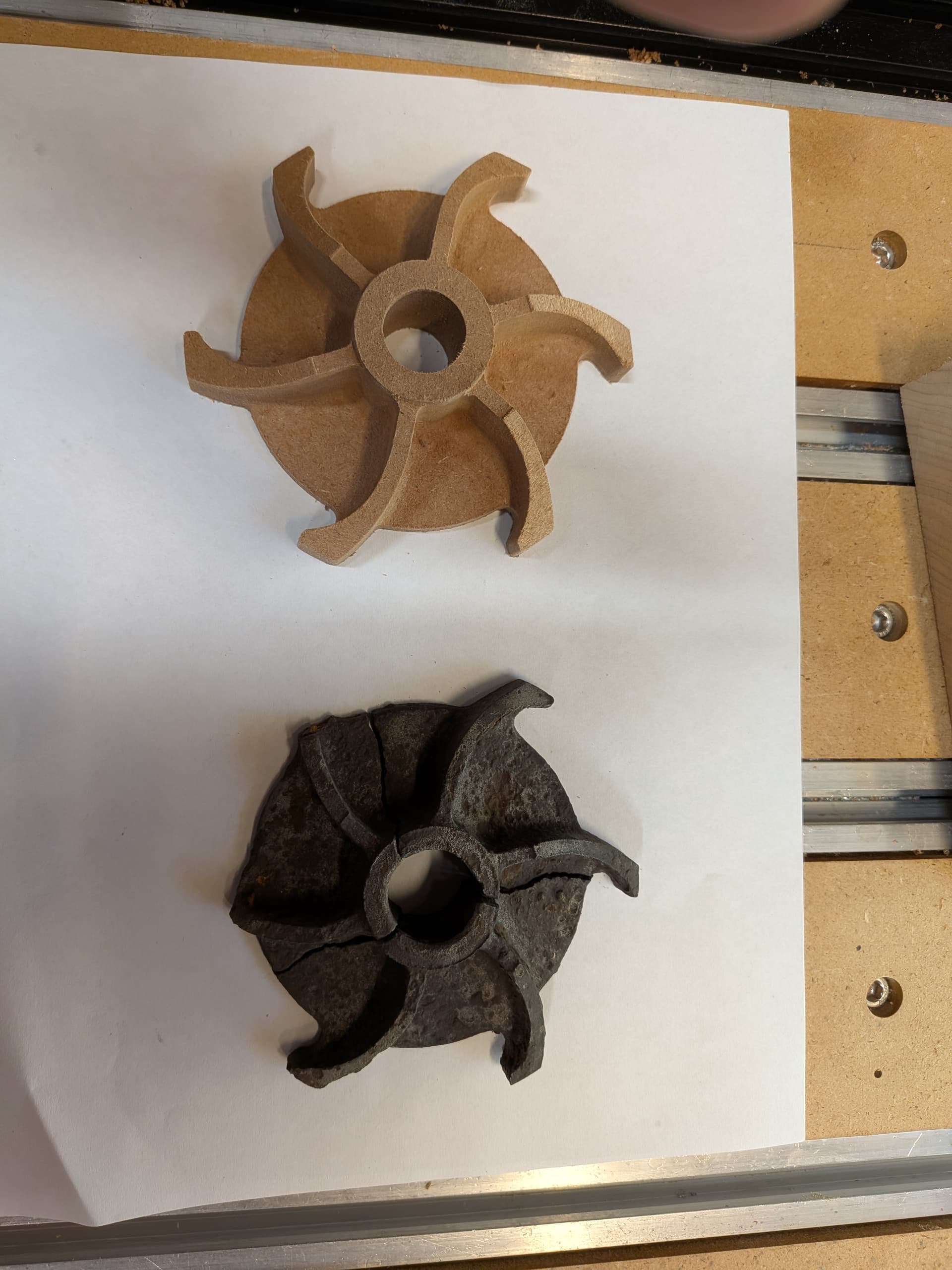

I was over a friends shop and another guy was there. My buddy says “he can do it”.
So I was handed a water pump impeller from a 1930’s firetruck water pump in three pieces.
I looked it over and said I would give it a try.
I pulled out my trusty 3D scanner (Lynx), fought my way through a software update, tried a hand scan which was nothing but frustrating.
I put together a turn table and found a tripod and got results that were useless. I then remembered this scanner was for large objects, not 4.5" circle that is 1" high.
So I broke out my circle templates ( 40 years old ) and was able to SWAG it together in about 20 mins. I figured old American casting would use basic fractional dimensions and it worked.
24 hrs after getting the impeller I finished this MDF version.
I made a STL file for him to have printed.
The part will need machining on the far side and the bore needs to be squared to the far side.
That is not my forte.
Fun squirrel.

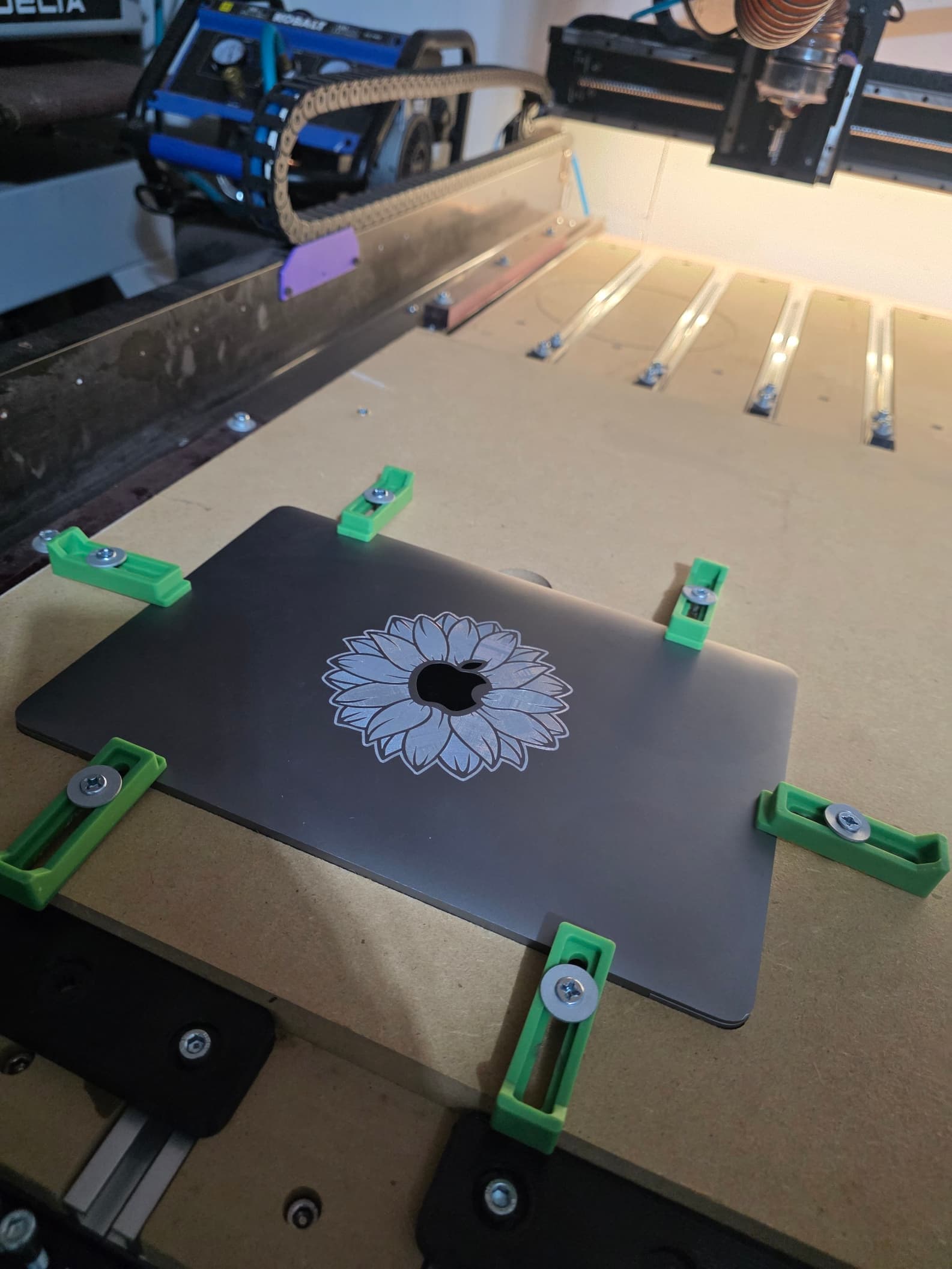

Did some engraving on my girlfriends mac book air, I think it turned out pretty good!
@keebs
Which bit did you use?
Turned out pretty good, looks like you got the Z zero set close.
Yes, great job. Please provide the details. Settings etc. I can’t seem to get my engravings to work properly.
@flynnie did you look at Kevins file on CutRocket?
https://cutrocket.com/p/6307d18c473a5
