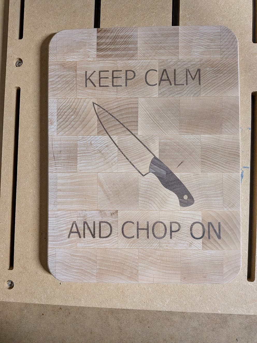

I did my first inlay with the kit from Cutting it Close. It was also my first trial with Carbide Create.
The base board is maple and started out at 1 1/2 inches thick.
At first, I used a 15 degree bit instead of the 30 degree bit I used in the Carbide Create file and had to surface out my mistake. I had taken the board off the machine and couldn’t line it up correctly again. There went 8 mm.
I used the Carbide3d webpage to convert the c2d toolpaths to gcode so I could send them with CNCjs. I had a strange error with CNCjs – for some reason I could not zero the bits with the usual macro (this had been working on the first few jobs). I zeroed it manually and then found that the V bit was 6.9 mm too deep. So I surfaced that off and finished the job and ran the “clearing” bit portion 6.9 mm deeper that the original.
It worked. Here’s the board after 80 and 120 grit with the orbital sander:

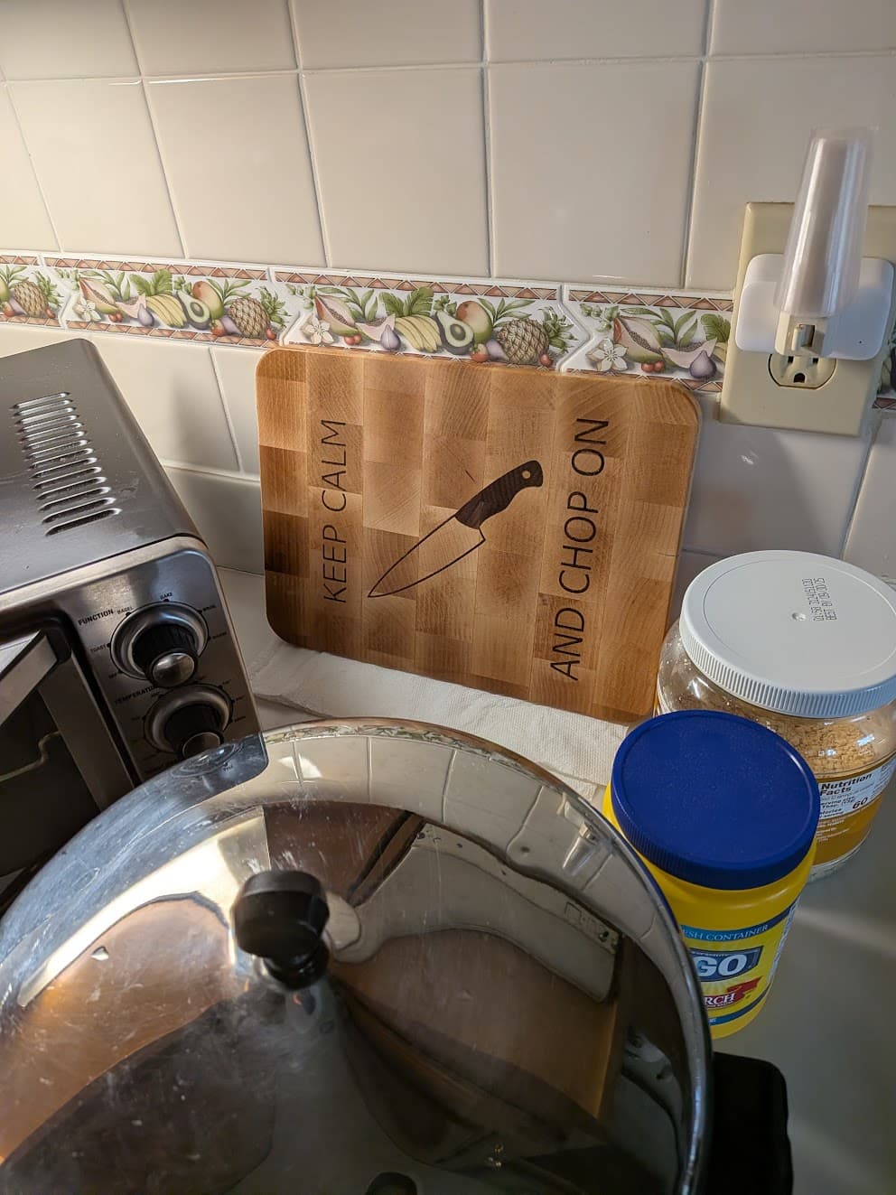

And here’s the board after quite a few rub-downs with mineral oil. The pot, corn starch and peanut powder proved to be an effective cat barrier.
The joke is not my own, it’s all over the Internet. I do hope my sister laughs and does not groan.
I had hoped to deliver a cutting board that was a chunky 1 1/2 inches thick but I think that this might be more manageable and will fit better in a dish drying rack.

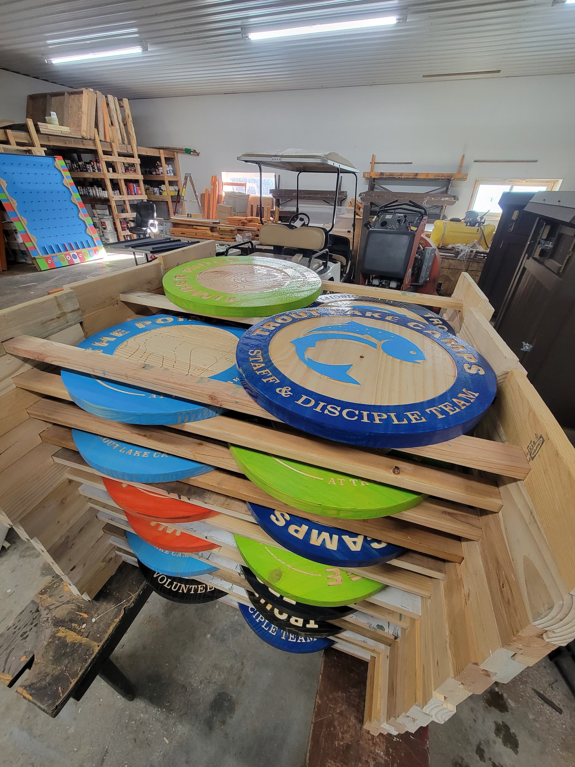

Pile of logos drying after a coat of poly.

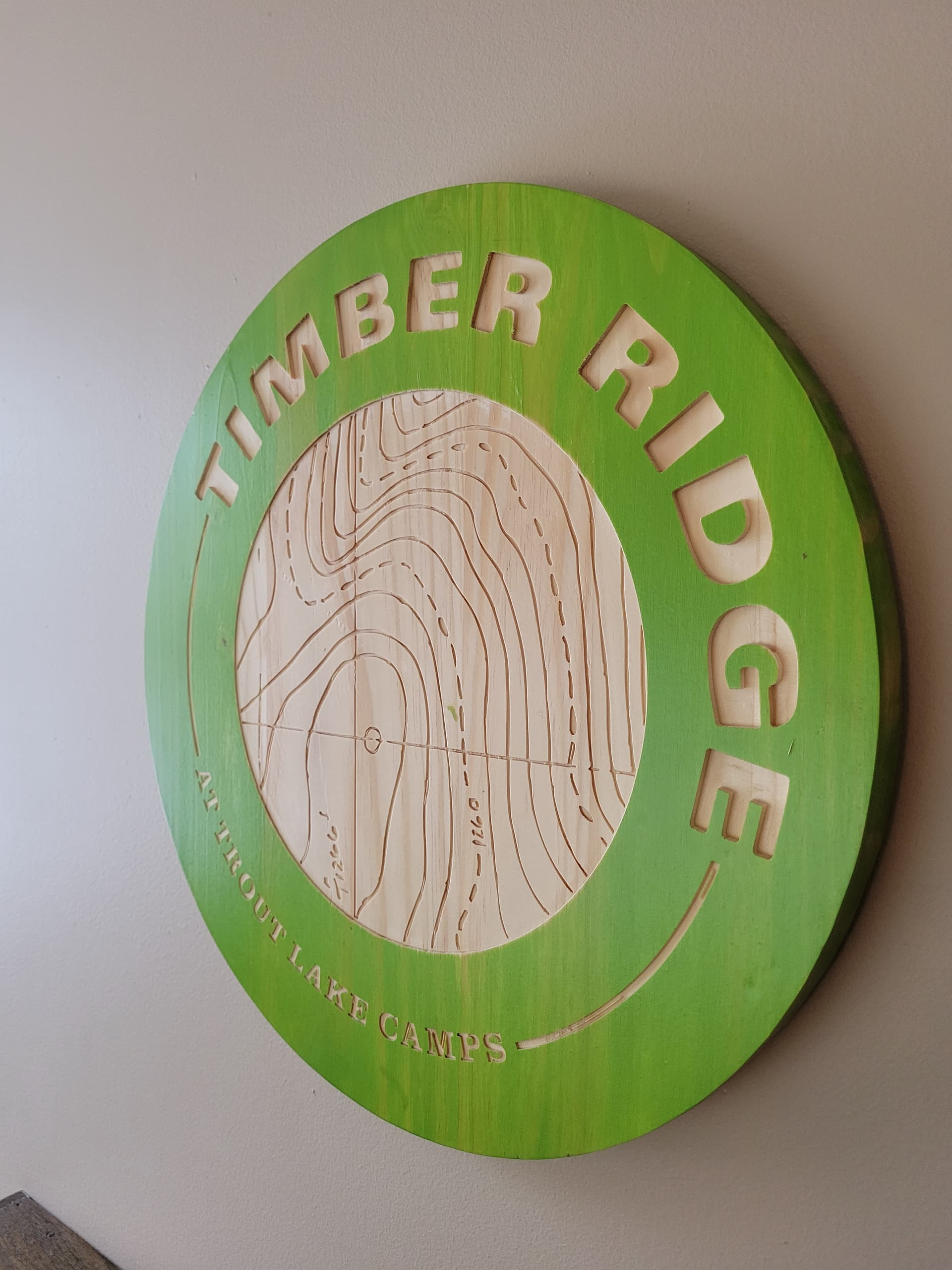

looks great. Spray Paint? what did you use to cover it with?
Slightly watered down acrylic paints.
Carve into the raw pine.
Satin Polycrylic

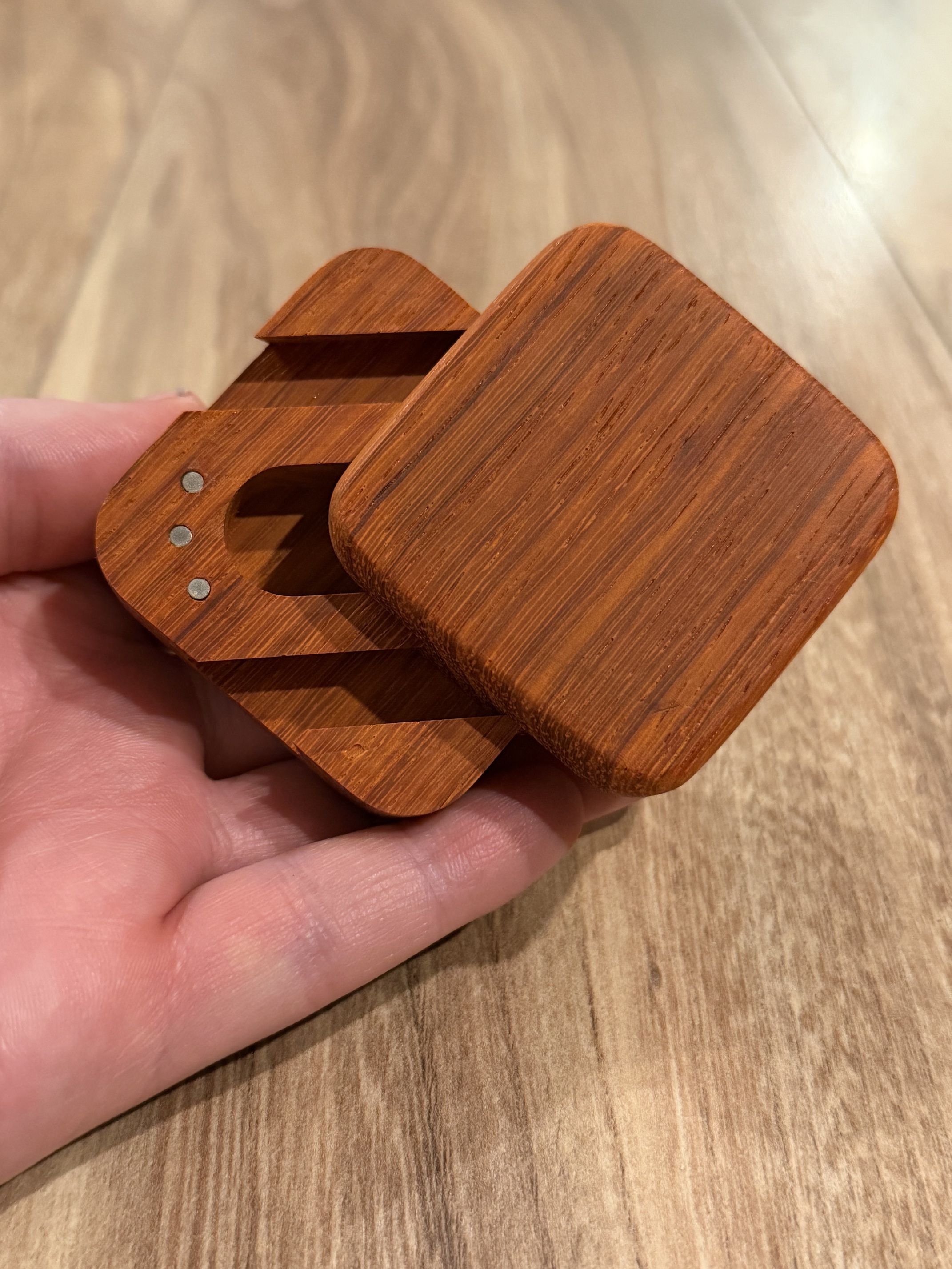

The wife requested nice little gift boxes for the items she’s giving out this year. I decided on the impossible dovetail box.
Just testing with some scrap pieces, the results are pretty decent! There are definitely some tool path tricks that could be implemented to prevent the bit of blow out at the ends of the dovetails. Plenty to improve on :slightly_smiling_face:
(It’s all done parametrically in fusion 360 so different configurations will be trivial. It’s going to be good fun running through ideas :chipmunk:)

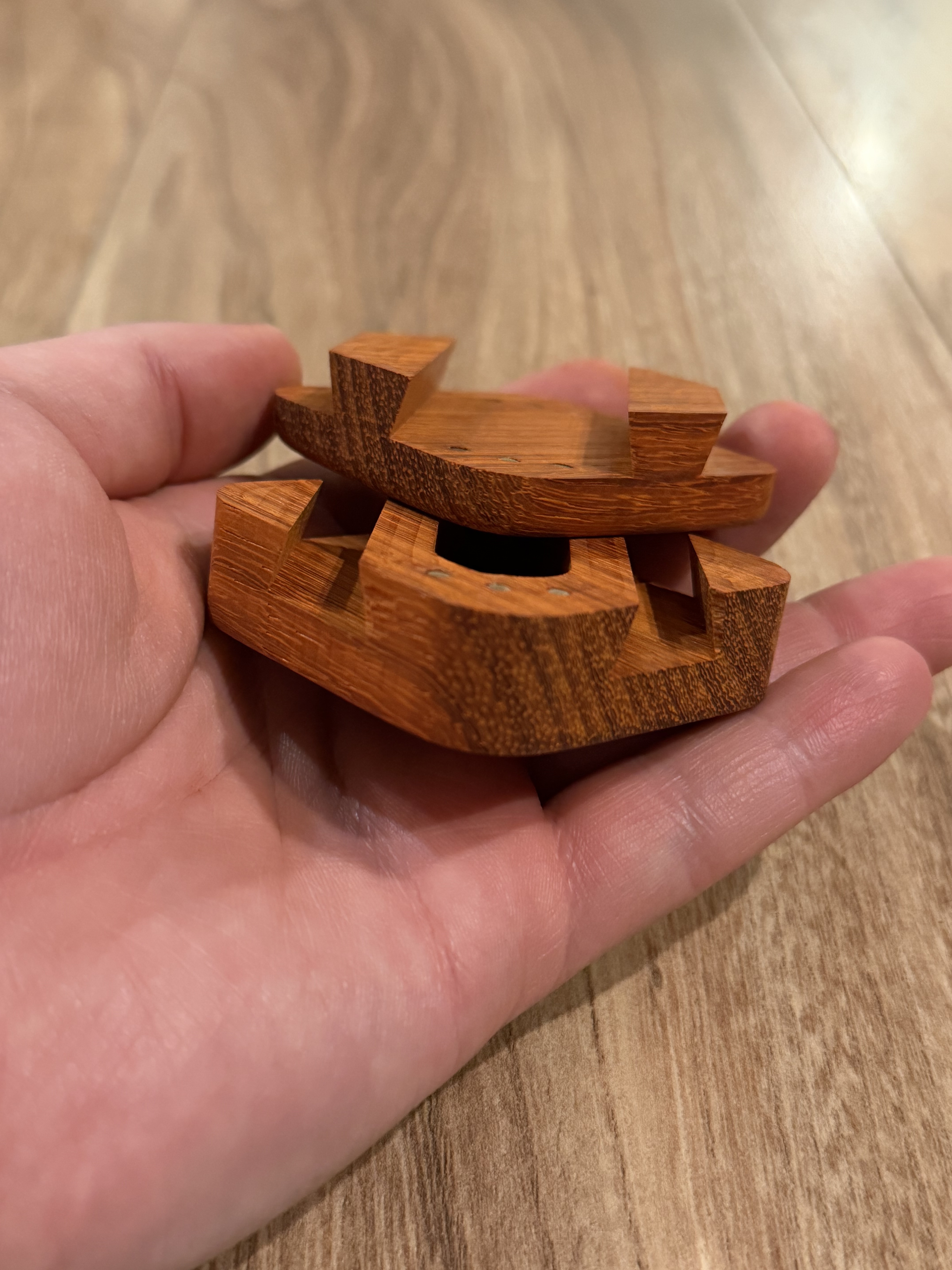

First time using a dovetail in the CNC. Went much smoother than I expected, it’ll be a mainstay for sure.

Depending on the diameter of the dovetail bit, especially on the larger ones you can run a contour path with a square end mill to rough out material that makes it easier on the actual dovetail bit on a final pass.
As for blowout or chip out you can also make the box slightly larger and then trim it down and remove the chip out on the edges.
One trick, since you get to program the toolpaths, is to run the bit into the exit end of the dovetail before doing the full dovetail from the entry end. Used to do that with a router table all the time.

Nice, that’s exactly what I had in mind to try next. It’s reassuring to hear that it works well from someone with real experience :pray:
That would be funny and I was also thinking of throwing a ball bearing in there somewhere to lock it in place unless it’s held in a certain orientation. Cheap attempt at a puzzle box element :slightly_smiling_face:

@Redlander this was done with a 0.5” diameter dovetail. I had just enough room to rough the center with a 0.25” square before running the dovetail through :slightly_smiling_face:
(Do people just run the dovetail through without clearing first!? That seems terrifying :see_no_evil:)
I’ll keep in mind the trick of making it bigger and trimming it down. Cleaning up with careful application of razor sharp hand tools seems useful for tricky grains like olive wood…I think anyway…I’m still getting used to the medium :grin:

Yes, some folks do not clear some material prior to running a dovetail thru material. Sometimes it’s not avoidable and the cuts can be made. It’s just harder on the spindle/router and bits long term, lots of extra heat buildup.
You can use hand tools, I was referring to the cnc for trimming things up. Just have to be careful on your clamping however. Easier on larger pieces on the cnc, easier on smaller pieces with hand tools.
Ah that makes sense, I’ll be trying that out for sure. I suppose it’ll entail an additional tool change but that’s a small price to pay (especially if it scales well to multiple boxes in the same run)
On another note, second op is going to be pretty convenient considering there’s a built in dovetail to hold the material firmly :slightly_smiling_face:
