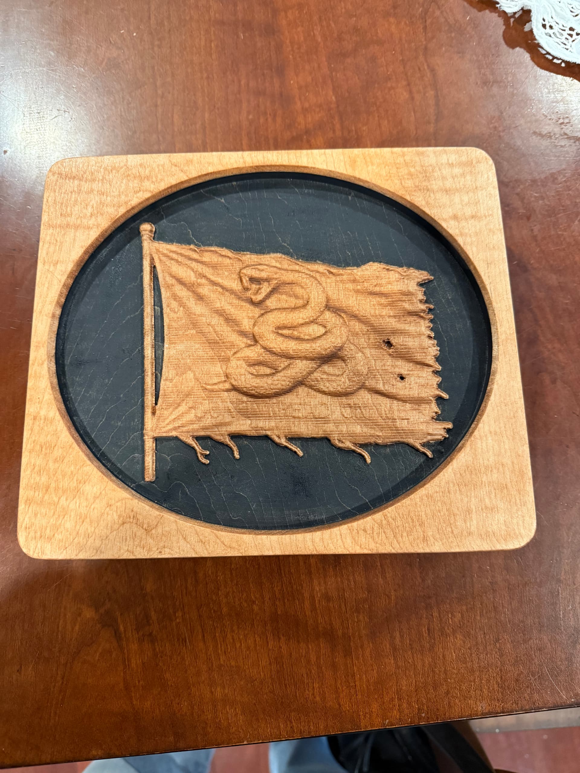

The heating grate looks fantastic. Good job!
What FEA program did you use? Was it easy to pre & post process with? Thanks.
I’m old and learned FEA the old school method…MATH, moment arms, bolted connections, etc. (I think F360 does it, but I’m comfortable with old school methods) I’m not sure what you mean Pre and Post process…Designed in F360, and Post processed using the Carbide3D post for the Shapeoko. Hope this answered your questions.

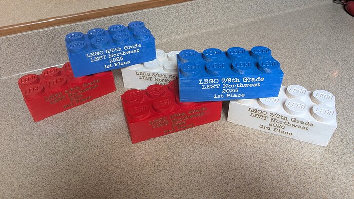

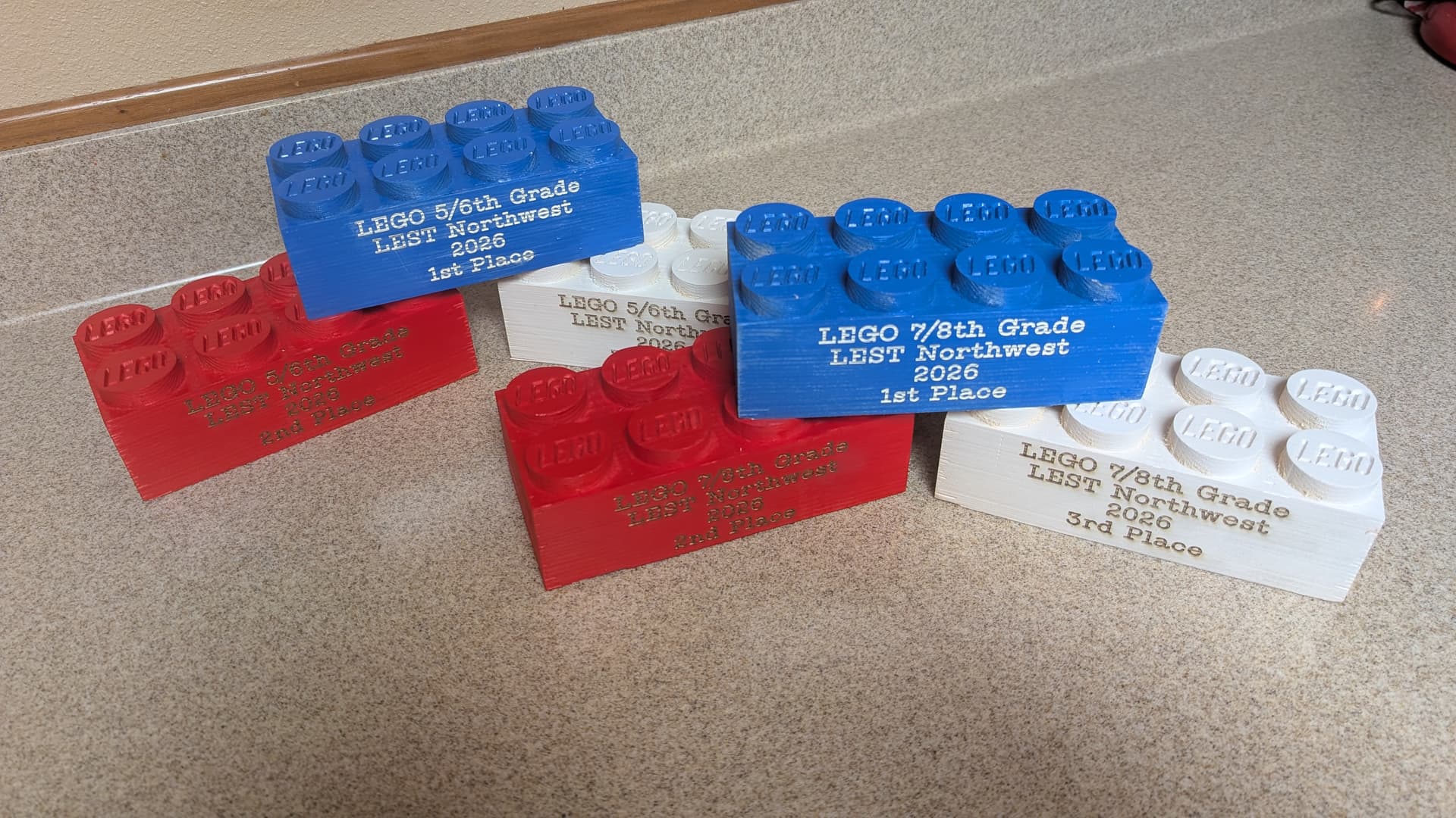

I’ve been busy making a number of awards for a tournament. I thought I’d show these ones because these are not the typical plaques. 4x4 stock cut to a set dimension. I was able to make all six of these in one shot with my Shapeoko 5 4x4. Text is laser engraved.

They look very effective, what a good idea. One question, how did you do the lettering on the sides?

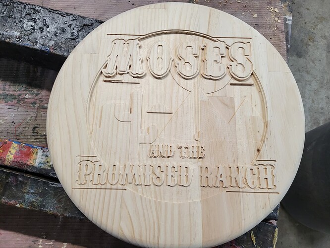

Third project, no issues so far. Agonized about feeds and speeds, cut depth and running into things as I didn’t think this should take 5 hours. Managed to get it down to 2 hours where I felt semi comfortable.
One question about sounds of bits going through Curly Maple. I noticed that when I started a clearing path that the bit squealed a lot when it started the first plunge and cut. Subsequent cuts didn’t squeal at all. I was using a 1/4" down cut endmill running the following parameters:
Golden Boy bit from CIC Workshop
Diameter 1/4"
Flute 3
Pass Depth 0.250
Step over 0.1
Speed 18000
Feed 100 inches/min
Plunge 50 inches/min
What does the squealing sound tell you? Should I change something?
Thank you for any help.

I used acrylic paint and then wiped the excess off. I sometimes use powder coat paint but the heat gun would mess up the base coat paint in this case.

It’s telling you its cutting 180 deg of the cutter surface on the first pass, the bit itself is designed differently than a normal spiral cutter due its objective of clearing. There is allot more groves that interact with the material being cut. In this case I think the wood is squealing instead of the bit!!
It’s called ā€œslottingā€ when the tool is cutting the full width of the bit.
Your ears will be as good a guide as your eyes.
It’s noisy, you can slow the feed rate down (%50) until the slot is done and the normal stepover takes over.
This is the reason you make a pocket to cut out something instead of a contour.
It relieves the amount of times the bit has to slot.
@jtclose Thanks for the advice I’ll try slowing it down next time.
@Redlander I agree its the wood screaming.

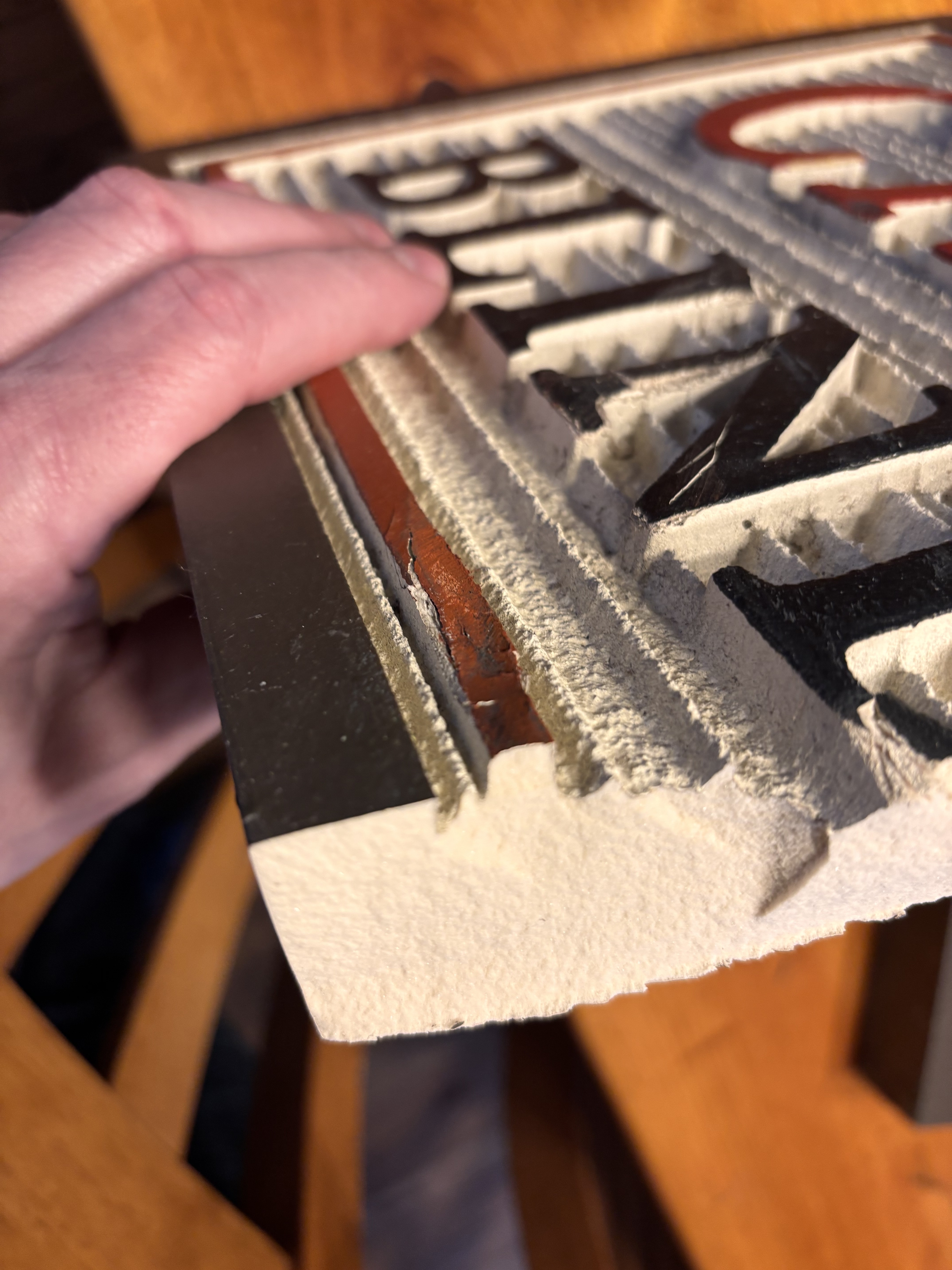

Made a office name plate for a coworker. My finest r.e: fiddliest inlays yet on Indy’s whip. I had to use the Amana Tool 46473, 6.2 Degree bit and lots of custom v carve inlay offset tests in Carbide Create to get the inlay to fit just right. Oh, and a 3d carve of the Cherubin from the top of the Ark of the Covenant on the reverse :slight_smile:
