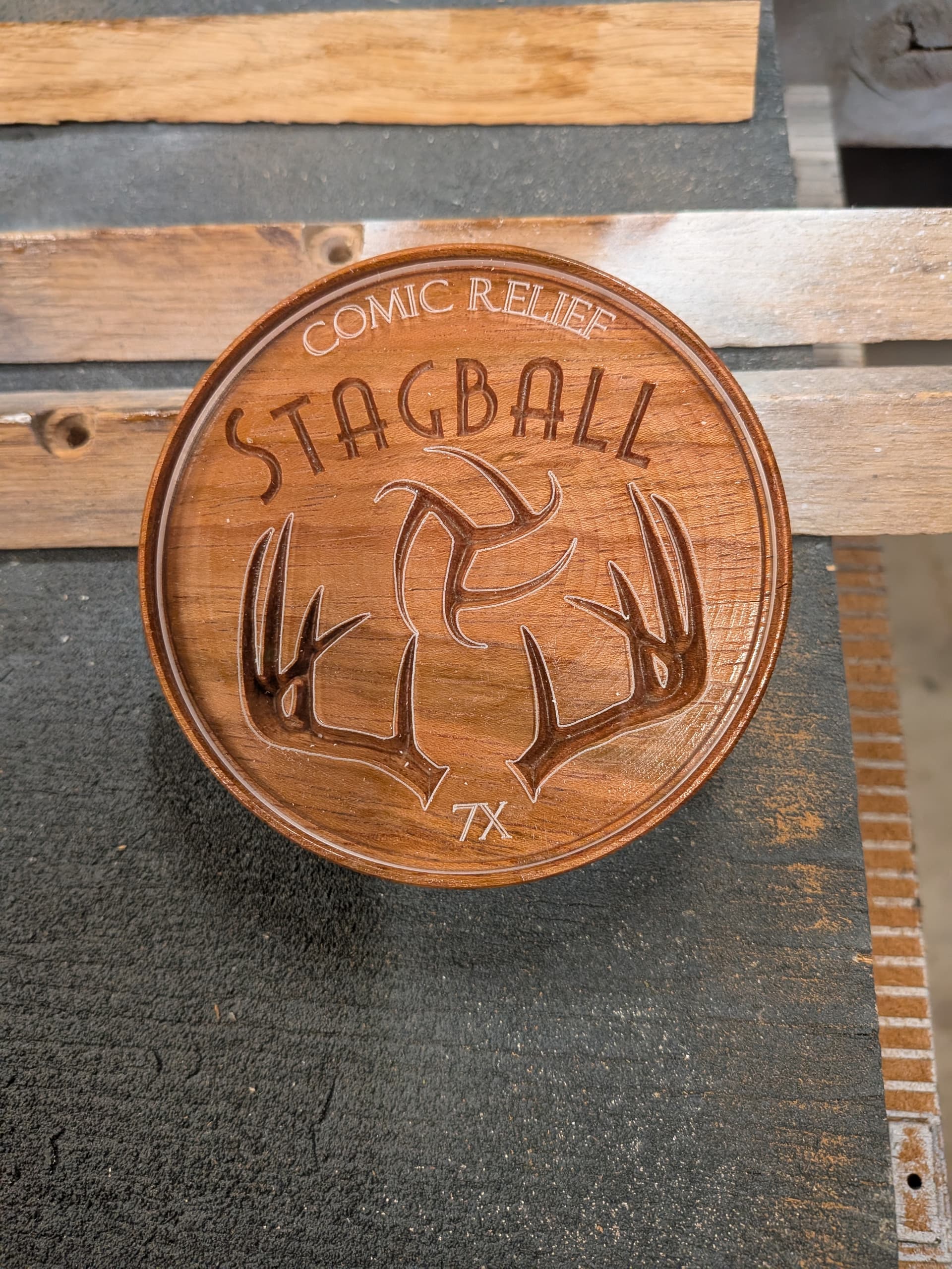

I had 5 pieces of cutoff 11 x 5.5 Jatabo decking board. Real heavy and hard.

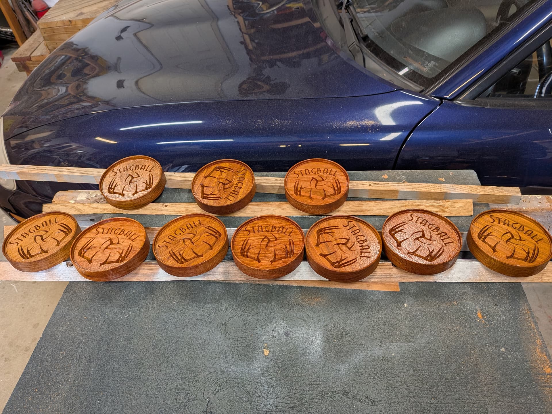

So I made coasters for my volleyball team ( they let me flop around the court ).
Added a personalized cover with their shirt name and number. Yep, that’s me.
As any project starts with a whim and turns into a science project.
I got the logo by taking a picture of my shirt. I didn’t REALLY check centering of the scan/trace so some downstream issues showed up. Oops. It’s a freebie.

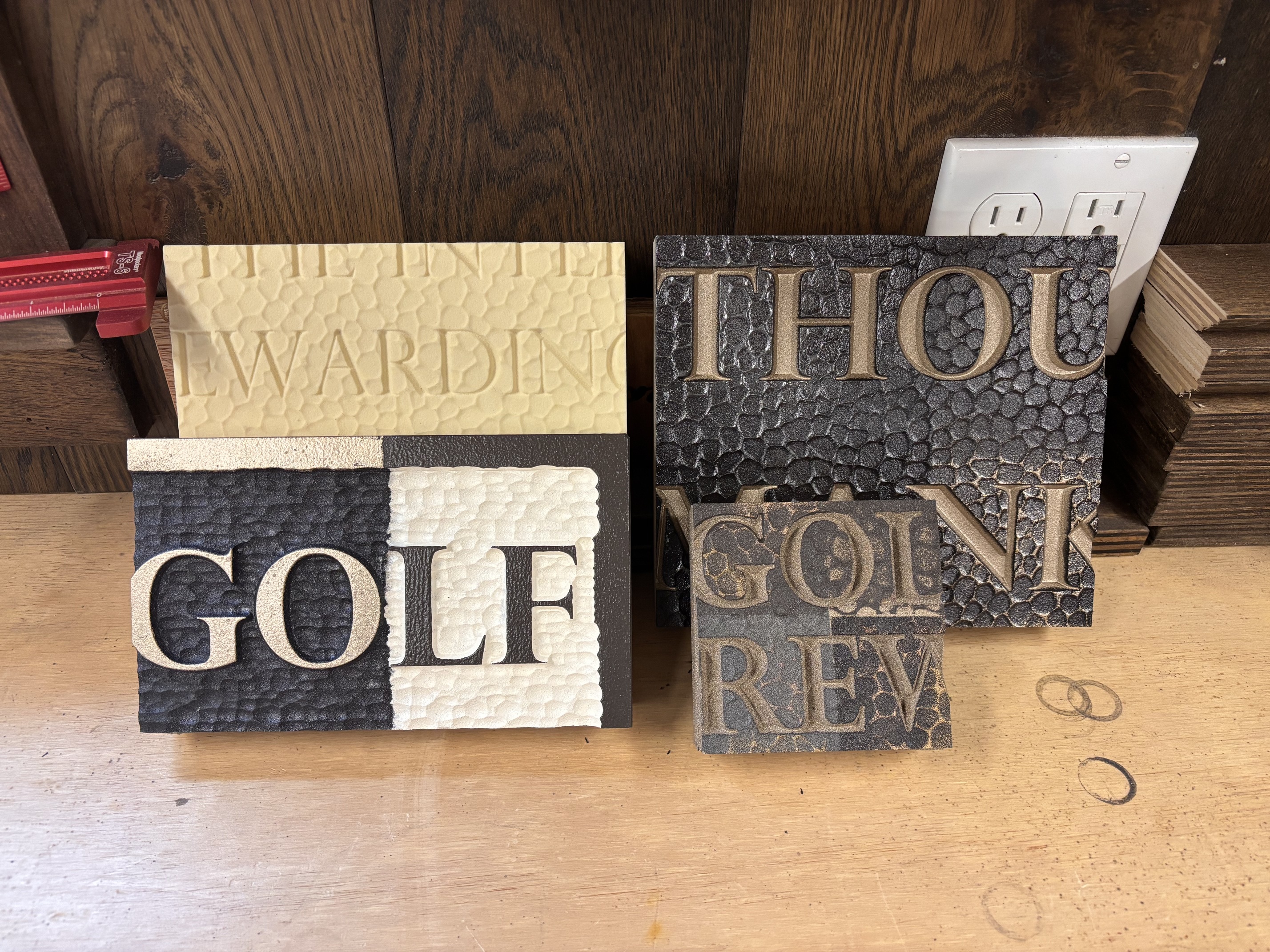

Samples samples samples. We spent a lot of time going through a few textures and color combinations to come up with some options for the customer to choose from… he chose the GO on the left by the way.

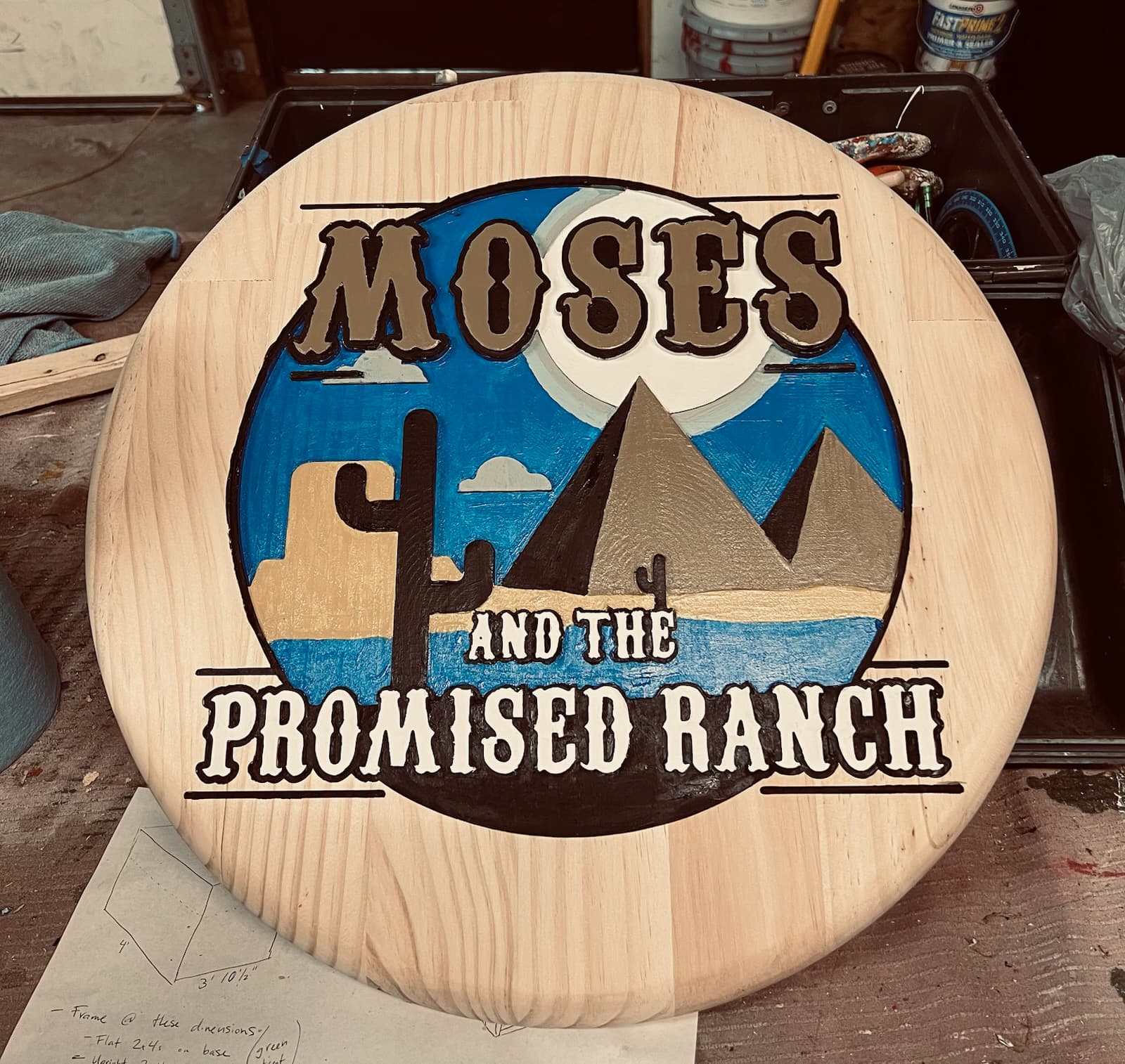

Now to finish the actual proof of the sign and get that approved. And then…carving.

I like all of them! The pebbled look of the top right one is pretty cool.
Are you modeling the texture in an STL or doing this with a texture toolpath?
Both. The front left is a CC texture toolpath, the others I modeled with deformed circles.
They all look great. I feel like texture on signs really elevates the final product. Mind sharing the settings/bit you used in CCreate to get the results there?

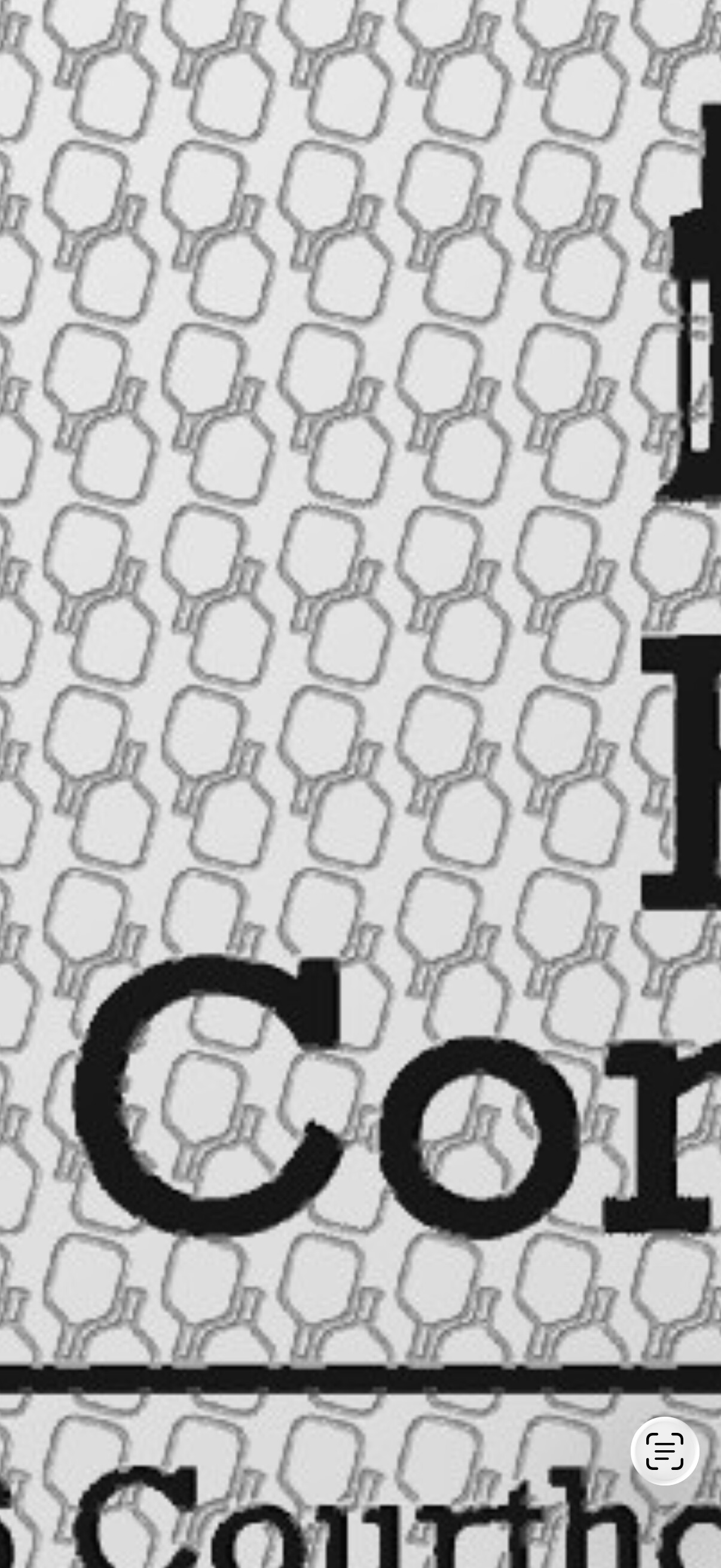

I am working on convincing a customer to let me do a big sign for them. I sent them some sample images with different textures. For fun I included the one below. It isn’t really a texture I guess but has the same effect. It’s for a park that has pickleball courts.

Here you go. Be aware feed speeds are set for HDU, and are a little faster than the max the pro 5 runs.
Texture Sample 5, Hammered metal, Raised Letter, .25in ball and .5in ball, 7inx4in, 02-07-26.c2d (312 KB)
Fantastic. I’m on a 4, so I’m sure I’ll dial them down quite a bit more.
Dial it WAY down if you are using wood as well.
My eyes shot out of my head looking at these FR values vs bit diameter.
Haha! HDU is much different than wood. Literally cuts like butter. It’s hard going back to wood once you use it :smile:
