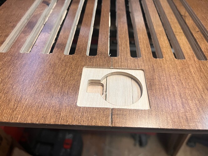

Hickory 3/4 ply. Chocolate Rubio stain. 4’x5’

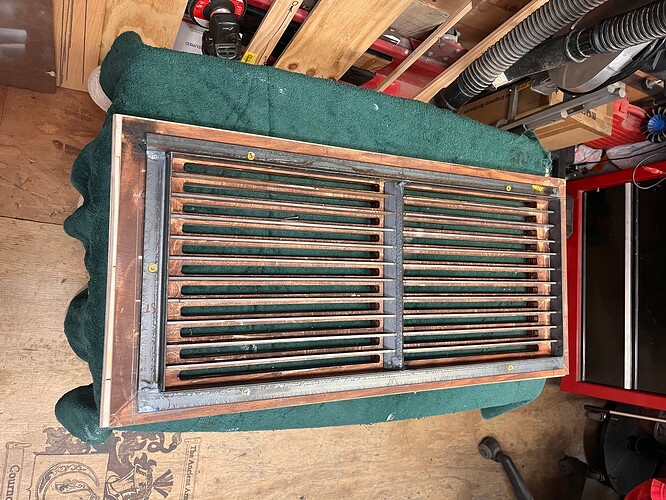

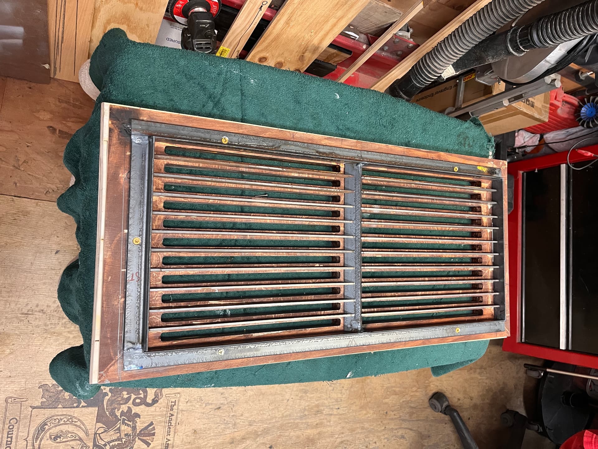

So this is what Richard has been doing for the last 6 months…Two projects:
First one. Flush Floor Vent. 30 Inch X 15 Inches…Made from Maple, reenforced with a TIG Welded Steel Frame that Mounts to another inner Steel Frame mounted to the home’s floor joists. Because it needs to support humans…AND I’m an engineer…I did a full FEA (finite element analysis) that dictated the size of the steel and hardware… Homeowner was ecstatic… (Located across the street from Albert Einstein’s old Pasadena Home…so it HAD to be right. Vent tool Five months…Lots of design and math…it HAD to be right.
Finish product, less some stain matching on the perimeter trim.
Ten years into my Shapeoko ownership and STILL amazed at the precision.

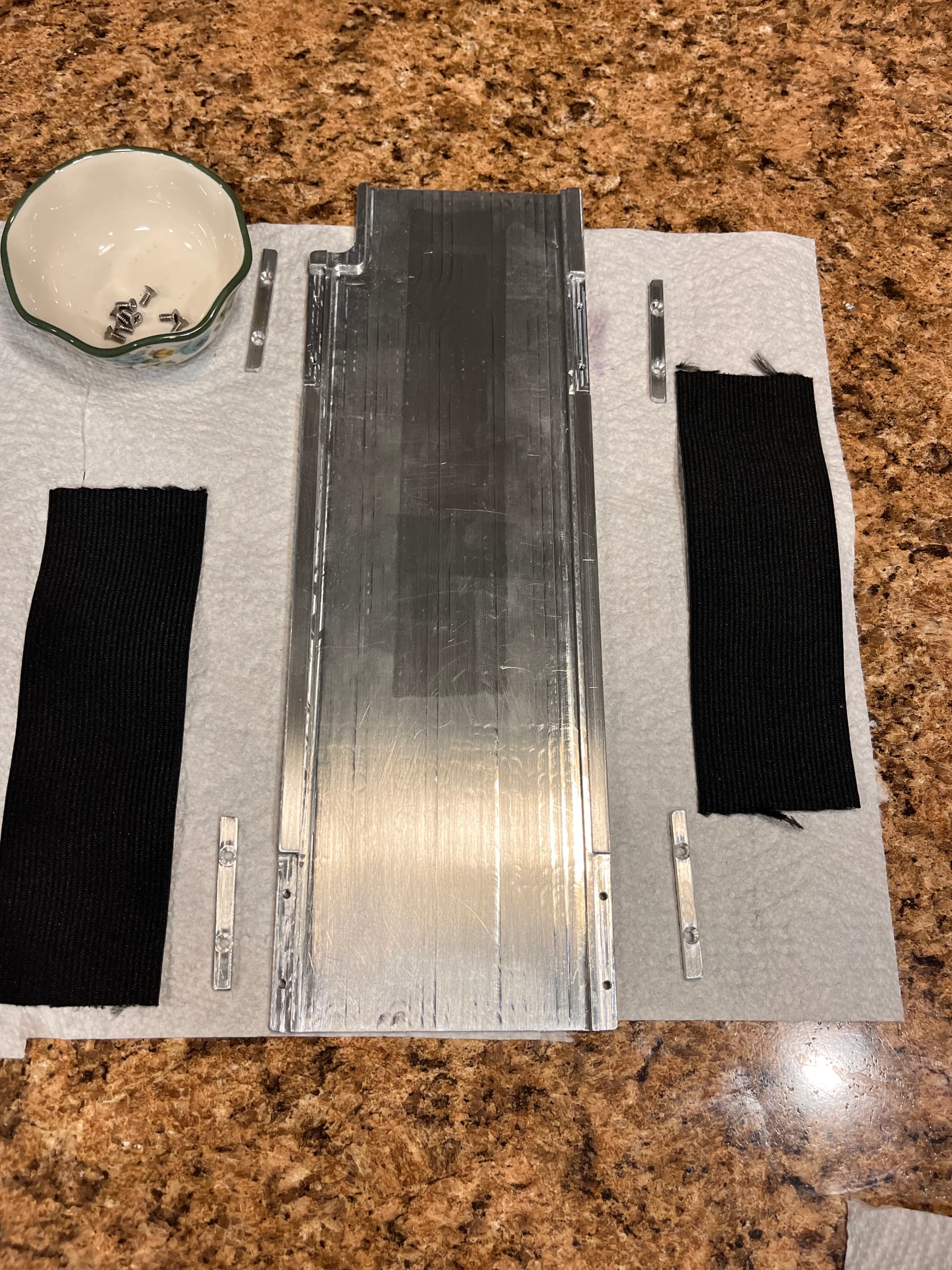

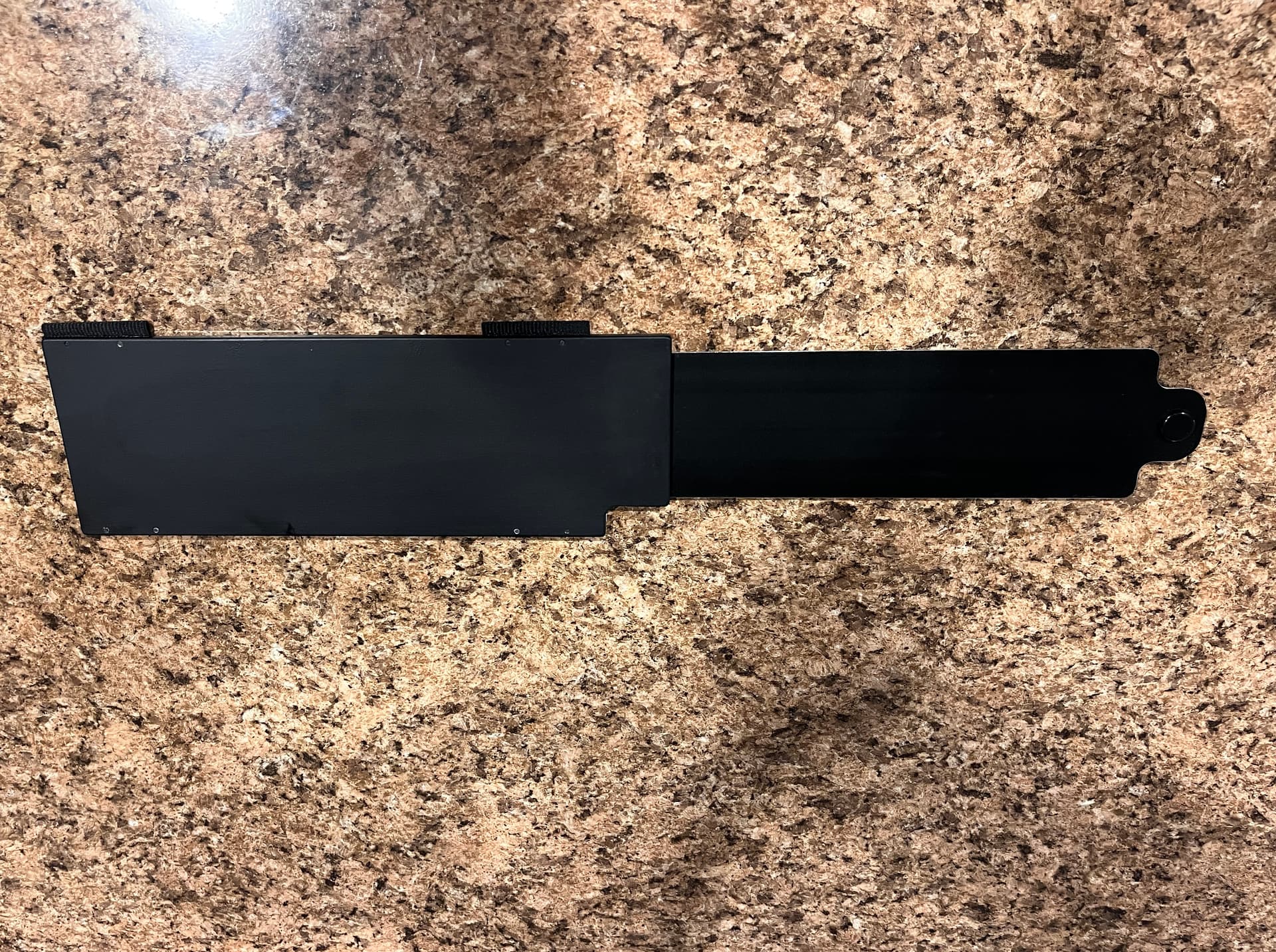

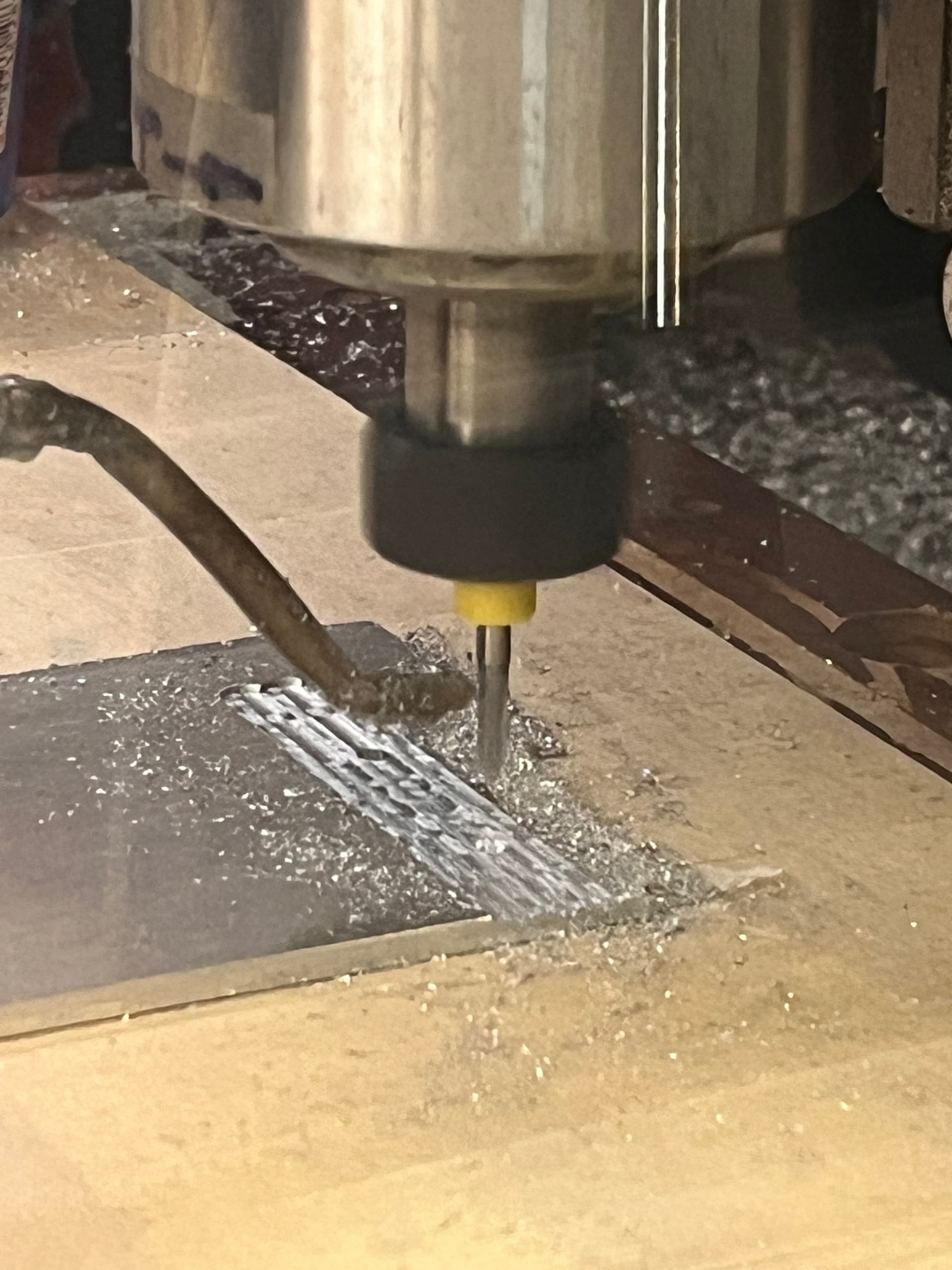

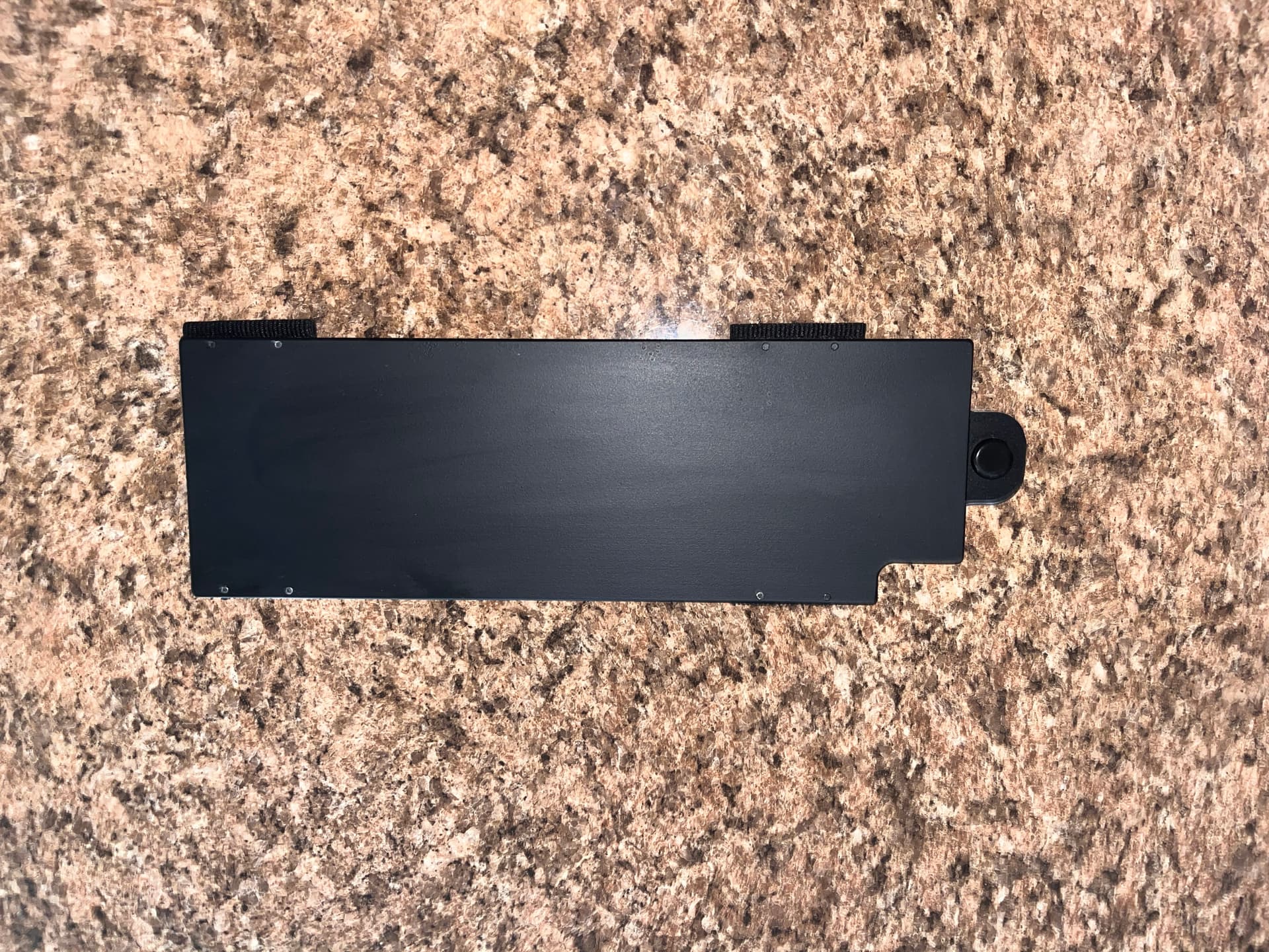

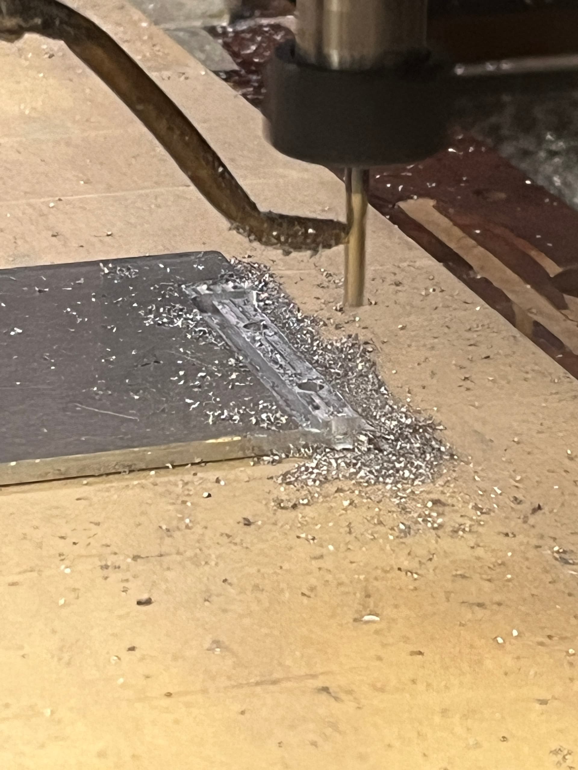

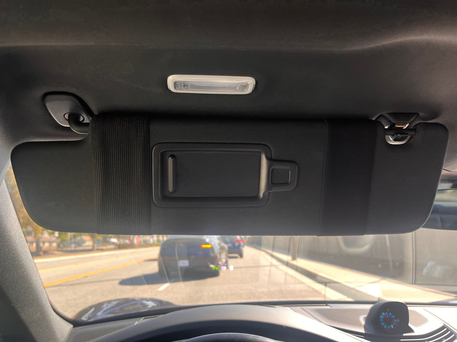

Second project was for me. After a minor cancer scare which turned out to be a benign growth on my appendix (YAY). I said F it… And bought myself a Porsche.
I did not know that Porsche does not have a sliding sunvisor. It might have 600 hp but it doesn’t know how to do a sliding sunvisor… WHY? Toyota does it, Mercedes does it…and I’m almost always driving West at sunset…and there it is blinding me…
(Sheet Metal was purchased with a matte black anodized and the 6061 was Power Coated (also matte Black)
So as a maker, I did what a maker does:

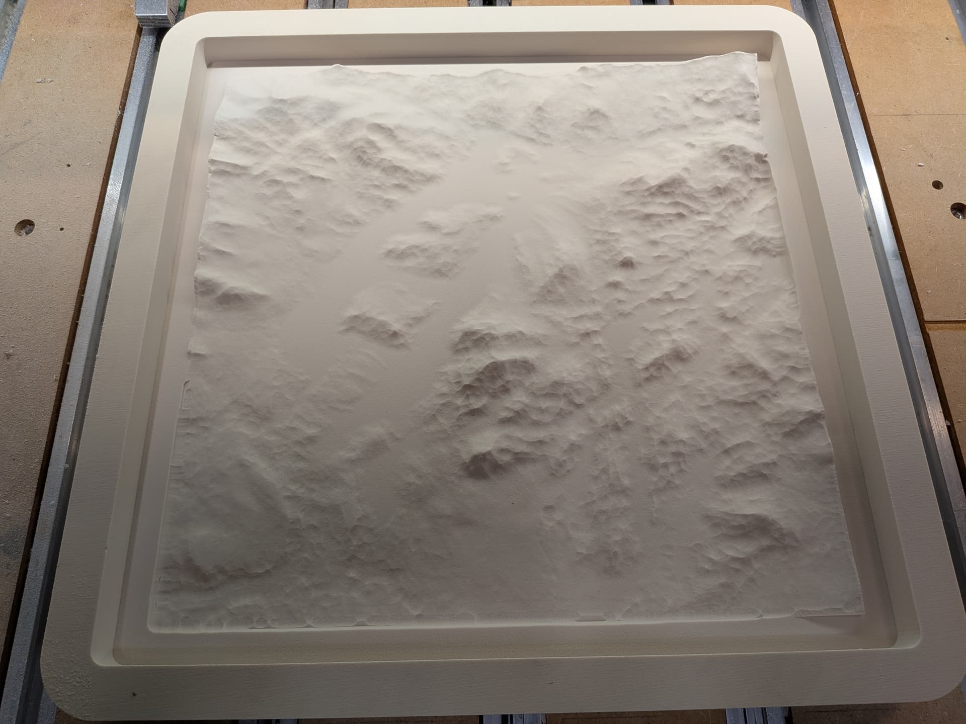

This is the same data and scale as the purple etching from earlier.
Lake Placid NY - 1 meter data, 9.8 square km.
The STL file is 781 MB. 16 million triangles.
My 32 GB Dell laptop using Fusion gets swamped ( memory ) , luckily its an SSD so the swapping memory is not as painful. I guess I found the max model for my setup.

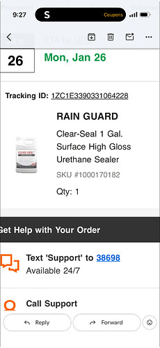

The customer then used acrylic on top of that. She did a little research which led her to using this as a sealer:
She said though that pulled up the acrylic paint in spots and she had to retouch and then have thinner coats.
