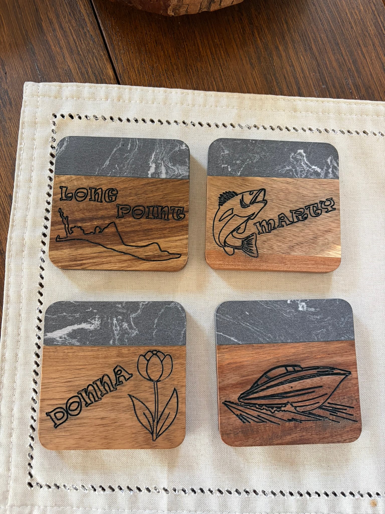

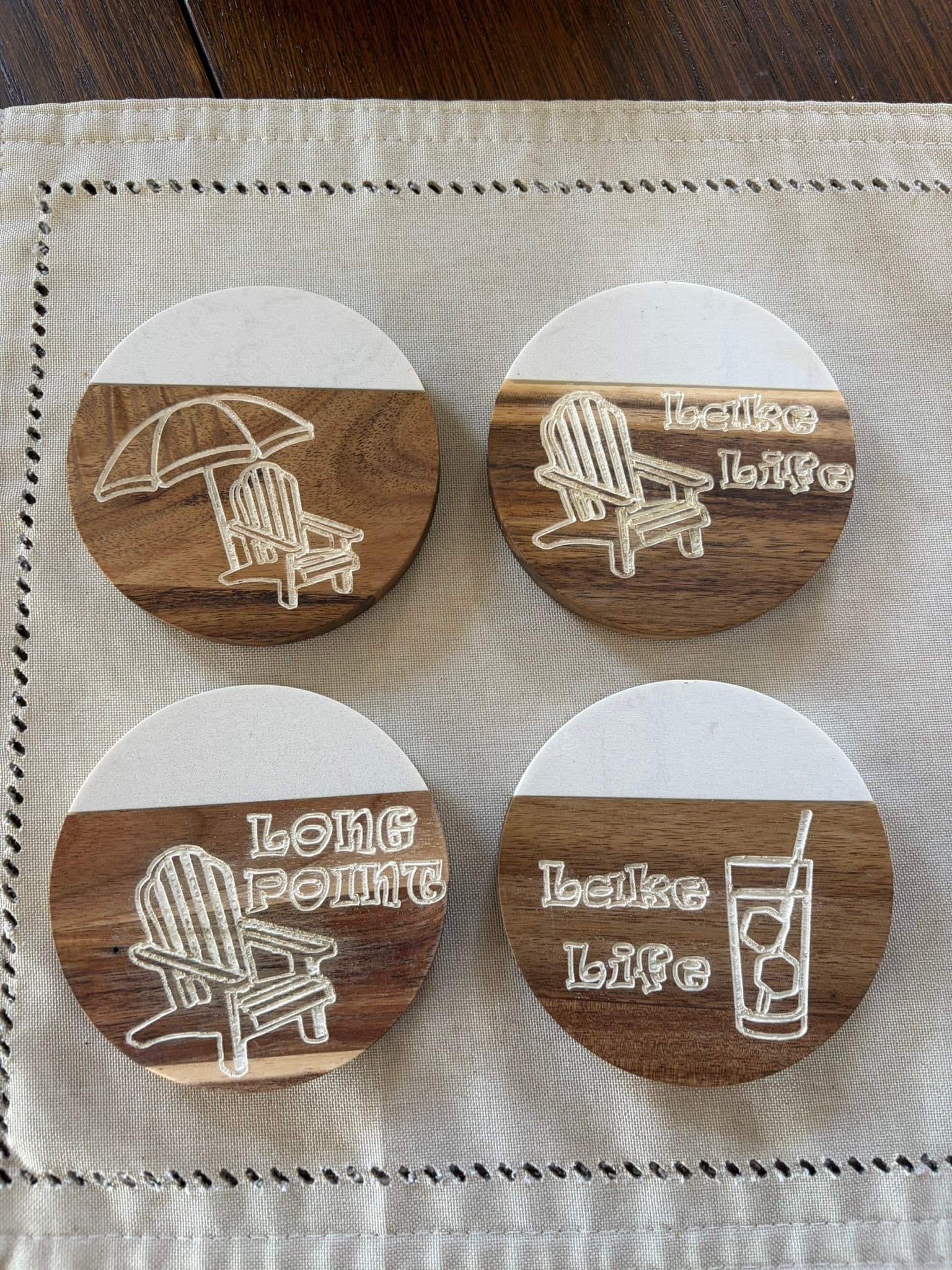

I made a jig (first pic) to hold coasters that my other half brought home from the Dollar Store the other day. Our friends have a cottage that they spend a lot of time at in the summer so I thought a couple sets of coasters would be a nice gift for them to use out there.
And after reading @Bigsmooth911 post above…yeah these have a few imperfections but they’re perfect :smiley:

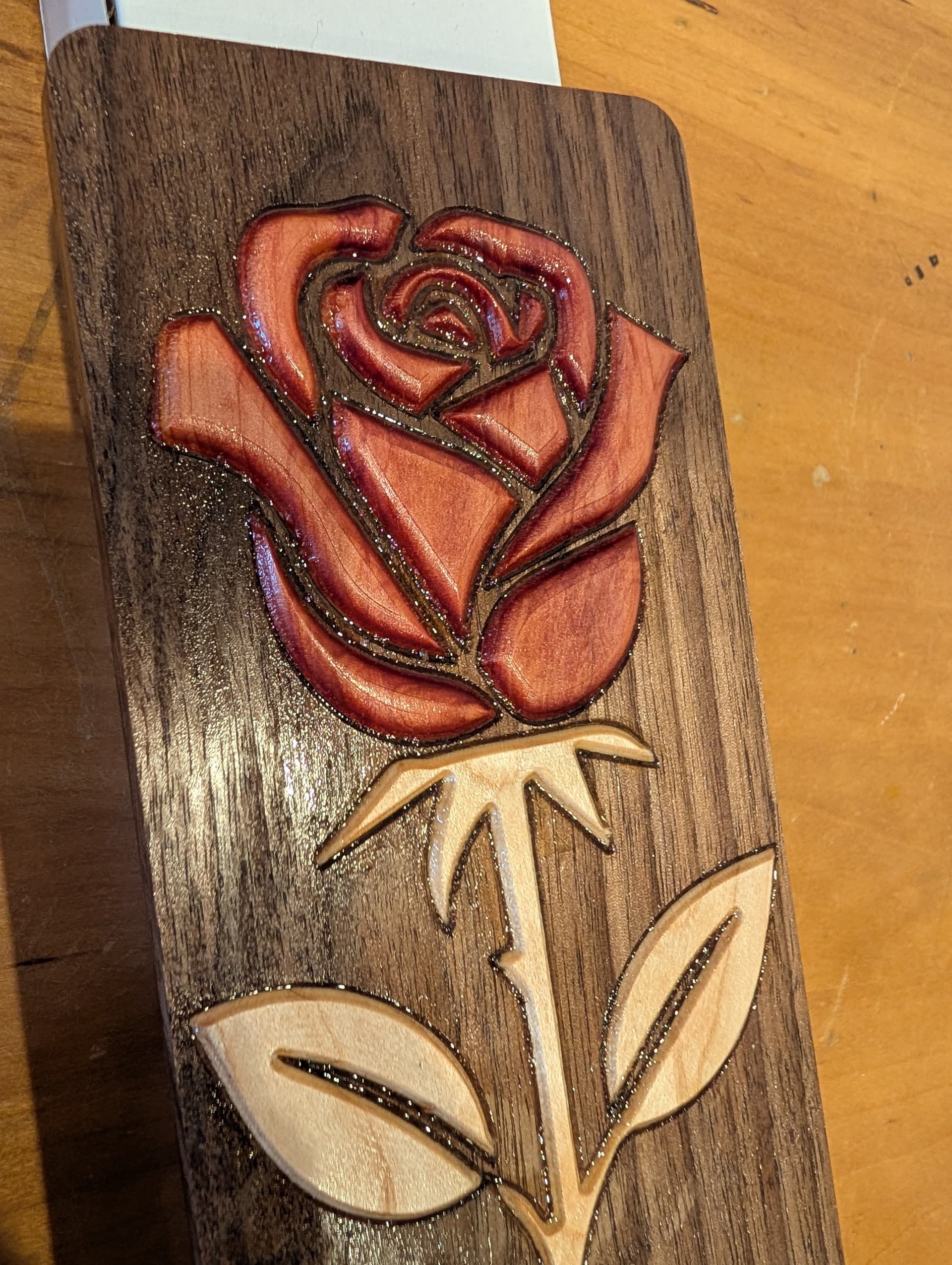

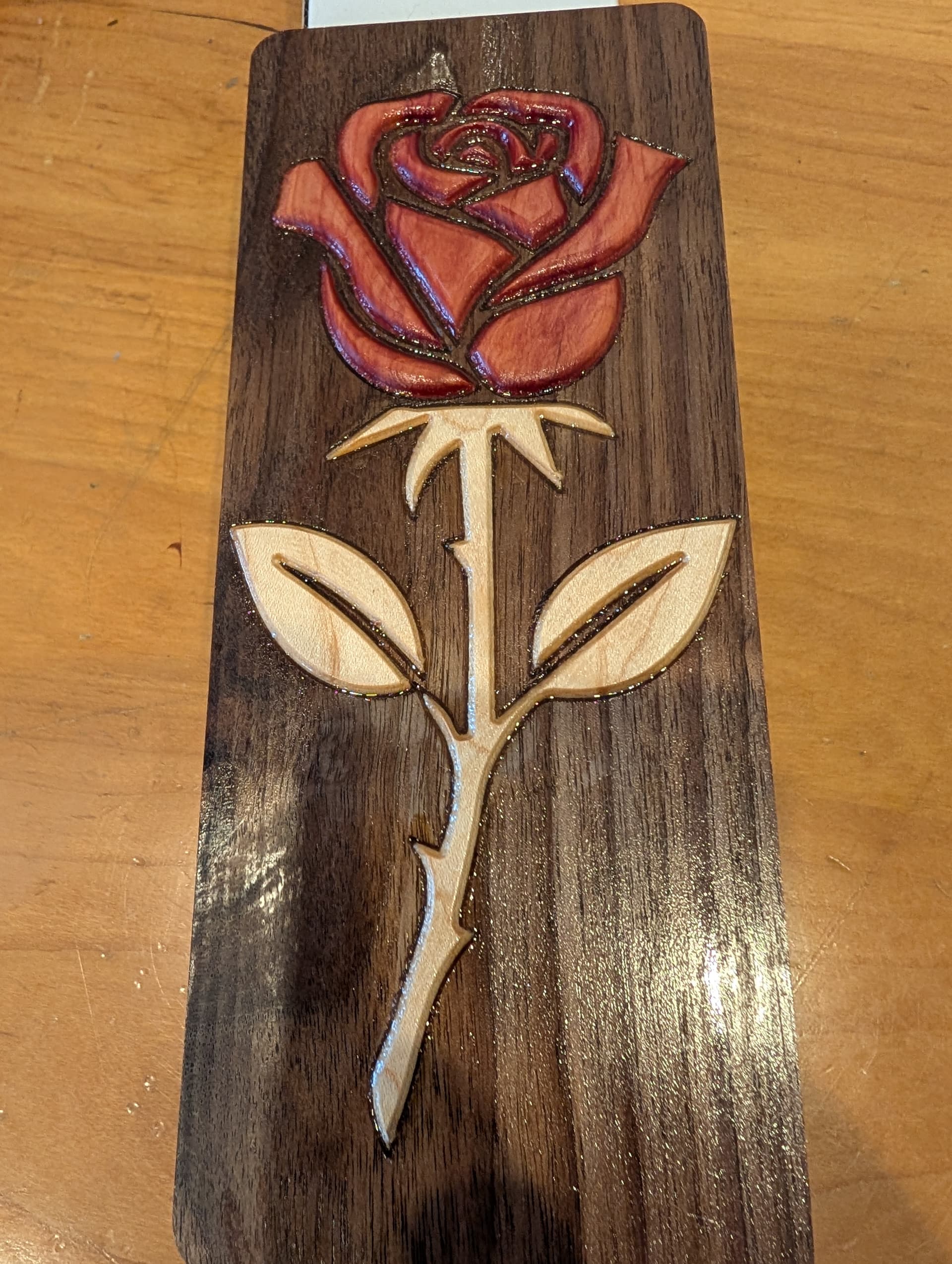

Playing with Carbide Create’s inlay feature to do multi-color inlays
Very nice! l like the definition of the raised inlay
That is very nice,like the colours

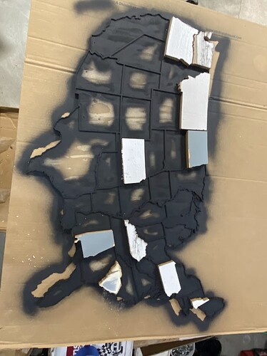

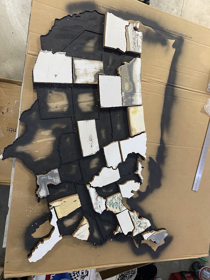

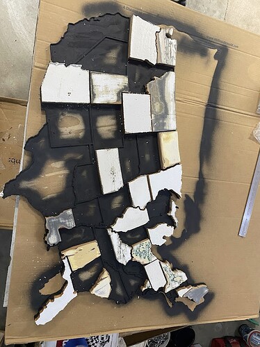

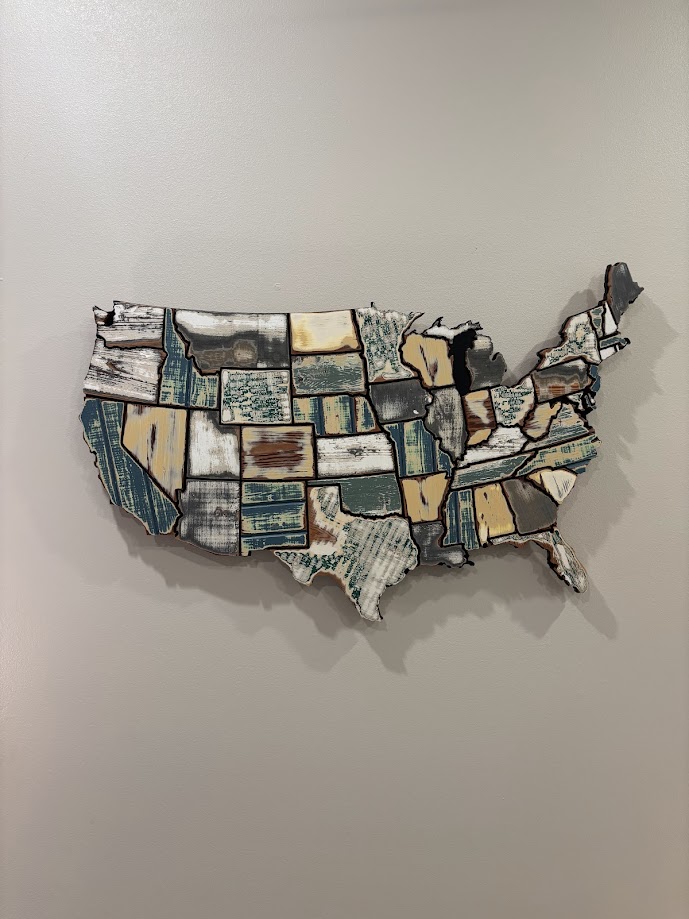

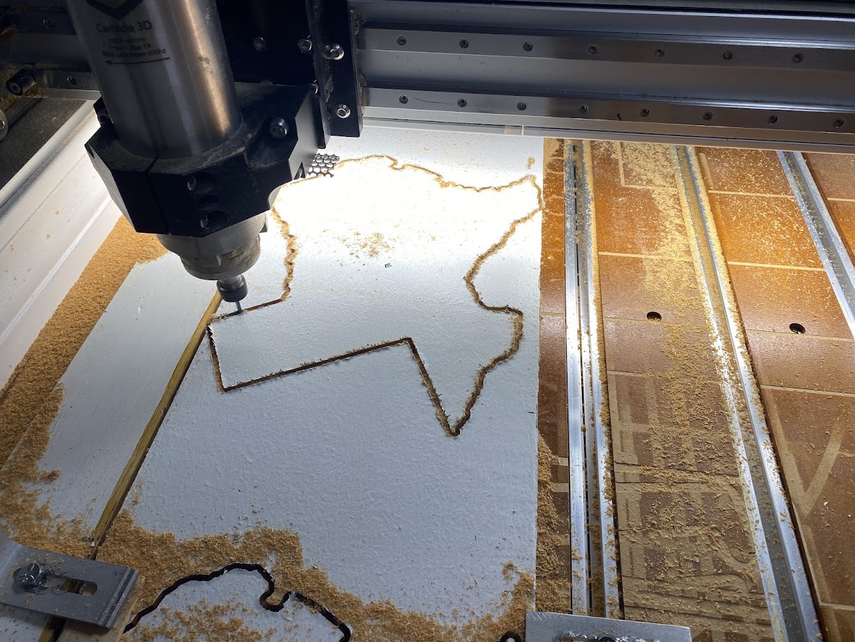

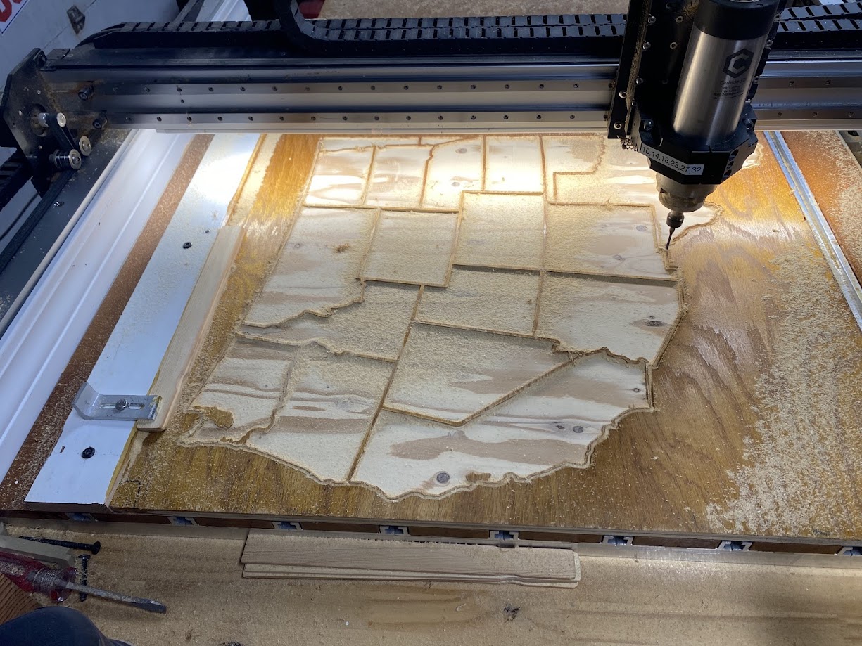

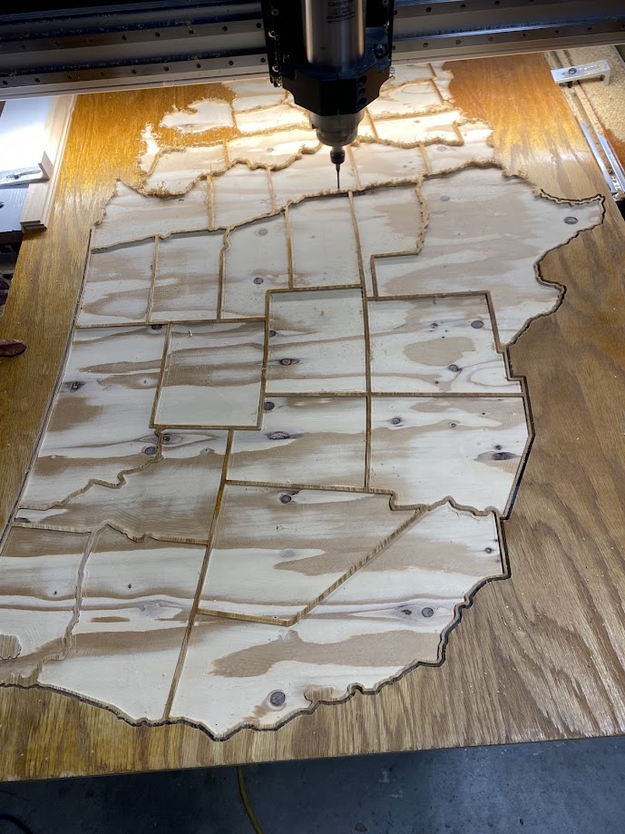

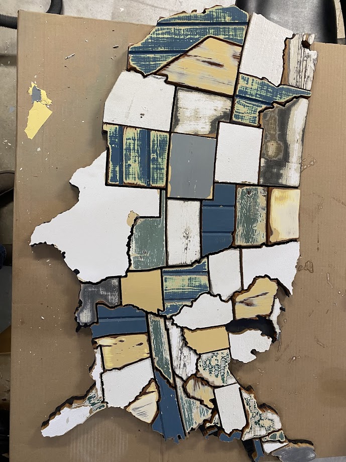

We did some remodeling to a couple of hundred year old buildings so I needed to come up with a project for the old trim and wall boards we removed. I decided to make a map of the U.S art project. I found a map online and separated each state. I recessed each state in 1/2 plywood about 1/8" to make the background. I then started randomly cutting out the states using the inlay tool. As I cut each piece I would sand the face down to reveal the colors underneath. Project dimensions are about 44 wide and 31 high.

For other folks who want to do this, here is a corrected version of the map from Carbide 3D Elements:
United_States_Outline

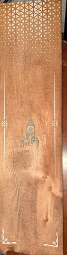

First time working with epoxy. The rocketship is brass powder.

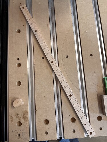

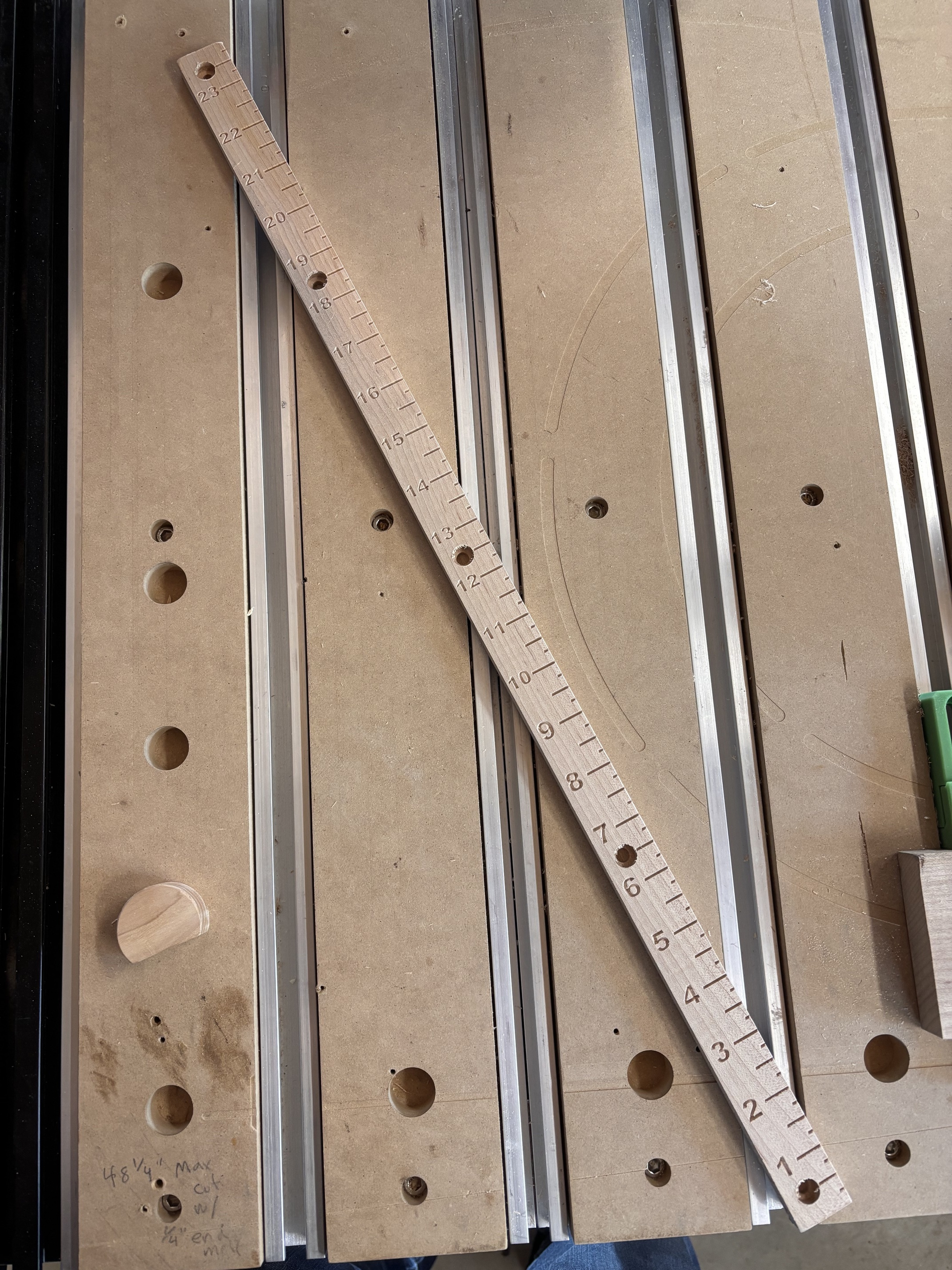

After seeing @SLCJedi tiling fence for the 4x4 S5 pro, and since I’m getting ready to start a large tiling job, I knew I had to make one. This is the link to his CutRocket project that I modified. Thanks, Josh, for sharing it! Made mine out of Maple.

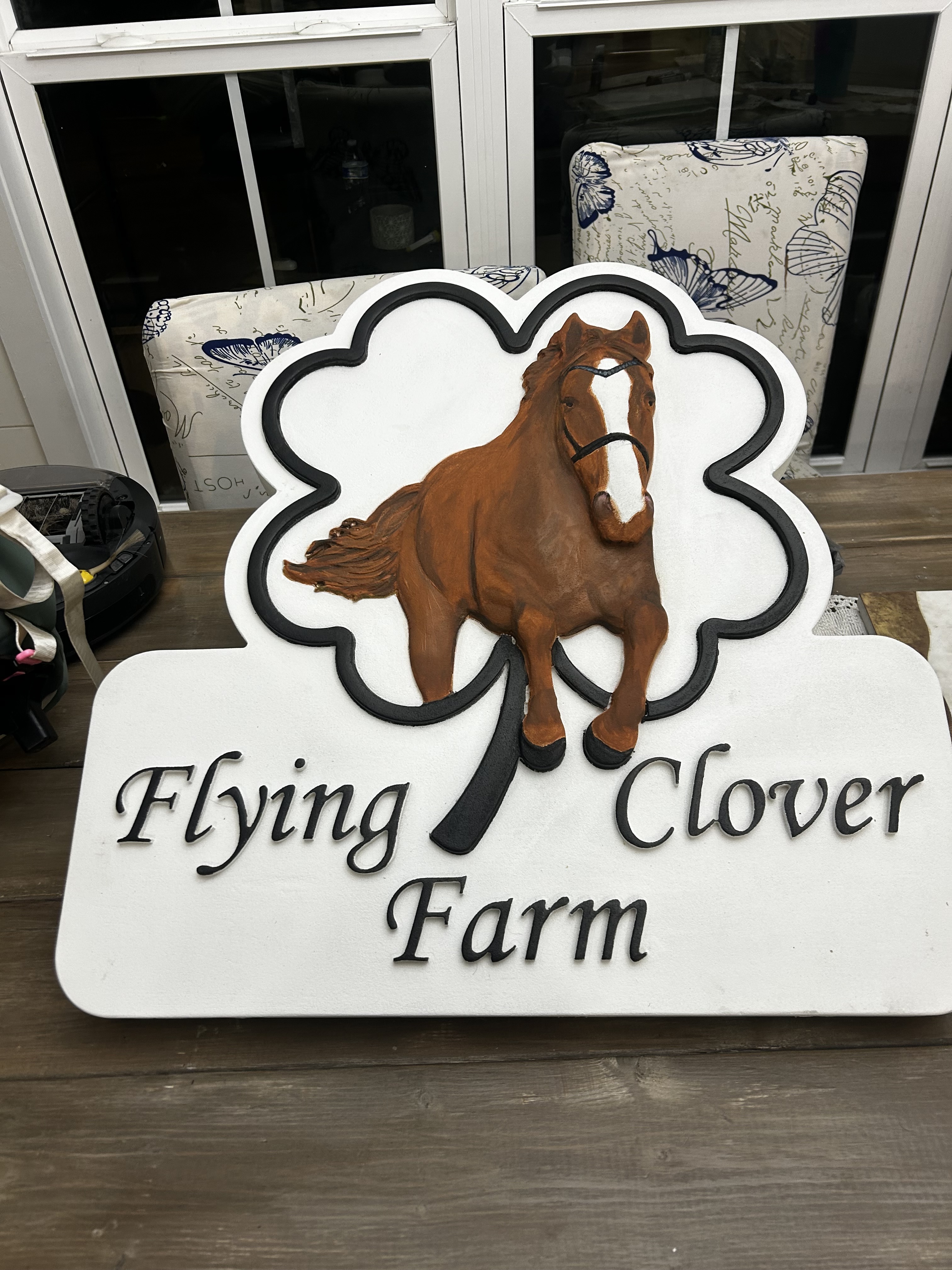

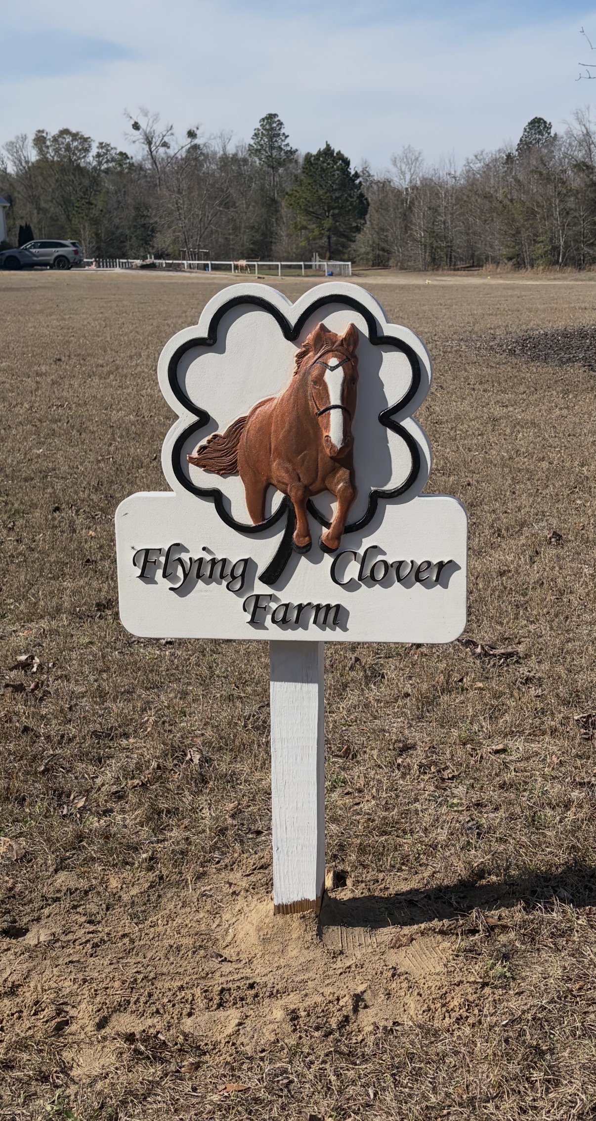

The customer painted and finally mounted the sign.
That came out beautiful. Well done. Good painter !
Thanks. I can’t claim any of the painting other than the primer :slight_smile:
Did they paint in the highlights for depth perception ? Or did you plan the photo shoot ?
The picture is mint.
Well, it was 2” material to start and the backplane now is .75 so there is plenty of depth. The horse is 3D carved. The rest is normal 2D machining.
She did a great job with the paint though.
Here was a shot in her house just after painting.
Not complaining! :smiley: But this piece is a good example of needing at least 4 coats of a good glossy lacquer.
Before mounting it outside she applied a top coat specifically for HDU that’s is supposed to help protect from the elements. I need to find out what that was. I don’t know if that’s supposed to be better than laquer.
Do the individual states that are also in the elements? Fit into the USA map you posted?
Almost inlay style? Because @ALLYBLAK map is inspirational
Yes, the states are individual element — note that actually cutting and fitting isn’t taken into account — for that, either V-carve inlay will need to be used, or each state will need to be inset by the diameter of the desired tool, then offset to the outside by the radius and any gaps addressed.
I shrunk each state down by 1/16" perimeter to give me 1/8 between states, I cut it with 1/8" bit using inlay tool and had an allowance offset of .025 for the states so they would fit the background. Hope this helps!
