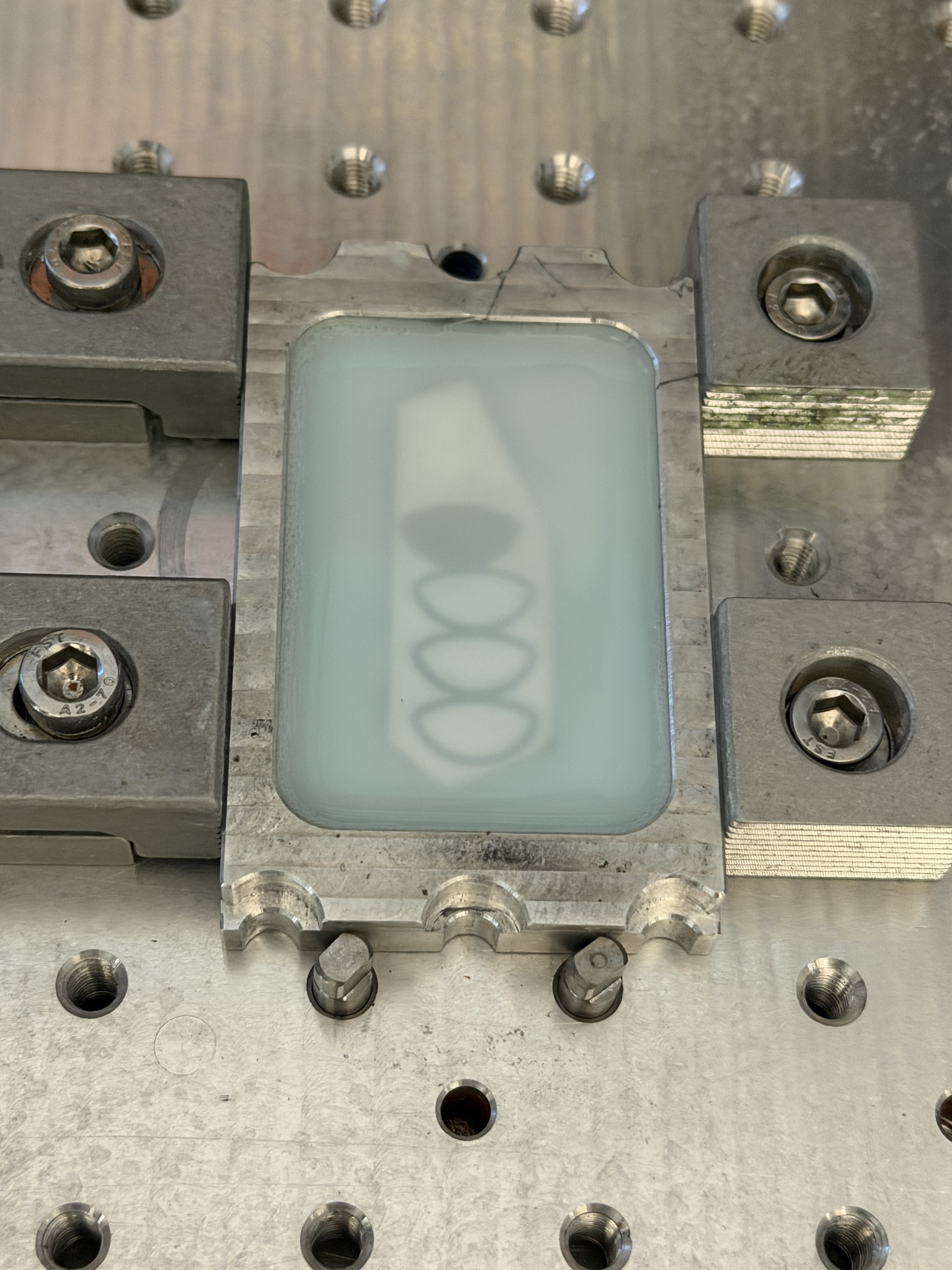

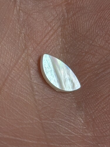

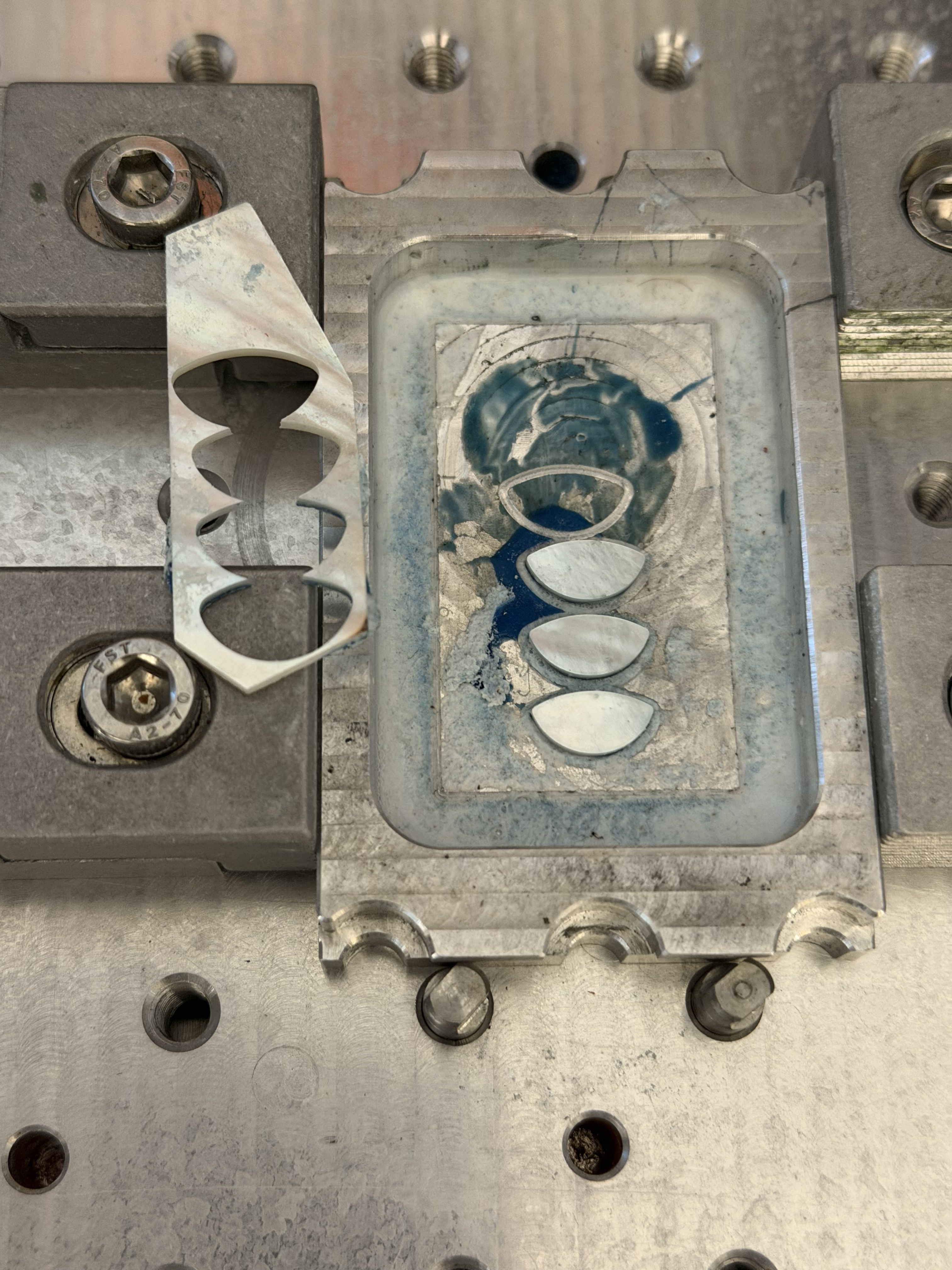

Cut some 1mm thick mother of pearl for some inlay. A bit of moon:
Fixtured with wax. Cut fully submerged with a 2fl 1mm carbide mill.
The water does a good job keeping the hazardous dust down and nothing cracked, flaked, or fractured.

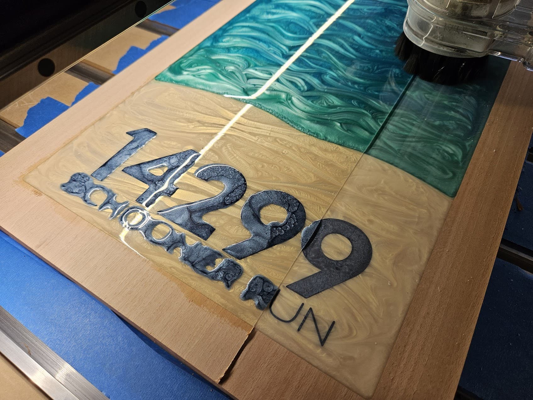

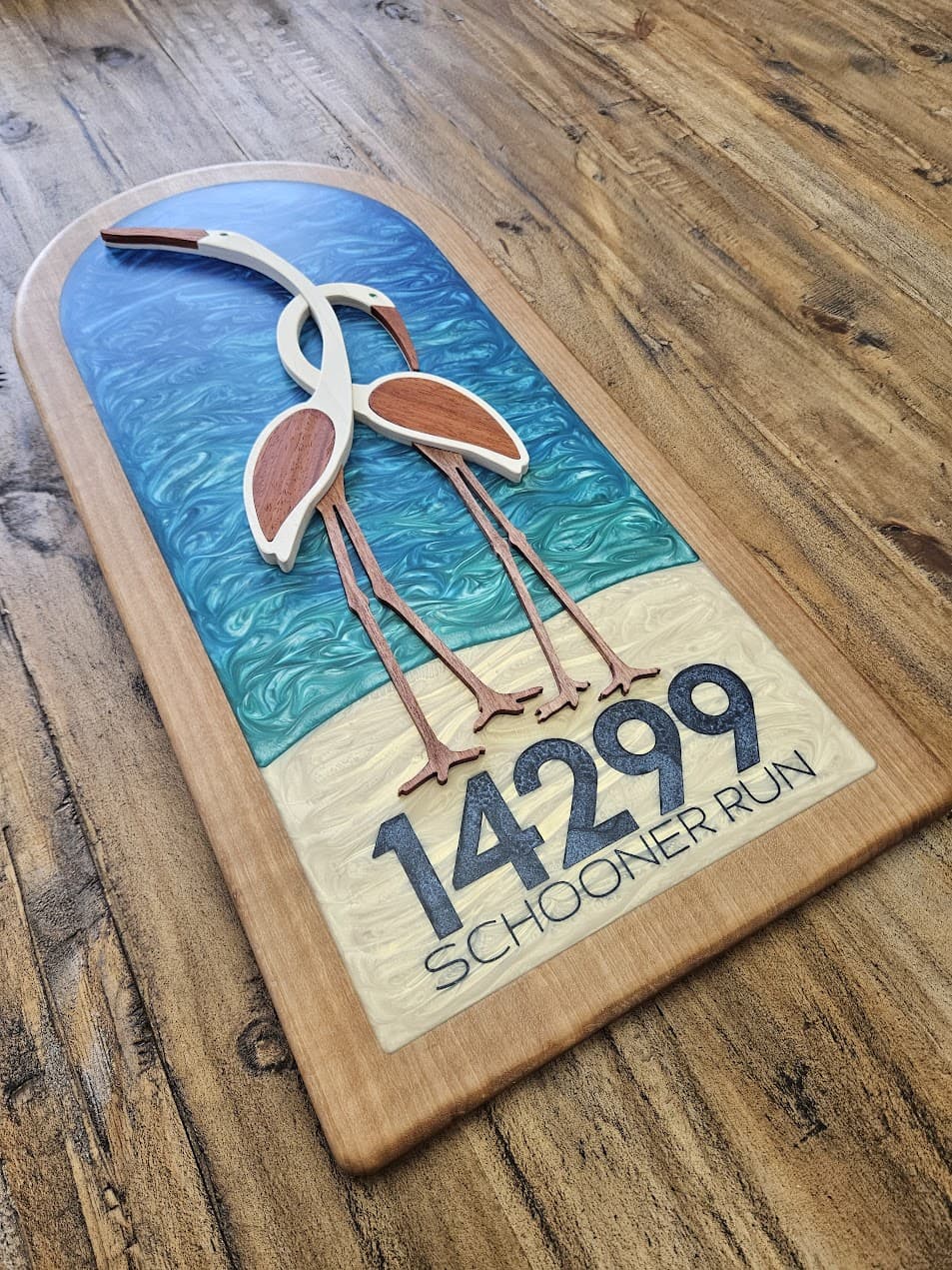

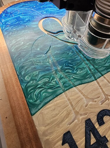

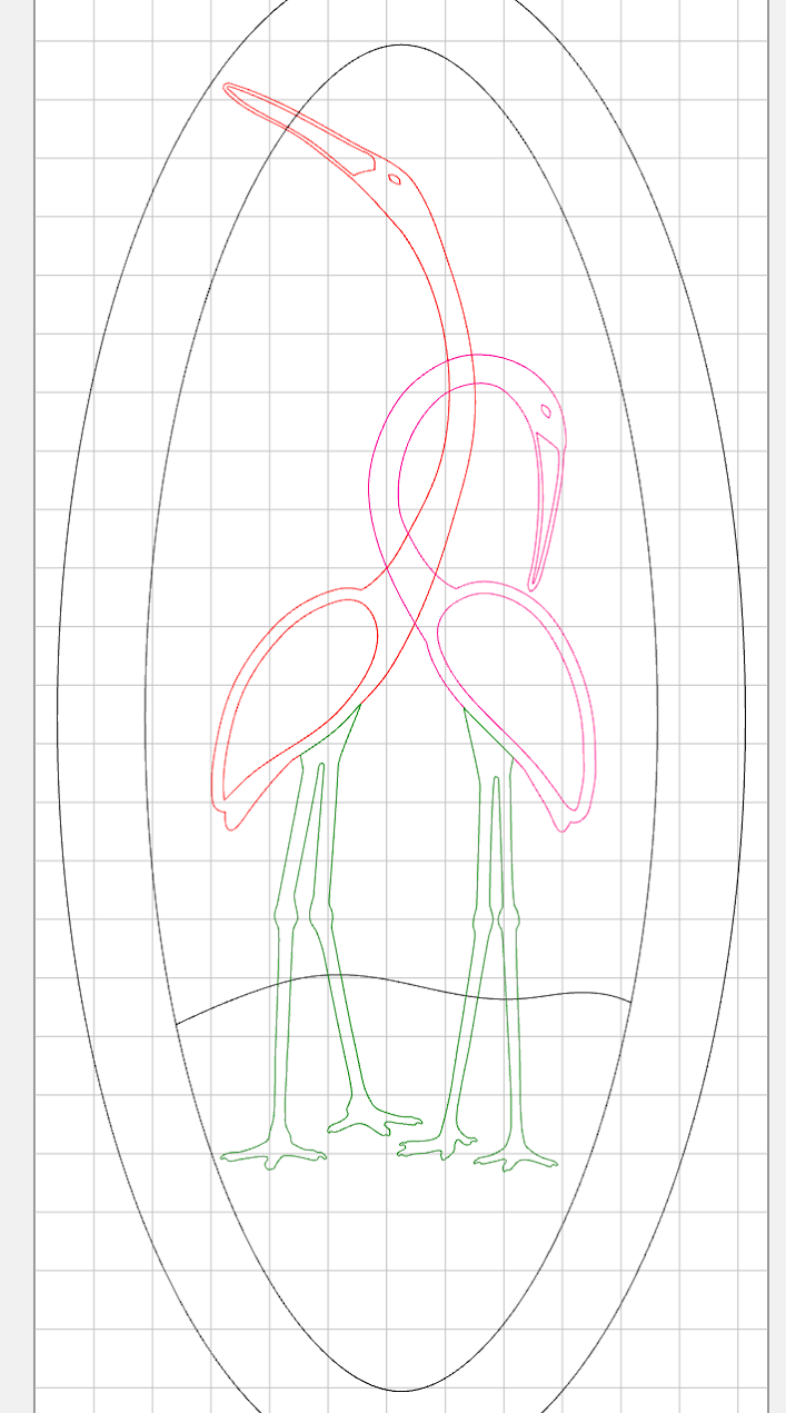

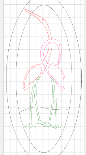

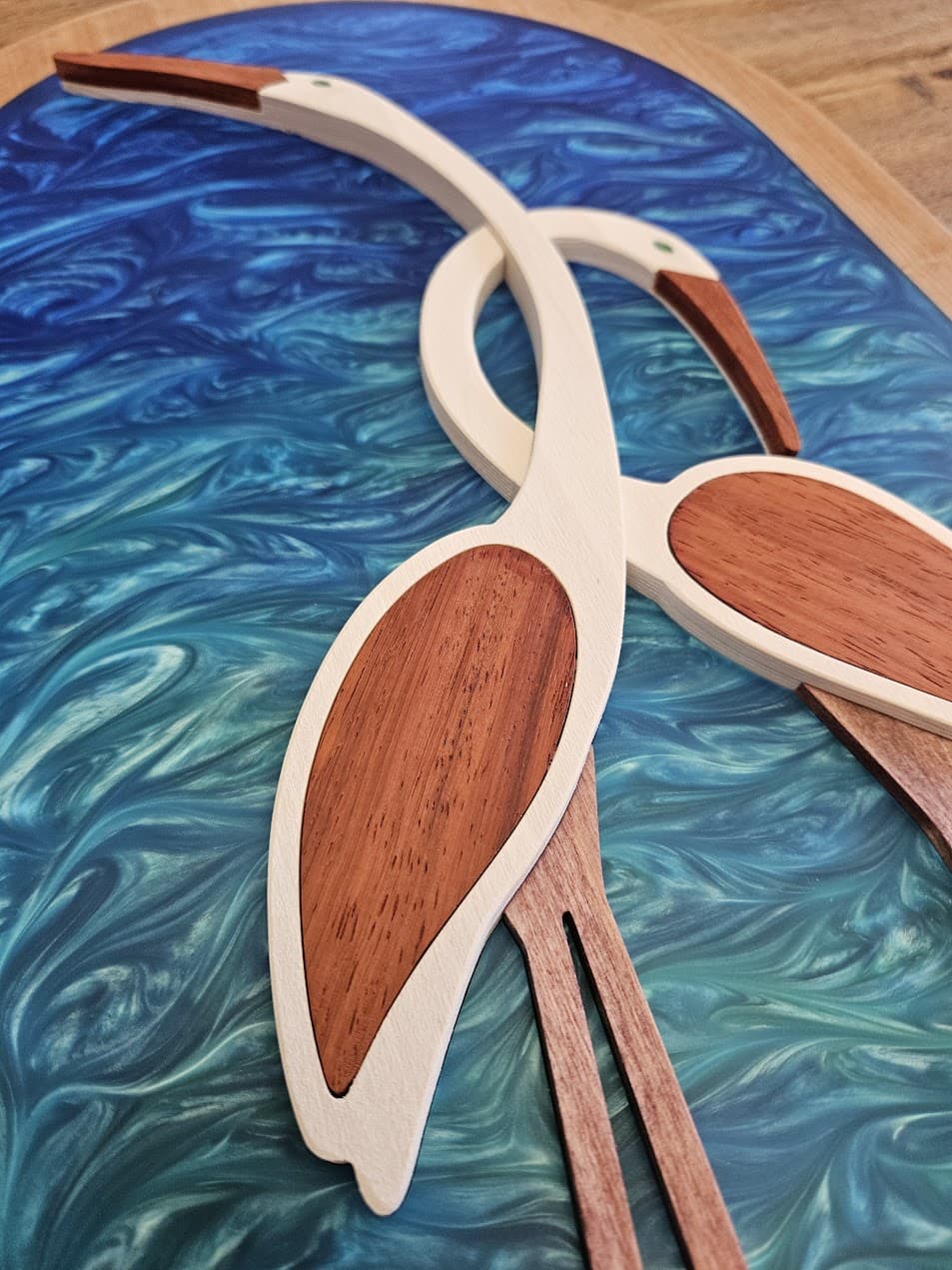

Haven’t posted in a bit, but time to share a latest project. I’m driving east to visit family and friends soon, and asked my mom what I could make for her. I have a sculpture of herons I bought years ago, and she asked me to make something based on that sculpture.
I took photos of the birds individually, and used AI to create line art which was then imported into Carbide Create and I started working the design.
As I was working this project, a neighbor asked me to make a housewarming gift for a family member. He saw the work in progress and we went with a modified design of the same thing to save time (10 day turnaround overall).

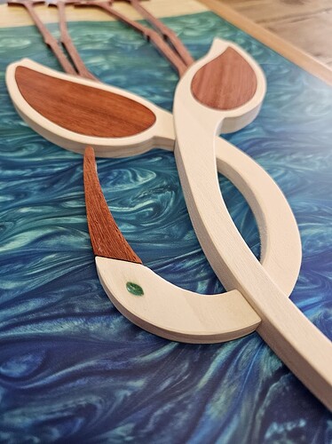

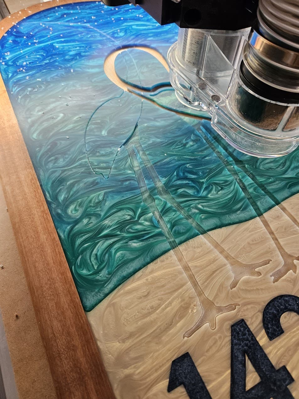

I started cutting parts…
I like to work a mix of wood and epoxy resin - especially when adding lettering.
There were plenty of ‘pucker moments’ during the process…
In the end, it came out gorgeous and the neighbor couldn’t have been happier!

That’s gorgeous. Great job.
I cut mine in a bath like that as well although mine is plexiglass. Nice clean cut.
Wow! How do you get the wavelike texture in the epoxy?

Absolutely fantastic result!

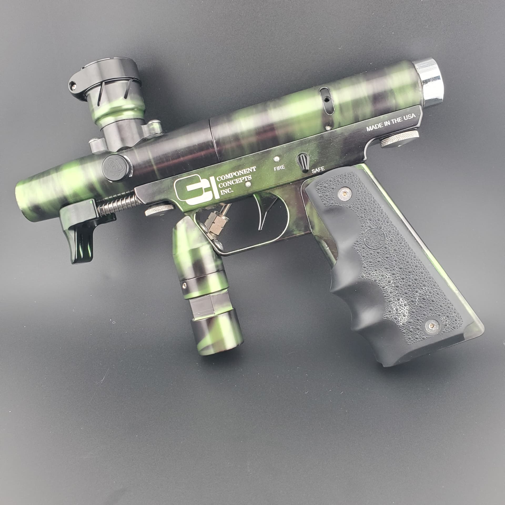

Yeah, WGP style detents but the Revolution needs them bad. I do lots of work on/ for the original Phantom, and keep hemming and hawing and saving for either an HDM or, now, an N4.
Some more photos of that CCI job, then another project to ensure my wife still likes that I have a CNC.

I used 3 colors of mica powder - turquoise, okinawa blue, and deep sea blue. As I poured the colors I allowed some slight overlap of horizontal stripes of color. As epoxy is curing, I run a wooden toothpick side to side in a wave pattern to get the effect.
The tricky part is that you can’t trust the epoxy to stay in place, it ‘rolls’ as it cures. You have to keep an eye on it and touch it up until it gets to a plastic state.

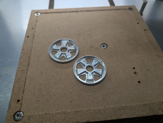

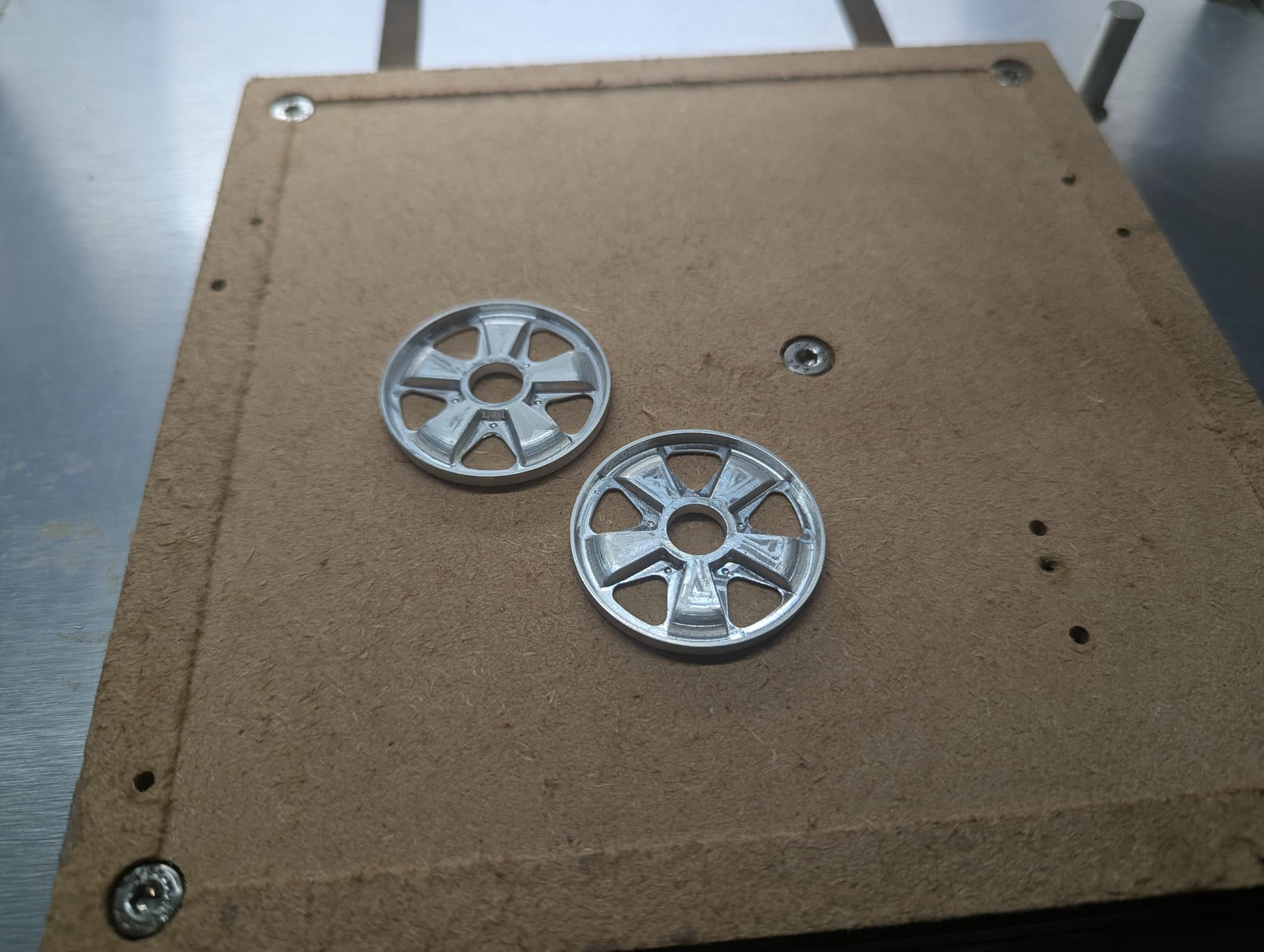

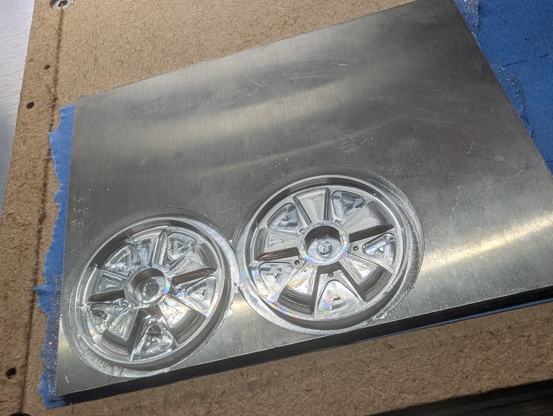

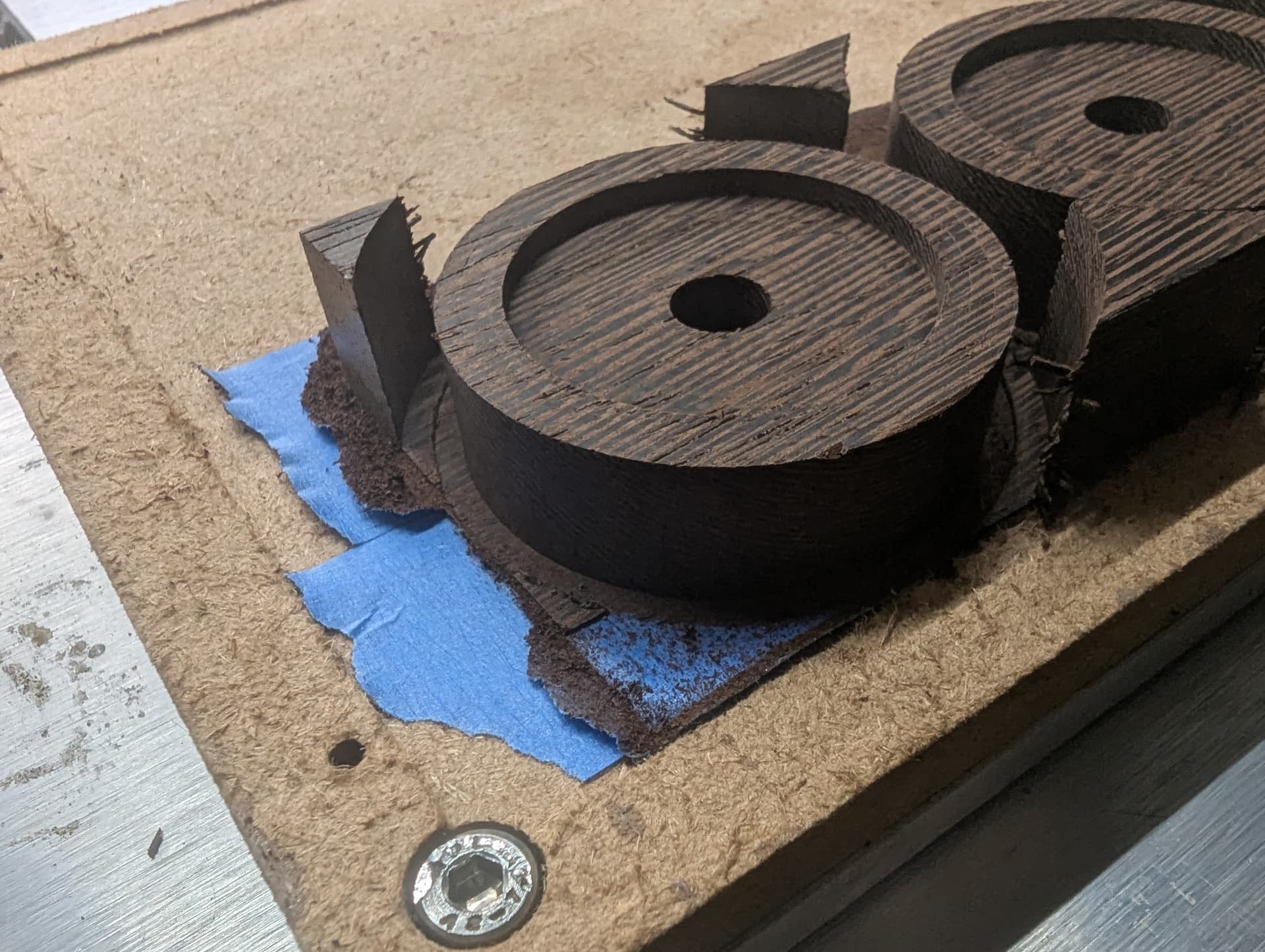

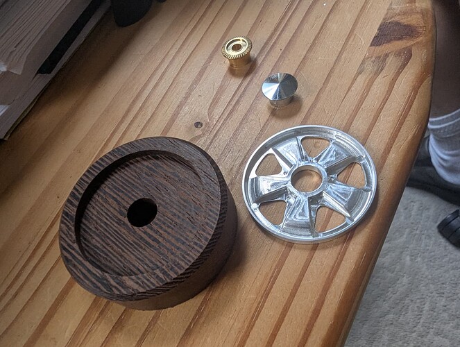

I had purchased some yo-yo kits from penn state industries like 2 years ago, and while I have a CNC lathe, I’m still learning it and I wanted to do a gift for my buddy who is pretty big into Porsche.
The inspiration ^
Cutting aluminum on the nomad 3

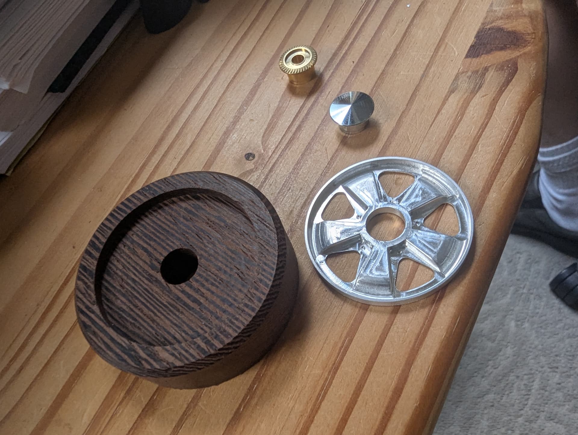

Tires made out of wenge
The pieces all lined up

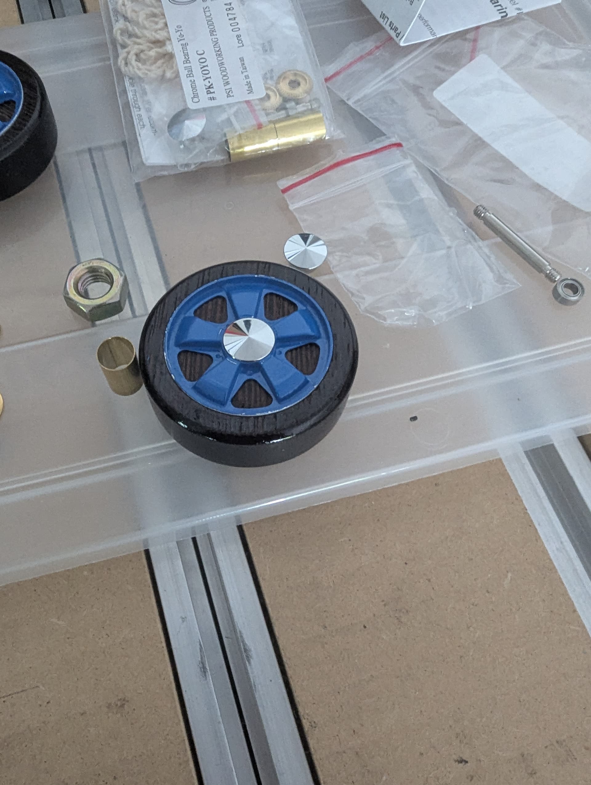

My buddy decided to paint the aluminum blue
He also put gun stock oil on the wood.
Finished result
I modeled it up in fusion. Going to run a second one, and did some slight changes based on feedback after the first.
