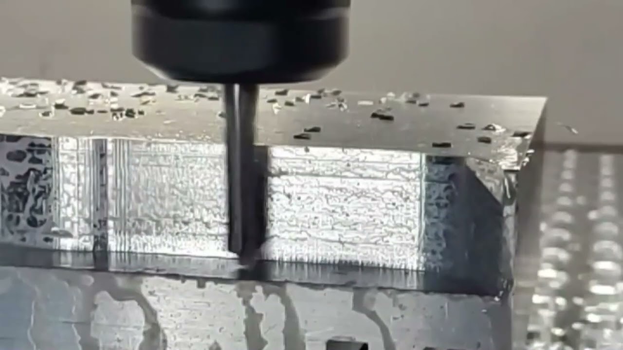

Initial tests of the Datron 6mm Cross Cutter. Awesome tool that is basically a single and two flute combined with chipbreaker. Datron apps engineer specified 3kw spindle minimum but I extrapolated the datas from his recommendations and put the 1.5kw HDM spindle to the test.
Beat my previous record of 3 cubic inches in 6061 by 25% and still have more to go. Sorry about the cellphone quality video, this was a initial test. John wants me to do a wednesday video on the tool so that should be fun.

The cost is up there but for moneymaker parts, the depth of cut and power requirements of this tool seem very well balanced for a roughing chipbreaker. Datron tooling has always performed well above the cost difference to standard tooling for me.
For large projects I can definitely see the worth, but I hear you.

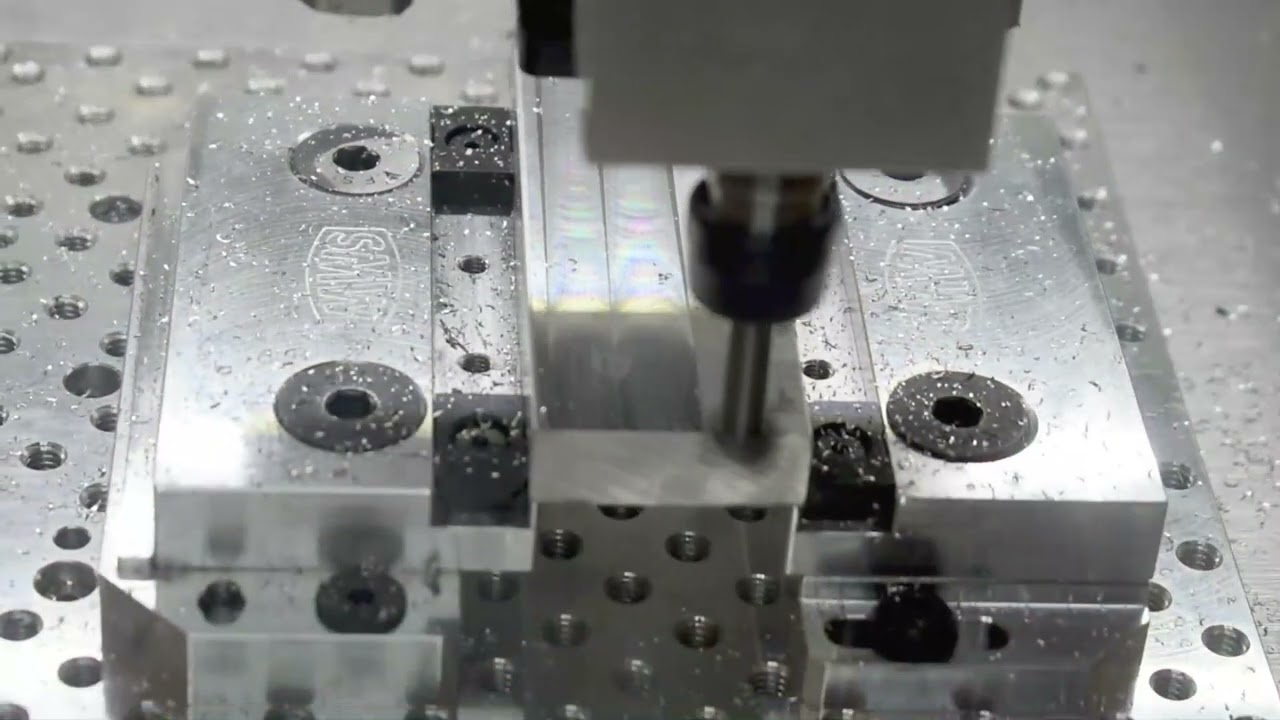

Prepping stock for a pure Silver Jewelry project with a Datron 12mm 2F in the Nomad 3.
Awesome results when spindle load is matched with optimum feeds and speeds, had to share. Datron 12mm Facemill #0068442, 18,000rpm, 54ipm, 0.003/0.002 axial steps, dry cut.
