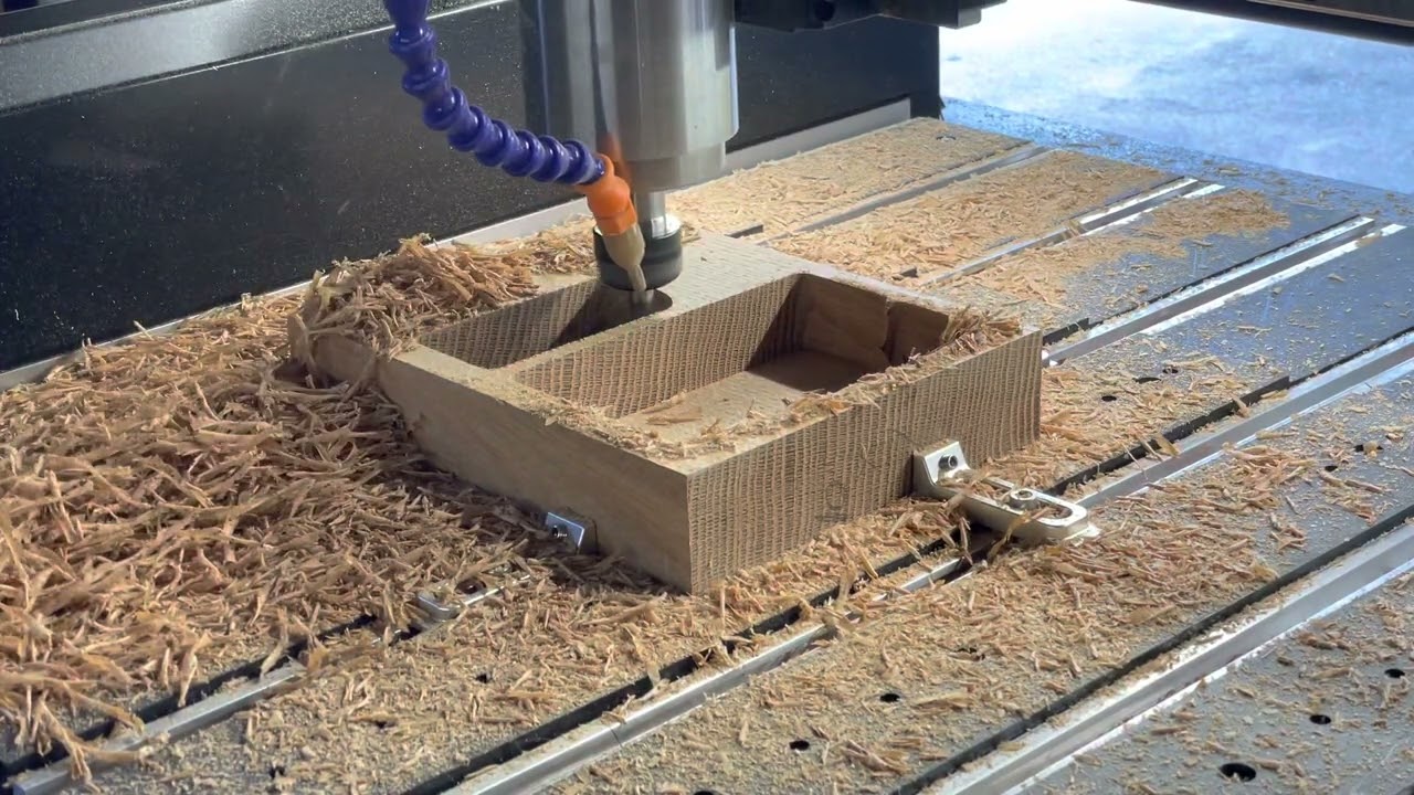

HDM enjoys white oak too. I know, it’s not aluminum, but 1 1/2 inch DOC is kinda cool.
I was satisfied I’m not owning a HDM knowing that it was optimised for metals. However, now you got me wanting one.
I’ve got the Pro. I’m assuming that upgrading just the spindle won’t give me those results, it’s the strength/rigidity of the HDM that you need
Honestly, I’d guess a Pro with a spindle could do similar.
My old XL with HDZ and 2.2kw spindle was capable of similar cuts also using 1/2”/3/8” single flute cutters. Albeit slower and less optimal load.
