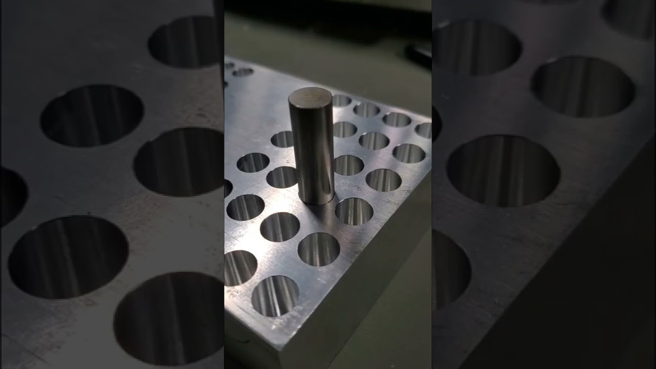

Checking the HDM Accuracy and repeatability of bores with pins and a surface plate with Mitutoyo electronic height gage. Lets go

Looks damn nice on position! Are you checking circularity and diameter too? I’m curious how boring and reaming on the HDM compare.
Also curious how the HDM compares to the bigger machines in the shop. I’m sure the bigger VMCs can chew through material faster but is the HDM comparable in terms of accuracy?

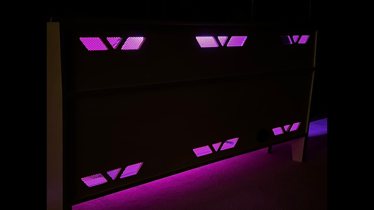

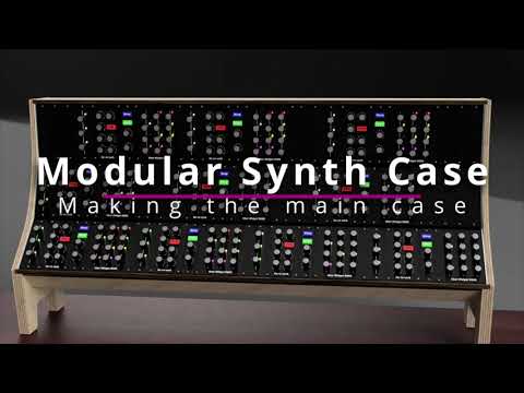

I’m making a modular synth case and found myself in need of some ventilation slots in the back panels to let the heat out. I just couldn’t commit the crime of boring round holes…

Hard to tell exactly from the video, but the corners look very clean and sharp - what bit did you use?
Hah, sorry, the video was also meant for non-woodworkers.
The adaptive clear was a regular #201 style two flute
20kRPM
1,500 mm / min
2.4mm optimal load
6mm depth of cut (workpiece was only 6mm)
0.5mm stock to leave
The contour was a cheap single flute £10 for 10 on Amazon 1/8" cutter which I run fast and take bigger cuts per tooth than I did the #102 2 flute.
24kRPM
1,250 mm / min
full depth
ramp down at 4 deg
2 finishing passes at 0.25mm per pass
Finished with a chamfer mill (Trend 90 degree V cutter) at
24kRPM
800 mm / min
0.5mm chamfer
2mm tip offset
(remember to measure the stock thickness properly to get the right chamfer depth when zeroing off the spoilboard)
The combination of the high RPM single flute with finishing passes and the chamfer tool leave very little to sand, even in this quite stringy birch ply.
It’s not the fastest set of toolpaths to run but I trade time on the machine for finishing time, especially sanding the insides of fiddly shapes like these.
Mostly the same feeds and speeds here
Except for the outer contour, still a 6mm step down but this was a 1/4" compression cutter with the double finishing pass at 0.25mm stepover and full depth to leave a nice crisp edge that didn’t need chamfering to clean up.
The big 19.1mm bottom cleaning cutter runs at 23kRPM (it just sounds happy at that speed with no vibration) and 0.5 to 2mm DoC feeding at 1,500 to 2,000 mm / min 9mm stepover.
