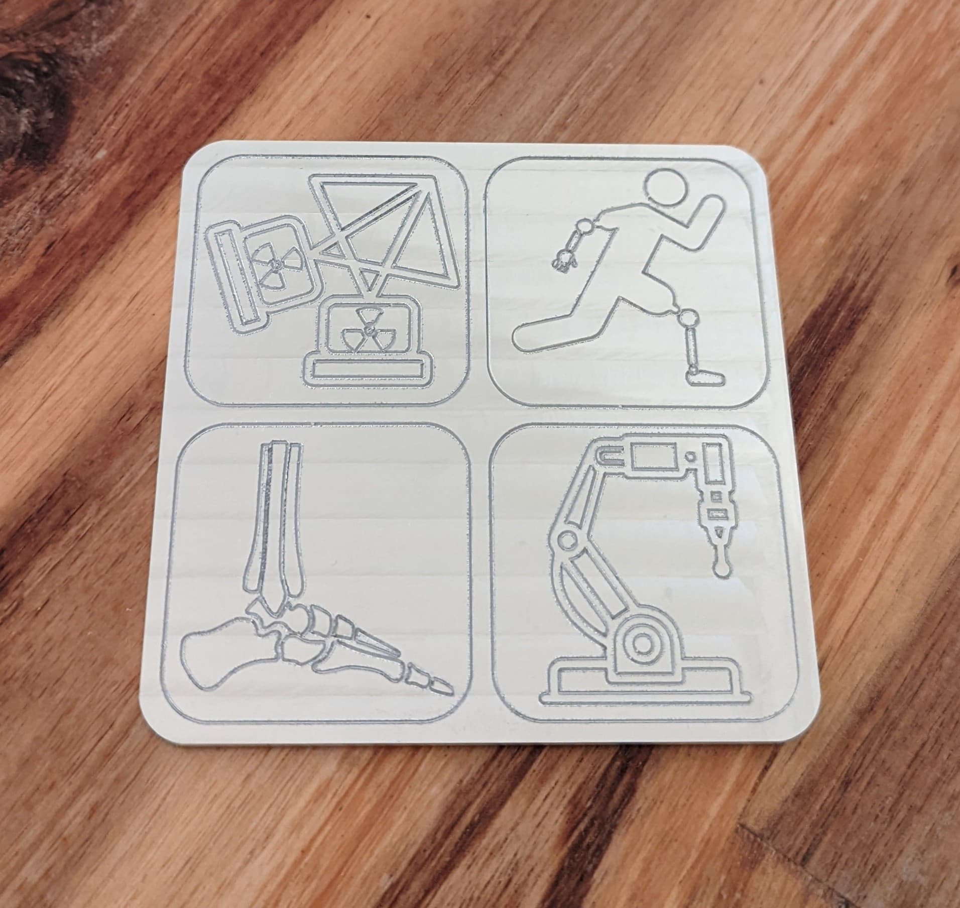

My third attempt to vcarve aluminum on the HDM came out okay. Struggling with tape fixturing that doesn’t warp. The carving is a bit rough around the edges, any advice on how to make it cleaner? This was a 0.1mm deep carve with a 60 degree vbit.
@SLCJedi this is my wife’s lab logo in ortho.

Have you tried the trick of running the job two times in a row ? The second run sometimes acts as a natural deburring pass.
Looks great from here. :slight_smile:
I’m with @Julien run it a second time. I’ve also started doing engravings at the highest RPM possible and slow. Seems to come out cleaner.

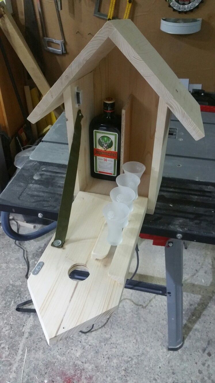

Just to be clear, I did not make this, I just liked the concept. :stuck_out_tongue_winking_eye:
…replacing the word concept with contents… :upside_down_face:
Cute way to hide your shop bottle. Just wait till work is done.
