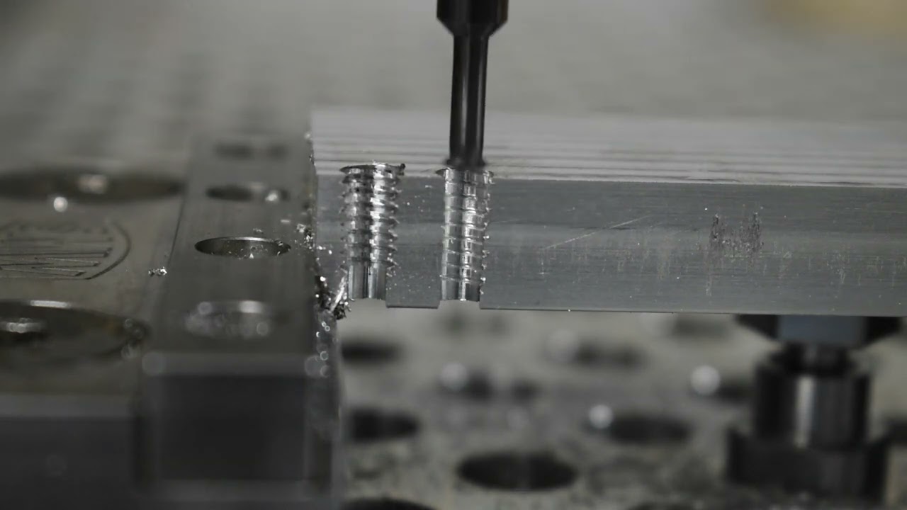

Getting ready to write up a threadmilling thread complete with tips, trick and Fusion 360 CAM secrets.
Perfect! Just in time for my next step.

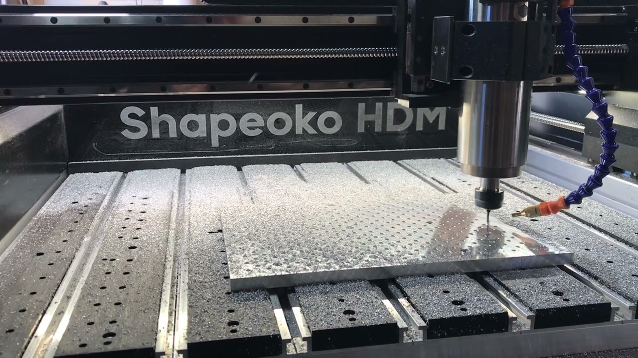

Visiting Crystek again this week, and decided to remake the plaque I had designed a few years ago with a few enhancements/improvements this time, and added a nice heavy base carved out of one inch thick 6061. Always room for improvement, but I think it came out pretty nice!
